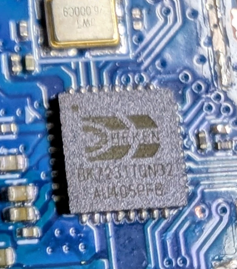

    I got an LED driver here that contains a BK7231T.
    I read it perfectly fine with the Easy UART Flasher. Afterwards, I wrote the auto-downloaded FW to it.
    After verifying, I received a CRC error and the chip is now dead. This happened on two different chips.
    It refuses to enter flash mode, regardless of whether I use the CEN pin or power the chip manually.
    The chip is clearly a BK7231TQN32, so that SHOULD be the T, right?
    The UART adapter used is CP2102 based, I also used an AMS1117 3.3V voltage regulator to power the BK.
    Help please?

    Thank you for your report! I double checked and it seems that like the newest build of the Flasher must have had some test code included accidentally. I can tell it by the offsets used by the write - 0x200000. I'm afraid that now you need to use CH341 method for this particular BK7231T to restore bootloader from QIO.
    EDIT: I've found offending changes and reverted them and pushed a new build, but I am afraid that you still need CH341 method for this particular BK.

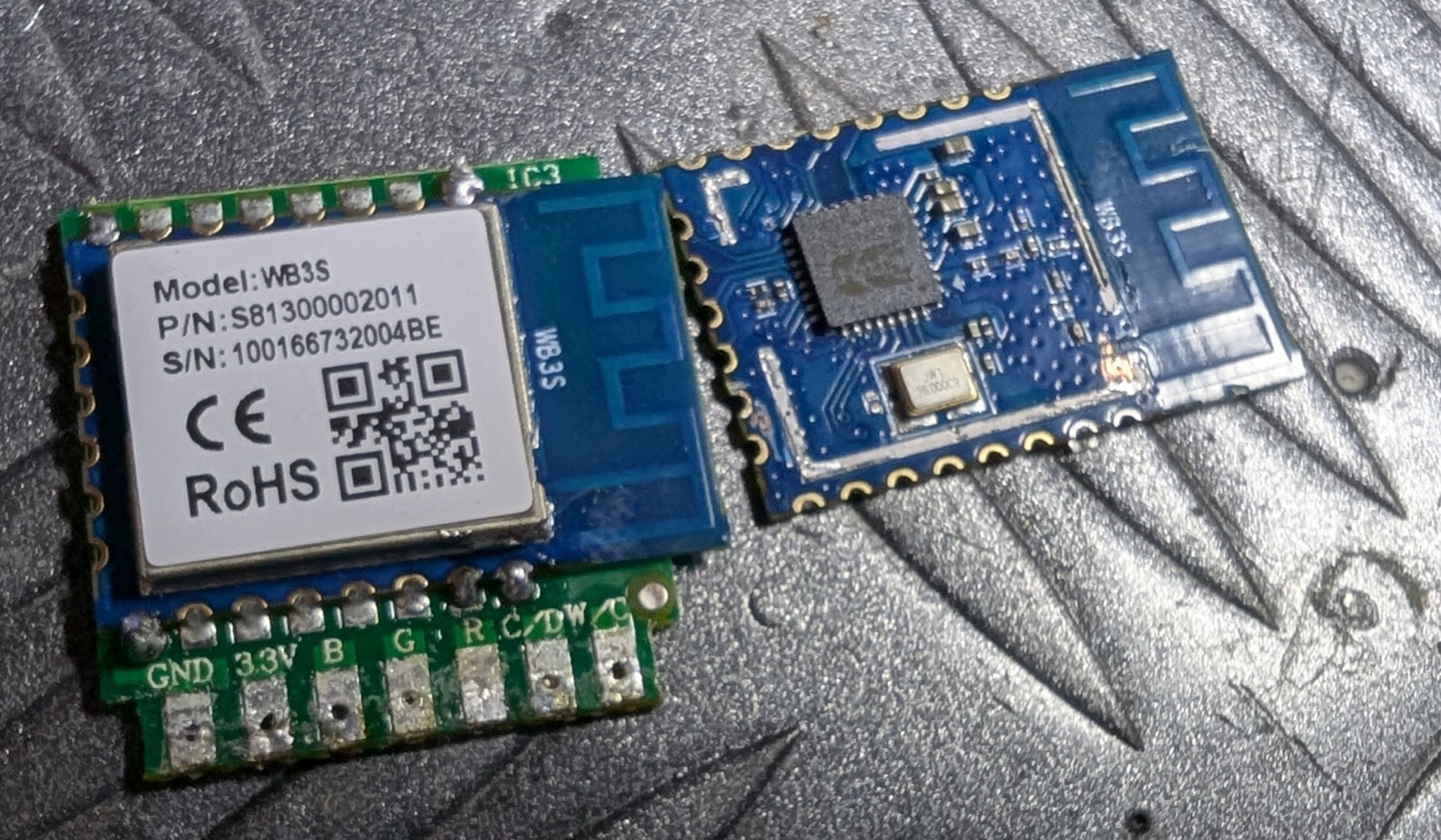

    Received a CH341 the other day and was able to fix one of the modules with it. The other will read and write, but not show up on Wi-Fi at all, so I'm guessing it may be damaged.
  • #4 21724644
    Posts: 14743
    Rate: 12839
    QIO restore should work just fine. You can also try flashing first a full BK7231T image from one of our flash dumps https://github.com/openshwprojects/FlashDumps and check if it boots. If something does not start, then you need to show TX2 log. It's not possible to destroy BK7231T by changing flash content.
    Maybe they don't show due to MAC conflict. You can change MAC in OBK or in flasher.
