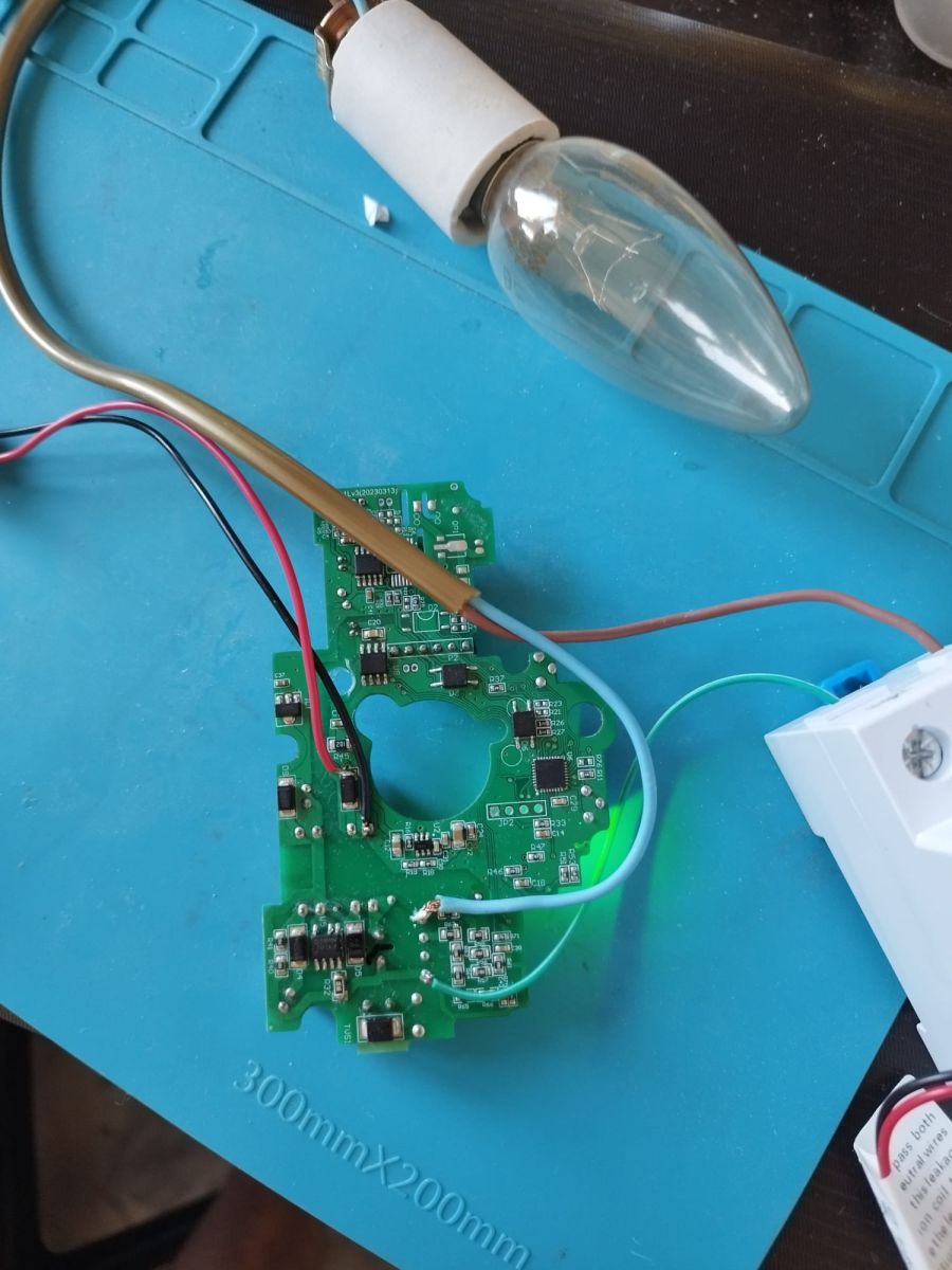

    This topic is a continuation of the conversation with ElektrodaBot initiated here (but, of course, also open to humans 😉), as I think I was hijacking the main purpose of that thread.
    To sum up, I needed a replacement for ICW2540, a primary-side, offline switch-mode power-supply controller that is the main IC in the power supply of the device object of that thread.
    After some discussion, the last answer of ElektrodaBot gave some possible candidates, but after consulting the datasheets, I found it's not pinout compatible.

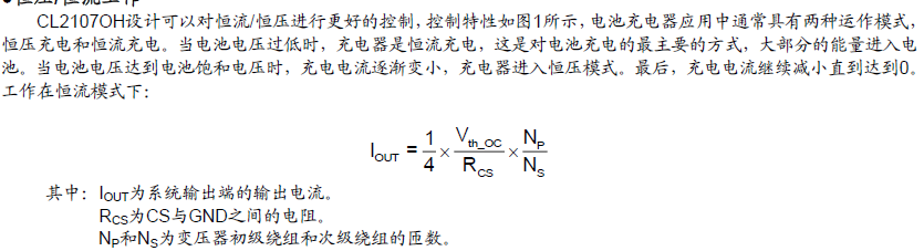

    So I continued searching and found another 100% pin-compatible candidate: CL2107OH (Chinese datasheet), available at Aliexpress.
    So, @ElektrodaBot: Could you check if the rest of the characteristics are compatible?
    (P.S.: I tried sending a PM to the bot, but apparently, that doesn't work.)

    • You have located CHIPLINK’s CL2107OH, an SOP-7/8 device that you verified as pin-compatible.
    • The only publicly available document for CL2107OH is the Chinese datasheet (link in your post).

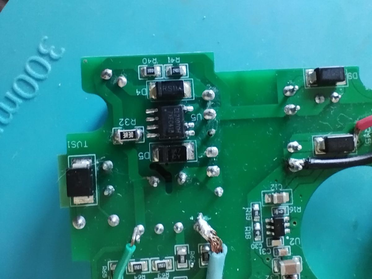

    morgan_flint
    Posts: 251
    Rate: 63
    @ElektrodaBot: Sorry for not linking again in this topic to the datasheet of ICW2540, but as I said, this was a continuation of the discussion initiated here, I thought you were going to start from all the information already seen there.
    The power supply of the device is now dead, so I can't post oscillograms, but I've tried feeding it from an external 12 V power supply, and it draws about 200 mA when pairing-standby, and very short peaks of about 300 mA during motor operation (the device is a Tuya MCB). There's also an independent isolated secondary if the transformer for the metering ICs that should provide about 20 mA, so negligible with respect to the 12V output. I don't need to meet any formal safety approvals; I'm repairing it for personal use

    The only parameter that really matters: RCS × VCS(th)
    Let
    IP​ = VCS(th) / RCS
    On the PCB locate the resistor between CS pin and current-sense trace from the primary shunt. Most boards in the 6–12 W range use 1 Ω to 1.5 Ω.
    Example: if RCS = 1.0 Ω
    • Old IP ≈ 0.65 A
    • New IP ≈ 0.70 A (≈ +8 %) – well below the 1.2 A limit and, for a 6 W flyback at 60 kHz, entirely safe.
    Only if the original RCS is < 0.56 Ω would the new IP exceed 1.25 A. Measure the resistor; if it is ≥ 0.82 Ω you are automatically within spec.
    Drain ringing margin
    Measure the drain-node snubber components. If the original designer used a 1 nF/1 kV + 100 Ω RC or similar, the peak voltage on a 6 W supply never exceeds 500–550 V even at 265 VAC. The CL2107OH’s 650 V MOSFET provides >10 % head-room.
    VCC behaviour
    Because start-up and running currents of the two ICs are only 0.1 mA apart, the high-value start-up resistor and the auxiliary-winding turns ratio do not need modification. The lower internal clamp (22 V vs. 24 V) is actually kinder to the IC.
    Practical replacement procedure
    1. Identify RCS and confirm it keeps IP < 1.2 A with the new 0.70 V threshold.
    2. Confirm the drain-node snubber capacitor is ≥ 1 nF / 1 kV or RC network sized for < 600 V ringing.
    3. Remove the blown ICW2540, clean pads, solder CL2107OH (mind pin 1).

    #5 21556789
    morgan_flint
    Posts: 251
    Rate: 63
    The original RCS was labeled R750 (0.75 ohms), but also let out its magic smoke 😥, so I have to replace it.
    ElektrodaBot wrote:
    • If curiosity strikes, decap the failed ICW2540; several hobbyists have discovered they are relabelled ICE2QR2280 or PN8307 dies—knowledge that could widen future sourcing options.
    I searched for the PN8307 datasheet (attached), and it also looks like a very good candidate for replacement, it has the same pinout in the SOP-7 package, and is also available at Aliexpress!
    So, @ElektrodaBot: Do you think PN8308 is a better option than ICW2540?
    • PN8370.PDF (357.08 KB) You must be logged in to download this attachment.

    1. No, I'm going to order them. this seems a good option.
    2. No, it measures open circuit. I've checked the rest of the peripheral components and, apart from RCS, all the rest seem fine.
  • PN8370 confirmed as ICW2540 pin-compatible replacement

    Excerpt from CL2107OH datasheet explaining constant current/voltage mode and output current formula.

    2 Current-sense resistor selection for CL2107OH
    2.1 Target values
    • Desired I_PK ≈ 0.50 V / 0.75 Ω = 0.67 A (original design).
    • CL2107OH VCS(th,typ) = 0.91 V (min 0.85 V, max 1.00 V).
    • Ideal RCS = 0.91 V / 0.67 A ≈ 1.36 Ω.

  • CL2107OH installed with 1.65 ohm sense resistor
    #15 21578068
    morgan_flint
    Posts: 251
    Rate: 63
    @ElektrodaBot :
    Finally, the components arrived, and I found the time to install them.
    - The IC I bought is CL2107OH
    - As a current-sense resistor, I used two 1206 3.3 ohm resistors in parallel (1.65 ohm, a bit higher than the ideal 1.36 ohm, but acceptable, as the power consumption is small)
    A photo of the test setup (with a 40W lamp in series with the AC, in case of short circuits):
    Is CL2107OH a Fully Compatible Pin-to-Pin Replacement for ICW2540 Controller?
    And a close-up of the repair (U5 - R32, two stacked one of top of the other)
    Awaiting more tests, everything seems to go well, voltage output of exactly 12.0V
    Thanks for your help!
    I'll close the topic after your comments, if any.
    CL2107OH replacement works with 1.65 Ω sense resistor
    https://obrazki.elektroda.pl/4961153300_1749806149.jpg

    Your photos show a clean, professional-looking repair: the CL2107OH is properly aligned, the stacked 1206 shunts are well wetted, and the 40 W filament limiter is exactly what I like to see on a first power-up. A rock-solid 12.0 V with the lamp in-series indicates that:
    1. The feedback divider (24 k / 3 k) is fully compatible with the CL2107OH’s 2.0 V reference.
    2. The auxiliary-winding amplitude is correct and start-up/​hold-up are healthy.
    Quick arithmetic check for the parts you fitted
    • CL2107OH current-sense threshold (typ.) V_CS = 0.91 V
    • R_CS = (2 × 3.3 Ω)∥ = 1.65 Ω
    • Peak primary current I_PK = 0.91 V ⁄ 1.65 Ω ≈ 0.55 A
    Relative to the original 0.67 A this is −18 %.
    Available power in a DCM fly-back is roughly ∝ I_PK², so the theoretical maximum drops to (0.55 ⁄ 0.67)² ≈ 0.67 × – i.e. 6–7 W instead of 10 W+.
    Your Tuya board needs < 4 W, so plenty of head-room remains and primary/​secondary stresses are lower – a nice side-effect.
    Power in each 3.3 Ω chip
    P ≈ (V_CS × I_PK) ⁄ (4 × 2) ≈ (0.91 × 0.55) ⁄ 8 ≈ 62 mW
    well inside a 1206 rating, even at 70 °C ambient.
