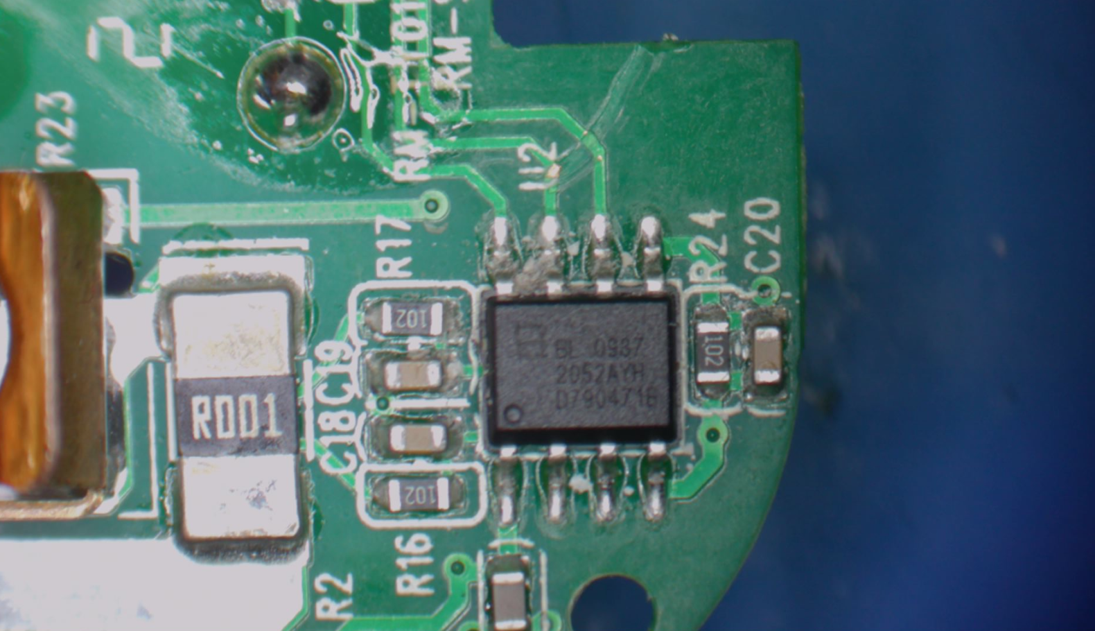

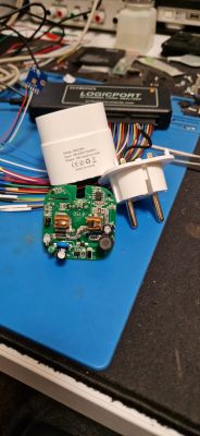

    Hello all,
    Device was brought to me disassembled and looks exactly the same as this one - https://www.elektroda.com/rtvforum/topic3945009.html
    Troubleshooting Smart Plug RMC004 w/ ZHU2114 Controller: Pinout & BL0937 Metering Info
    Interesting thing it is based on ZHU2114 controller, never seen this one before and google is not helping :)
    Troubleshooting Smart Plug RMC004 w/ ZHU2114 Controller: Pinout & BL0937 Metering Info Troubleshooting Smart Plug RMC004 w/ ZHU2114 Controller: Pinout & BL0937 Metering Info
    Pinout is the same as on BK72xx modules, no response from the flasher but there is some transmit going on when CEN is grounded. I'll have more info once I hook it up to some gear and post it here.
    It uses BL0937 for metering

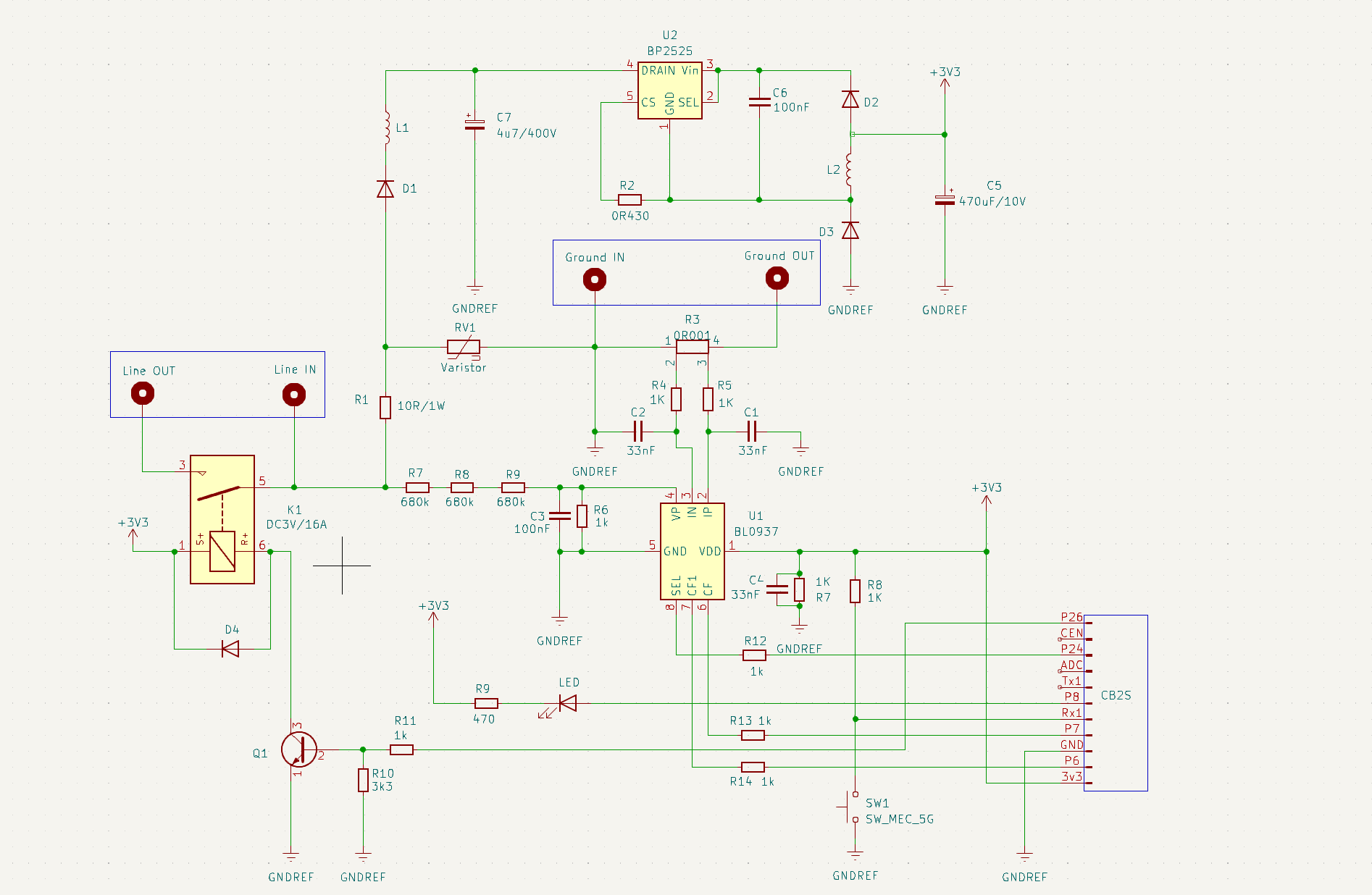

    EDIT: schematics added

    Hello... I have triple-checked the name ZHU2114 and it looks like just a Zigbee device, not a WiFi one.
    You will not be able to connect it to WiFi, unless you replace the module with something that works with WiFi.
    You can use this device with a Zigbee dongle and Home Assistant without changing the firmware.
