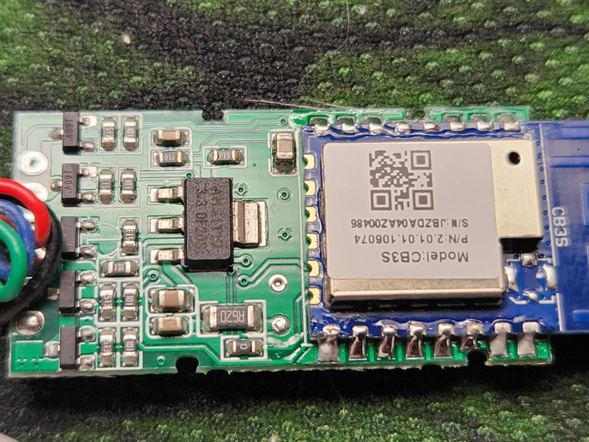

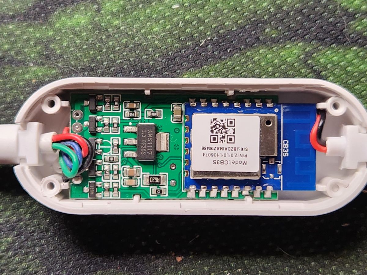

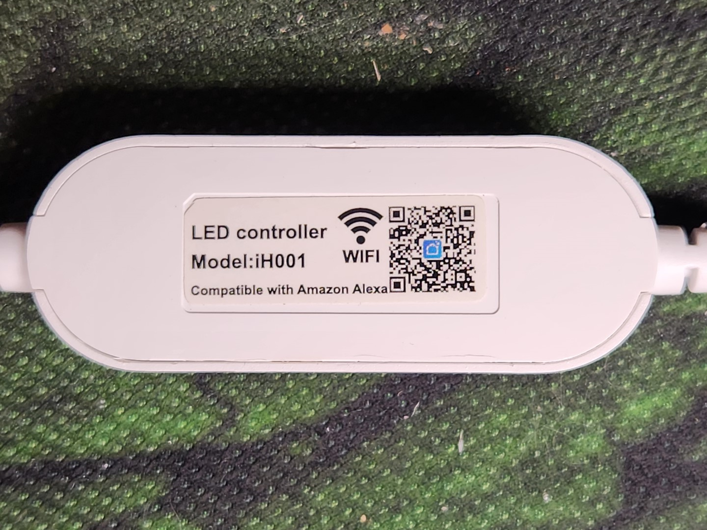

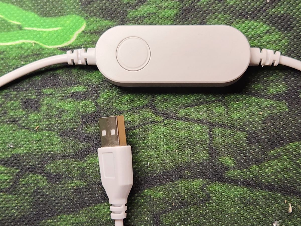

    I note that this device has been mentioned before but seemed to be unresolved Here, the one I am submitting appears to be a slightly different version of it, it may also go by a different device name apologies if it does I had a good look but couldn't find it.
    PCB with Tuya CB3S module inside a casing. A spool of LED strip with purple LEDs on, lying on a desk with a control button on the cable. LED strip wound on a spool with partially lit blue diodes and a connected cable, featuring a white controller with a button. Four-pin plug connector on a green surface. A white device with a button and USB cable, resting on a green mat. Close-up of a circuit board with a Tuya CB3S module and various electronic components. Green PCB with various electronic components and wires. White LED controller model iH001 with a label indicating compatibility with Amazon Alexa.
    Board: Tuya CB3S
    Pins:
    P8 PWM 0
    P9 Btn 0
    P24 PWM 1
    P26 PWM 2
    Template (Working with button as Colour Change Autoexec for on\off on hold)

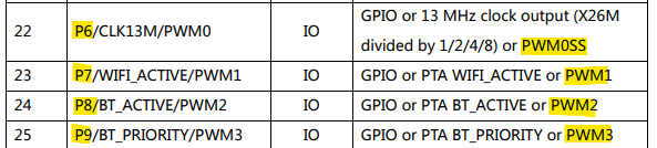

    Beken PWM numbering differs from OBK channel assignment

    are you sure PWM;0 though? I thought R=1, G=2, B=3, CW=4, 5=WW
    It's just on Beken only 6 pins can be used for PWM and they're referred to as PWM0-5 by Beken. But for OBK channel assignment it's 1-5

    EDIT: I can also see it has 5 transistors? So you can easily use it as RGBCW.
