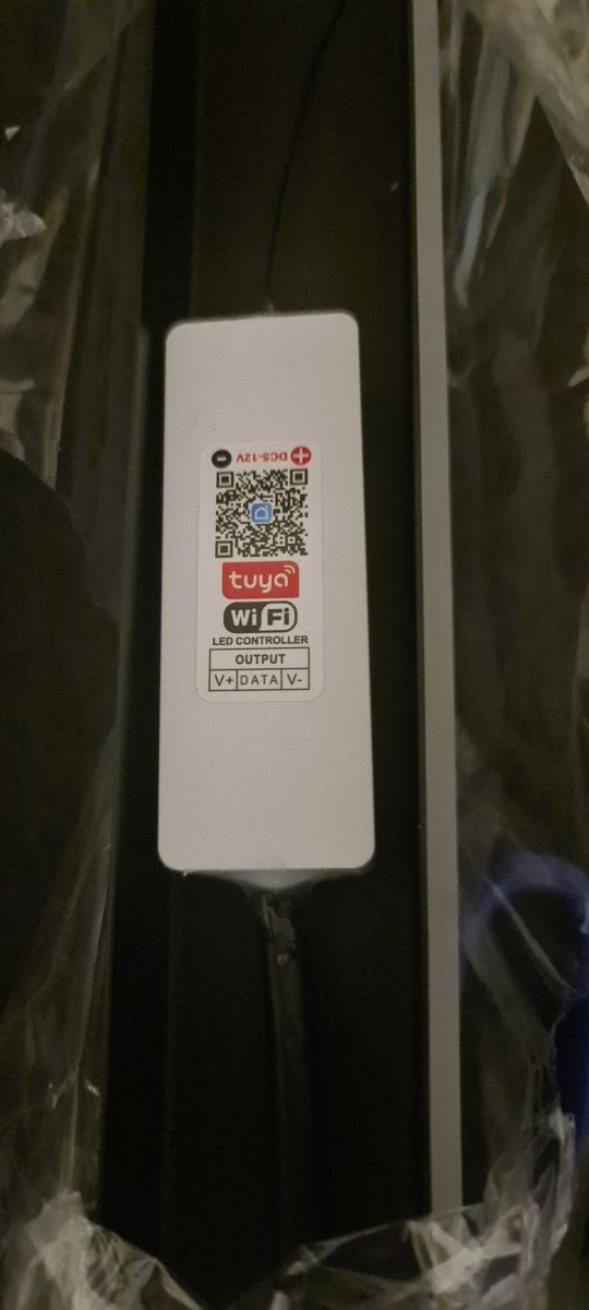

    Got this light from AliExpress:
    https://www.aliexpress.com/item/1005005338731...order_list.order_list_main.100.21ef1802s6ff4A
    It is a waterproof light and I really can't open and see the inside components. Plus, it is not that cheap and I don't want to ruin it.
    I am trying to see if I can use cloudcutter to flash BK7321 (which version?), if the required drivers are supported, and maybe some GPIO settings.
    The LEDs on the light can display different colors:
    The LEDs are controlled by this device:

    The information I have from the vendor is that they are "3535-96 beads, the lamp beads are 3535" - not sure if that helps or not.
    If it doesn't help, can someone help phrase my question to the vendor as I am not sure I am asking him the right way. What exactly should I ask him?

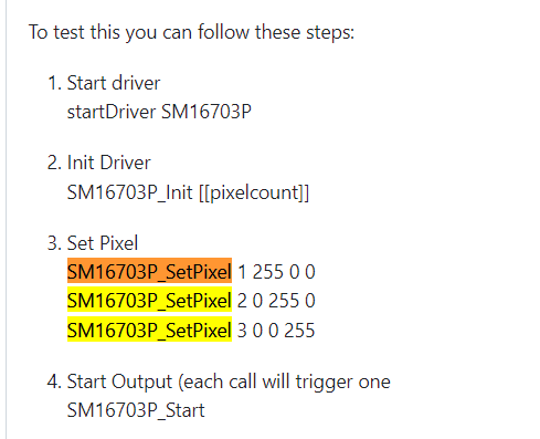

    If you want to experiment ,get latest build and try:
    1. Start driver
    startDriver SM16703P
    2. Init Driver
    SM16703P_Init [[pixelcount]]
    3. Set Pixel
    SM16703P_SetPixel 1 255 0 0
    SM16703P_SetPixel 2 0 255 0
    SM16703P_SetPixel 3 0 0 255
    4. Start Output (each call will trigger one
    SM16703P_Start
    I can't test it myself because I don't have this device... make sure you have Tuya firmware backup!

    On step 2 I get this error:
    Error:CMD:cmd SM16703P_Init NOT found (args [[pixelcount]])
    Unknown command

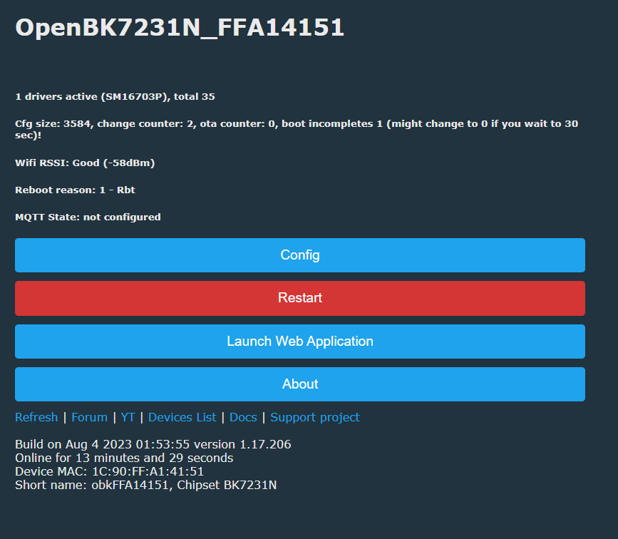

    I have received my test device today.
    According to the manufacturer, it uses SM16703. It also uses BK7231N.
    I added it to Tuya, and I got a cloud cutter supported firmware on it.
    I have added it to HA with LocalTuya and have got a list of dp_ids from the Tuya IoT site.
    As per my previous 2 devices, these are really sealed and weatherproof - so I have no chance in opening it without destroying it. And as I really don't want to kill it, I went ahead and uploaded 1.17.206 to it. Complete the upload and initial setup, and I have the device on my wifi now.
    I went ahead and ran the commands as instructed. I can see the driver loaded now:
    Web interface of the OpenBK7231N device with visible buttons and status information.
    But I am not seeing anything else in the menu (Toggle, dimming/rgb/temp options, etc.)
    What do you advise I should do next?
    Or if you need any logs or anything from me, please let me know.

    This is a good news, we can test finally that SM16703P driver from contributor.
    His comments says:
    Configuration instructions for SM16703P driver to control LEDs
    Please do steps from the image and let me know if anything lights up. Those commands show turn on 3 LEDs. There is no GUI for that yet. We can work on GUI once we know that at least LED communication is working.

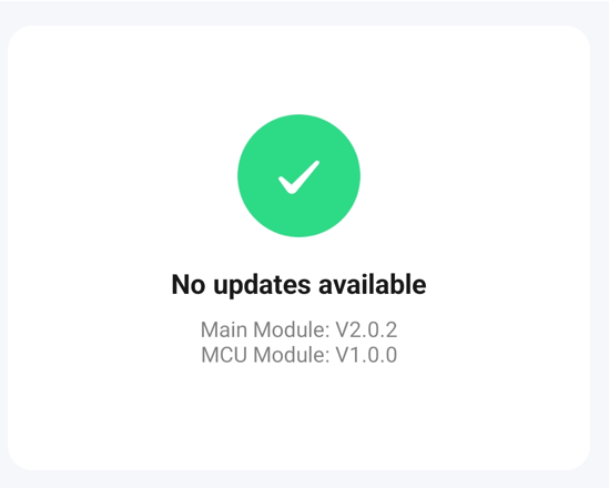

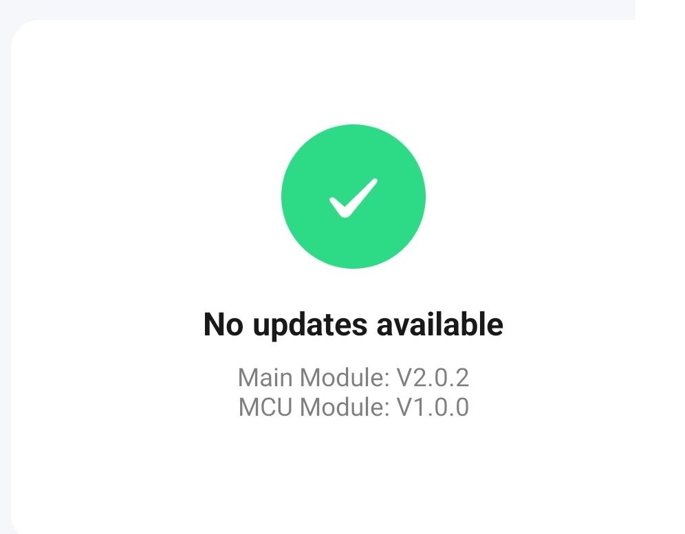

    The LEDs turn on and start flashing as soon as I turn the power on the device.
    In the attached video, I turn the power on and the LEDs blink, and then I turn the power off:
    This is what Tuya showed me in the app:
    Update message in the Tuya app indicating No updates available.

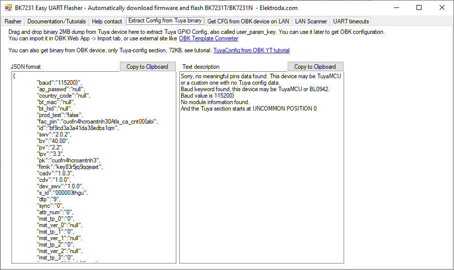

    Here is the Tuya Config partition:
    Thanks again for your help, I know you are very busy.
    Edit: The device is not in pairing mode. It is not broadcasting a WIFI AP. As mentioned, it has been flashed with BK7231N version 1.17.206

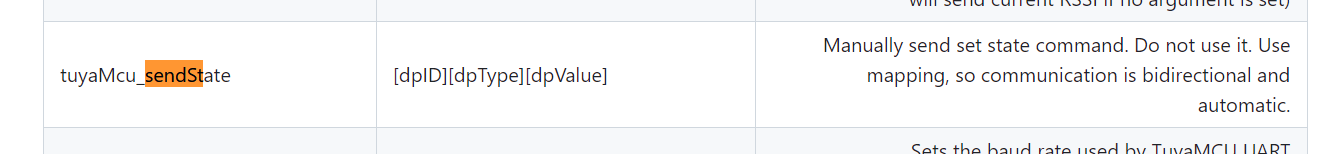

    The SM driver will not work for this device, as it's a TuyaMCU device.
    Your Tuya config even shows the baud rate:
    Screenshot of BK7231 Easy UART Flasher with a TuyaMCU device configuration in JSON format.
    The LEDs are blinking because MCU thinks it's in pairing mode. They will stop blinking as soon as you do:
    tuyaMcu_defWiFiState 4
    to tell MCU that is "paired and connected to the cloud".
    First of all, are you sure this device has individually addressable LEDs?

    Are you able to control this device with IR remote? I saw something like that mentioned in previous posts.
    If so, do a methodical test of changing, let's say, first colors, and copy the log from the Web App, and write down what each packet does. Something like:
    Info:TuyaMCU:TUYAMCU received: ?? ??? ??? ??? <--- this sets RED
    Info:TuyaMCU:TUYAMCU received: ?? ??? ??? ??? <--- this sets BLUE
    etc, etc.
    Try to capture dpID 24, dpID 28, etc, and always make sure to write down which particular TUYAMCU event does.
    I haven't seen yet an individually addressable LEDs with TuyaMCU, but they should be supportable.
    We could also use this command to manually send packets from OBK to the MCU to check what is working:
    A fragment of a documentation table showing the tuyaMcu_sendState command highlighted in orange.
    but first we need to know what to send.
  • #30 20685661
    MnM1
    Posts: 175
    Rate: 13
    While I can control the device with the remote, it doesn't show anything in the logs.
    I can only see
    Info:TuyaMCU:TUYAMCU received: 55 AA 03 00 00 01 01 04
    Info:TuyaMCU:TuyaMCU_ProcessIncoming[ver=3]: processing command 0 (Heartbeat) with 8 bytes
    Info:TuyaMCU:TUYAMCU received: 55 AA 03 03 00 00 05
    Info:TuyaMCU:TuyaMCU_ProcessIncoming[ver=3]: processing command 3 (WiFiState) with 7 bytes
    When I press the OFF button
    Info:TuyaMCU:TUYAMCU received: 55 AA 03 07 00 05 14 01 00 01 00 24
    Info:TuyaMCU:TuyaMCU_ProcessIncoming[ver=3]: processing command 7 (State) with 12 bytes
    Info:TuyaMCU:TuyaMCU_ParseStateMessage: processing dpId 20, dataType 1-DP_TYPE_BOOL and 1 data bytes
    Info:TuyaMCU:TuyaMCU_ParseStateMessage: raw data 1 byte:
    Info:GEN:CHANNEL_Set channel 20 has changed to 0 (flags 0)
    Info:MQTT:Channel has changed! Publishing 0 to channel 20
    And when I press the ON button
    Info:TuyaMCU:TUYAMCU received: 55 AA 03 07 00 05 14 01 00 01 01 25
    Info:GEN:CHANNEL_Set channel 20 has changed to 1 (flags 0)
    Info:MQTT:Channel has changed! Publishing 1 to channel 20
    I can't see anything else in the logs (I have all features selected including IR)
