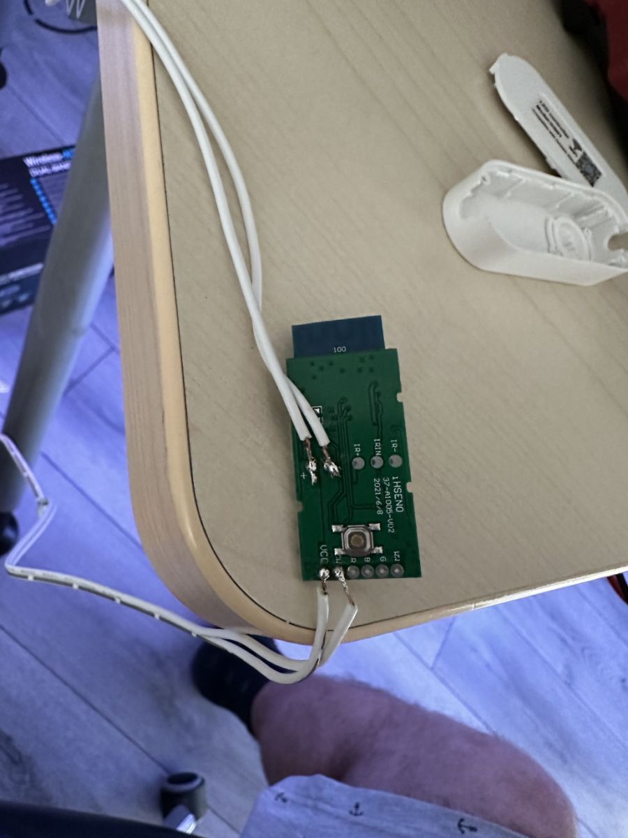

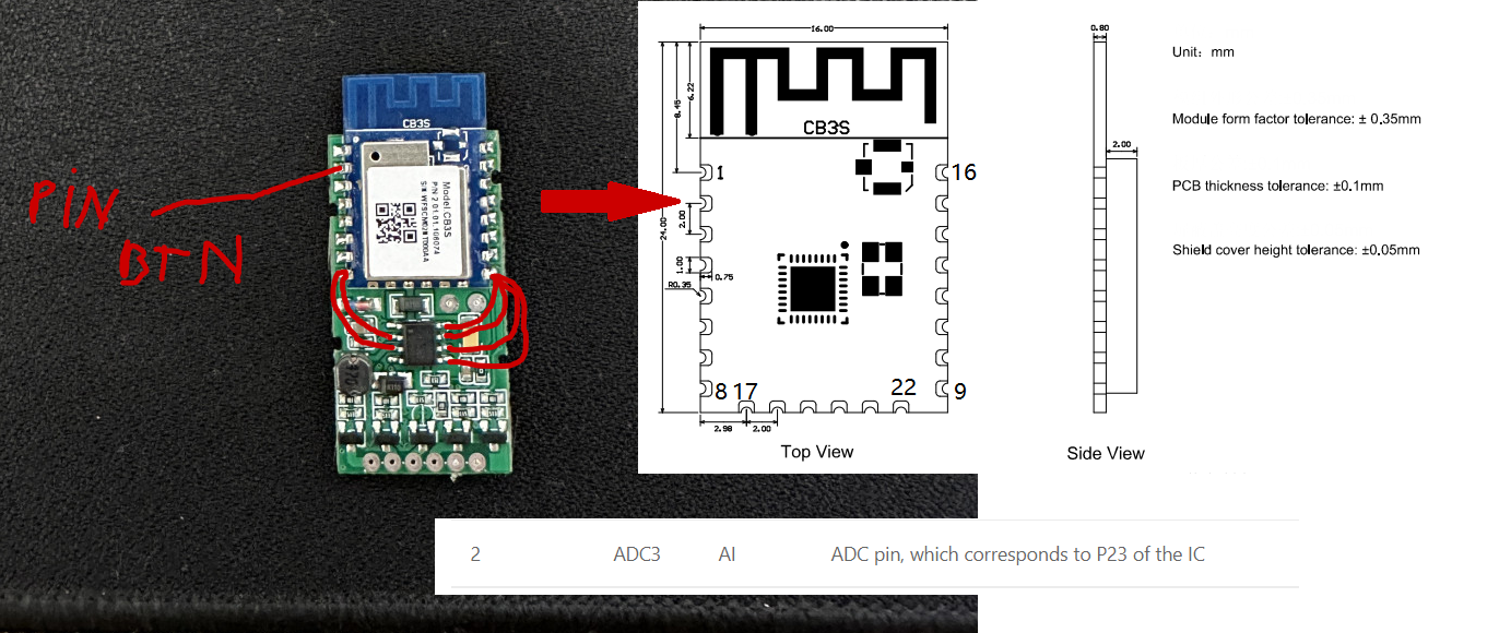

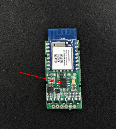

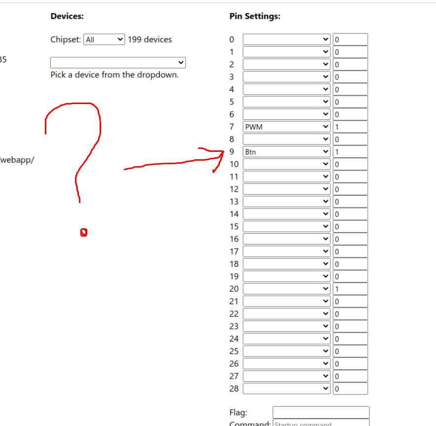

    Hello ,
    I am trying to configure PIN on a Led Controller Single Color with CB3S chip, anyone cand help me with this?
    https://github.com/tuya-cloudcutter/tuya-clou...eneric-ih001-led-controller-single-color.json
    [BK7231N / CB3S] Tuya Generic ih001 Led Controller Single Color
    What i find is with PIN 7 as PWM brightness increase or decrease but i dont know what pin is for on or OFF only this i need.
    This is what i find until now with pin 7 and 9 when i press on Button and TuyaMCu driver start.
    Thanks

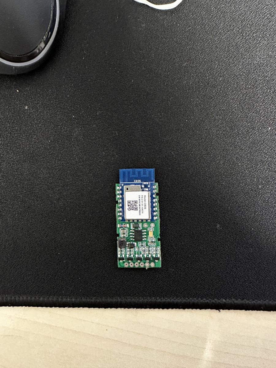

    Hello, what is the marking on this chip:
    Why do you think it's a TuyaMCU?
    Do you have a multimeter?

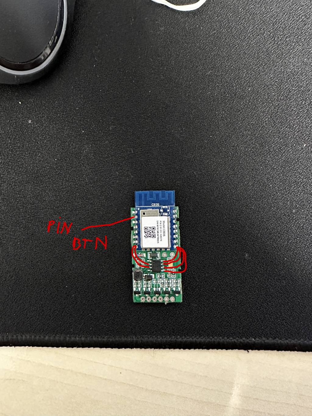

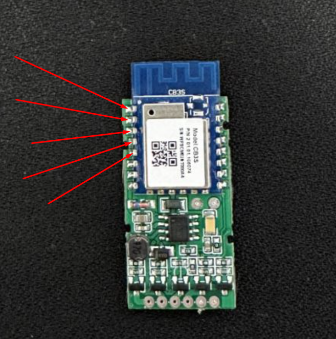

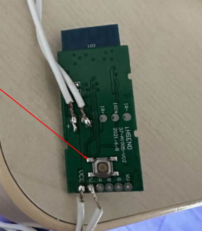

  • Identify the button pin on CB3S with continuity test
    #4 20370488
    Posts: 14727
    Rate: 12814
    XL1509 is not a Tuya MCU. It's a step down converter. It only powers your device. It converts 5V or 12V (depending on your device) to 3.3V for BK7231.
    Please:
    1. take your multimeter
    2. set the continuity test mode so it beeps when probes are shorted
    3. put one probe here:
    4. with other probe, check each CB3S pin:
    5. check all of those pins from CB3S, at which one do you get a "beep" ? Which is connected to button?

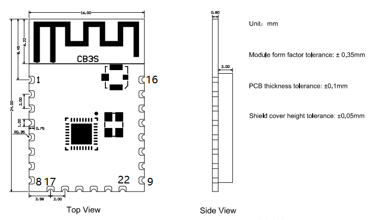

    Pin numberSymbolI/O typeFunction
    1RSTILow-level reset, high level active (the pin has been pulled high internally), correspond to CEN of the IC
    2ADC3AIADC pin, which corresponds to P23 of the IC
    3CENIEnabling pin, which is pulled high internally to be compatible with other modules
    4P14I/OA common GPIO interface, which corresponds to P14 of the IC
    5P26I/OGPIOP_26, which corresponds to P26 of the IC, PWM 5
    6P24I/OGPIOP_24, which corresponds to P24 of the IC, PWM 4
    7P6I/OGPIOP_6, which corresponds to P6 of the IC, PWM 0
    8VCCPPower supply pin (3.3V)
    9GNDPPower supply reference ground
    10P9I/OGPIOP_9, which corresponds to P9 of the IC, PWM 3
    11TXD2I/OUART2_TXD (used to display the module internal information), which corresponds to P0 of the IC
    12CSNI/OProduction test control pin. If it is used as a common I/O pin, it must be connected to the VCC externally. Do not connect it to the ground before the module is powered on.
    13P8I/OGPIOP_8, which corresponds to P8 of the IC, PWM 2
    14P7I/OGPIOP_7, which corresponds to P7 of the IC, PWM 1
    15RXD1I/OUART1_RXD (user serial interface), which corresponds to P10 of the IC. Do not connect it to the VCC. By default, the MCU serial port should be in low-level or high-impedance state.
    16TXD1I/OUART1_TXD (user serial interface), which corresponds to P11 of the IC. Do not connect it to the VCC. By default, the MCU serial port should be in low-level or high-impedance state.
    17ADC3AI(Not recommended. If needed, please use Pin 2) ADC port, which corresponds to P23 of the IC. Programmed SPI
    18P22I/O(Not recommended ) GPIOP_22, which corresponds to P22 of the IC. Programmed SPI
    19CSNI/OThe pull-up resistor is needed during usage of customers. Do not connect it to the ground before the module is powered on. Correspond to P21 of the IC.
    20P20I/O(Not recommended. ) GPIOP_20, which corresponds to P20 of the IC. Programmed SPI

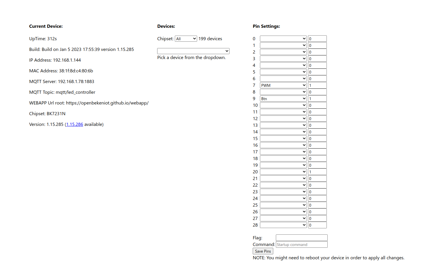

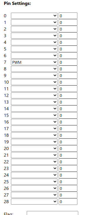

    Also please post a screenshot from OpenBeken WWW panel so I can make sure that everything else is ok.

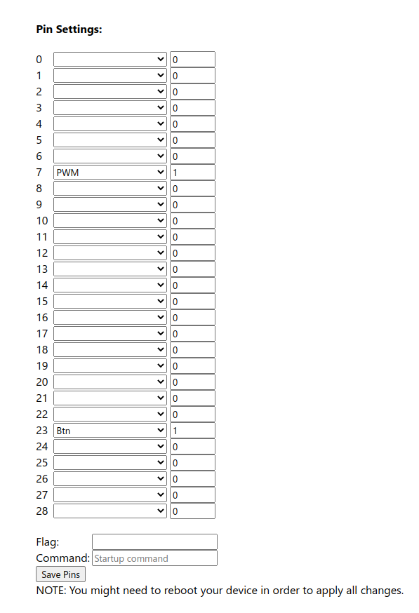

  • #5 20370498
    lionboy
    Posts: 69

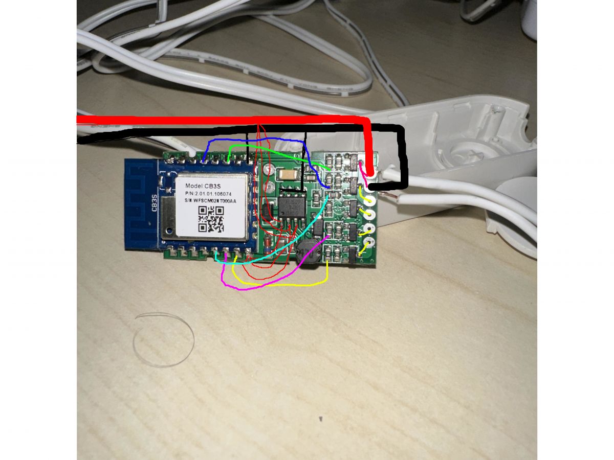

    This i find with multimeter:

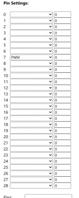

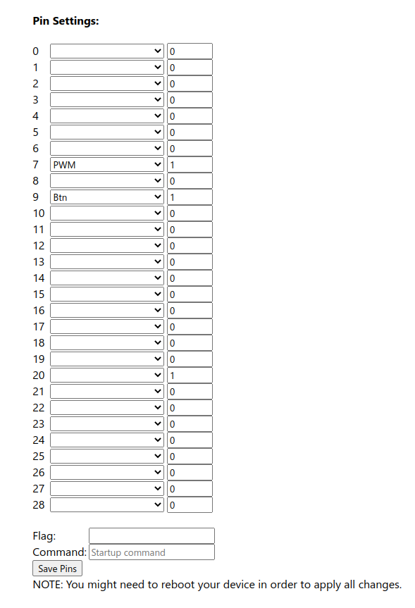

    Pictutes from www here:
    Thanks
  • #6 20370512
    Posts: 14727
    Rate: 12814

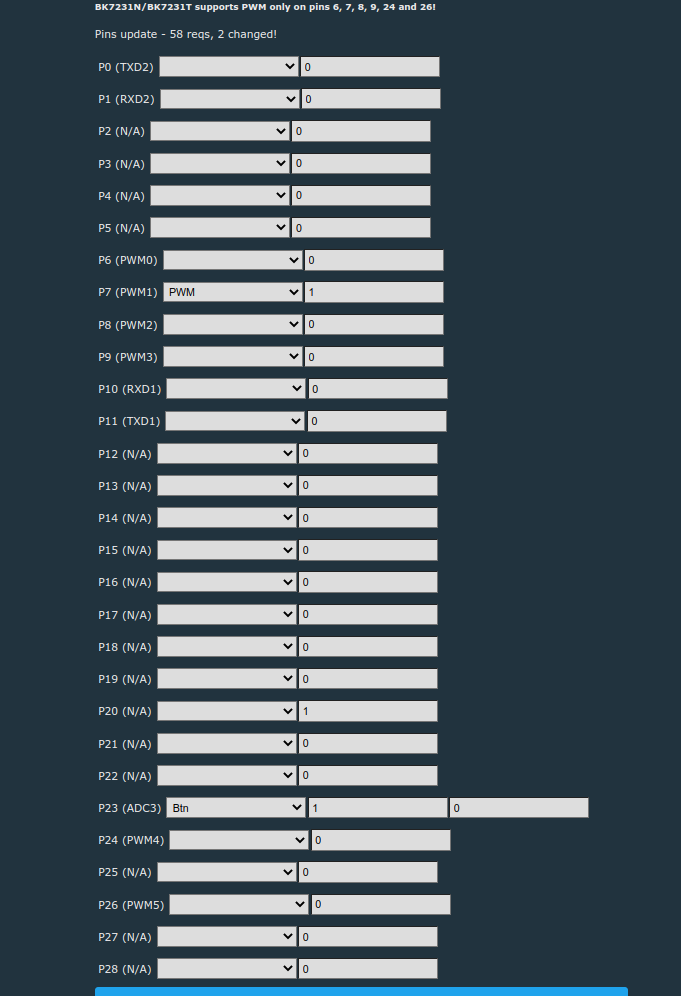

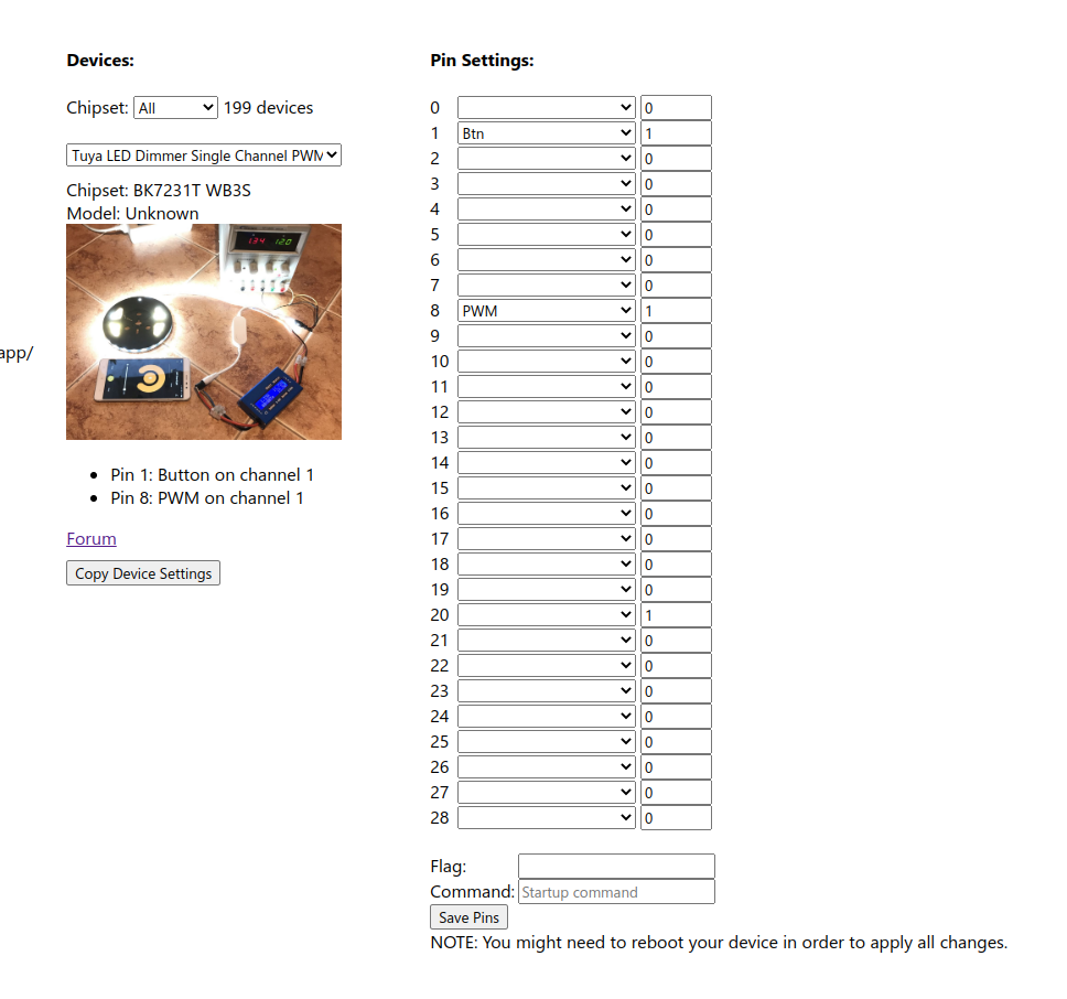

    Thank you, please see my image:
    Why do you have a "Btn" role on P9, while according to your test, Btn is on P23?
  • #7 20370541
    lionboy
    Posts: 69
    It was for testing that btn there, i will change like you say to see what happen
  • #8 20370546
    Posts: 14727
    Rate: 12814

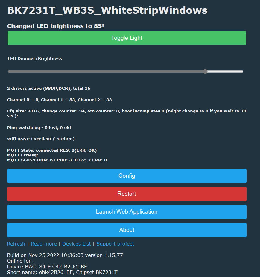

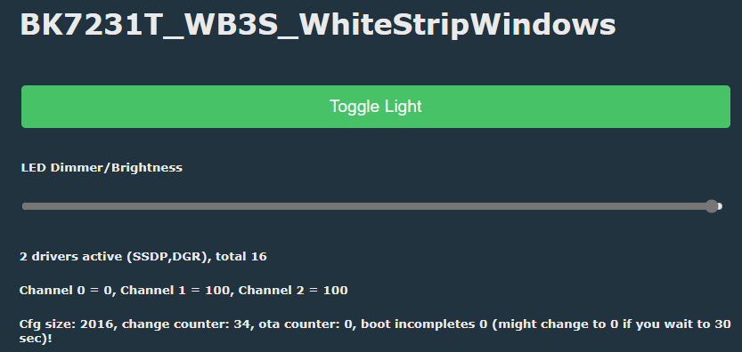

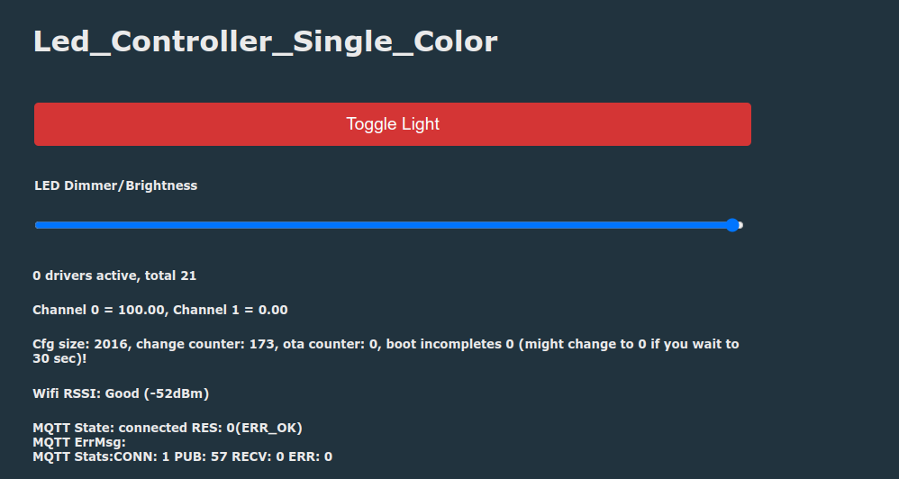

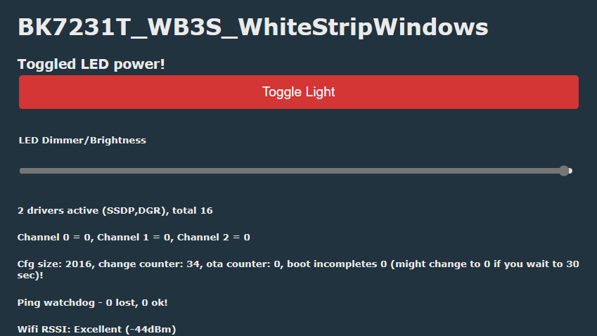

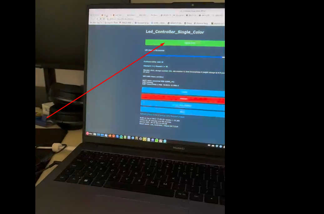

    Futhermore, is PWM pin a correct pin?
    Can you change LED brightness here, see screenshot from my LED strip device:
  • #9 20370717
    lionboy
    Posts: 69
    I dont know if pwm is correct, can you help me how to verify this?
    Thanks
  • #10 20370760
    Posts: 14727
    Rate: 12814
    Do you have a LED strip connected to check if dimming works?
    This is "single color" strip - right? - so it has 1 PWM.
    BK7231 has only 6 PWMs, so basically... you have 6 options to try.

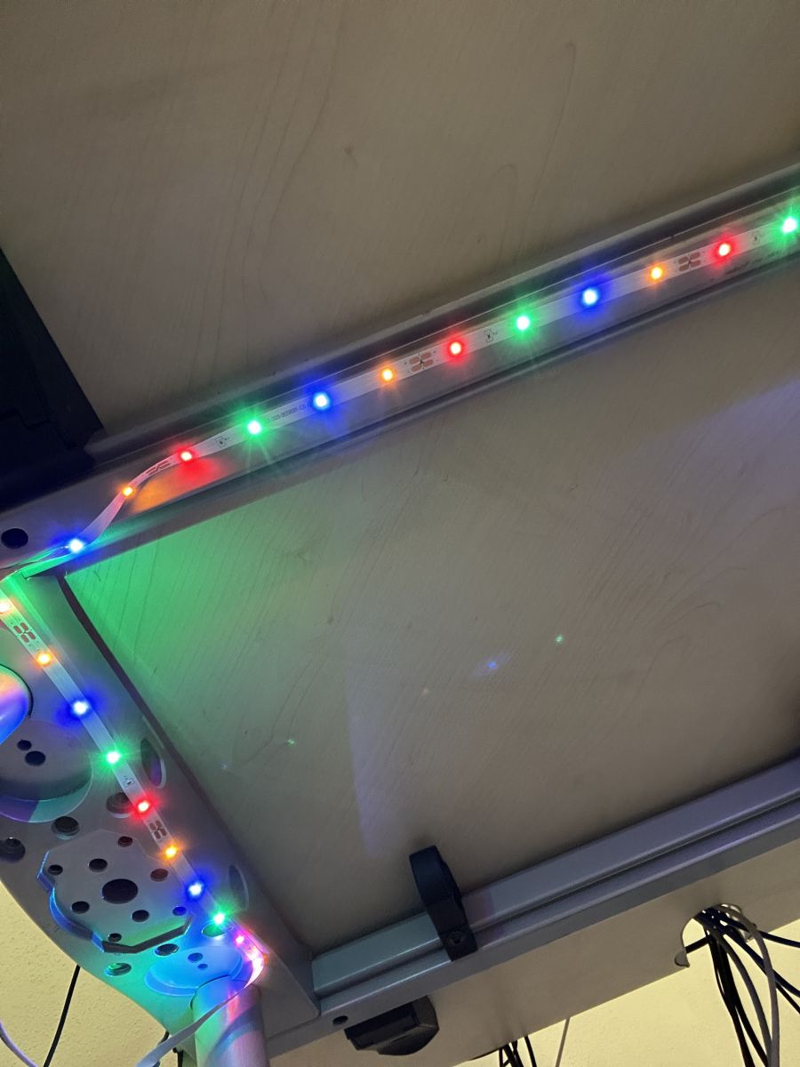

    lionboy wrote:
    Yes is single color but i saw at PIN 7 is some change on light but only when i toggle not on dimmer.
    This is very strange. Can you show a photo of your LED strip?
    Have you connected a normal LED strip to the controller or something else?
    How strip behaves with PWM state here, with dimmer?
  • Need to verify button and PWM pin mapping
    #13 20370892
    lionboy
    Posts: 69
    On 23 don't work like Btn, is very hard with this :D

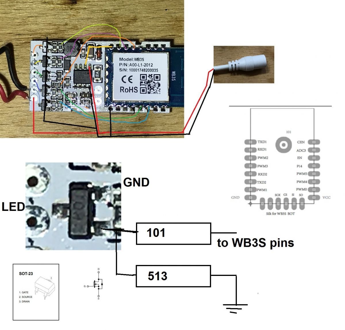

    Added after 7 [minutes]:
    now ADC Pin don't work with Btn and i don't know why, is not connected to AC , i need to connect and press Btn ?
    Added after 31 [minutes]:
    Is the same schema like this one only difference is WB3S and my CB3S but there are same PIN.
    I check all PIN now and all is like in this image
    Added after 6 [minutes]:
    I saw this is posted by you: https://www.elektroda.pl/rtvforum/topic3798114.html
    can you show me your configuration for PIN? Because is same like my only chip is CB3S
    Thanks
    Is the same strip who i controlled from Tuya App i didn't change, i will try with another to see if work, i have one more but is RGB :D
    I don't understand why can't use on/off because on Tuya work normal

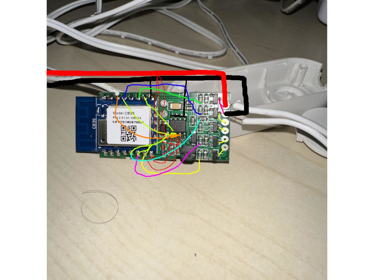

    Last image with PIN, from BTN i don't find any of them
    One more image:

    Hello @lionboy, can you clarify - do I understand correct:
    The clickable button on web page works OK:
    but physical button on device doesn't work:
    Do I understand correctly?
  • #16 20378775
    lionboy
    Posts: 69
    Click on web only change a little bit brightness but btn from device don't work. What i want only to on or off from home assistant i don't want btn to work.
    Thanks

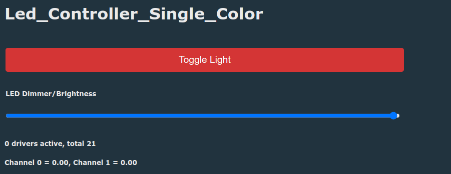

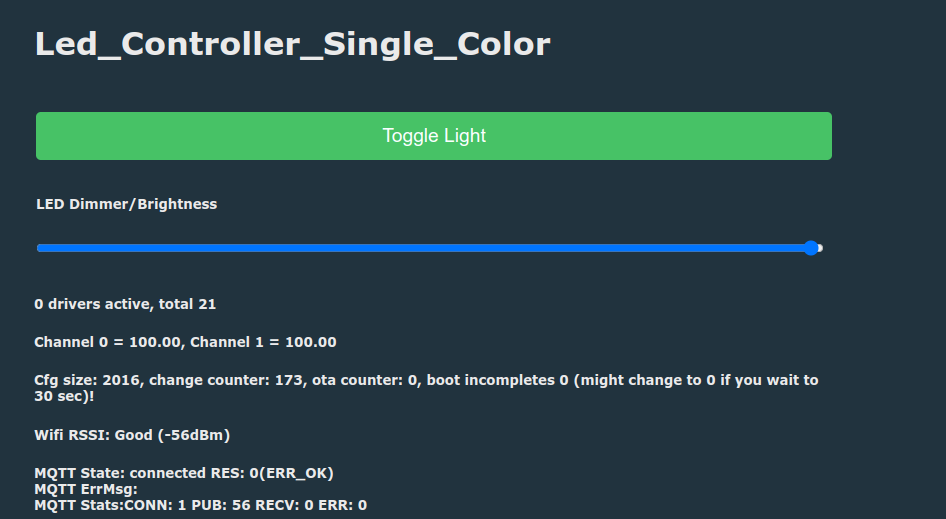

  • Requesting screenshots of off and on channel states
    #17 20378780
    Posts: 14727
    Rate: 12814
    With green button and brightness to the right, it should be 100% brightness:
    With red button, it should be off:
    With red button, you should have zeroes here:
    Channel 0 = 0, Channel 1 = 0, Channel 2 = 0
    Can you show how it looks like for you?
    I need two screenshots - 1. with red button (off state), 2. with green button (on state)

  • Web control should toggle full 0–100% brightness
    #19 20378813
    Posts: 14727
    Rate: 12814
    Click on web page should turn off and on the device. It should be possible to set 100% brightness and 0 % brightness.
    If for you, click on web page only changes a little bit brightness, then issue is somewhere else - maybe wrong PWM or wrong wiring or something else strange.
    Even without physical button on the device, you should have 0% to 100% brightness control. From no light to full light.

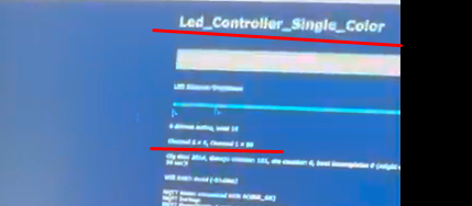

  • #20 20378848
    lionboy
    Posts: 69
    You can see in this video what do when press and change brightness:
  • #21 20378858
    Posts: 14727
    Rate: 12814
    If that's a single color strip, then why do you have two channels?
  • #22 20378879
    lionboy
    Posts: 69
    Btn was on channel 1 and Pin 7 PWM is on same channel 1. Is wrong with this?. Tomorrow i will tell someone to plug this controller and then i can acces via VPN to send image with configuration

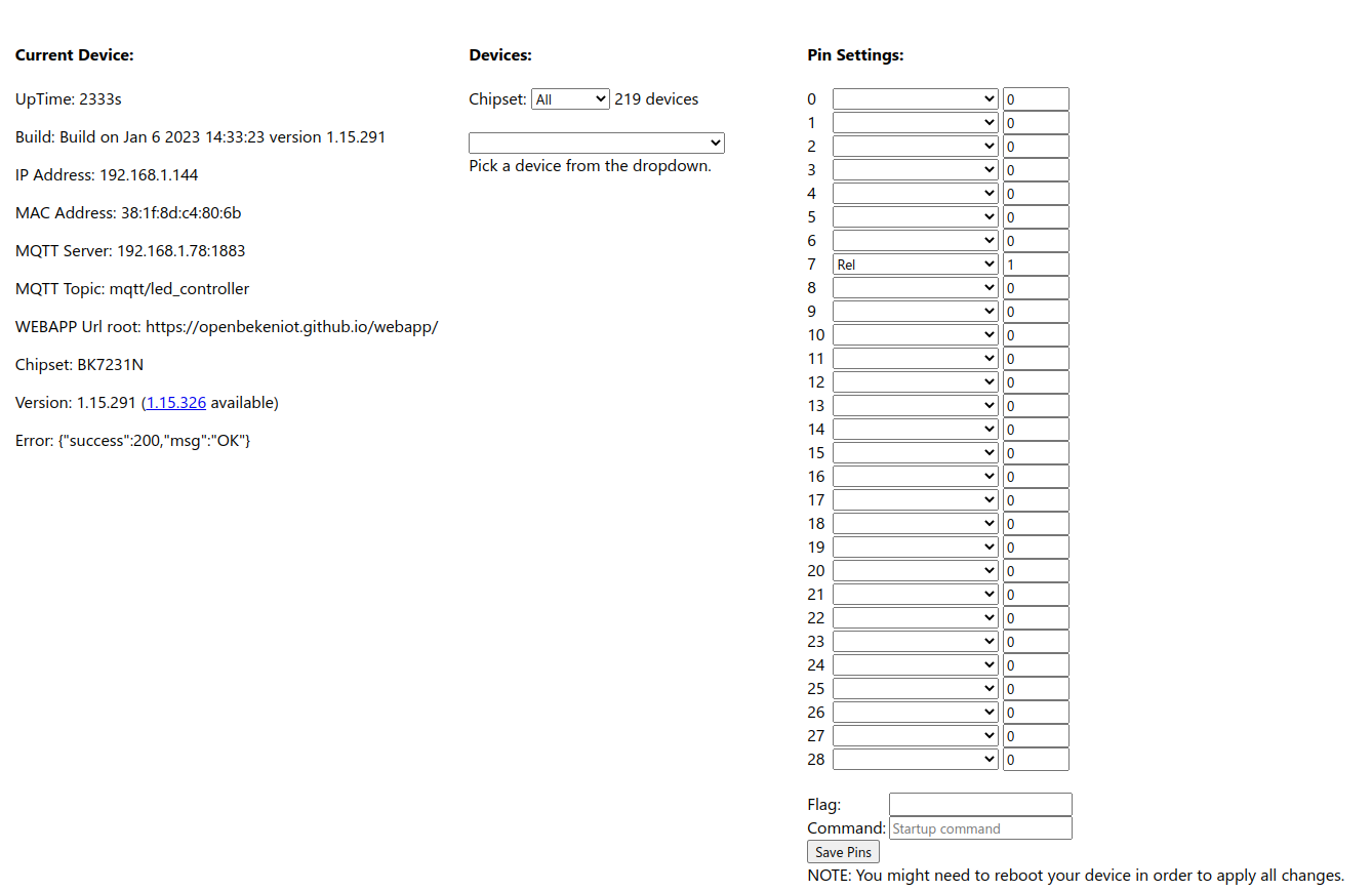

  • #23 20380166
    Posts: 14727
    Rate: 12814
    So at the moment it seems that your description of the problem was not entirely correct.
    You have a PWM issue. A very strange one, i must admit.
    If you change PWM role to relay, does setting that channel OFF turns off the light and ON turns on the lights?

  • Need screenshots of off and on driver states
    #25 20386266
    lionboy
    Posts: 69
    I saw at you have 2 driver start, at me i don't have any driver start.
    I will give you the imeage or a video with this settings today.
    This is as Relay on PIN7:
    Thanks
  • #26 20386294
    Posts: 14727
    Rate: 12814
    Hello, SSDP and DGR drivers should not affect your issue.
    Maybe your LED strip is custom and uses two PWMs at once to control the strip, somehow?
  • CB3S suspected after PWM channel mismatch
    #27 20386318
    lionboy
    Posts: 69
    I will go to buy a white strip today at 12v to see if work with that
    What i don't understand why with Tuya App work normal on brightness and On/off and on Beken don't want
    Added after 51 [minutes]:
    Can you tell me why with PIN 7 on PWM and chn 0 i have 2 channel? maybe there are a problem with channel at me ?
    Added after 3 [hours] 6 [minutes]:
    I was to buy a white normal led strip and is same problem, i think the CB3S is problem, i will try to solder a ESP32 because this don't want to work
