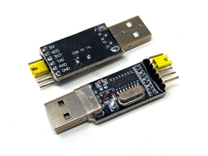

    My USB to TTL is the very common CH340.
    [la touko 24 07:51:33 2025] usb 1-6.1: new full-speed USB device number 10 using xhci_hcd
    [la touko 24 07:51:33 2025] usb 1-6.1: New USB device found, idVendor=1a86, idProduct=7523, bcdDevice= 2.54
    [la touko 24 07:51:33 2025] usb 1-6.1: New USB device strings: Mfr=0, Product=2, SerialNumber=0
    [la touko 24 07:51:33 2025] usb 1-6.1: Product: USB2.0-Ser!
    [la touko 24 07:51:33 2025] ch341 1-6.1:1.0: ch341-uart converter detected
    [la touko 24 07:51:33 2025] ch341-uart ttyUSB0: break control not supported, using simulated break
    Two USB to TTL adapters with pin headers and USB type A connectors.

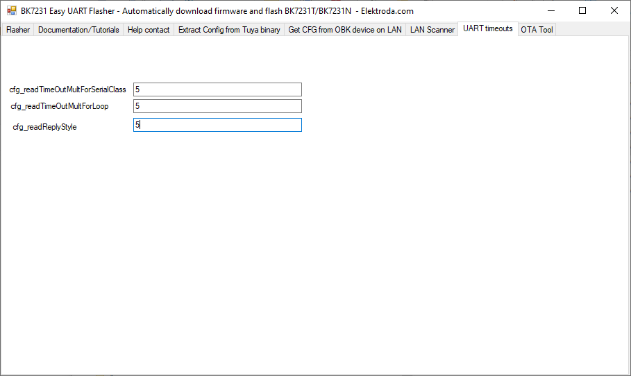

    It's a known issue. I would love to get some help with troubleshooting that. I've added "UART Timeouts" tab some time ago, maybe you can try changing them...
  • cfg_readReplyStyle 5 fixes BK7231N read on Arch Linux
    #3 21570597
    iotRL
    Thanks for the tip, changing cfg_readReplyStyle from 0 (default) to 5 made the read function work instantly.

    I don't know what cfg_readReplyStyle does in specific, but setting it to 5 with speed 921600 works fine on my hardware.
    edit: cfg_readTimeOutMultiForSerialClass and cfg_readTimeOutMultiForLoop were both default at 5 the whole time.

    I see, thank you for testing. So you're saying that it should be set to 5 by default?
    @divadiow does the flasher works on for you on Windows with it set to 5?

    I've checked source code and cfg_readReplyStyle is used as bool. So it's either 0 or non-zero. So there is no difference between 1 and 5.
