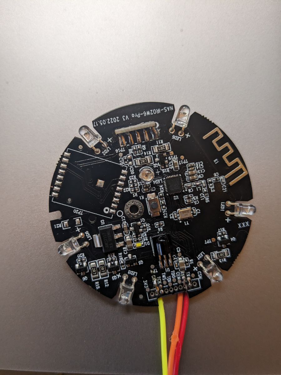

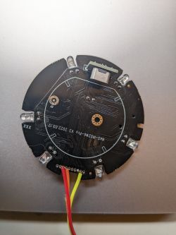

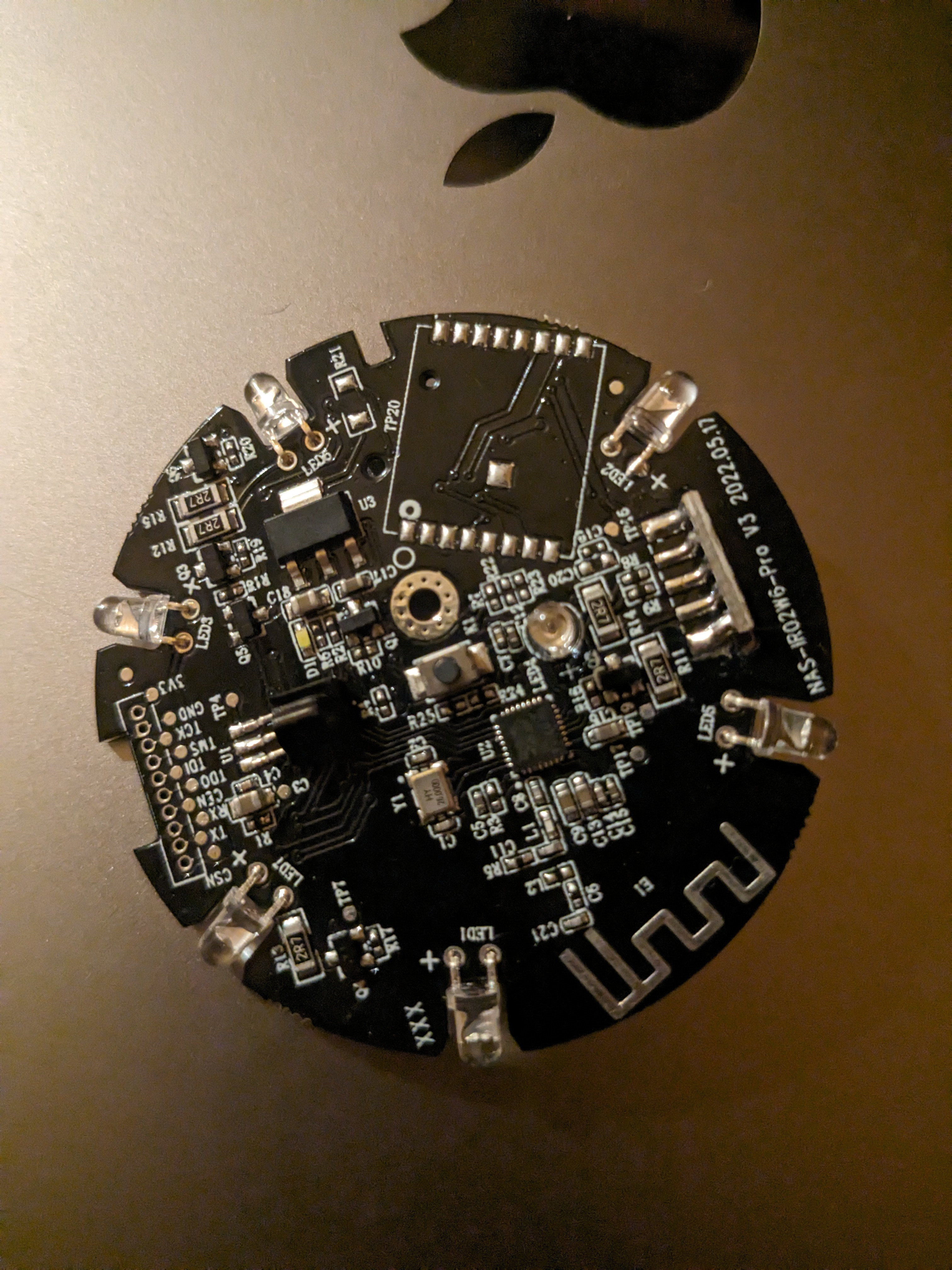

    Hello, can you provide a more detailed photo of the device? Are TX/RX lines used in any way in this device, maybe for a button or for TuyaMCU?
  • #3 20657734
    callipejian
    Posts: 8
    Here are the photos Unable to Get Bus Message: Flashing NAS-IR02W6-PRO V3 on Linux Using Mono and HID Tool Unable to Get Bus Message: Flashing NAS-IR02W6-PRO V3 on Linux Using Mono and HID Tool
    I am not sure if rx/tx lines are used in any way.

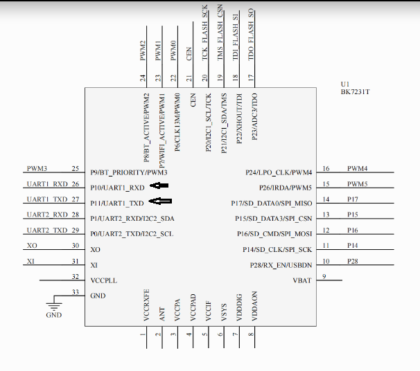

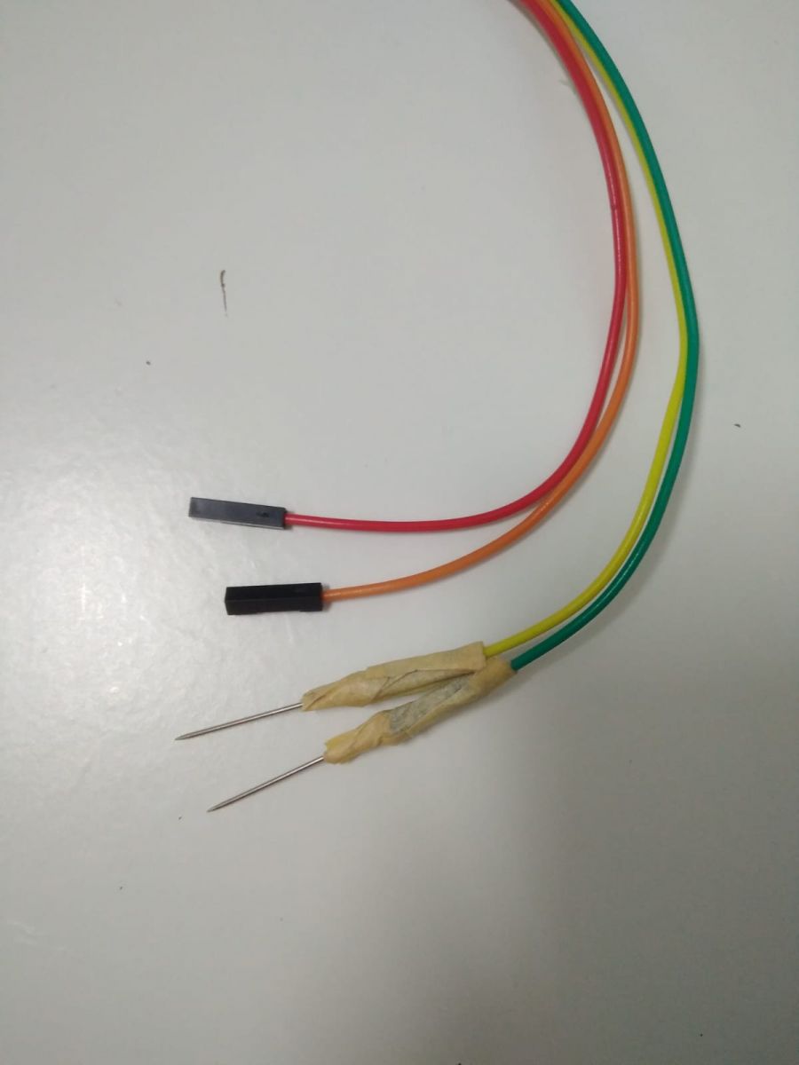

  • Direct chip contact on BK7231N UART pins
    #14 20668374
    spin55
    Posts: 209
    Help: 17
    Rate: 42
    Hi,
    Locate pins 26 and 27 of the BK7231N.
    Take two pins, cut off their heads and insert them into the Rx and Tx connections of the Dupont cables of the USB converter.
    Click directly on the chip terminals and test. You can hold both with one hand and with the other don't forget to short CEN to ground quickly. If it fails, keep trying.
    Greetings
