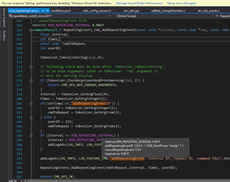

    addChangeHandler Channel1 == 1 addRepeatingEvent 1 1 setChannel 1 0
    waitFor WiFiState 4
    Power2 1
    Is that beep shorter possible?

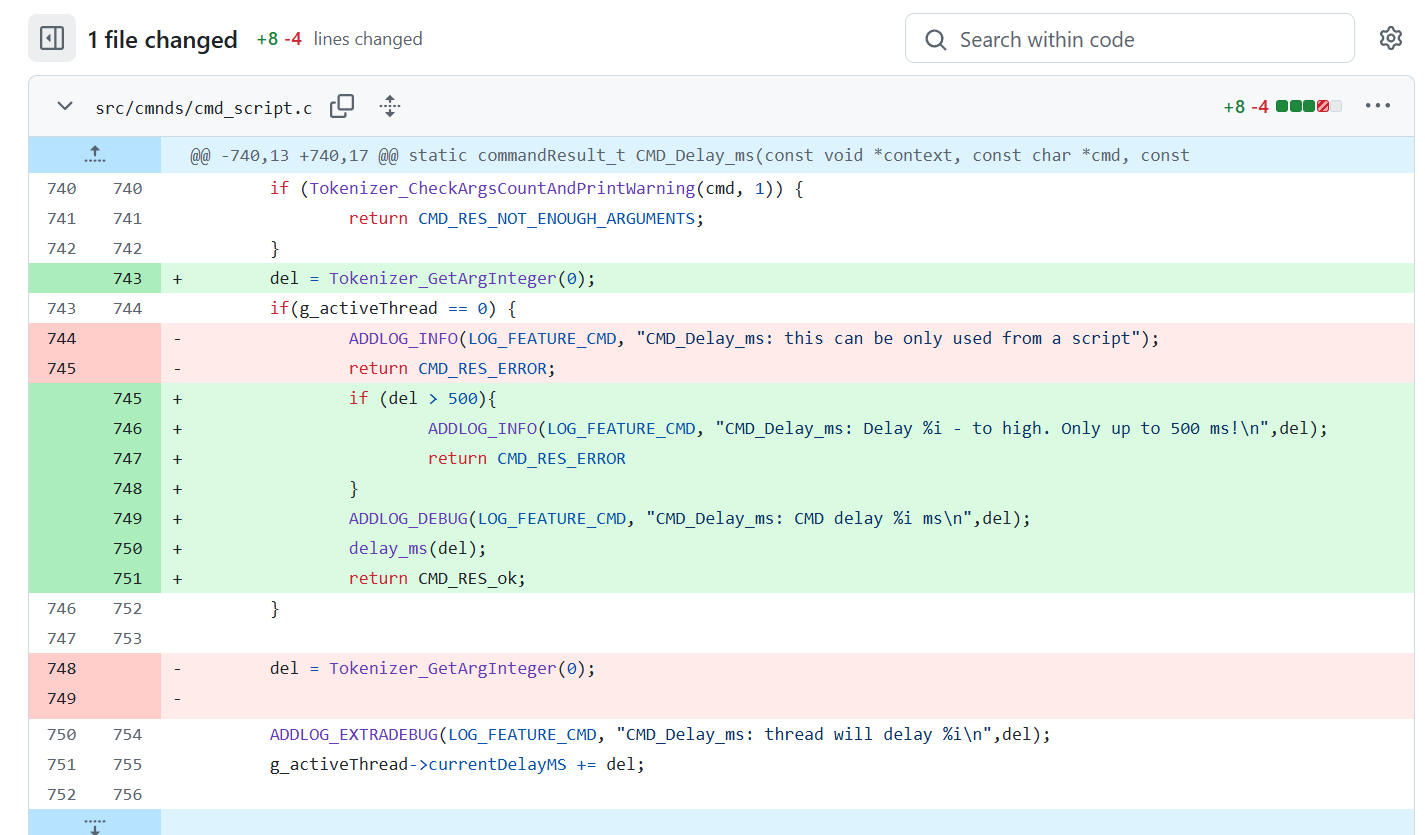

    I tried to implement this micro second delay "delay_ms".
    I limited it to 500ms, not knowing, if this "waiting" might have side effects.
    If you have an git account, you can try to download the "artifact" for your device here:
    https://github.com/MaxineMuster/OpenBK7231T_App/actions/runs/15739205979
    Else I can upload the version for you so you can test.
    For now I only tested this on an ESP32:

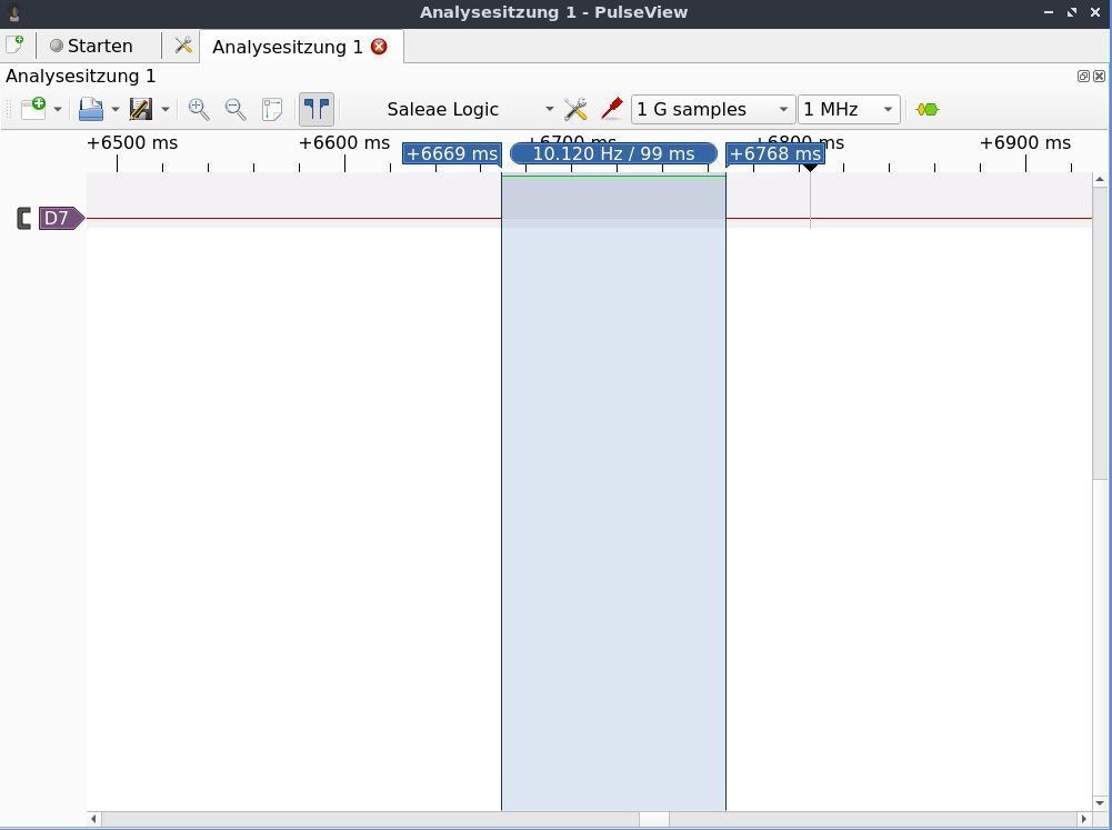

    alias buzz backlog setPinRole 15 AlwaysHigh; delay_ms 100; setPinRole 15 AlwaysLow
    Then command "buzz" looks promising:

    Hmm, interesting hack:
    WiFiState Command States and Short Beep Automation in OpenBK7231 Autoexec Script
    I would personally just clamp the number to 500 instead of skipping...
    Well, it can certainly work, however... when ran from, for example, a repeating event or change handler, doesn't it break whole main thread for 500ms?

    Maybe we could just convert backlog string to script file (scriptFile_t) by replacing ; with newlines.
    Will this work with an "alias", too?
    While thinking about this, I only tested alias use, not in command only.
    But why should anyone do a "delay" outside an alias or "backlog"??
    O.k., let's try:
    Info:MAIN:Time 520, idle 0/s, free 4287600, MQTT 0(32), bWifi 1, secondsWithNoPing 451, socks 2/21
    Info:MAIN:Time 521, idle 0/s, free 4287768, MQTT 0(32), bWifi 1, secondsWithNoPing 452, socks 2/21

    Hacky backlog delay_ms support added
    #11 21583288
    Posts: 14756
    Rate: 12883
    I think we have separate "every second" thread, separate "quick tick" thread, and we also have separate threads calling change handlers, and they all can contain delay_ms in backlog...
    Added after 1 [hours] 30 [minutes]:
    backlog delay support has been added to relaese, however it's a very hacky way:
    https://github.com/openshwprojects/OpenBK7231...mmit/716cd7b87cdd81727f58dd7f1cbb671606236106
    I just check backlog string for delay_s /delay_ms, and if found, i treat it as script (replace ; with newlines)
    If you want, you can check this out, but it should work good enough, as I covered it with Windows self tests.

  • #13 21584205
    Posts: 14756
    Rate: 12883
    Interval can be lower than 1. Here's related code snippet:
  • #14 21584498
    150219v8
    Posts: 46
    Ok, you show me the description how a cow produces milk. But how can I get it out? 😂😂😂
    How is the syntax for repeat 50ms?
    #15 21584579
    Posts: 14756
    Rate: 12883
    Well, I've checked the code to make sure that fractional parts are enabled. It seems they are, so if 1 second works, then try 0.05 for 50ms.
  • #16 21584670
    150219v8
    Posts: 46
    I checked it, and it works.
    addChangeHandler Channel1 == 1 addRepeatingEvent 0.05 1 setChannel 1 0
    This released the port after 50ms when it has turned on.
    Thanks
