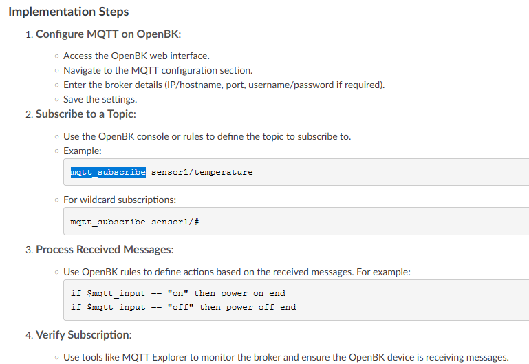

    #8 21438523
    jkwim
    Posts: 186
    Rate: 25
    Has there been any feature added for this?
    The requirement is to send a message to MQTT broker with SUBSCRIBE TOPIC and assign to a variable.
    Eg:
    If another sensor device periodically sends a MQTT message in the format say
    devicename/topic/temperature 100
    then by sending a message like
    SUBSCRIBE devicename/topic/temperature
    to MQTT broker,
    the MQTT broker will forward all
    messages to current device.
    The SUBSCRIBE command should also allow the received value to be assigned to a variable say "temperature".
    Then whenever the MQTT message is received its value will be updated in the variable "temperature".
    Added after 9 [minutes]:
    AI Tool gives me following answer.
    However I do not find such command in OpenBK commands list.
    Instructions for configuring MQTT on OpenBK with a subscription command.
