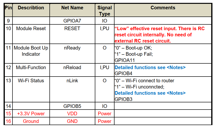

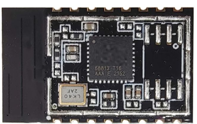

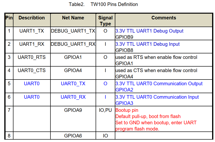

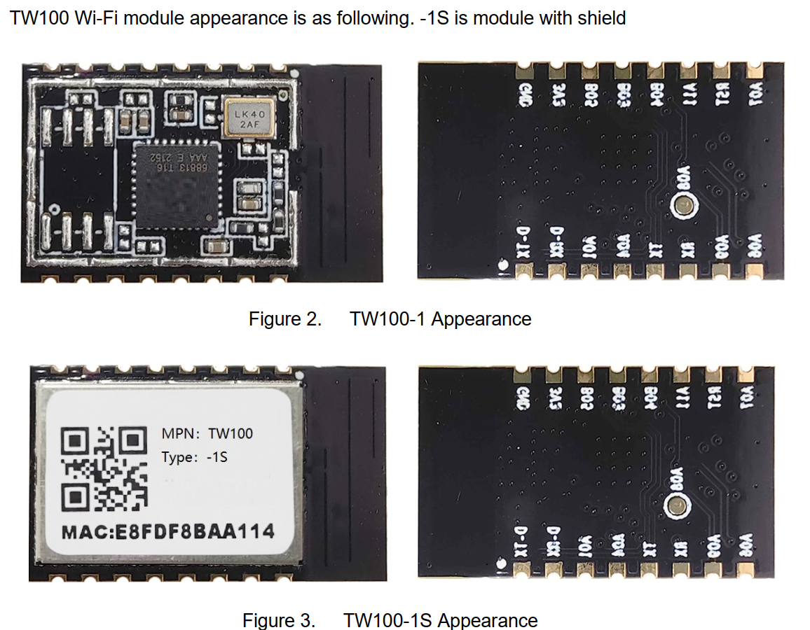

    Was just looking through the Hi-Flying ftp again for anything interesting - http://ftp.hi-flying.com:9000/TW10X/
    It seems the Hi-Flying TW100 module is LN882H - http://www.hi-flying.com/tw100
    Hi-Flying TW100 Module Identified as LN882H - Posting SDK, PDFs, Images
    You have to dig a little to find evidence as it doesn't seem to be openly advertised as LN882H

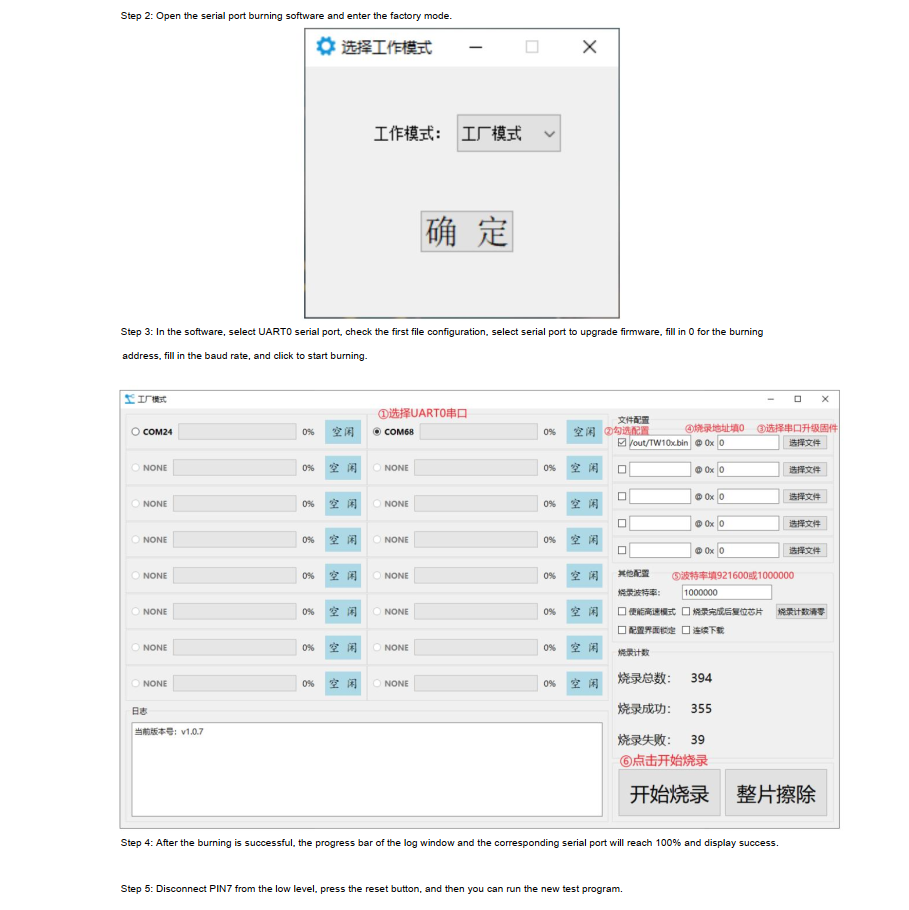

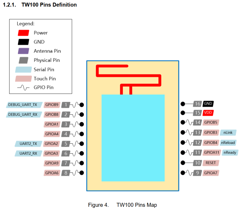

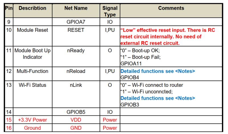

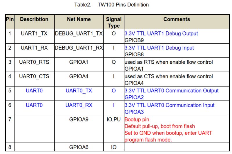

    but then the LN flasher images in the PDFs gives it away

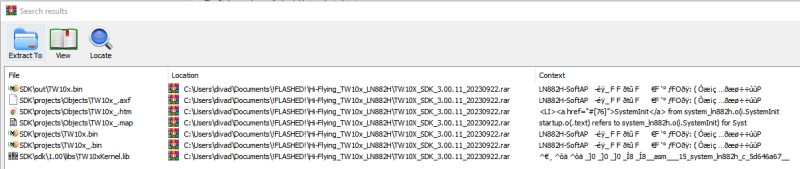

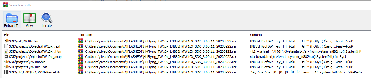

    Hi-Flying seem to have their own SDK for LN882H, attached.
    The built AT binary (TW10x.bin) in SDK zip boots on my test LN882H and from A2/TX outputs a rather minimal:

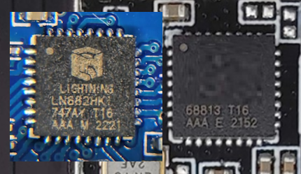

  • #2 21577831
    Posts: 14795
    Rate: 12952
    What happened with MCU label?
    Is it partially blured?
    Also, this empty space for Flash is interesting.
  • #3 21577883
    Posts: 5236
    Help: 450
    Rate: 920
    yes. obfuscated for some reason. compare the date/batch code part format and it's clearly a match
