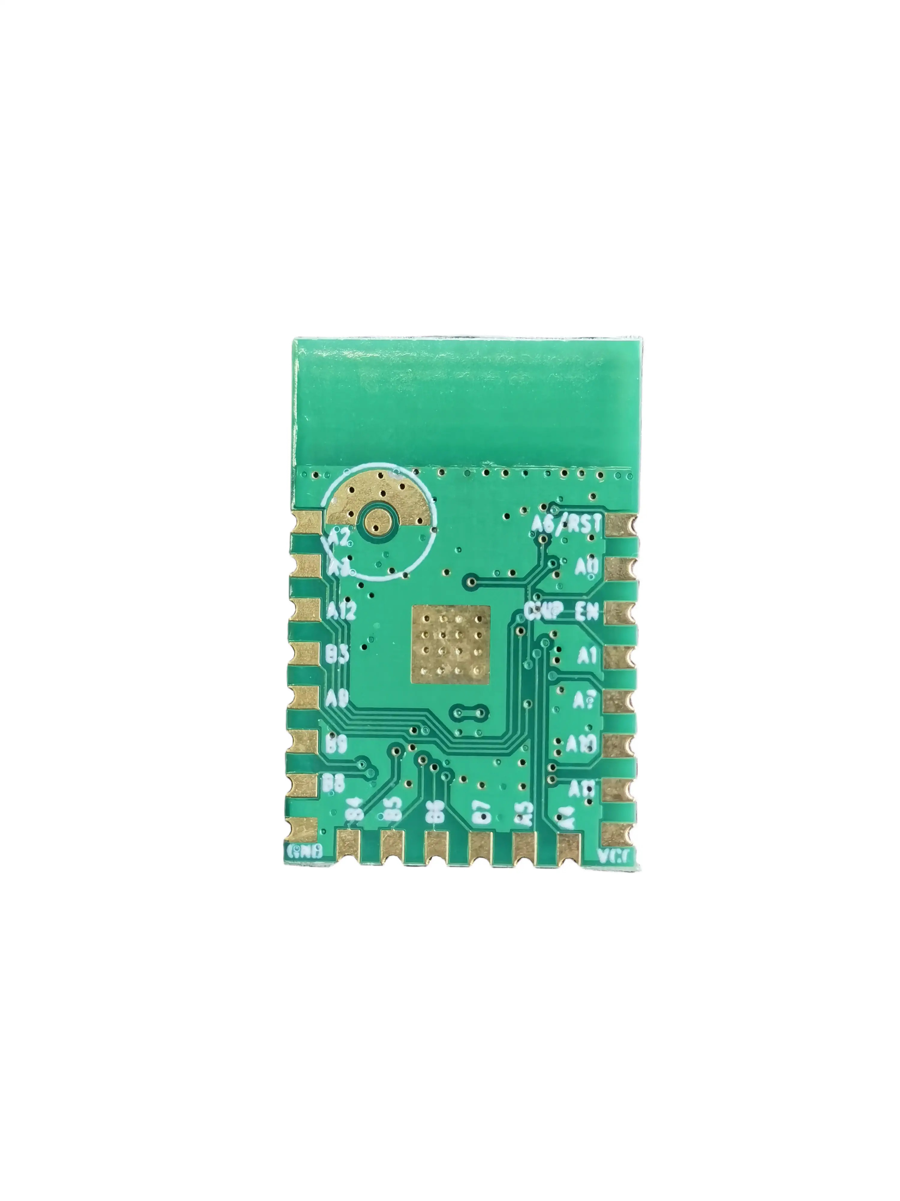

    I bought this hoping for an Espressif or Beken chip, but no luck.

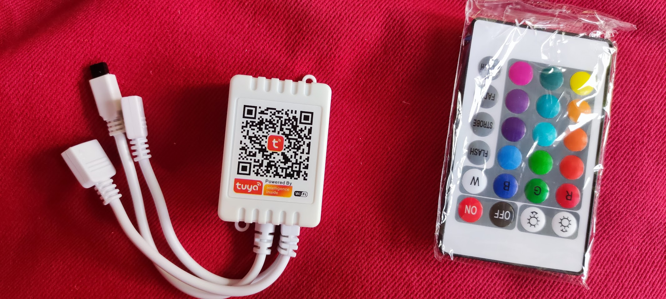

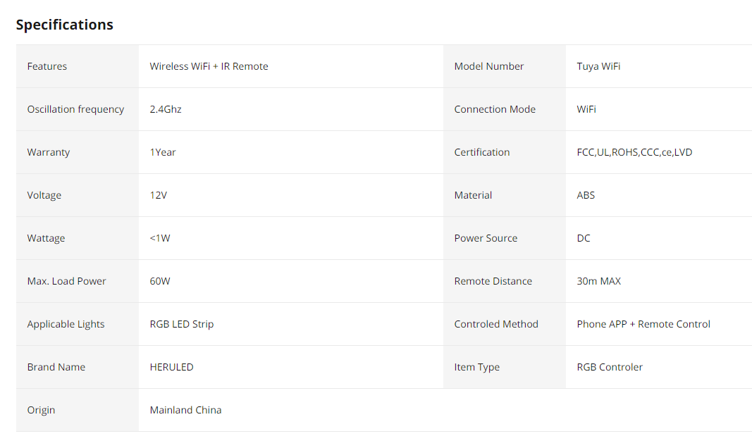

    Tuya WiFi LED controller with remote and mobile app.
    Specification table with details for the Tuya WiFi model and HERULED controller for RGB LED strips.
    https://www.aliexpress.com/item/1005004613749484.html

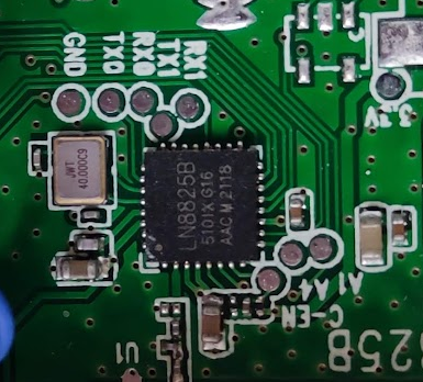

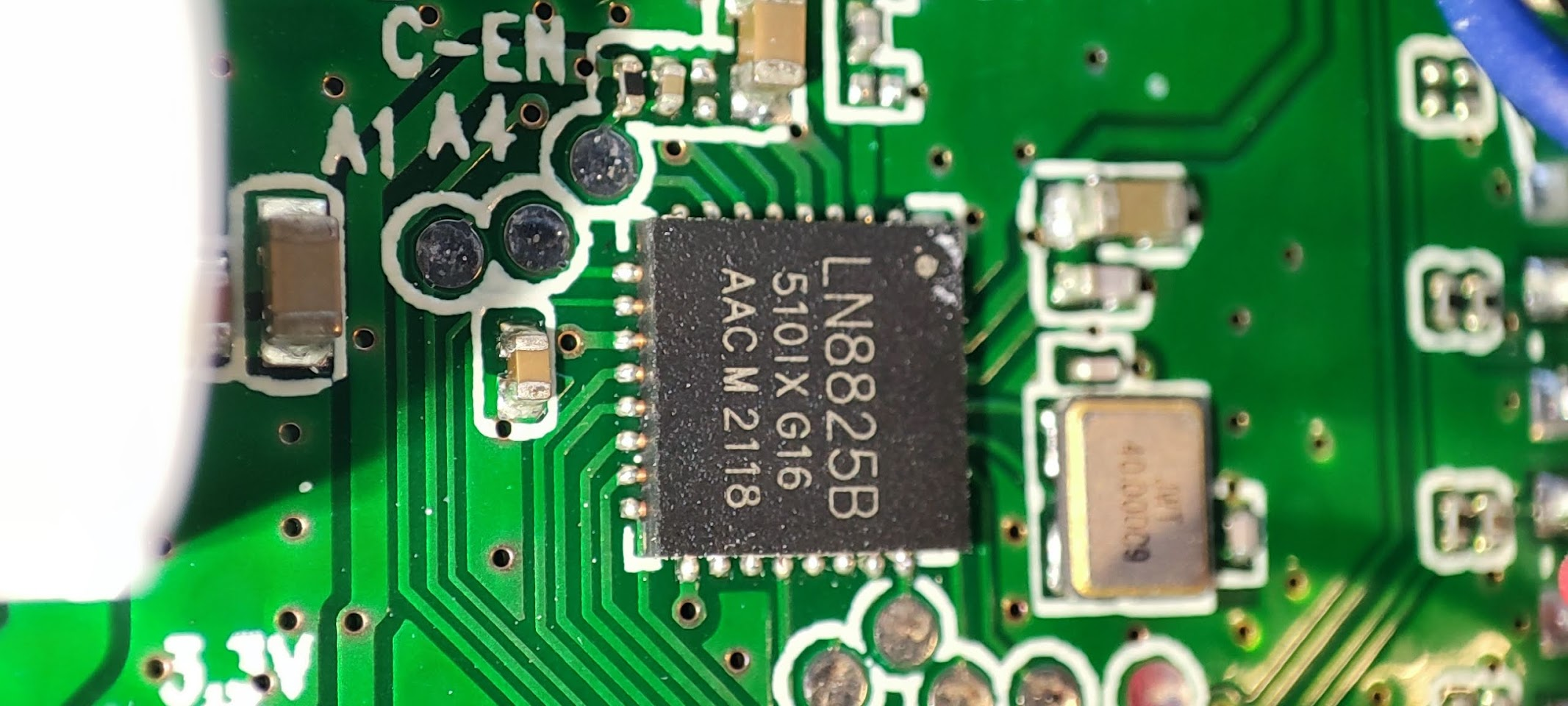

    It appears to be a Lightning Electronics LN8825B chip, which has no mention on this forum or any other, that I can find. It seems no chance it's a rebranded version of something we can flash. The same situation as https://www.elektroda.pl/rtvforum/topic3989796.html
    https://developer.tuya.com/en/docs/iot-device...e?id=Kaiuyfgqxi1cl#title-0-Chipset%20platform
    LED controller with cable and remote on a red background.
    Close-up of a circuit board with LN8825B chip. Circuit board with LN8825B chip in a white enclosure with connected wires.
    I wouldn't recommend wasting your time with it.

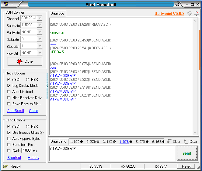

    I've tried CH340 and PL serial adaptors. The CH340 doesn't seem to register any output at all. I'm not sure my external 3.3v is pushing enough current because I only get the log out when using a DC jack.
    I'm off home for Christmas now so won't be able to do anything more for a week or so. I could order another one too in case I have half-killed this one

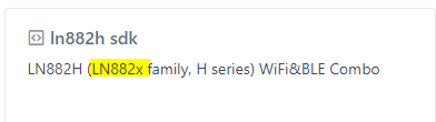

    Interesting. I just came across this thread https://www.elektroda.com/rtvforum/topic4008545.html#20824130 and noticed that @sithyoda also had trouble getting a boot log with any baud rate.
    I notice the SDK is for LN882xx, so looks like it would also cover this variant.
    (Subheading in GitHub is "LN882H (LN882x family, H series) WiFi&BLE Combo*

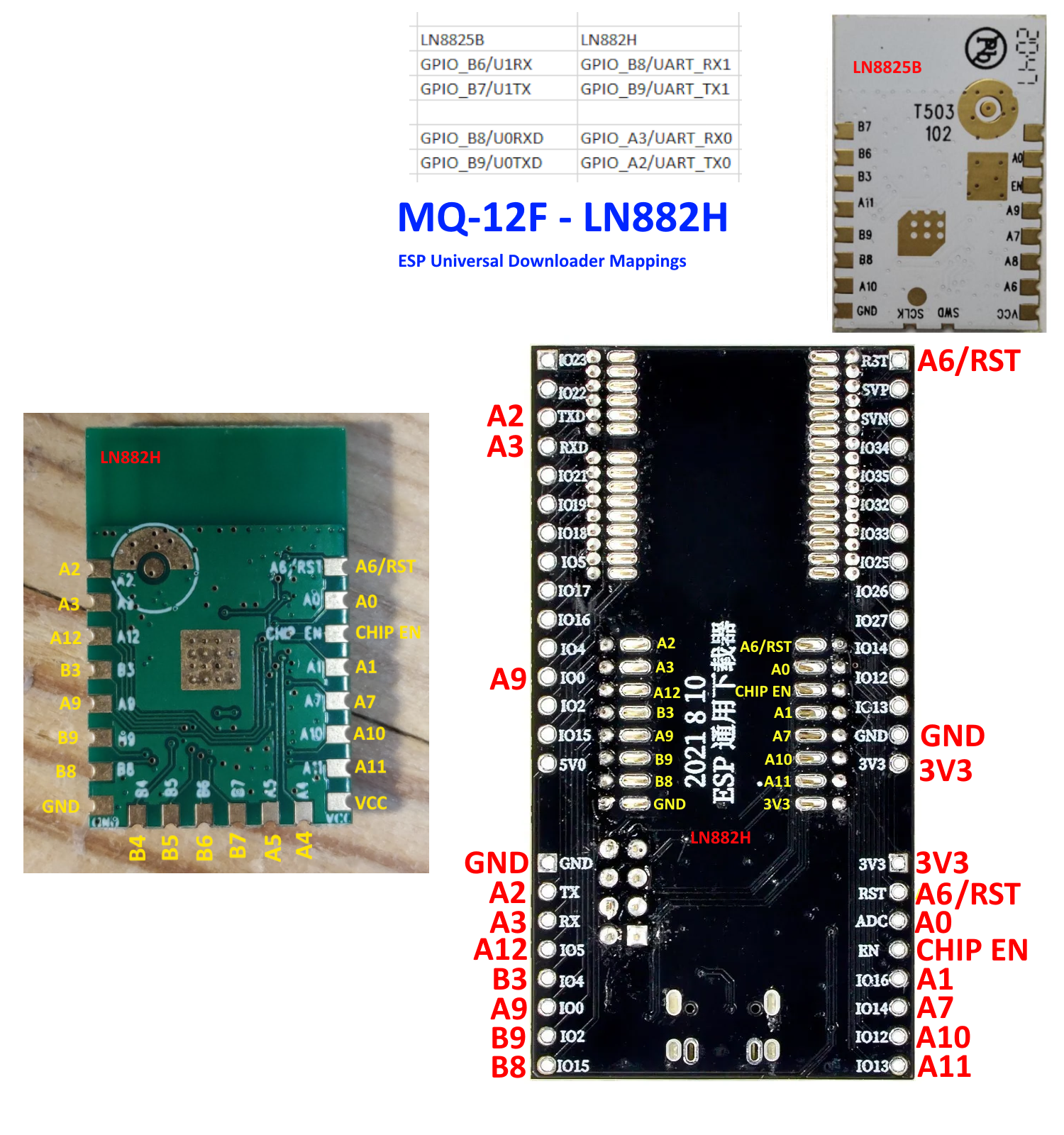

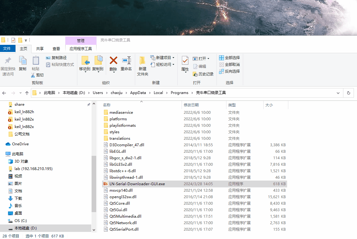

  • UART flashing LN8825B by pulling A10 low
    #15 21023961
    Posts: 5209
    Help: 446
    Rate: 914

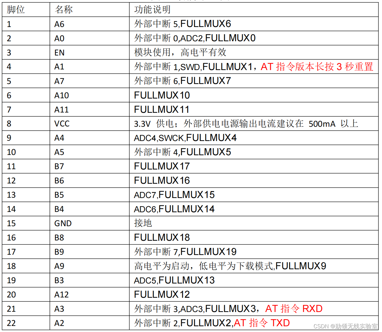

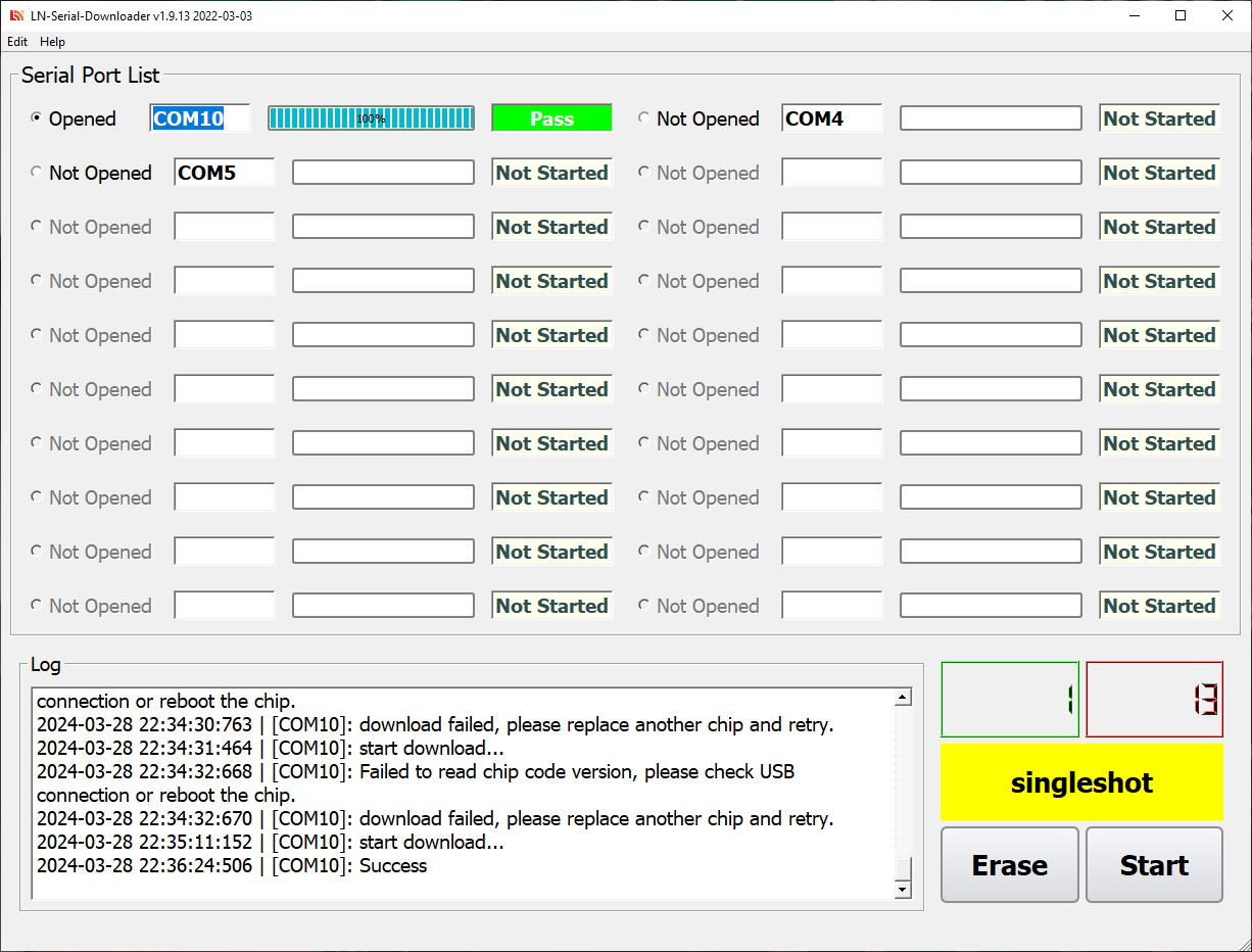

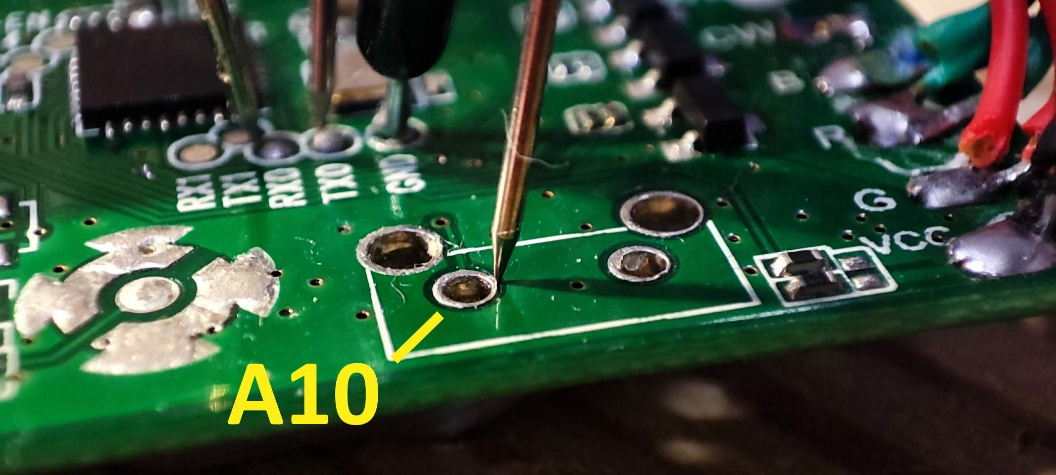

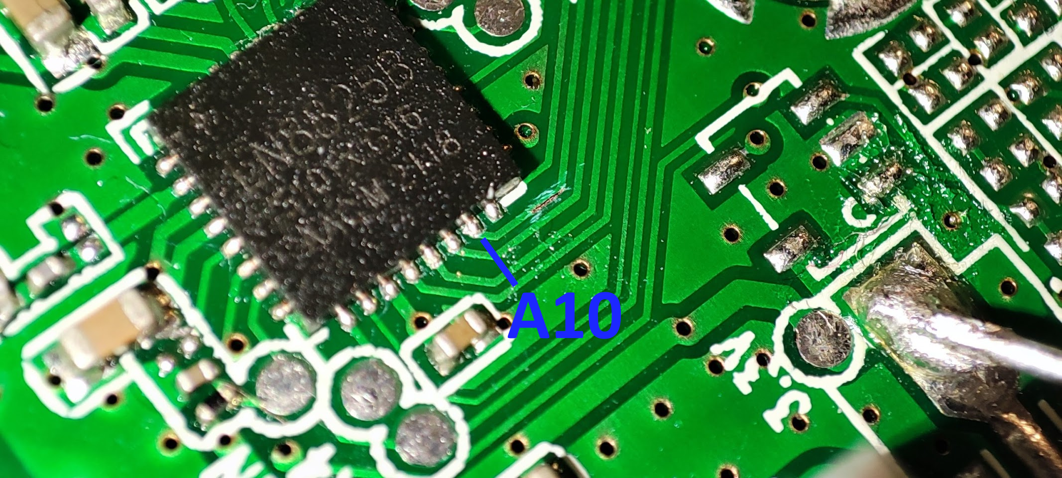

    I've now managed to flash an LN8825B over UART using an official flasher GUI. You have to pull A10 down. I scratched the trace for A10 on this same LED controller as there are no A10 pads. Perhaps expectedly, LN882H OBK does not boot.
    Screenshot of the LN Serial Downloader program showing serial ports and log history.
    LN8825B microcontroller on a PCB with pin A10 marked.
    Close-up of a circuit board with LN8825B chip and connected wires.

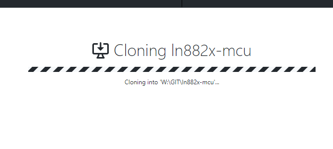

    That's very good news! Let's try some SDKs, shall we?
    https://gitee.com/lightningsemi/ln882x-mcu
    Screen of the cloning process of the ln882x-mcu repository.
    Still, it doesn't seem complete...

    -- CMAKE_SOUECE_DIR:/cygdrive/w/GIT/ln882x-mcu
    -- Building project:firmware_XIP
    -- Build type: Debug
    CMake Error at CMakeLists.txt:35 (include):
      include could not find requested file:
        /cygdrive/w/GIT/ln882x-mcu/project/wifi_mcu_develop/gcc/gcc-arm-none-eabi.cmake
    CMake Error at CMakeLists.txt:36 (include):
        /cygdrive/w/GIT/ln882x-mcu/project/wifi_mcu_develop/gcc/target-def.cmake
    CMake Error at CMakeLists.txt:43 (include):
        /cygdrive/w/GIT/ln882x-mcu/project/wifi_mcu_develop/gcc/gcc-flags.cmake
    CMake Error at CMakeLists.txt:59 (add_subdirectory):
      add_subdirectory given source
      "/cygdrive/w/GIT/ln882x-mcu/components/net/lwip-2.0.3/src" which is not an
      existing directory.
    CMake Error at CMakeLists.txt:60 (add_subdirectory):
      "/cygdrive/w/GIT/ln882x-mcu/components/net/iperf" which is not an existing
      directory.
    CMake Error at CMakeLists.txt:61 (add_subdirectory):
      "/cygdrive/w/GIT/ln882x-mcu/components/net/ping" which is not an existing
      directory.
    CMake Error at CMakeLists.txt:62 (add_subdirectory):
      "/cygdrive/w/GIT/ln882x-mcu/components/net/dhcpd" which is not an existing
      directory.
    CMake Error at CMakeLists.txt:63 (add_subdirectory):
      "/cygdrive/w/GIT/ln882x-mcu/components/kernel" which is not an existing
      directory.
    CMake Error at CMakeLists.txt:64 (add_subdirectory):
      add_subdirectory given source "/cygdrive/w/GIT/ln882x-mcu/components/fs/kv"
      which is not an existing directory.
    CMake Error at CMakeLists.txt:65 (add_subdirectory):
      "/cygdrive/w/GIT/ln882x-mcu/components/fs/nvds" which is not an existing
      directory.
    CMake Error at CMakeLists.txt:66 (add_subdirectory):
      "/cygdrive/w/GIT/ln882x-mcu/components/fs/partition_mgr" which is not an
      existing directory.
    CMake Error at CMakeLists.txt:67 (add_subdirectory):
      add_subdirectory given source "/cygdrive/w/GIT/ln882x-mcu/components/atcmd"
    CMake Error at CMakeLists.txt:68 (add_subdirectory):
      add_subdirectory given source "/cygdrive/w/GIT/ln882x-mcu/components/wifi"
    CMake Error at CMakeLists.txt:69 (add_subdirectory):
      add_subdirectory given source "/cygdrive/w/GIT/ln882x-mcu/components/fota"
    CMake Error at CMakeLists.txt:70 (add_subdirectory):
      "/cygdrive/w/GIT/ln882x-mcu/project/wifi_mcu_develop" which is not an
      existing directory.
    -- Configuring incomplete, errors occurred!
    See also "/cygdrive/w/GIT/ln882x-mcu/build/CMakeFiles/CMakeOutput.log".
    Wait, I've got something more complete:
    https://github.com/openshwprojects/ln882x-sdk
    I am not even sure if it's for LN8825 as well, but I will try...

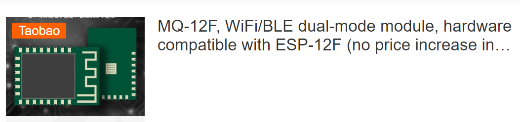

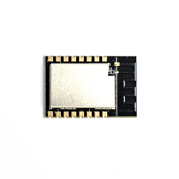

    I'm wondering if it's pin-compatible with something - ESP-12F? - and could be used in a NodeMCU transplant.
    Added after 16 [minutes]:
    hires image of that module
    Electronic module with a green PCB and visible traces.
    • Heruled Tuya WiFi Smart LED Controller - Lightning Semiconductor LN8825B chip MQ-12F_Taobao.jpg (484.76 KB) You must be logged in to download this attachment.
  • LN8825B flash tool and engineer gif
    #18 21024297
    Posts: 5209
    Help: 446
    Rate: 914

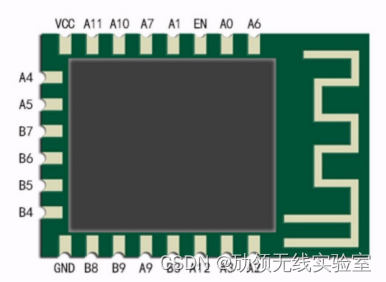

    MQ-12F dual-mode module labeled WiFi/BLE.
    Illustration of an integrated circuit with pin labels. Table showing pin functions of LN8825B.
    https://blog.csdn.net/mqlinks/article/details/136698831

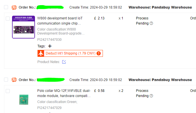

    Added after 1 [hours] 40 [minutes]:
    ordered a couple + W800. see what comes.
    Order list of two electronic products from Pandabuy warehouse.
    Added after 6 [hours] 46 [minutes]:
    Here is the LN8825B flash tool and a gif supplied by the Lightning Semi engineer.
    This tool is in English. It is a different program to the LN882H GUI flasher.
    Screenshot of Windows File Explorer with an open folder showing files including LN-Serial-Downloader-GUI.exe.
    • LN-Serial-Downloader-LN8825B.zip (24.62 MB) You must be logged in to download this attachment.

  • LN8825B needs its own flasher and A10 test pad
    #20 21029890
    Posts: 5209
    Help: 446
    Rate: 914
    no, LN8825B cannot be flashed with the LN882H flasher
    Added after 41 [minutes]:
    actually, there was no need to reveal A10 trace. There is of course a test pad for A10
    Close-up of a PCB with a probe pointing at a test pad labeled A10.
    @p.kaczmarek2 did this one fail too?
    There's also this which seems to have more files, though not all. it says LN8825X AND LN882H
    Screenshot displaying the SDK name ln882h and a description including LN882H (LN882x family, H series) WiFi&BLE Combo.

    Rate: 914
    Yes, try to get some AT commands working
    nothing yet
    Screenshot of Uart Assistant software displaying data log and command sending.
    Error code list with highlighted code and message.
    Added after 8 [minutes]:
    ooh. -1s now with auto append checked
    Screenshot of UartAssist v5.0.3 interface showing COM settings and data log.

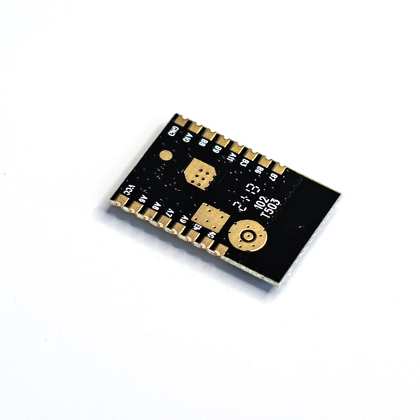

    another LN8825B module for the records.
    http://www.scanway-tech.com/product/detail/34.html
    SHENZHEN SCANWAY TECHNOLOGY CO. LTD SCW-T503
    Electronic module with pin and component markings on a black board. Electronic module with metallic cover and gold pins. Electronic module Scanway Technology LN8825B. LN8825B electronic module on a white background.
    • Scanway_SCW-T503.pdf (562.99 KB) You must be logged in to download this attachment.
    • Scanway_SCW-T503_en.pdf (798.22 KB) You must be logged in to download this attachment.
  • #27 21074840
    Posts: 14755
    Rate: 12879
    VDD/GND footprint matches TYWE3S/WB3S/CB3S/etc, does UART port also match?
  • #28 21074899
    Posts: 5209
    Help: 446
    Rate: 914
    scrambles my brain for some reason mapping pins around.
    this is LN882H vs LN8825B. LN882H (ESP-12F dimensions module MQ-12F)
    both UART sets are available on the LN8825B module but one set does not match.
    Comparison of LN882H and LN8825B modules with pins labeled on a black PCB and green module.

    not that there's much to be gained from it, apart from the experience doing it, I've bought some of these QFN32 .5 pitch boards to transplant the LN8825B chip from the LED controller onto. I'll post success/failure in due course! Wish me luck
    QFN32 adapter board with an integrated chip, displayed with the Jessinie logo.
    Close-up of a circuit board with an LN8825B chip and path markings.
