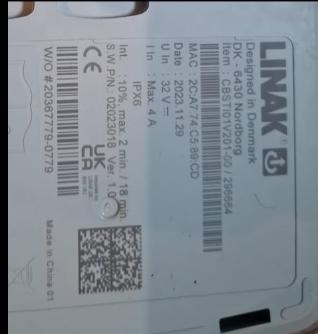

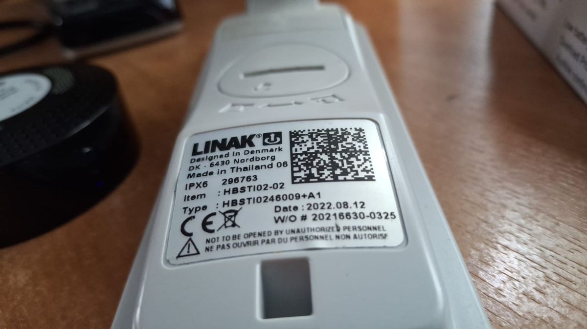

    I have a remote control like the one attached. Do you think it can be copied somehow to control the device by voice? While the remote from the TV is not a problem Tuya WiFi IR RF 433 RF 315, I wonder if it is possible to copy such a device?
    Supposedly it's Bluetooth based, can the Bluetooth be copied somehow?
    Any ideas?
    https://www.ebay.pl/itm/266226000320
    (I will still upload pictures of the control panel in the evening)

    In the Chrome or Edge browser, type chrome://bluetooth-internals/#devices or edge://bluetooth-internals/#devices in the address bar respectively and select "Start Scan". See if it finds the controlled object. Maybe there is a sticker with a MAC address on it ?

    What I really need is to hook up preferably two remotes (or rather two controls, one being the original remote and the other a voice control). I'm quite poor in health and, in order to reach for the remote at night and, for example, lift my legs so they stop hurting, I have to spend about 15 minutes doing this, which practically wakes me up.
    I already have the infrastructure in place with Home Assistant and I can control some devices by voice, which has made my life much easier. For example, I have an actuator for a window and I can use the ESP32 to open and close it.
    I've even wondered if it might be possible to solder such an ESP32 into such a control panel and feed a signal to the relays. It is possible that there is an Atmega or other microcontroller in there and maybe it would be possible to feed signals to the control from another microcontroller, but I am too small in the ears for such miracles...

    There is a MAC address on the sticker. This may relate to WiFi, LAN or BT. Do an experiment with scanning in your browser. See if it finds the device 2C:74:89:A7:C5:CD. If there is such a device then try to connect to it (select "Inspect").

    After a power failure in the flat something, the control panel does not connect to my remote control, nor can it be seen at the link indicated. I checked on my phone, does it necessarily have to be a laptop with Wi-Fi?
