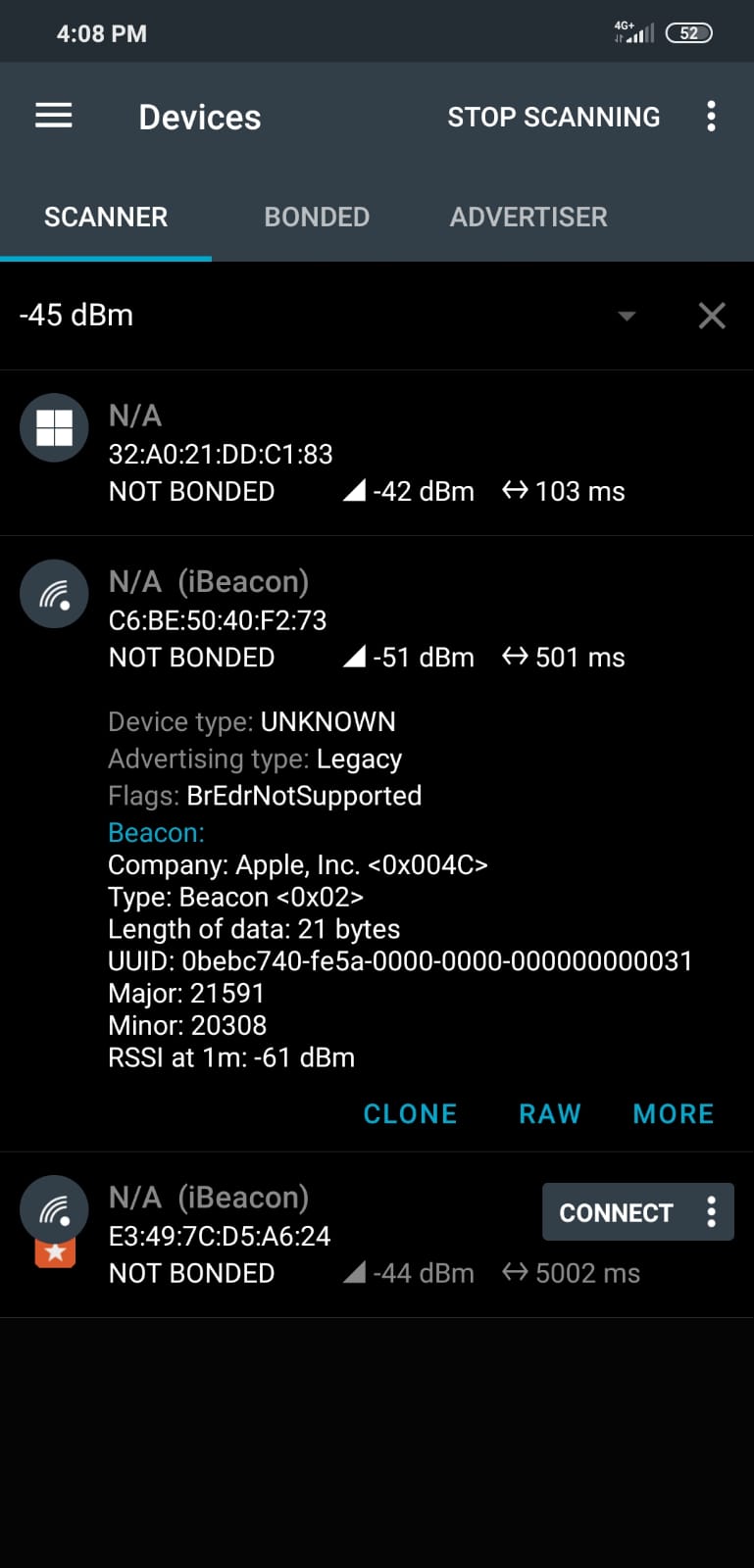

    im using wbl3 module with pwm driver for smart light i have used your openbk7231T code and controlled light brightness through my mqtt broker now i want to add ble functionalities to the code so that i can configure the ssid password for wifi and username password for mqtt can you please help me with this??
    note: i have referred your my_mqtt_demo code for ble but ble stack seems to be initiated somewhere other than main i want to init the ble in main and change the advertise packet to the ibeacon format

    we are having 100's of ble watches which will advertise in certain intervals. I want this light to scan our watches. We are differentiating our watches with serial numbers which will be included in the watch raw advertising packet, so the light should scan our devices and then advertise which device it scanned by sending a serial number in its raw advertising packet.
    my overall application
    ble->scanning and advertising(scan our devices and advertise with our serial number)
    mqtt->to change the light color and brightness
    flash memory->to store the ssid, pswrd, certs etc
    ota->to flash over the air
    if i implement the ble, i can also change the ssid and pwrd of mqtt and wifi in ble connected mode
    can you help me with this?
    note: i have attached our advertising format in photo

    @p.kaczmarek2 we are using nrf ble controllers in watches..for now only adding ble advertising to your code is enough for me can you tell me how I can start that?
