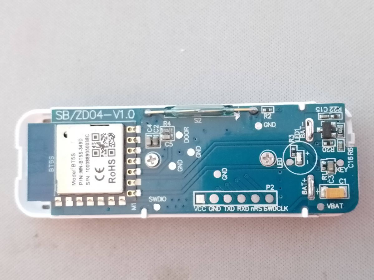

    Device Name: Arlec Grid Connect Contact Sensor
    Device Chip: BT5S
    White Arlec Grid Connect contact sensor with two parts. Top view of the Arlec Grid Connect contact sensor PCB with BT5S chip and connector labels.
    Flashing of Main Chip
    Appears this device could be flashed as there are TX and RX pins to connect to. Would just need OBK firmware to support the chip.

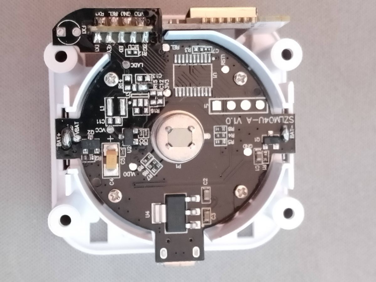

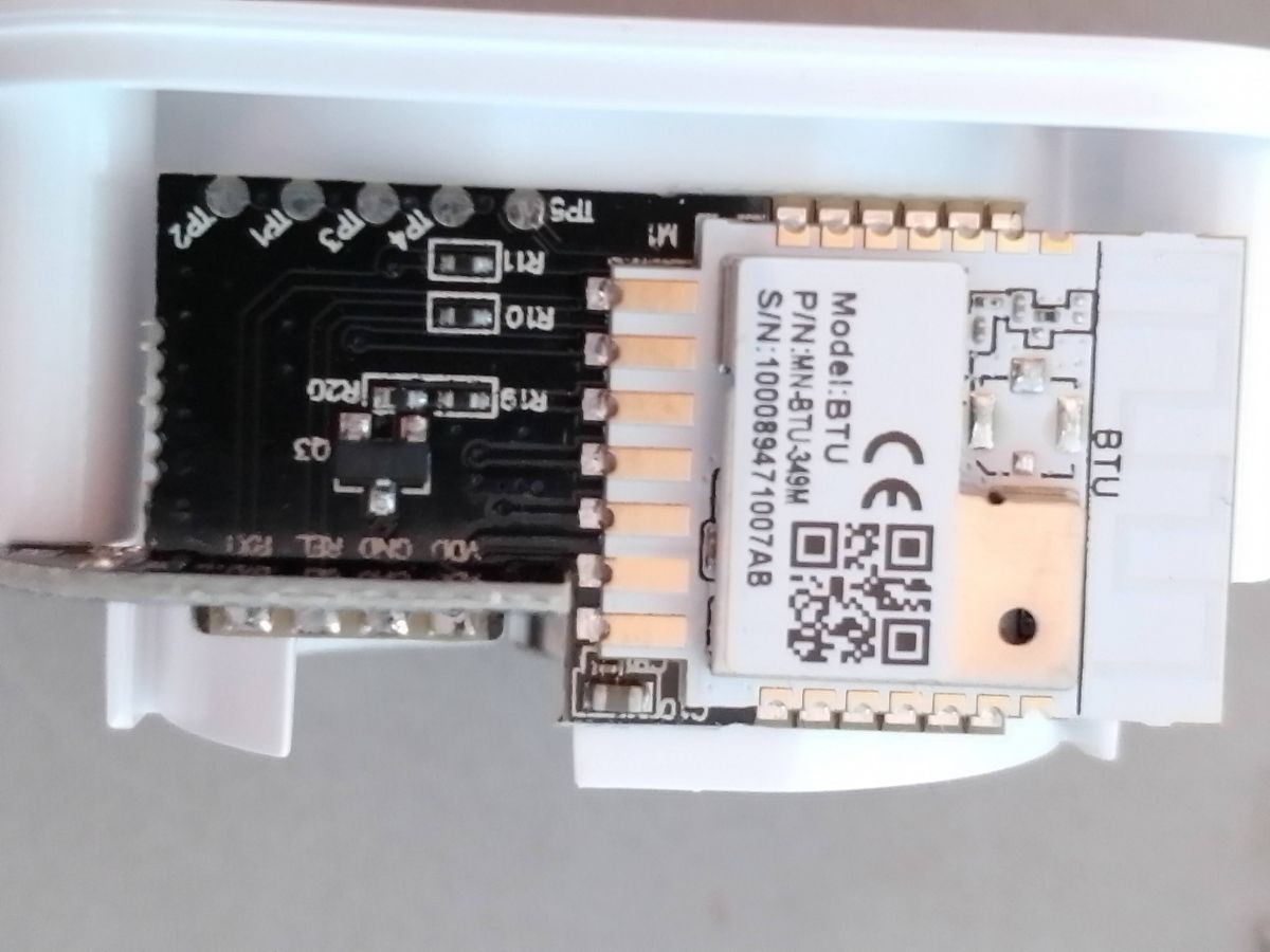

    Device Name: Arlec Grid Connect Motion Sensor
    Device Chip: BTU
    White cube-shaped motion sensor Arlec. Close-up of Arlec Grid Connect BTU circuit board. Inside view of the electronic components of the Arlec Grid Connect device.
    Appear this device could be flashed as there are TX and RX pins to connect to. Would just need OBK firmware to support the chip.

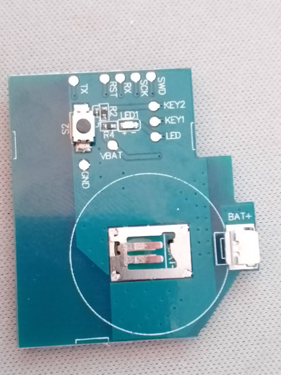

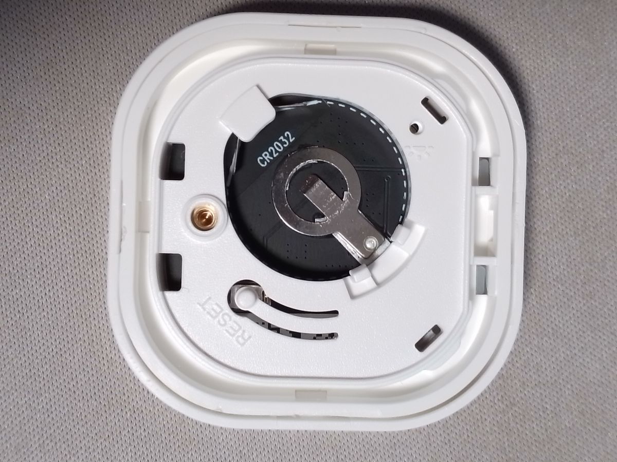

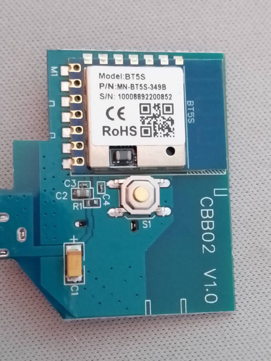

    Device Name: Arlec Grid Connect Smart Button Kit Version
    Device Chip: BT5S
    White Arlec Grid Connect attachment in a square shape. Electronic board with a BT5S module and SMD components. Printed circuit board with smart home electronic components
    There are two versions of the smart button one comes with the kit the other can be purchased on its own. They both have different chips

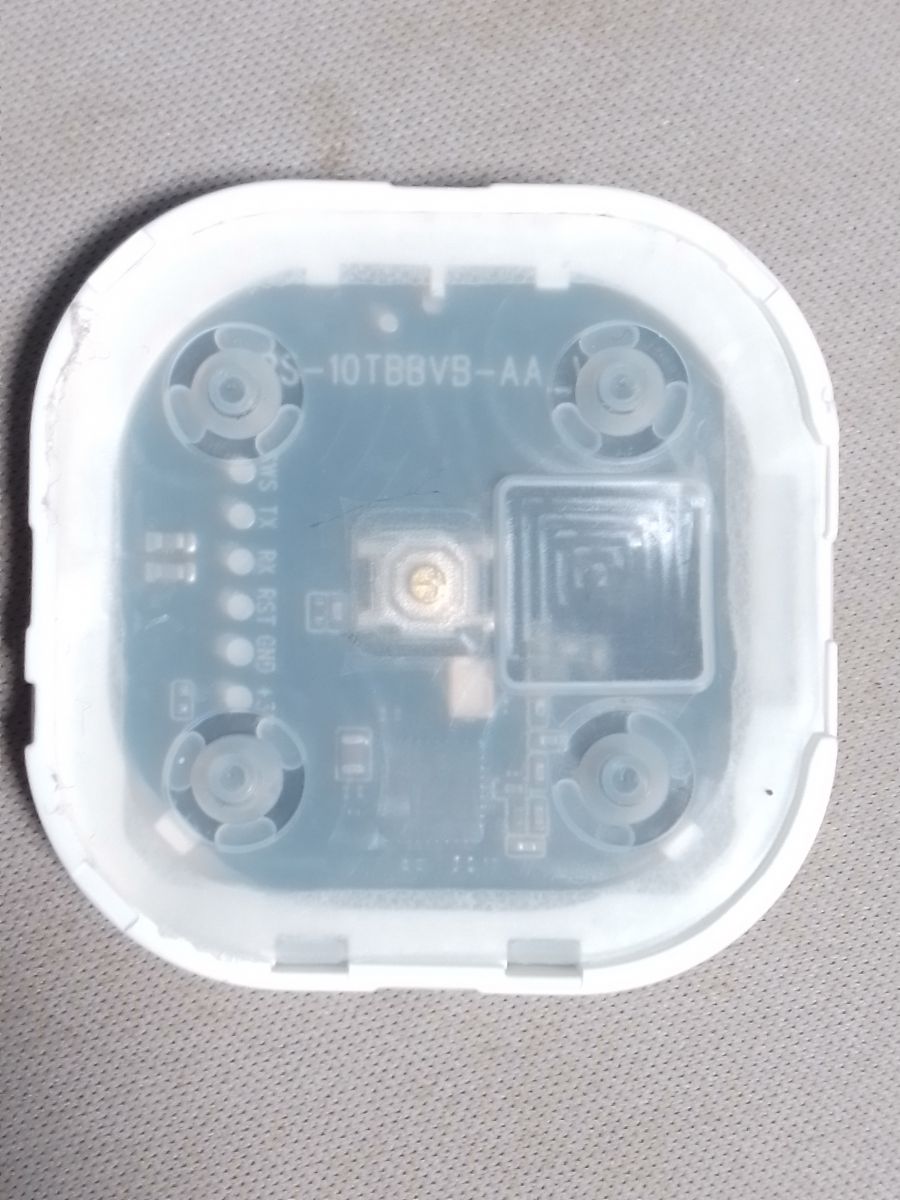

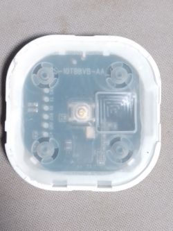

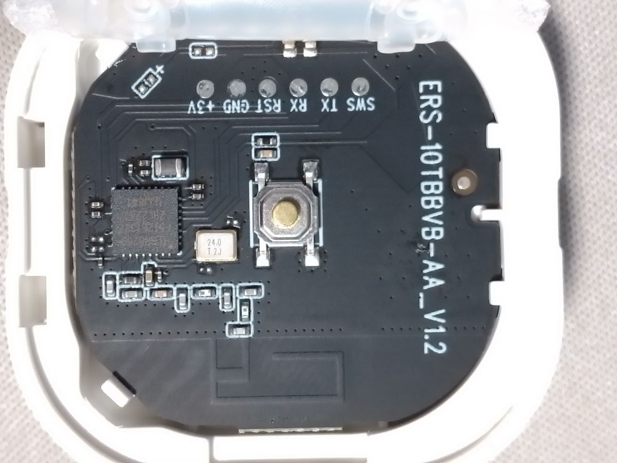

    Device Name: Arlec Grid Connect Smart Home Button
    Device Chip: ers-10tBBvB-aa_v1.2
    Printed circuit board with a microchip and inscriptions on the surface. Internal view of an Arlec Grid Connect device with visible circuitry. View of the interior of a smart home device with a CR2032 battery.

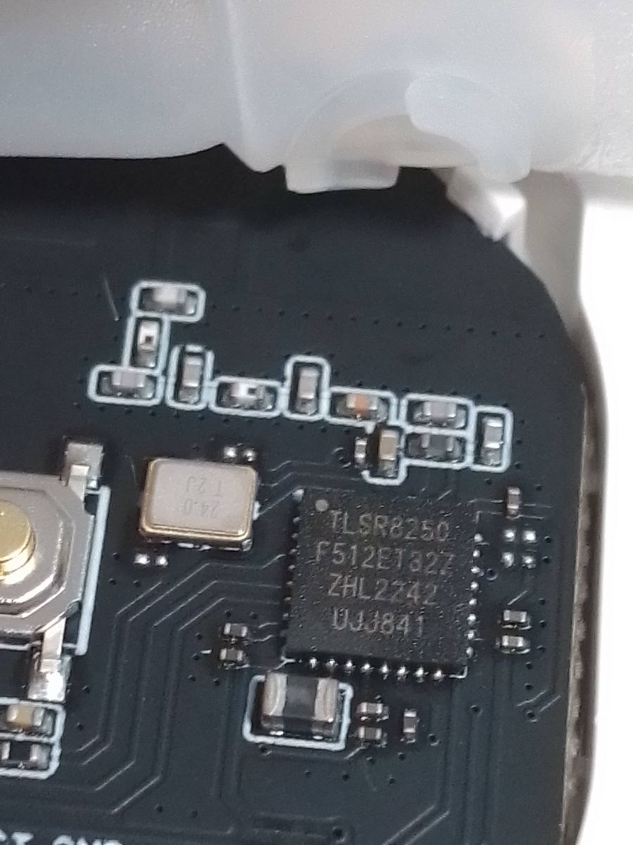

    So it looks like one of the smart buttons has an MCU on board
    Close-up of a circuit board with a TLSR8250 chip from Telink.
    It's a TLSR8250 from Telink.
    Appears there are some burning tools that could allow you to get data of the chip. Unfortunately, it looks like you need one of these Telink Kits.
    I did find an OTA solution here but Not really sure how to use it yet.

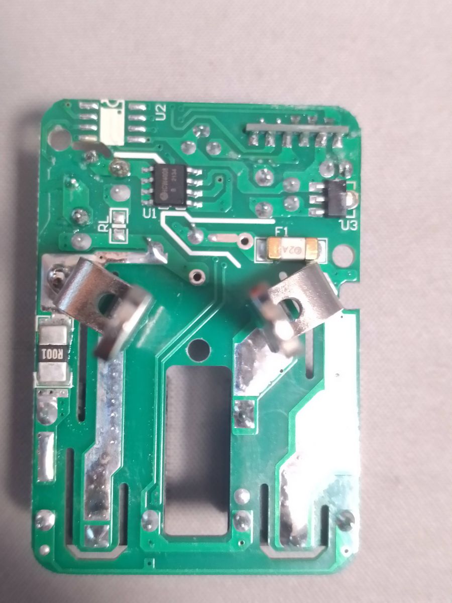

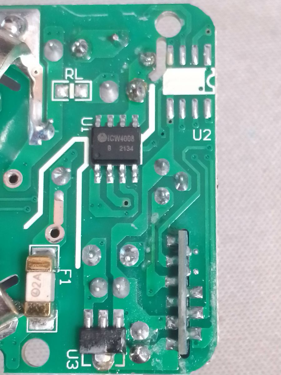

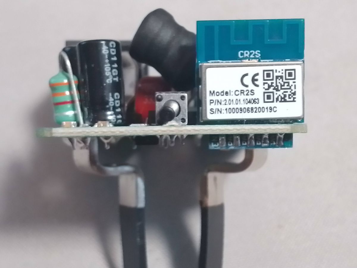

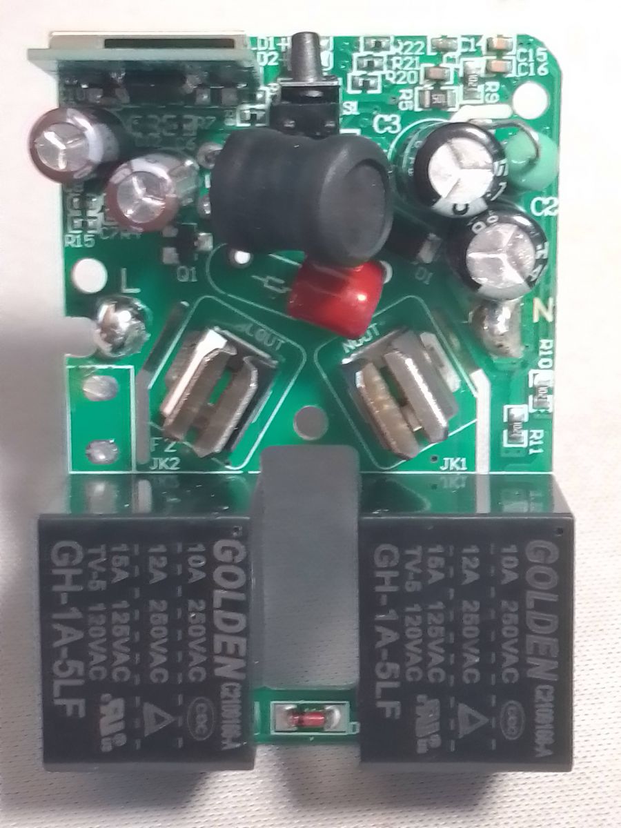

    It got the better of me and I decided to try and open the Hub. Inside I found it uses a CR2S module. I haven't yet tried to pull data from it. It appears the is an MCU on board as well so might not be able to get too much information from the device. Will see how I go and I'll post the results.
    A circuit board with visible electronic components, including integrated circuits and resistors. Close-up of a circuit board showing electronic components, including an IC labeled ICW4008 and a 2A fuse. View of an electronic module with various components on a printed circuit board. CR2S module with electronic components on a circuit board.
    Added after 3 [hours] 34 [minutes]:
    I have been trying to get the data off the CR2S module but I'm not having much success.
    I have tried using Realterm, YAT and Putty but none of them seem to be able to get anything.
    I have tried 4 different USB to TTY/Serial adapters and basically every setting I can think of that should work and still nothing.
    I thought there was something wrong with the drivers but I have tested it with some other modules and they all get an output fine.
    I desoldered the module and tried connecting that way but still no show.
    Unfortunately in my desoldering of the uart wires the TX pad ripped off so I can't do any more testing.
    There was no magic smoke when I turned it back on so for now it looks like it still works. Need to do a bit of testing to see if I still have full function with the device. So far it appears to be working ok with the other devices.
    I'm sure there is a way to get these modules to output something but whatever that is it's beyond my skill level.

    Have been doing a little bit more investigation about these devices. I found a few things that might be interesting
    TLSR8250F512ET32
    datasheet for the TLSR8250
    Datasheet_...SR8250.pdf (1.46 MB)You must be logged in to download this attachment.
    So far it appears that there is no way to dump the firmware without some kind of authorization key and a Telink Burning and Debugging Tool (BDT).
