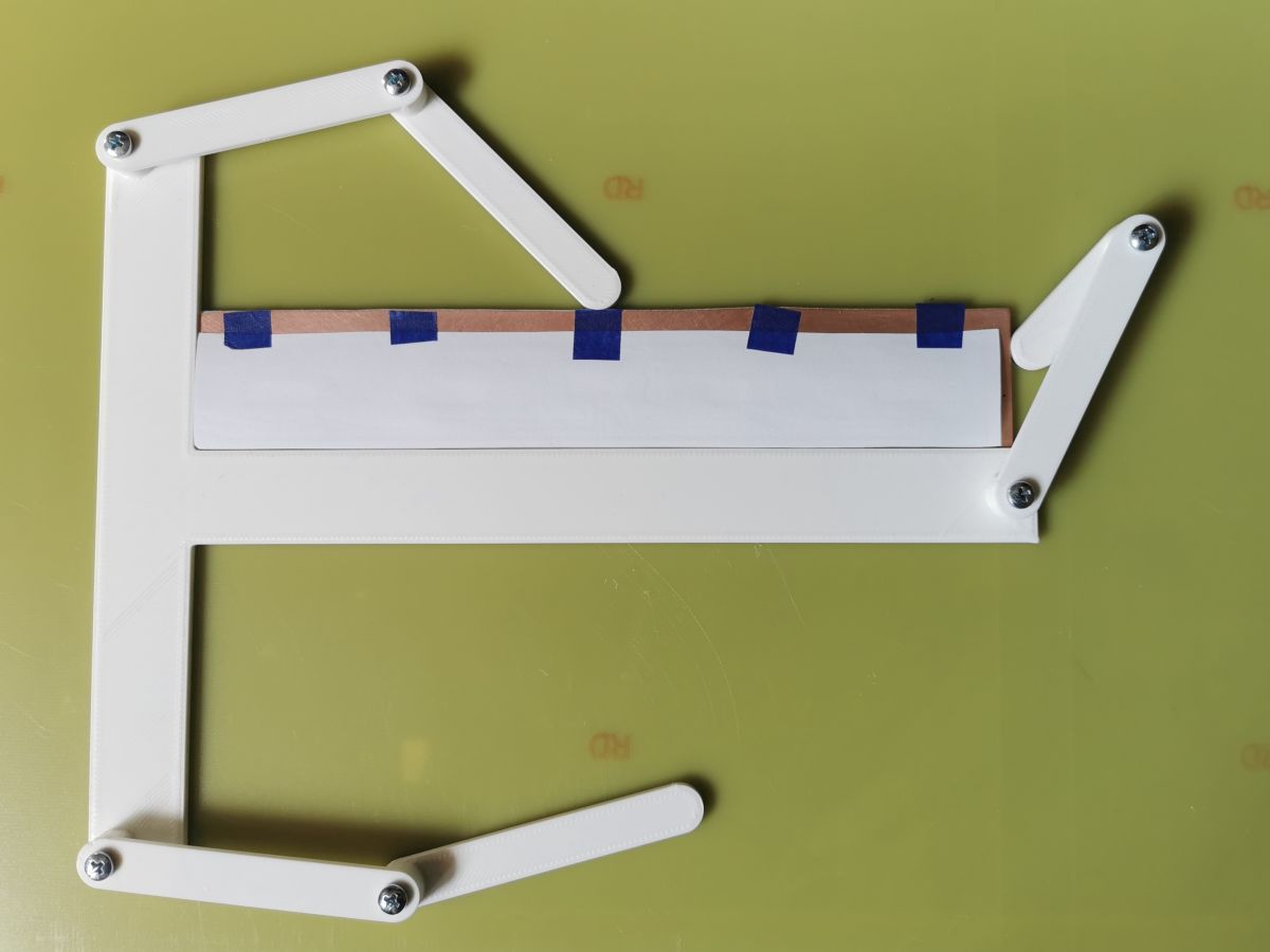

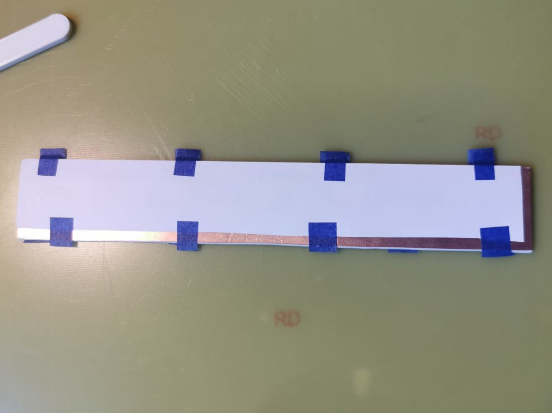

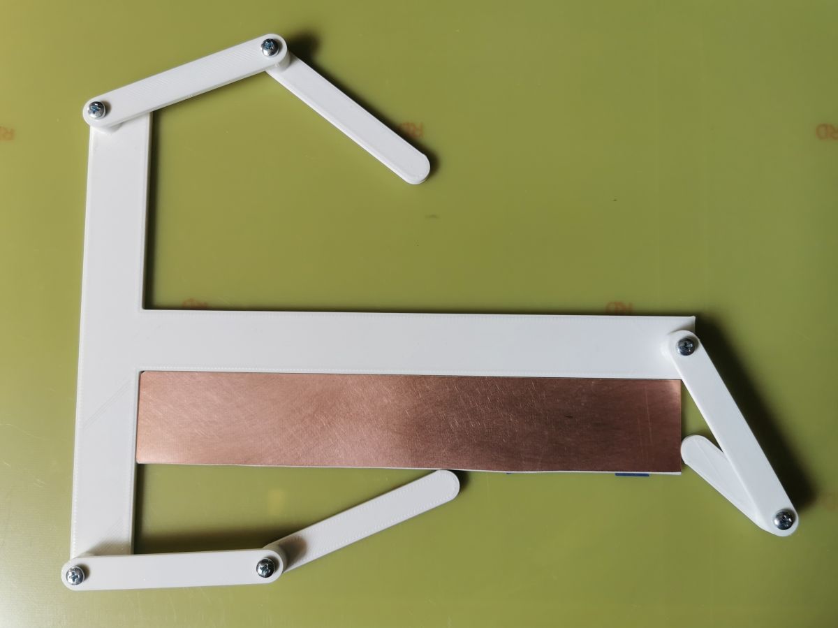

    In the end I came up with an alternative, experimental gadget that makes it easier to position the bottom and top print of the tracks.
    The mosaic to be printed has to be provided with a corner marker for both sides of the print, or a larger frame. According to this marker you need to cut one corner of the print paper for each side.
    I align the plate with the adjustable "pressers" to the corner of the jig. I place the printed paper on the plate and fix it with pieces of paper adhesive tape.
    PCB positioning jig with printed paper sheet taped to copper-clad board

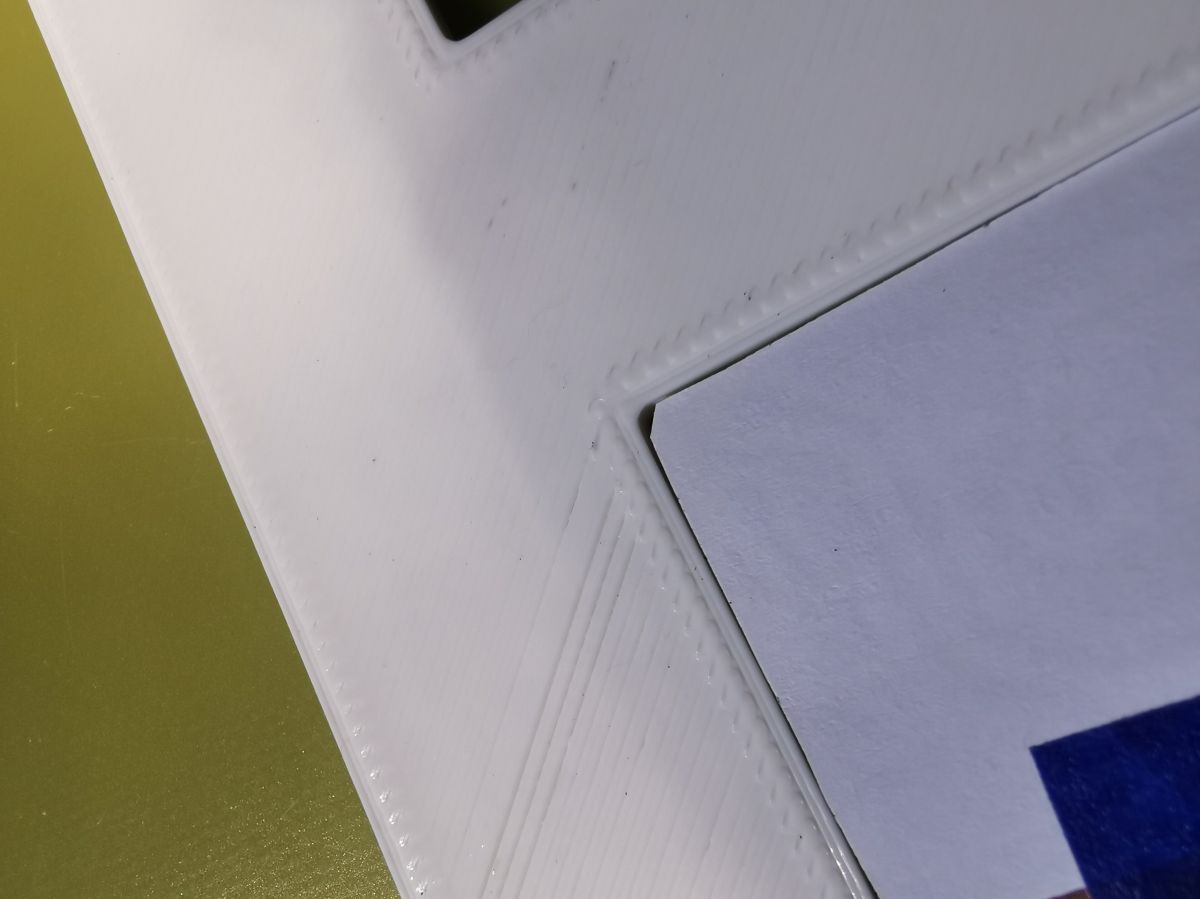

    I cut the corner of the plate and the printed paper slightly so that there is a better fit between the sides and the frame.
    Close-up of alignment jig corner with trimmed paper fitted into the frame
    I then turn the plate over and fix it in the jig.
    PCB alignment jig with clamping arms and copper-coated board
    Continue analogously to the previous page.
    PCB positioning jig with printed paper and tape on a green background
    PCB board with printed paper aligned and taped with blue painter's tape

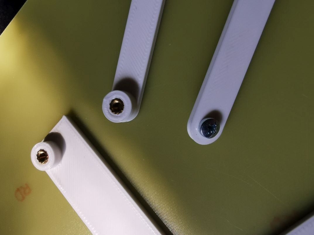

    The arms are connected by sunken inserts with M3 threads.
    Close-up of a white mounting jig with three arms screwed into a green surface.

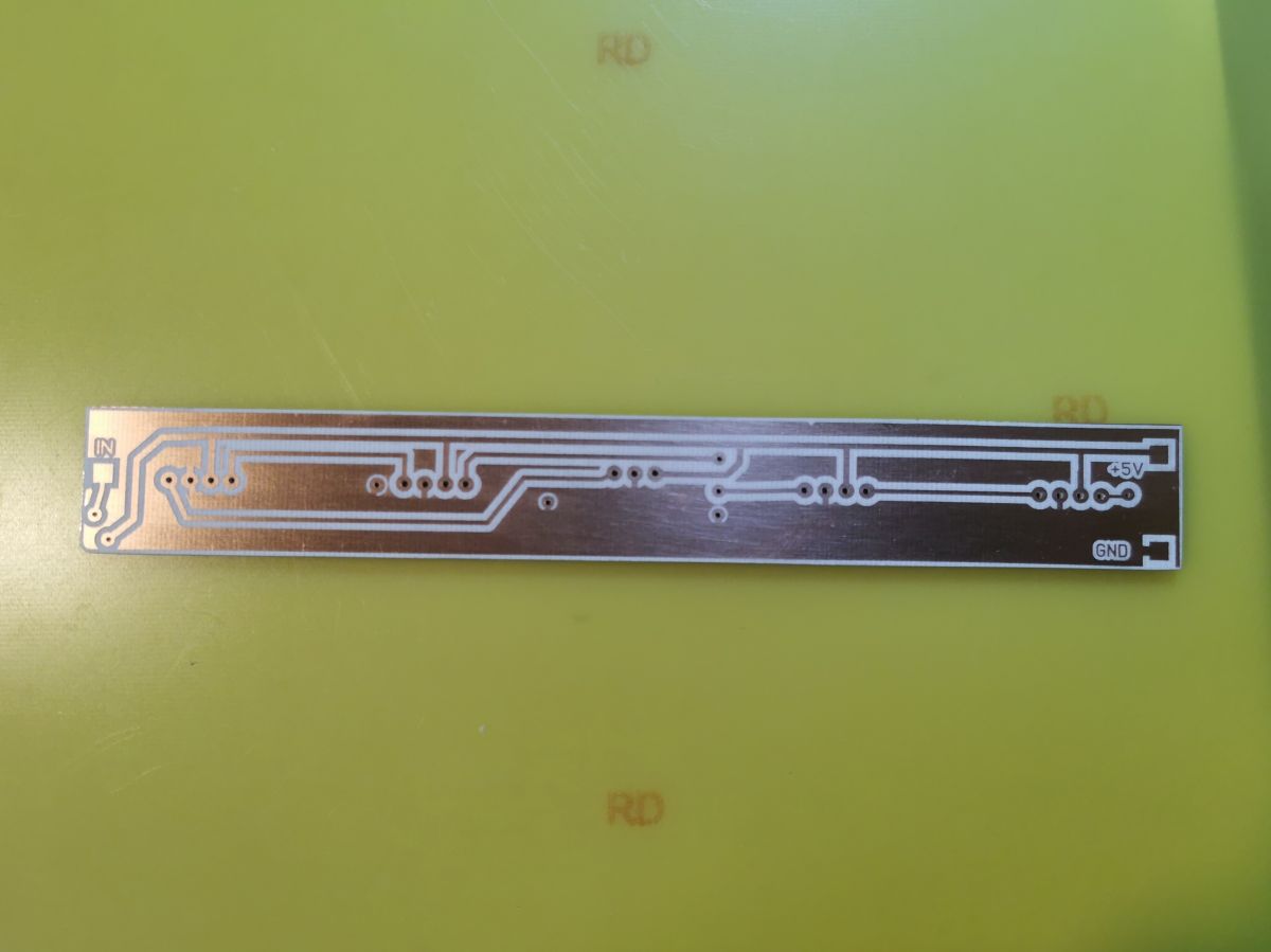

    Drilled inserts. 2.1mm diameter through-hole pads. Deviations are and probably always will be. This is the third tile I've done this way. It's not too big - 170x30 mm. I haven't tested on larger sizes. But the potential I think is there.
    Double-sided PCB with etched traces and alignment holes on yellow background
    Narrow double-sided PCB with white traces and mounting holes on a copper surface
    I need to observe in which phase these shifts occur. Maybe something can be refined further.

    efi222 wrote:
    Corner of plate and paper with print slightly cut so that there is a better fit between the sides and the frame.

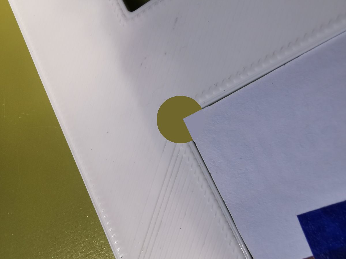

    As you are designing for corners you can make rounds.
    White rounded corner with flat material installed on green background
    You will be able to use tiles without chamfers.

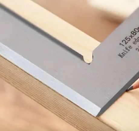

    Good point. The scribe angles have a similar dodge.
    Close-up of a try square positioned on the corner of a wooden board
    I also thought of this as the hardware was already in use :) So much so that even with the hole in the corner there will still be a slight protrusion at the start of this rounding. Alternatively, it can be refined.
