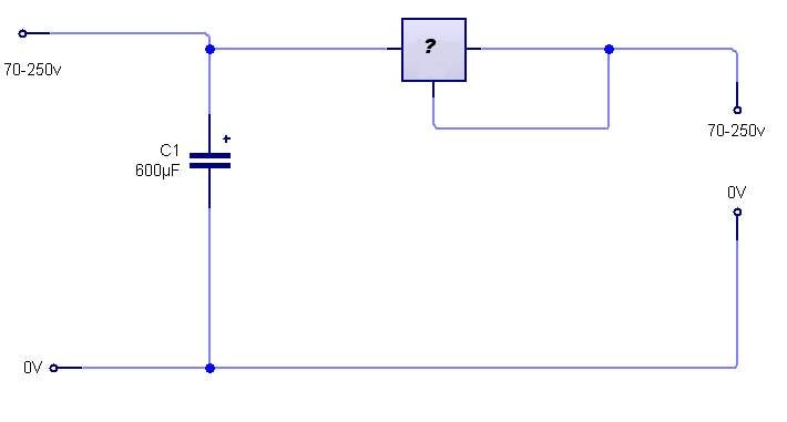

How can I switch a 250VDC capacitor discharge so the welding leads only become live when the probes touch the workpiece?
Use a power MOSFET or, simpler, an SCR/thyristor to gate the capacitor discharge only when the probe contact is made; an optoisolator can keep the control side isolated, and a MOSFET for 250VDC should have a Vds rating comfortably above the maximum, about 375V by the 150% rule [#21660498][#21660508][#21660514] If you go the MOSFET route, the thread notes that N-channel parts are more common, but the circuit polarity has to suit the device, which is why the opto-isolator idea was suggested for using an N-channel in an isolated control arrangement [#21660509][#21660514] The later SCR approach was presented as the cleaner fit: an SCR only needs about 10–30 mA to trigger, and a part like the 2N6397G is rated 12A/400V with 100A non-repetitive surge, though it will have a voltage drop and dissipate heat during the pulse [#21660523] That SCR circuit was also described as working over a variable 70–250V input as long as the gate trigger current stays within limits [#21660525] If you can redesign the welder, lowering the voltage and paralleling several low-voltage capacitors was suggested as a safer way to get the needed current while reducing shock risk [#21660517]

  • MOSFET switch proposed to prevent accidental discharge

  • #12 21660508
    Steve Lawson
  • N-channel to p-channel MOSFET polarity reversal guidance

  • Optoisolator suggestion for positive-ground isolation
    #18 21660514

  • Considering an SCR instead of 70A MOSFETs
    #24 21660520
    Sarah Harris
  • #25 21660521
    Sarah Harris
  • Simpler SCR circuit with higher R9 value
    #27 21660523
    Steve Lawson
  • Diode between Q1 and SCR gate improved simulation
