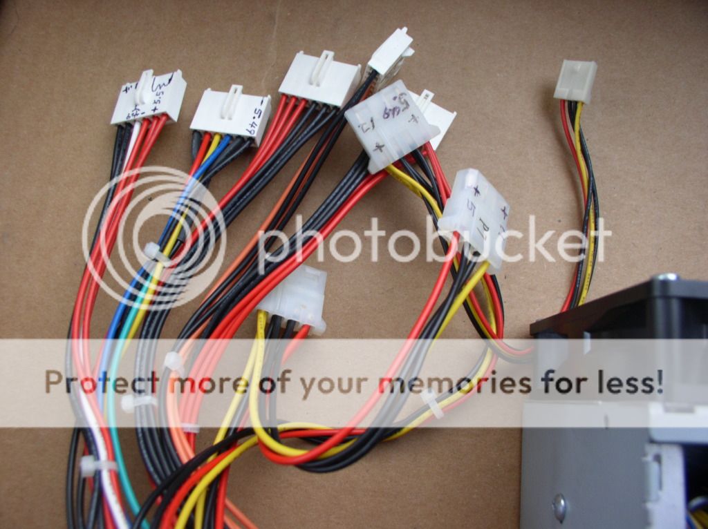

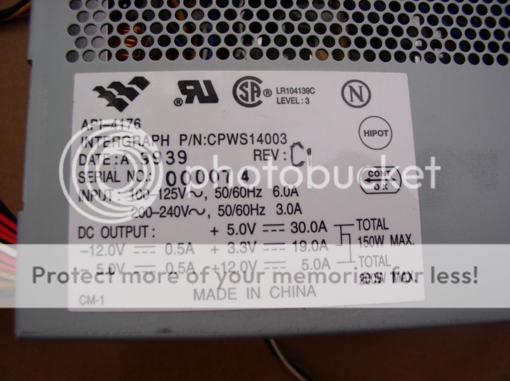

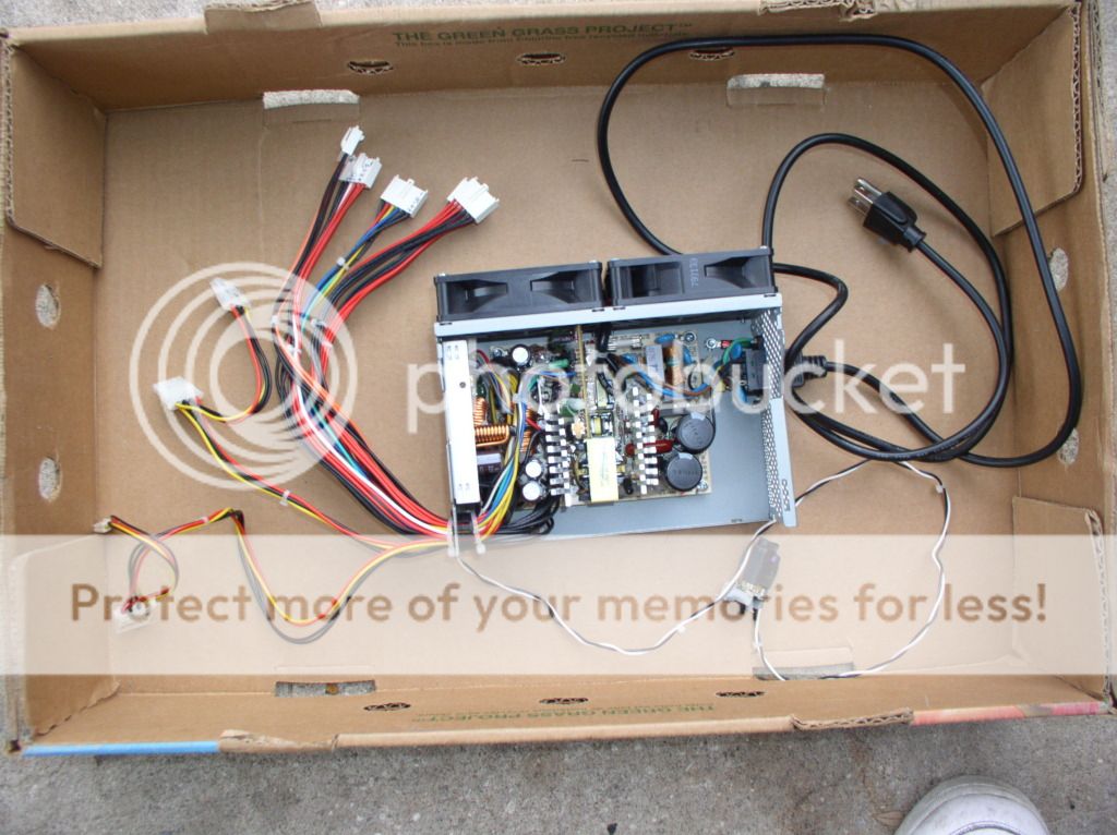

How can I make this surplus Intergraph CPWS14003 SMPS keep its 12 V output up under load and identify the missing feedback or sense connection?
This supply is actually an ATX PC power supply, and it needs the green PS_ON wire tied to ground plus a minimum load on the outputs to start and regulate properly [#21661116] After doing that, the 12 V rail worked normally with an AC/DC TV drawing about 3 A [#21661117] A follow-up test showed that green-to-black alone was not enough; adding a load on the 3.3 V output made the supply power up [#21661119]

  • Measured connector voltages and current ratings on SMPS outputs

  • Clarifying connector voltage labels and load readings

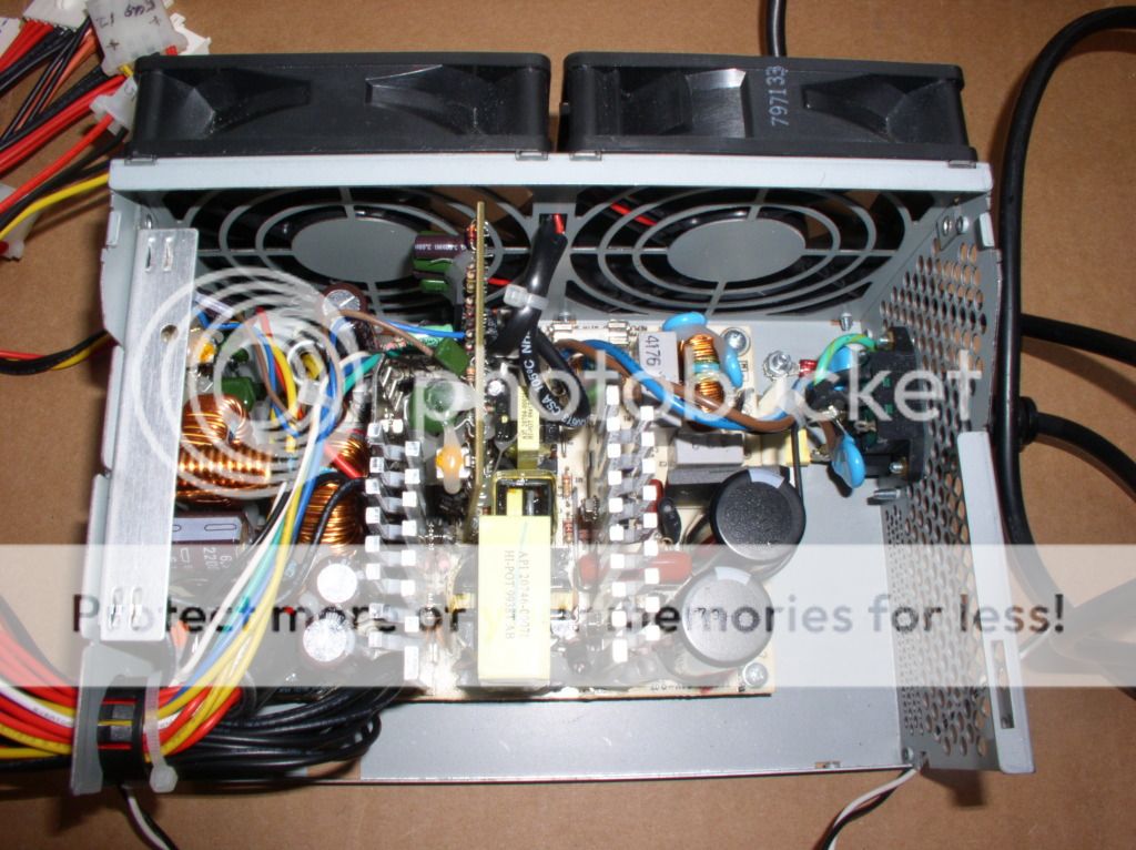

  • LM339N may handle output voltage comparison

  • ATX supply bench-mod wiring and bad capacitors

  • ATX jumper and load resistors restored SMPS output

The unit exposes multiple connectors carrying combinations of +5 V, +12 V, +3.3 V, and negatives. The label lists capacities: +5 V 30 A, +3.3 V 19 A, +12 V 5 A, −12 V 0.5 A, −5 V 0.5 A. Measure and confirm before wiring. [Elektroda, RAYMOND JACKSON, post #21661107]

Electrolytic capacitors can fail early. “There was a run of bad capacitors,” and a cap near a heatsink often suffers. Inspect and replace bulging or leaking caps before heavy use. [Elektroda, Steve Lawson, post #21661116]

An LM339N quad comparator was observed on the board. Comparators supervise voltages and control protection or feedback thresholds in SMPS designs. Supervision explains the lockout behavior before correct enable and loading. [Elektroda, RAYMOND JACKSON, post #21661115]
