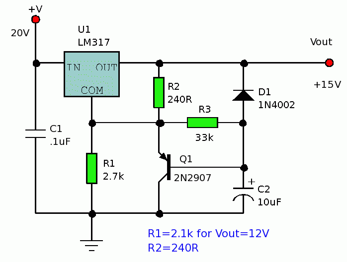

How can I add a roughly 5-second soft start to an LM334Z 2 mA current regulator so it ramps current up instead of hitting full current immediately?
Use a transistor-and-capacitor soft-start ahead of the LM334 so the current, not the voltage, ramps up; the LM334 cannot be made to rise slowly by slowly ramping the supply because it will still regulate to 2 mA once it has enough compliance voltage [#21662002] In the suggested circuit, C1 starts discharged, then charges through R2 and gradually turns Q2 on; while C1 is charging from 0 V to about 1.4 V, Q2 limits the current into the LM334 to less than 2 mA, and once C1 finishes charging the LM334 takes over [#21662002] Q1 and R1 act as a current limiter: when about 0.7 V appears across R1, Q1 turns on and begins shutting Q2 down, with the limit current roughly set by R1 ≈ 0.7/IL [#21662002] The ramp timing is temperature-dependent and can be adjusted mainly by changing C1; the original explanation notes that making it a direct capacitance-multiplier style soft-start across R1 would need a very large capacitor, around 4200 µF for a 5-second ramp [#21661995][#21661997]

The discussion centers on implementing a 5-second soft start for a 2mA current regulator circuit using the LM334Z. The main challenge is that the LM334Z, as a current regulator, maintains a constant current by adjusting voltage, causing an immediate current ramp rather than a gradual increase. Attempts to slow the current ramp by varying input voltage or using different transistor configurations were unsuccessful. A proposed solution involves using a transistor-capacitor network acting as a capacitance multiplier to create a controlled voltage ramp at the regulator's reference pin, thereby achieving a soft start. The capacitor (C2) initially discharged, charges through a resistor (R3) and transistor base, gradually reducing the transistor's conduction and allowing the output current to ramp up over time. This approach avoids the need for large capacitors by leveraging the transistor's gain. Further discussion includes designing fail-safe measures to limit current in case of regulator failure, considering fuse ratings and alternative current limiting resistors. Clarifications were made regarding the difference between current and voltage regulation, and the importance of understanding the overall application and compliance voltage to tailor the soft start design. Simulation results for an exponential current ramp circuit with specified temperature coefficient and compliance voltage were also mentioned.
