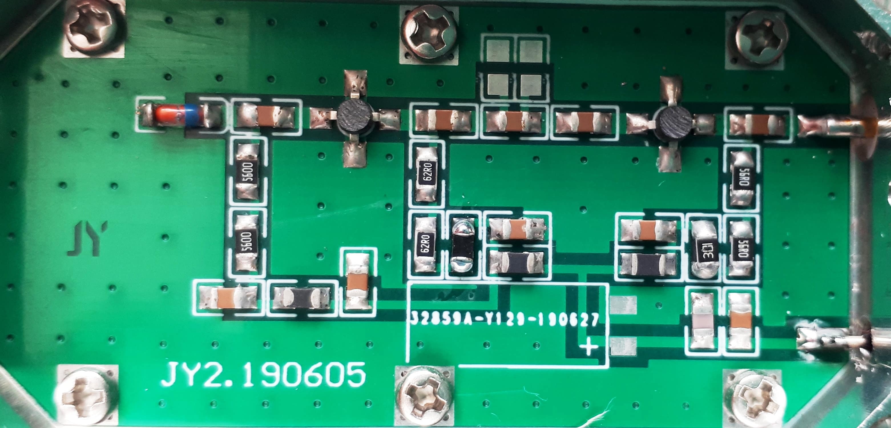

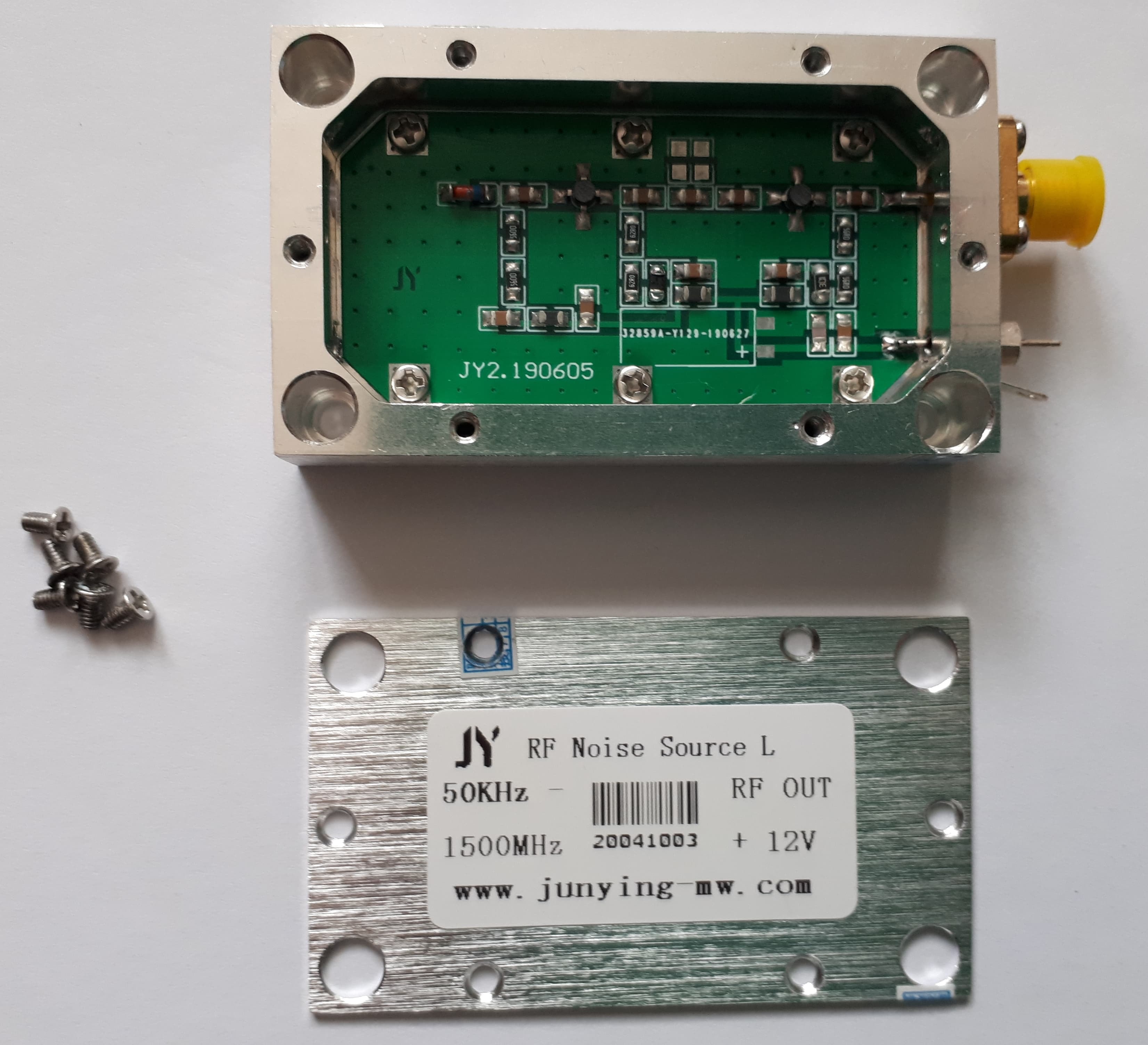

  • Zener diode and monolithic amplifier identification
    #4 21685152
    PeterTraneus Anderson
  • #5 21685153
    Virginia Loucks
  • #6 21685154
    Virginia Loucks
  • MAR-6SM+ fits as amplifier substitute with resistor changes
    #7 21685155
The discussion focuses on identifying components in a vintage Chinese noise source circuit. The component in the left corner is likely a Zener diode with the anode grounded and the cathode connected through resistors to the positive supply. Adjacent to it are four-pin monolithic amplifiers, whose markings have been intentionally erased, complicating direct identification. Analysis of the amplifier pinout and circuit connections suggests these are standard monolithic amplifiers with grounded top and bottom pins, input AC-coupled via capacitors, and output AC-coupled and DC-fed through resistor networks. The Mini-Circuits MAR-6SM+ amplifier is proposed as a compatible substitute, matching the physical package (WW107), pinout, and operating frequency range (2000 MHz bandwidth vs. circuit’s 1500 MHz). The MAR-6SM+ is noted as an exact footprint substitute for Avago’s MSA-0686, indicating the use of multiple-sourced standard parts. The circuit operates at +12V DC supply, consistent with the resistor values observed on the PCB feeding the amplifier outputs.
