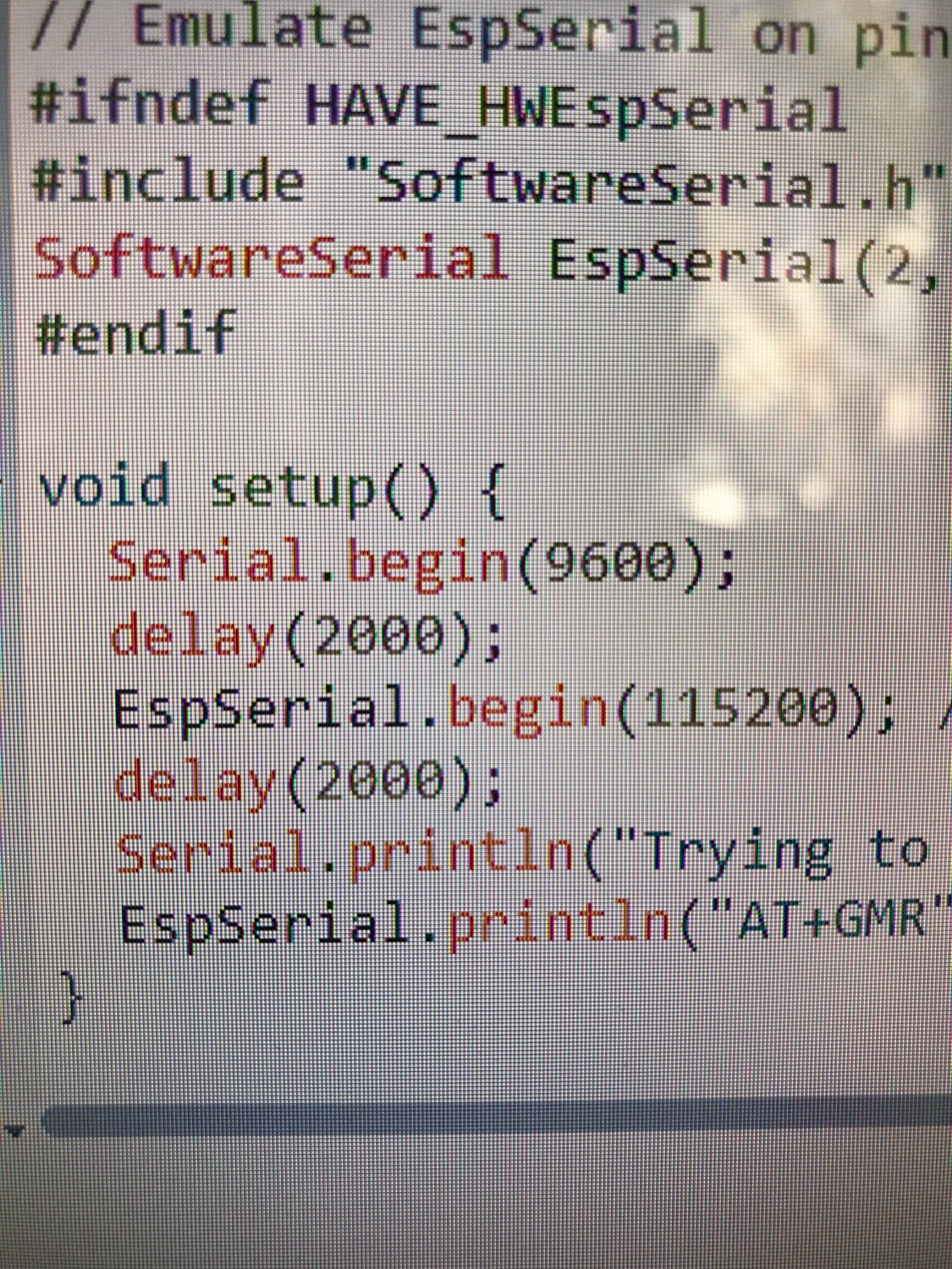

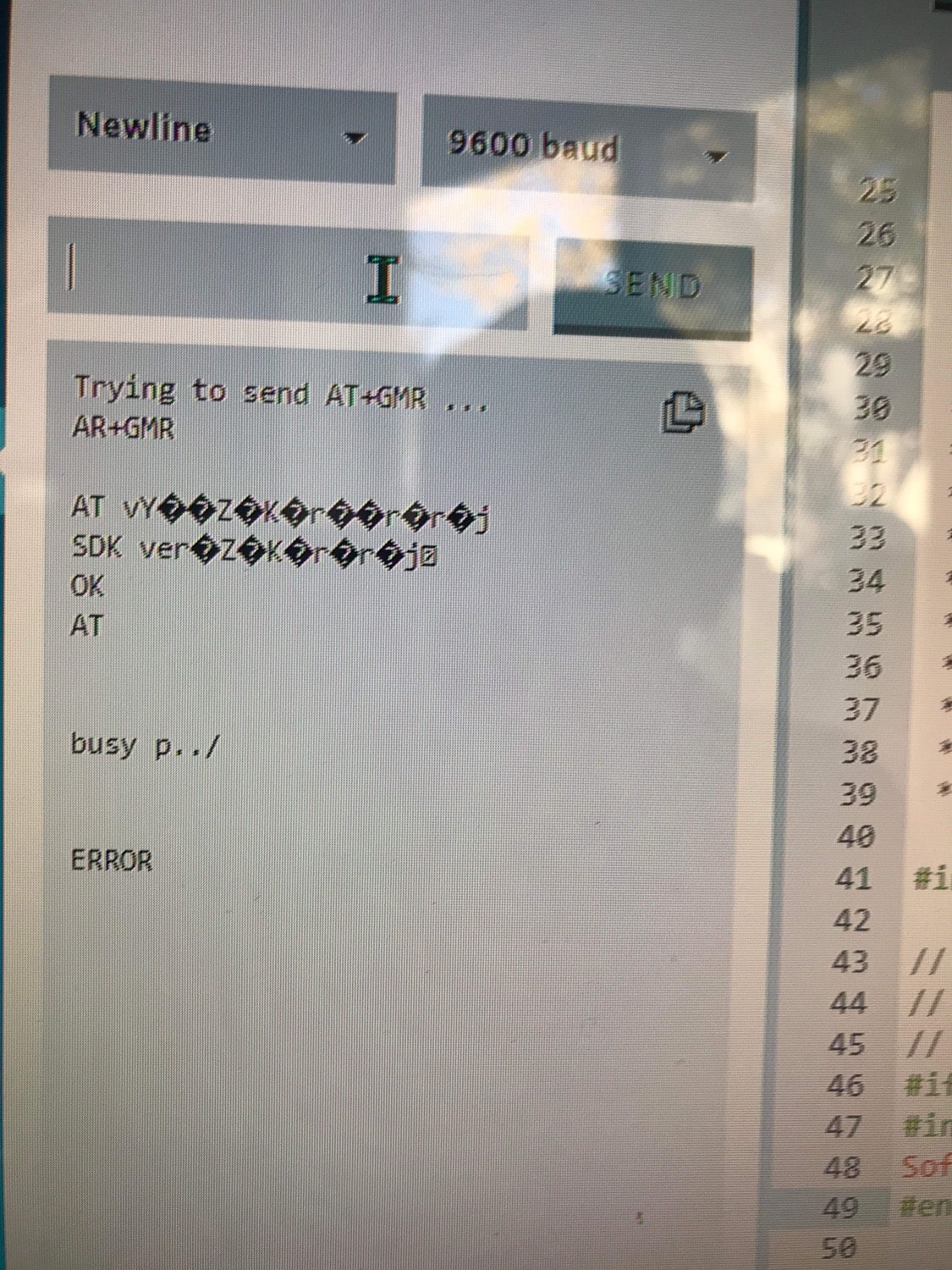

ESP01S (ESP8266) with Arduino Nano Clone, G9133 Regulator, 9g Servo: AT Commands Issue
477 2
  • ESP01S responds once, then returns busy p… ERROR

  • Check baud rate, 3.3V levels, and wiring
