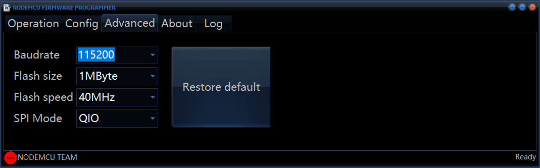

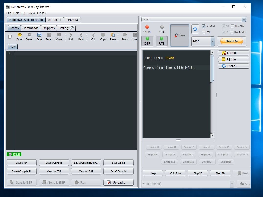

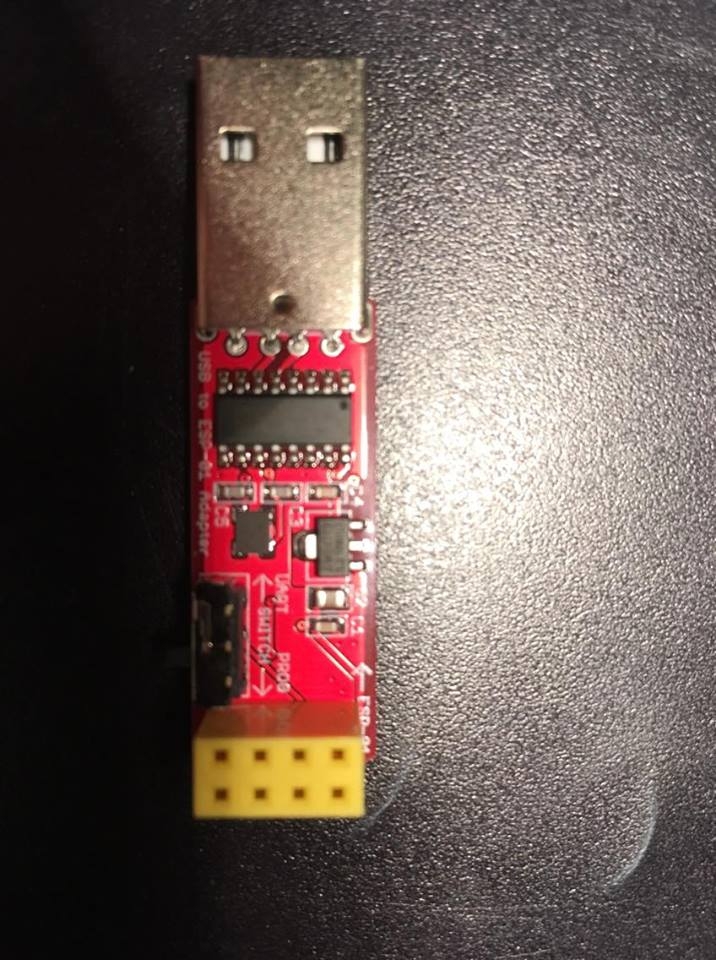

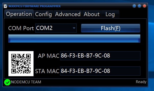

    Hello, The firmware updates, screenshot attached), however when trying to connect the chip does not respond. I've tried changing the switch setting, but it doesn't do anything. Maybe some of you have used an adapter like me and know how to solve the problem?
    ESP8266-01 firmware update but no response to connection ESP8266-01 firmware update but no response to connection ESP8266-01 firmware update but no response to connection ESP8266-01 firmware update but no response to connection .

    kamarol1
    Posts: 19

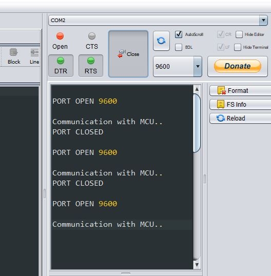

    I loaded something like this: ESP8266 v0.9.5.0 AT Firmware.bin (attachment).

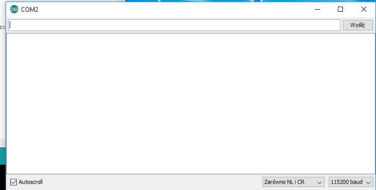

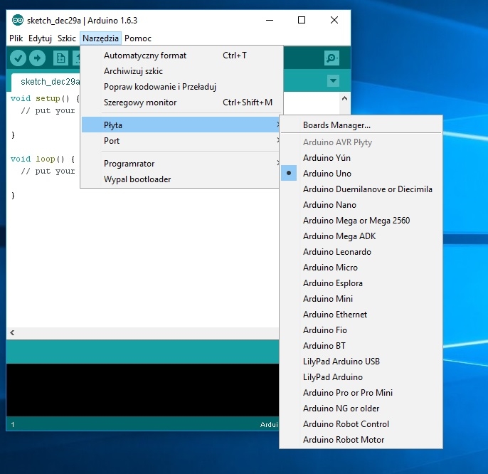

    In ESPlorer I have something like the picture. ESP8266-01 firmware update but no response to connection .
    Namely, this light should be green and has red, which I perceived as no connection. Later on the internet I searched for information that you can also connect to the ESP using the Arduino IDE (Electroconductor) which I did, but after typing 'AT' nothing pops up for me, which I guess it should.
    Forgive me if the questions are trivial, but this is the first time I've had an ESP8266 in my hands ;) .

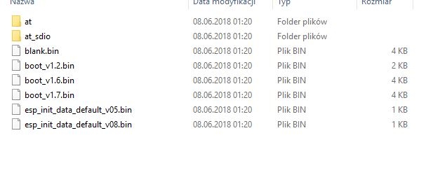

    Would you still write which file I should upload?

    The default transmission for ESP8266s, such as those from ali, is 115200, and in your case I see 9600 when uploading as well as trying to read. This way you are probably fuzzing the firmware and that's why it doesn't work.

  • Default flash baud rate likely still 115200

  • Firmware upload baud rate differs from default boot speed

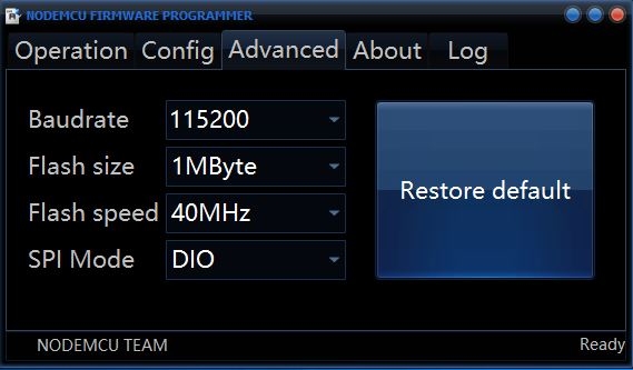

  • Incorrect ESP8266 flash layout may prevent boot
    #12 17659340

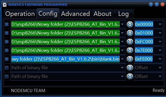

    kamarol1
    Posts: 19
    khoam wrote:
    kamarol1 wrote:
    Would you still like to know which file I should upload?
    0x00000 boot_v1.7.bin
    0x01000 user1.1024.new.2.bin (from folder "at")
    0xfc000 esp_init_data_default_v08.bin
    0x7e000 blank.bin
    0xfe000 blank.bin
    Added after 2 [minutes]: .
    simw wrote:
    This way you probably mess up the firmware and that's why it doesn't work.
    Nothing can be "fuzzed" this way.

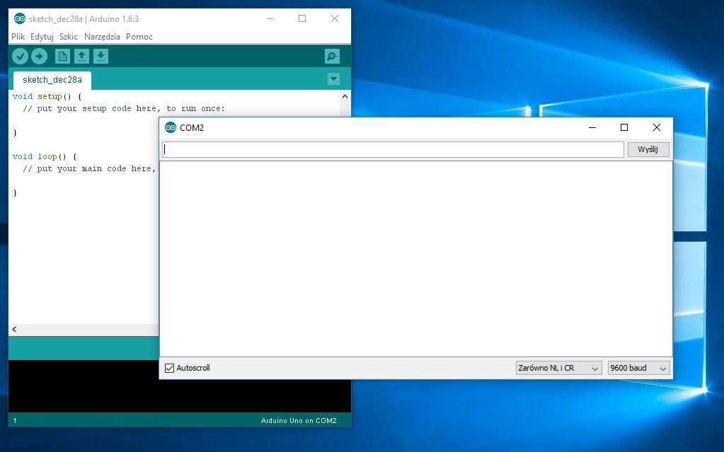

    I have uploaded this, but it still does not respond, neither in the Arduino IDE nor in ESPlorer.
    Could this have an impact ? Because 'difoltically' it is indicated, while I do not use any Arduino board.

    115200

    At no speed does it respond to the AT command.

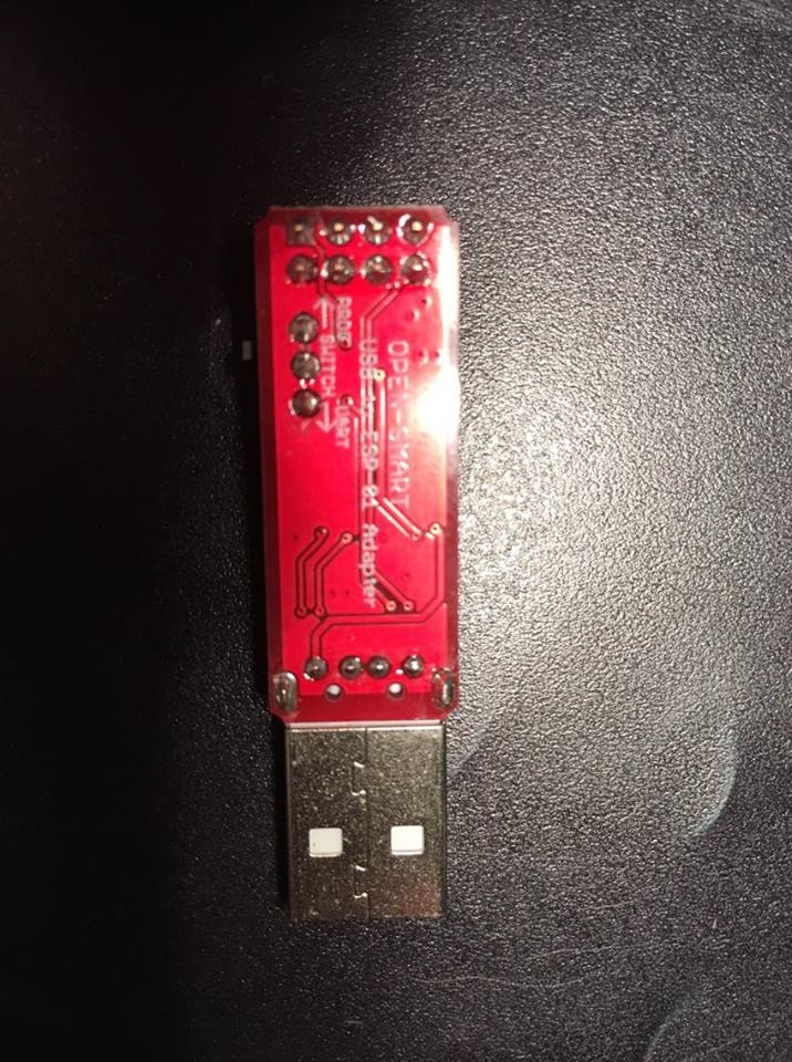

    There is a switch on the programmer, you can see it in the first post in the picture. There are Prog and UART positions. I did all the operations on Prog, while on the UART position it doesn't show the COM2 port, but that doesn't matter at this point either?

    However, it already shows COM2 but still no connection on the UART ;/.

    Does not work at any speed.

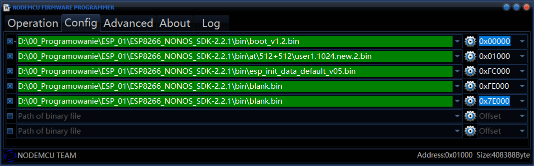

    first is boot _1.7
    second user 1.1024.new.2
    third esp_init_data_default_v08
    fourth and fifth blank

    Well and I checked, with the software I have (nodemcu firmware programmer) when uploaded with the speed set to 115200 everything works fine.
    When I set 9600 it firstly goes much slower, which of course is understandable, but still after a longer while everything is uploaded and there is communication over uart, so I was wrong :) .
    Here are my settings, in the attachment I still upload the firmware 2.2.1 maybe this will help the author of the thread.

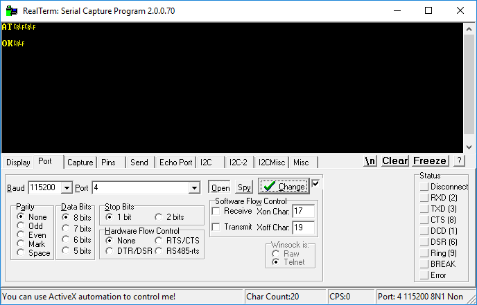

    In addition I recommend RealmTerm for communication with ESP, it makes things easier, for me the serial monitor with Arduino is too simple a tool.

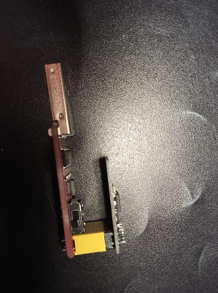

    This programmer does not support flashing ... when it is without the additional button which in the top photo 3 from the top is covered by a black field 8)
    Solder a bridge between 3v3 - EN
    Solder a tac switch between io0 - GND
    https://zapodaj.net/97a860e2a079f.gif.html here how to solder it
    1) you insert into the port a programmer with a switch to serial YOU HAVE SERIAL IN THE CONSOLE e.g. putty
    2) you insert the programmer with the serial switch into the port and at the same time press the soldered button, after inserting it you can release it and all programs will go away, finally your ESP
    3) you insert the programmer with the switch to PROG into the port, you can load sketches e.g. from Ardurino of course without pressing ...
    The jumper does not interfere with anything
