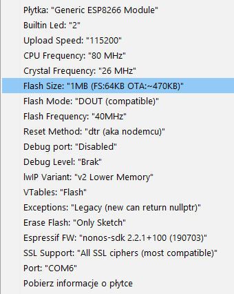

    Uploading AT firmware to the ESP8266 is some kind of failure.
    The ESP-01 module talked nicely over AT after purchase (I won't say not without a fight, but as it turns out it was my mistakes)
    Next in the task queue was to connect under the Andruino IDE and some demo software - reprogramming went and it works.
    Now trying to get back on Firmware AT - i..... drama. Different combinations of flashing softwares give different results, one doesn't go without a word another displays errors like "ESP efuse". The firmware "ESP8266 download tool" requires parameters the meaning of which it does not even explain (not to mention that they are highly detailed, such as memory mapping - can't it read this for itself from the module?).
    Interestingly, the Arduino IDE programs it with 100% success rate.
    I tried esptool.py, which is installed with the Andruino IDE (because this one apparently somehow manages it), and again it clings to the dependencies of pyserial.py, which is of course installed, but the dependencies are watched over by the Arduino IDE and so cannot be called from a finger.
    I don't want to junk myself and install a separate instance of python, esptool, pyserial etc.
    OK, question - isn't it possible to upload this AT firmware somehow magically from the Arduino IDE? this one somehow manages to deal with memory maps without pointing a finger.

    Thanks, I installed esptool on another computer where I don't have the Arduino IDE - and it worked there.
    I managed to load some binary composition ESP_8266_BIN0.92.bin that works with AT but I think it's quite old.
    And trying to load the individual boot/user/init/blank packages in version 1.7 succeeds - only it doesn't work :) .
    I suspect that I have incorrectly matched the software to the version.
    Trying to upgrade directly from AT commands - AT+CIUPDATE also ends in Errorem (after going through steps 1,2,3,4 correctly)
    I need an AT command for the ESP-01 board, which is identified by the Arduino IDE as follows:
    How to successfully upload AT firmware to ESP-01 module? ESP errors efuse, esptool.py, pyserial.py. .
    Sorry but I'm getting lost in the multitude of these versions, branch....

    It works, thanks a lot - indeed the 1.6 could be loaded with this esptool.
    Anyway - selecting this software to suit your needs - is not a simple matter.
