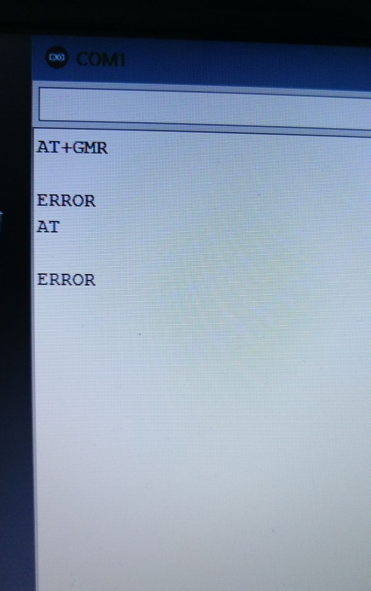

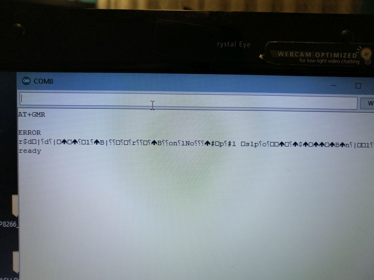

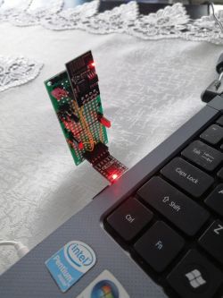

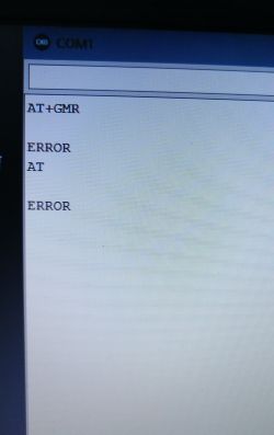

    This is my first 'approach' to these modules. I bought 3pc. + adapters for programming on CP2104, FTDI 232RL, CH340. Diagram according to which I made the connections: ESP01: Difficulty uploading ESP8266_AT_Bin_V1.6.2_0 firmware via Flash Download Tools v3.8.5 .
    I have also added a reset button. External power supply, power supply ground, esp01 and adapters connected. I start the arduino, on the serial port monitor after a reset to 74880kb I have this notification: ESP01: Difficulty uploading ESP8266_AT_Bin_V1.6.2_0 firmware via Flash Download Tools v3.8.5 .

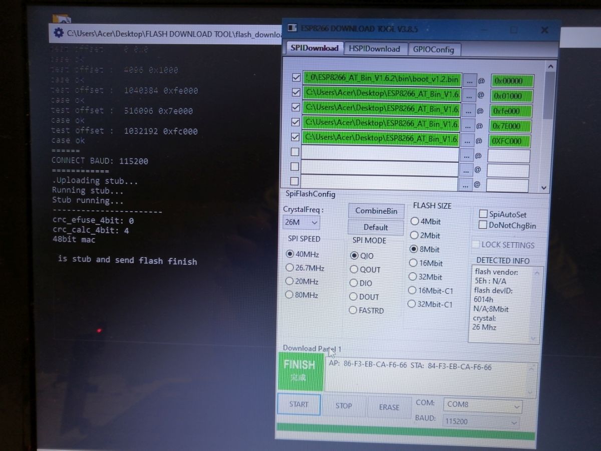

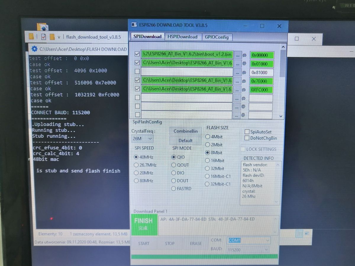

    I run Flash Download Tools v3.8.5, Firmware to upload is ESP8266_AT_Bin_V1.6.2_0, address map setting to upload according to readme.md. file, GPIO0 on ground, I press start : ESP01: Difficulty uploading ESP8266_AT_Bin_V1.6.2_0 firmware via Flash Download Tools v3.8.5 .
    At the end, a message like this: ESP01: Difficulty uploading ESP8266_AT_Bin_V1.6.2_0 firmware via Flash Download Tools v3.8.5 .
    Attempting to issue AT command : ESP01: Difficulty uploading ESP8266_AT_Bin_V1.6.2_0 firmware via Flash Download Tools v3.8.5 .
    After checking the firmware version in the port monitor it is still the same : ESP01: Difficulty uploading ESP8266_AT_Bin_V1.6.2_0 firmware via Flash Download Tools v3.8.5
    I have the same thing on every adapter, no commands.
    Please any advice from colleagues on the subject, what am I doing wrong.

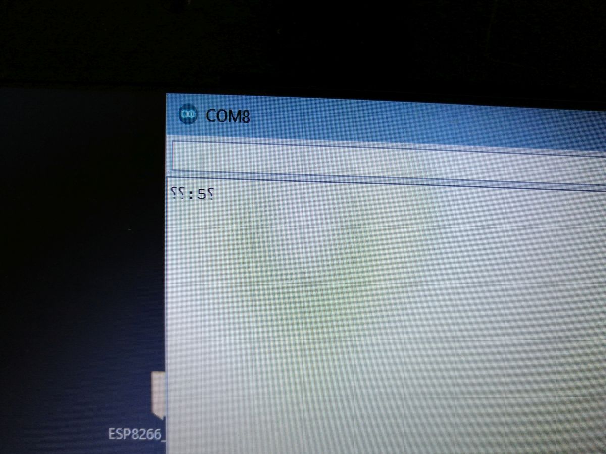

    88xtc
    Posts: 36

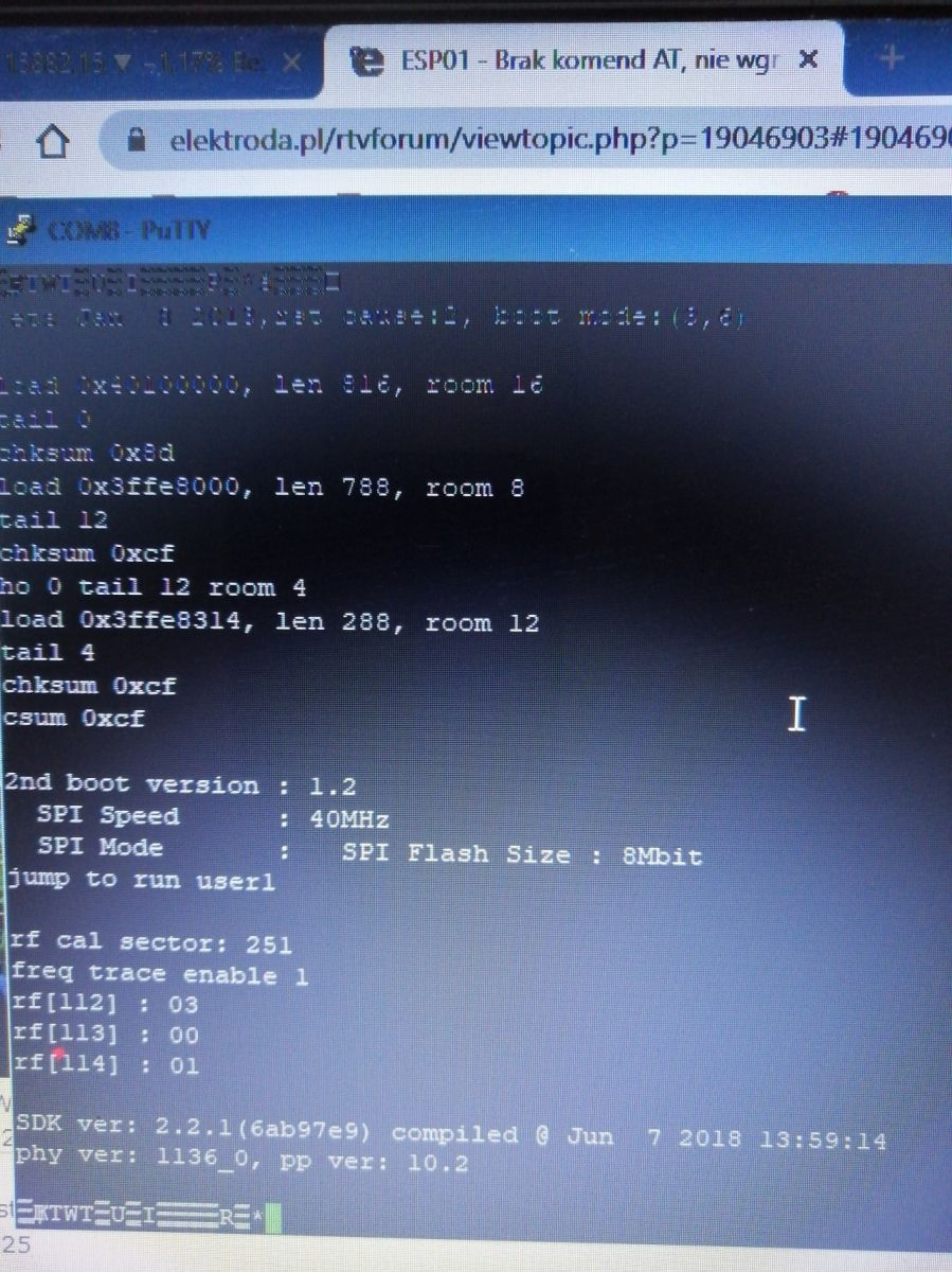

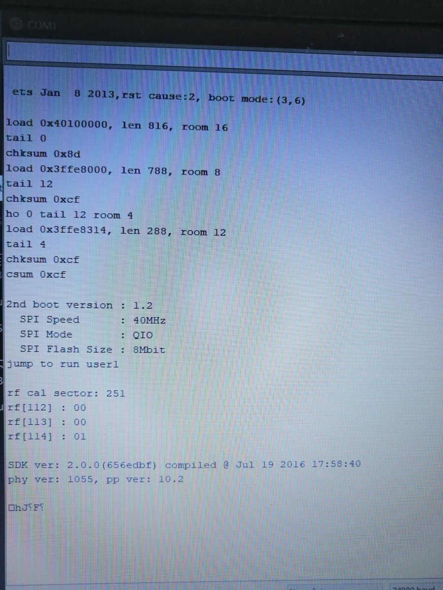

    I have already corrected the memory address map settings for the upload: ESP01: Difficulty uploading ESP8266_AT_Bin_V1.6.2_0 firmware via Flash Download Tools v3.8.5 .
    And the situation after uploading: ESP01: Difficulty uploading ESP8266_AT_Bin_V1.6.2_0 firmware via Flash Download Tools v3.8.5 .
    On the AT+GMR command at 74880kb it responds with screams: ESP01: Difficulty uploading ESP8266_AT_Bin_V1.6.2_0 firmware via Flash Download Tools v3.8.5 while after a reset at this speed I have feedback about what I have uploaded.
    At 115200kb after issuing the AT command it responds: ESP01: Difficulty uploading ESP8266_AT_Bin_V1.6.2_0 firmware via Flash Download Tools v3.8.5 while a reset at this speed results in a dump of bushes instead of feedback.

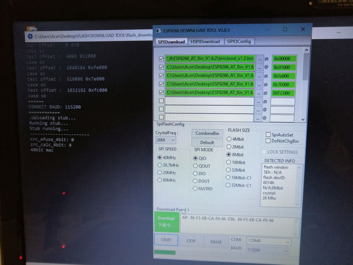

    88xtc
    Posts: 36
    I just cleaned + uploaded this firmware from AT, still the same as before. Is it possible to deduce from these circuit feedback messages that it is faulty ?

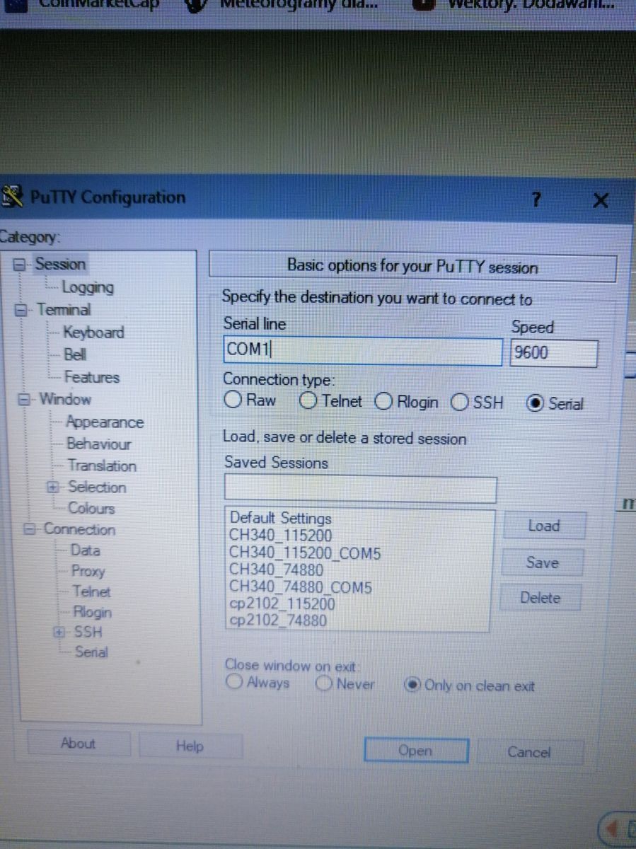

    88xtc
    Posts: 36
    The terminal built into the Arduino that is this serial port monitor and Putty. W
    Putty I open a session, serial - select the port on which CH340 is visible, set the speed and that's it. ESP01: Difficulty uploading ESP8266_AT_Bin_V1.6.2_0 firmware via Flash Download Tools v3.8.5 .
    One more thing, I don't know if it matters but when I upload a sketch via ArduinoIDE and even though the sketch uploaded doesn't work, the Esp continues to broadcast the WiFi signal. I thought that if I upload anything via Arduino then the uploaded sketch will act as firmware and Esp should not work in AP mode after that ? Sorry for such 'peasant' reasoning but I am describing as much as I can.

    AT uploaded with DOUT option, on 115200kb AT+GMR responds Error, on 9600 silence, on 74880 bushes.
    Strange that after a reset it doesn't state what mode the SPI is in: ESP01: Difficulty uploading ESP8266_AT_Bin_V1.6.2_0 firmware via Flash Download Tools v3.8.5 .

    DIO didn't change anything either, it returns ERROR after issuing any command, on 74880 after a reset it returns the information correctly. The ones I am trying to flash are 'ordinary' ESP01s. Today 4pcs of esp01 have arrived including one esp01S and a Nodemcu V3 through which I will also try to upload something on esp01. If the situation repeats itself, then it's either an adapters fault or something with the ports ? I will report back from the battlefield on Wednesday. Thanks a lot for the support so far !
    Do you take care in the terminal to add the appropriate characters at the end of the line after typing the command? Depending on the terminal this can vary. In the Serial monitor with the arduino, "Both NL and CR" should be selected.
  • GPIO0 must return to VCC after programming

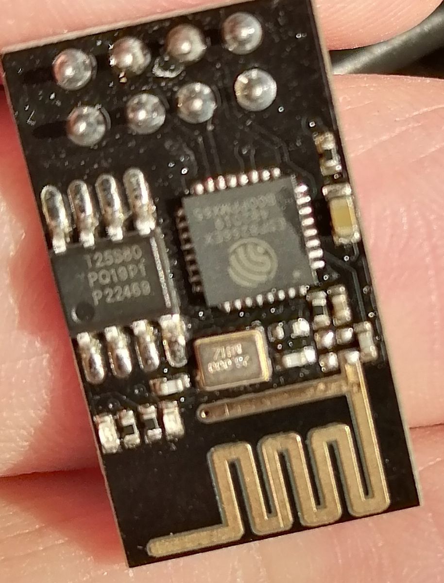

    khoam wrote:
    If you uploaded a photo of the "lid" of these modules, it would be possible to have a closer look.
    From what I read the esp01 on the blue pcb had 512kB. I can't take a better photo with what camera I have.

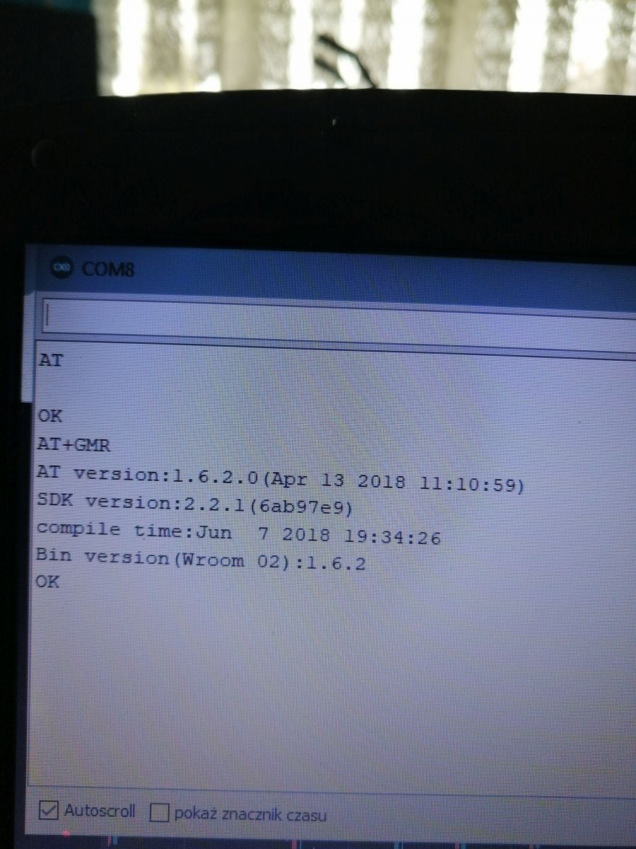

    simw wrote:
    In the Serial monitor with the arduino it should be selected "Both NL and CR"
    I inserted and it works, every AT command. I have wasted several days looking for a problem where there is none, leaving me with 7pcs of esp01 to use :) .

    No CR LF characters inserted at the end of commands
