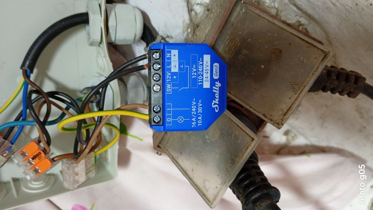

    I need to replace the Shelly Gen3 Wifi relay located in the detached garage that is used to open the gate with one that will work with the TaHoma switch panel located in the house next door. What device should I replace the current WiFi relay with?

    The reason for the replacement is that the gate is to be able to be controlled from a dedicated application for the TaHoma switch panel. This Shelly is connected to the contacts that allow the gate to be controlled by e.g.: a monostable wall switch.

    Beninca with HEADY 24 controller

    I am aware that I will not see my gate as a gate in the Somfy app. I was thinking more about whether it would be possible to implement opening the gate using a relay with ZigBee 3.0 communication. I found something like this: Shelly 1 Gen4, or OXT T250. The question is whether either of these relays will connect to the TaHoma switch and be seen in the application e.g.: as another device.
