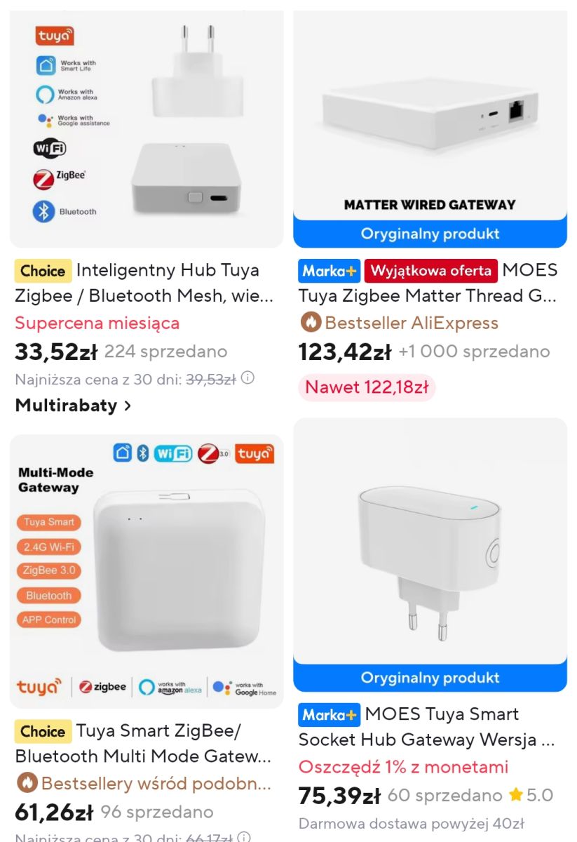

    Any gateway that supports zigbee and bt. For my part, I recommend the one with the integrated power supply. Less cumbersome.

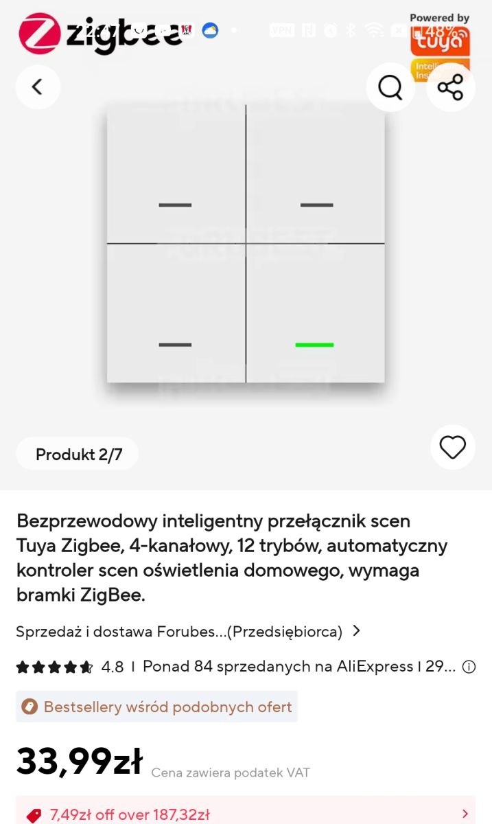

    Screenshot showing four different Zigbee and Bluetooth gateways from a shopping platform
    And if you want automation without reaching for your phone. Then you buy buttons and make yourself the appropriate scenes.
    Four-button Tuya Zigbee wireless scene switch, one button lit with green light
    Here you have a four-button one. It allows you to program 12 scenes.
