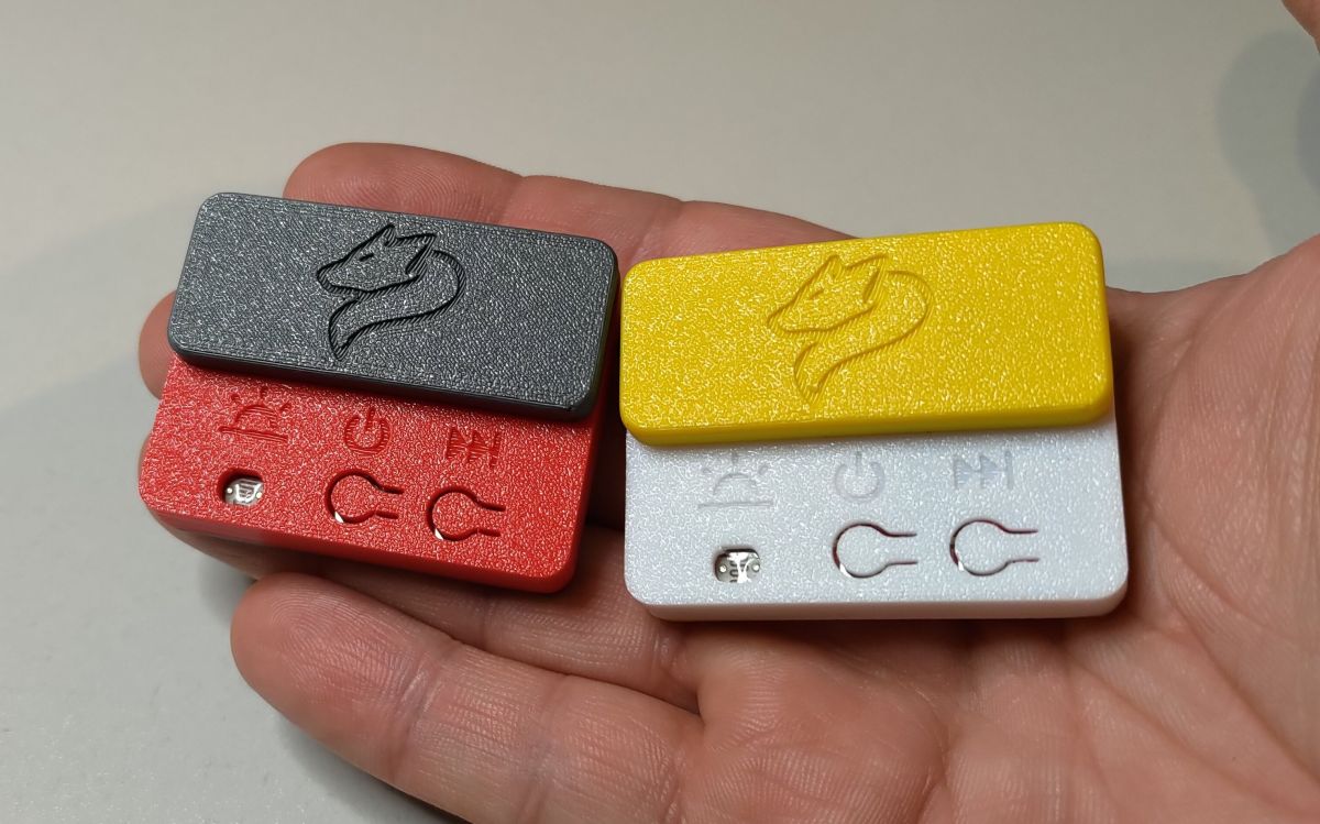

  • Two compact audio players in 3D-printed cases resting in a hand.

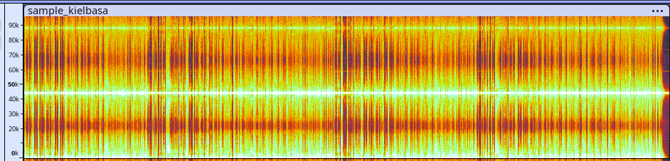

    Initially, I set the PWM to generate the waveform at 176.4kHz, which was intended to pull the potential squeal far out of hearing range. A new sample was taken every four waveforms, giving a final sample rate of 44.1kHz. Unfortunately, such PWM conjugation limited playback to 8 bits - more could simply not be achieved at 48MHz clocking.
    As an experiment, I dispensed with sampling every 4 passes and increased the range to 10 bits. A 44.1kHz squeal is not audible to the ears anyway, but 10bits definitely is.
    At first I planned to add some basic dithering, but 10bit turned out to sound so much better that I abandoned the idea for now.

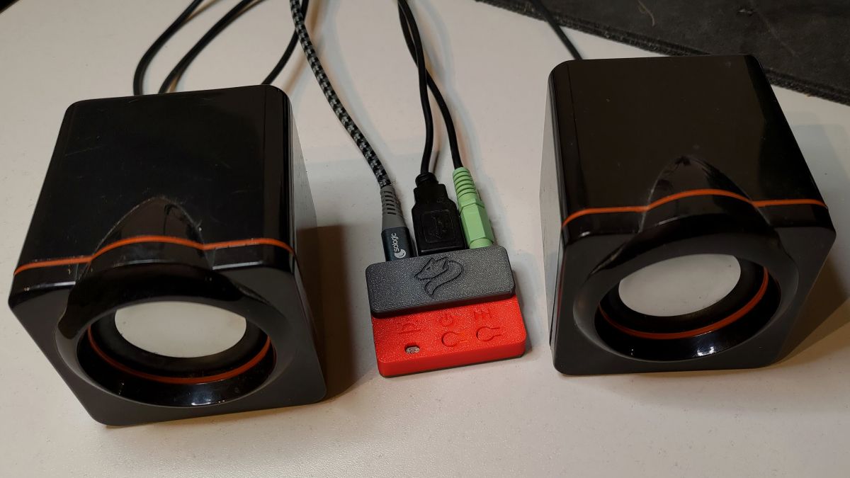

    The device was designed to work with cheap USB-powered computer speakers, so it has a built-in USB power output, which can be switched off together with playback (small power saving), or run all the time.

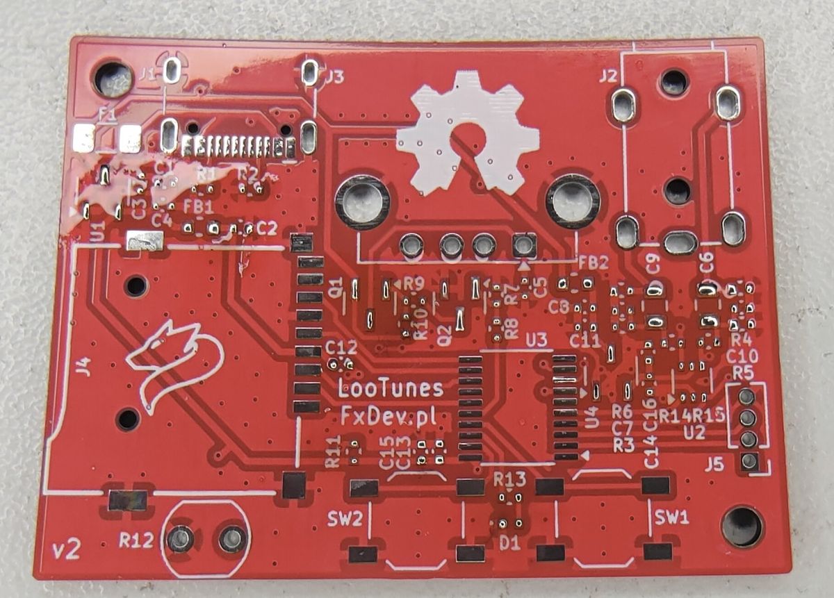

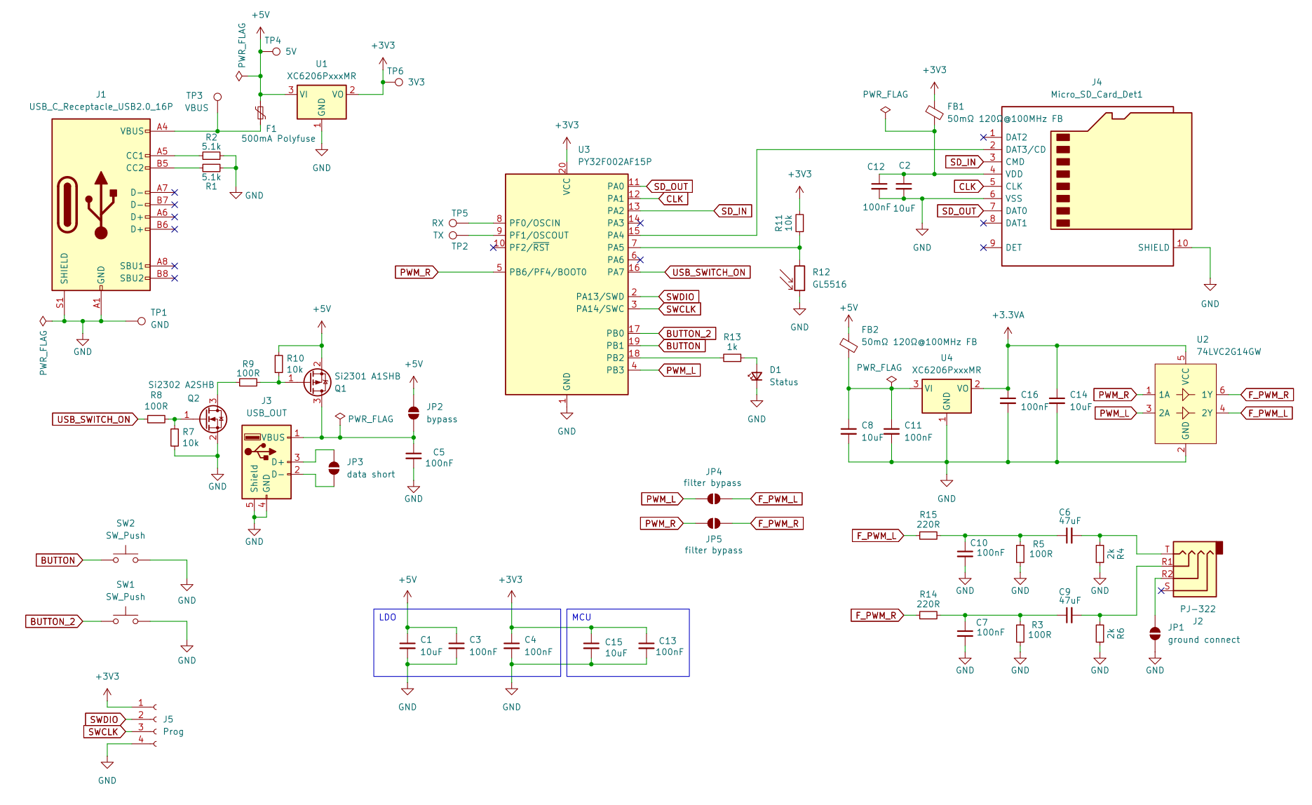

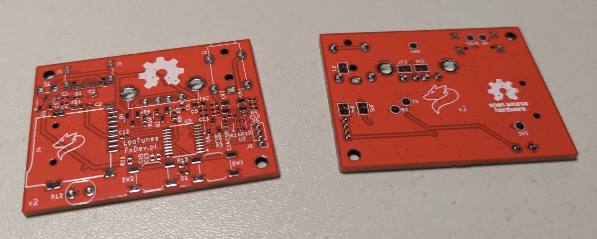

    Schematic and PCB:
    The schematic diagram and PCB were designed in KiCAD and the PCB was manufactured in a cheap PCB shop. The PCBs are double-sided, any normal PCB manufacturer should seamlessly produce them in the cheapest option.
    Schematic diagram of a small audio player with PY32F002AF15P microcontroller
    Two red PCBs with LooTunes FxDev.pl and a fox logo, populated with SMD pads

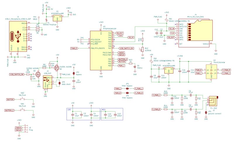

    The main microcontroller is Puya PY32F002AF15P6TU, used as PY32F030. All the pieces I checked worked, but the manufacturer does not guarantee the existence of the peripherals I am using.
    The whole thing is powered at 3.3V by two "662K" type stabilisers - very cheap and common clones of the XC6206P332MR. The second stabiliser is used to power the buffer to the sound on the 74LVC2G14GW.
    Schematic the entire audio output is almost 100% copied from the Raspberry Pi, only there the more expensive NC7WZ16 is used, which can also be inserted here without any modifications. It's just a buffer, so it sounds the same.
    In the first version there was no buffer but only a low-pass filter and unfortunately the operation of the memory operation card was very clearly audible. Adding a separate 3.3v stabiliser and buffer has SIGNIFICANTLY improved the sound quality.
    I have made jumpers on the PCB that can be soldered to omit the second stabiliser and buffer - it will work, just worse.
    There's also a jumper to cut the ground from the mini jack - I wanted to avoid a ground loop when feeding the speakers from the USB A socket of the device, but in practice you're unlikely to hear the difference.
    I realise that the low-pass filter used will absolutely not help the PWM carrier: 44100Hz. In the attached samples it is clearly visible, but under normal conditions it is not audible.
    As far as I know, it is not possible to construct a simple low-pass filter at 44100Hz that would not massacre the treble.
    The USB A socket control is implemented on 2 standard Si2302 and Si2301 mosfets. I wouldn't overload this port, but for USB speakers it's enough.
    There is a jumper, which allows you to omit this part of the circuit as well and not fill the transistors - then the port will always be on. You can, of course, leave the port unmanned if you don't need it.
    The circuits used are cheap enough that the sockets may turn out to be the most expensive part of the whole.
    Programming is done via the SWD socket, and for programming and all development I used probably the cheapest possible programmer: a debugprobe based on the Raspberry Pi Pico. You can buy a clone of the board from the Chinese for as little as a dollar, and the original one is also very cheap.
    There is a chance that other programmers like J-Link or maybe even ST-Link will work. I programmed the whole thing with PyOCD, previously aided by my 'dirty' OpenOCD fork with Puy support added.
    I thought it would be possible to program the board via a simple USB-TTL adapter, but the RX and TX leads on the pads were connected to pins other than those used by the built-in bootloader....
    If anyone gets carried away with recreating the design I would be happy to help with programming.

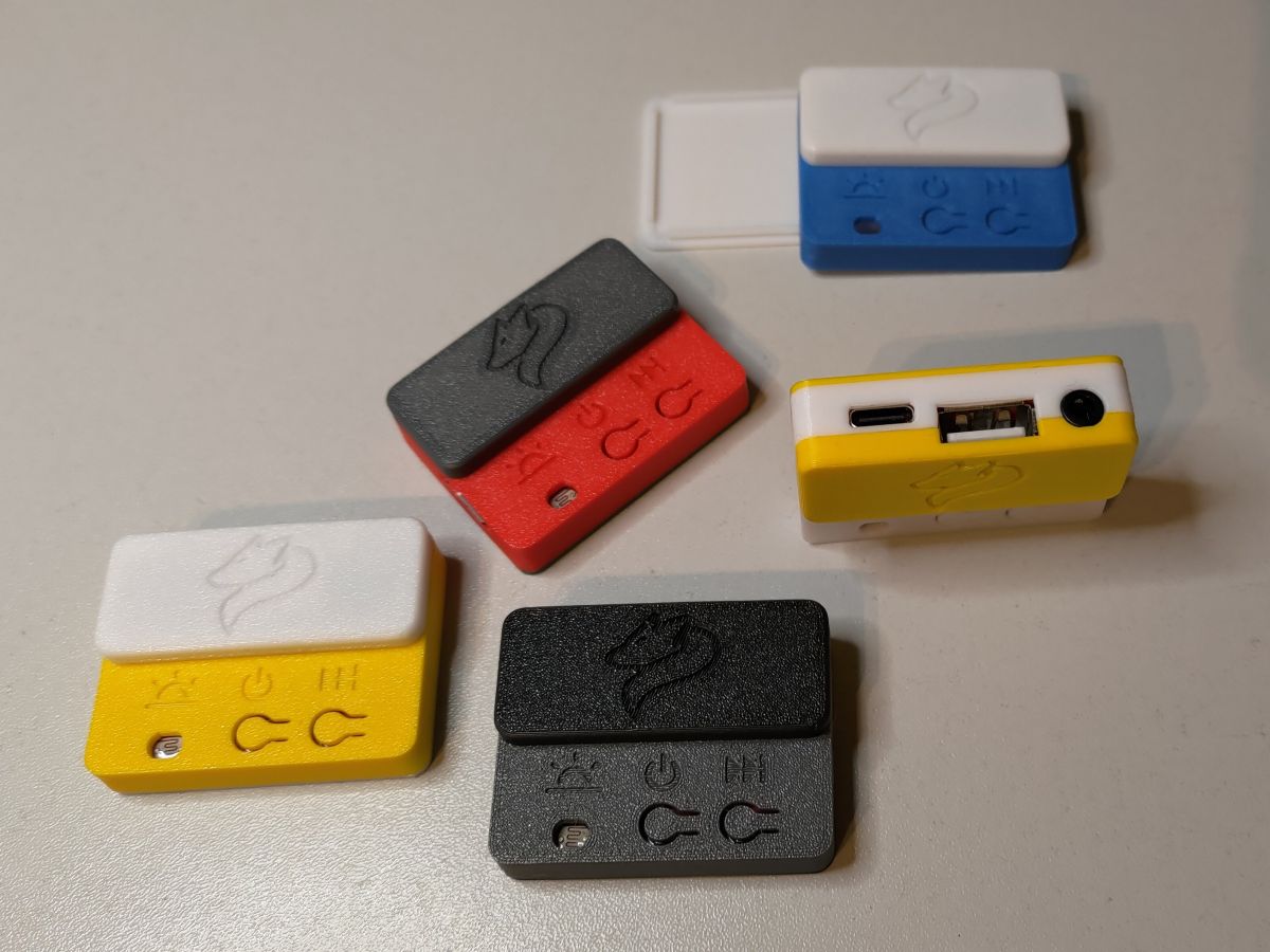

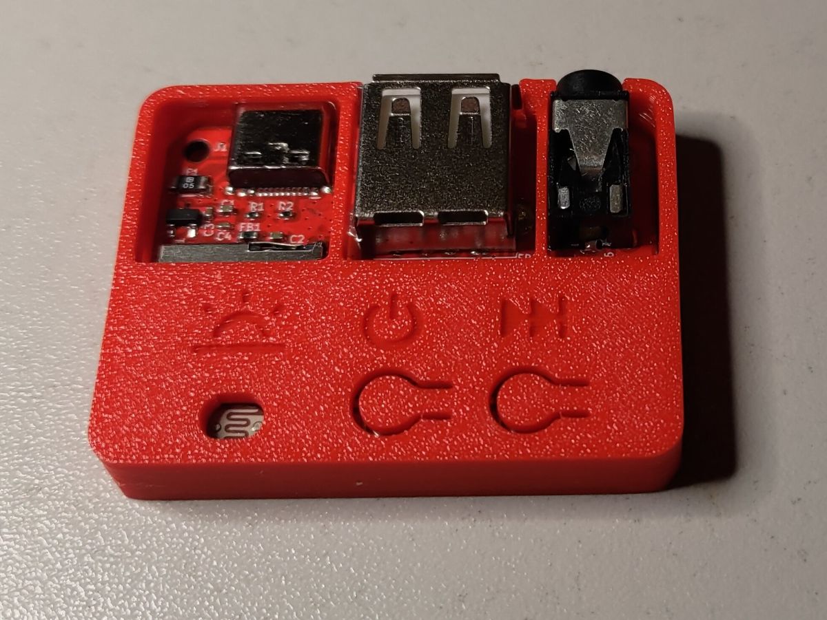

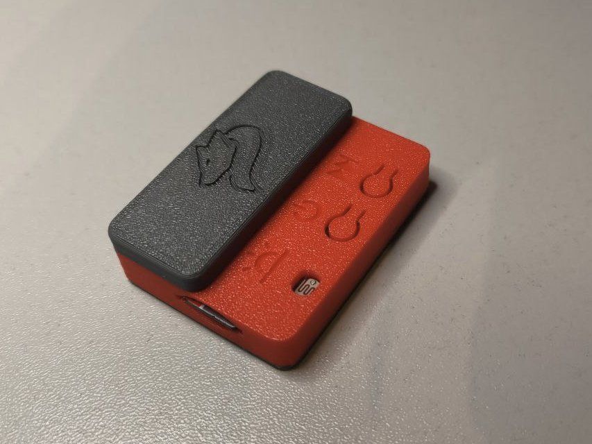

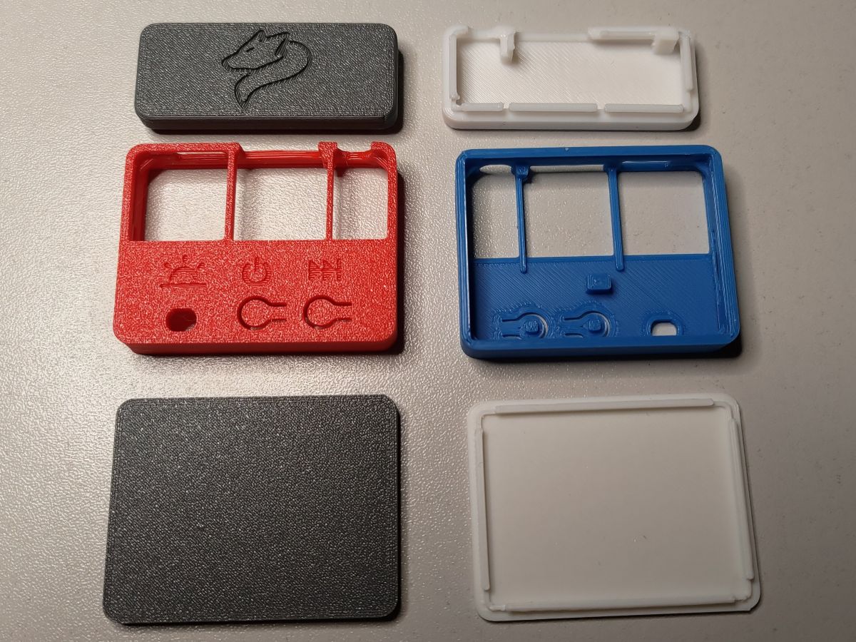

    Housing:
    Four 3D-printed enclosure parts in different colors laid out on a desk
    The enclosure was designed in Blender and made by 3D printing. It is divided into three relatively easy to print pieces, which tightly graft together using snaps.
    I left 2 mounting holes on the PCB which were ultimately of no use - everything sits stably without screws.
    The whole thing is simple to print, only working cooling is required to make a few curves. In addition, the adhesion of the layers must be good enough that the hooks do not break during assembly.
    It is possible to print completely without supports, positioning the objects flat so that nothing - apart from the indentations for the ports - hangs in the air. By printing the three elements separately, a variety of colour variations can be achieved without a special printer :)
    The whole thing weighs about 8.5g and prints in less than 30min on a faster printer.
    Probably the best effect is when printed on a rough PEI base - this gives a slight texture that hides imperfections in the print.

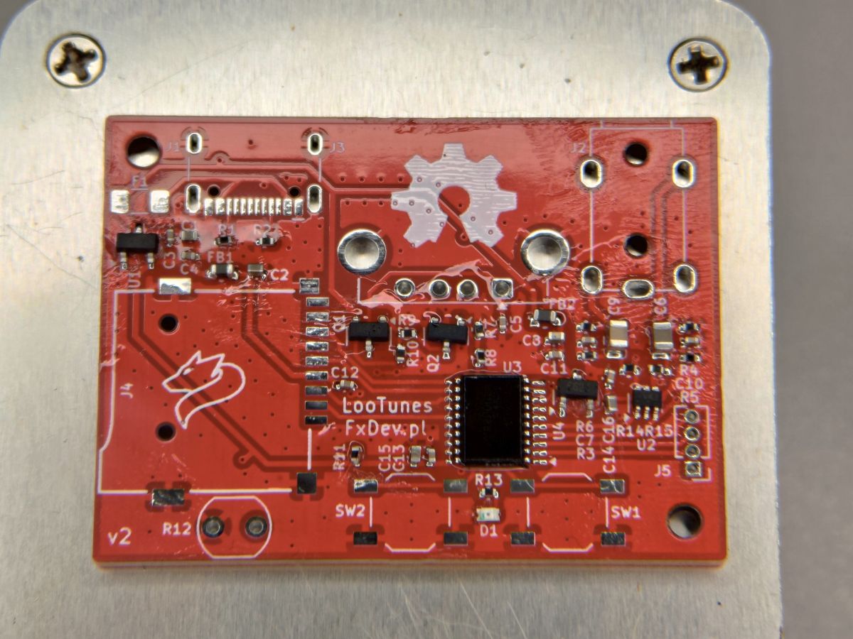

    I soldered the PCB myself, although for a fee you could ask the PCB manufacturer to cast the components.
    I started the whole thing by greasing everything with flux and tinning the pads of the smaller components.
    Red PCB with white silkscreen, labeled “LooTunes” and “FxDev.pl” at the center
    I then soldered the MCU, the positioning was not perfect but I found that I would improve it at the next stage.
    I placed the PCB on a small hotplate and turned on the heating. The tin melted and with some adjustments with tweezers, the components settled into place.

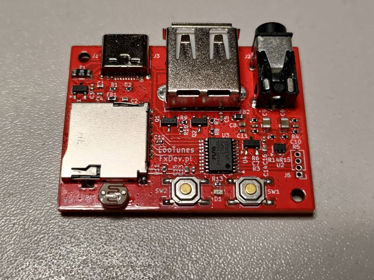

    Red LooTunes PCB with microcontroller and SMD components mounted.
    Finally, I soldered the through-hole components, USB port, buttons and memory card slot with a soldering iron.
    Close-up of red LooTunes PCB with USB ports, mini-jack, and control buttons
    After assembling the components, it is worth checking that 3.3V is being generated correctly. If it is, you can connect a programmer/debugger and upload the software.
    After inserting a properly prepared card (and enabling the appropriate mode), the music should start playing.
    I start assembling the chassis by inserting the PCB into the centre piece (body). The PCB needs to pop satisfactorily into its slot and the buttons need to start clicking.
    Small music player in red casing with USB, mini-jack connectors and light sensor
    I then push in the 'cap' on top and the base carefully, which completes the assembly of the unit.
    Small device in a red and black casing with two buttons and a USB Type-C port.

    Everything you need to create and develop the project: schematic, project in KiCAD, enclosure as well as the whole firmware is available on my github:
    https://github.com/l0ud/LooTunes
    The licence is MIT.
    For those who just want to reproduce the project, I invite you to the assets directory, where there is already built FW and Gerbery for PCB production:
    https://github.com/l0ud/LooTunes/tree/master/assets
    In the attachments I provide the same, files latest at the time of writing the message.
    In addition, I am adding 2 audio samples: a new sausage type track, and something with a higher dynamic range where the imperfections of the 10bit audio will be more audible.
    I originally recorded them specifically lossless with a higher sampling rate to show the 'carrier' pwm at ~44100Hz. It is clearly visible on the spectrogram:
    Spectrogram of an audio file showing dense high-frequency components
    Unfortunately the forum will not accommodate such large files. So in the end I put the samples in a 44100Hz mp3 to evaluate the audible bandwidth ;)

    In terms of hardware, there have been 3 iterations. The first was a version on a breadboard (in an adapter I made myself), with a soldered Sd-MicroSD adapter that served as a card slot. On this I first proved that what I wanted could be done (stereo playback without clipping on a "gold" card).
    Then I designed a PCB version one (it's on the repo) which seemingly worked, but I made without knowing it some passive two-stage low-pass filter which clipped way too low. Go could be bypassed, but whatever I did, the noise from the memory card played first fiddle. In v2 I copied the buffer idea from the Raspberry Pi and already achieved acceptable quality without card squeaks.
    Damian_Max wrote:
    I'm asking because I'm curious and you also wrote that you discovered peripherals from outside the documentation as I understand xD.
    The documentation is there, you just need to read the reference manual for py32f030 instead of py32f002 ;)
    Of the featurs that should not be there I use:
    - PLL (up to 48MHz)
    - DMA
    - SPI with divider 2 (should be slower)
    - additional 1kB of ram
    - an extra 12kB of flash memory (well, actually the whole thing takes about 28kB)
    - TIM3
    - TIM14
