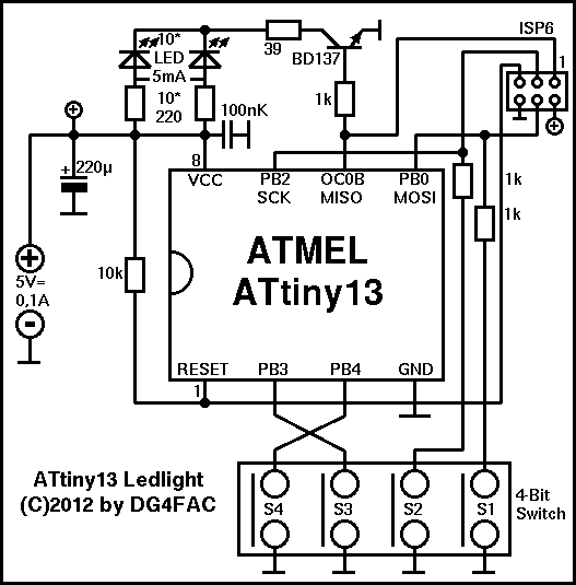

  • :smile: Over 10 years ago Gerhard Schmidt DG4FAC on avr asm tutorial.net (site already not exists) :cry: presented such a circuit :idea: LED effect based on ATtiny13
    LED schematic with ATtiny13 microcontroller and 4-bit switch interface

    ;   H A R D W A R E
    ;          ____________
    ; RES o--|             |--o VCC
    ;        |     AT      |
    ;  S3 o--|             |--o S2/SCK
    ;        |    tiny     |
    ;  S4 o--|             |--o OUT/MISO
    ;        |     13      |
    ; GND o--|             |--o S1/MOSI
    ;        |_____________|
    ; Input port bits
    .equ bS1In = 0
    .equ bS2In = 2
    .equ bS3In = 3
    .equ bS4In = 4
    ; Output port bit
    .equ bOut = 1
    ;  H O W   T H I N G S   W O R K
    ; Processor:
    ;   Operates with 1.2 Mcs/s clock
    ;   Default R/C oscillator dived by 8
    ;   Default fuse settings
    ; Timer 0:
    ;   Operates as fast PWM with TOP=15
    ;   System clock prescaled by 256
    ;   f(PWM) = 293 c/s
    ;   OC0B controls PWM ratio (0 .. 15)
    ;     OCR0B set by lower nibble of control byte
    ;     sets OC0B output on restart,
    ;     clears output on compare match
    ;   OC0A sets TOP and interrupts
    ; Timing of cycles:
    ;   Upper nibble of control byte sets number
    ;     of PWM cycles (16 to 256)
    ;   Results in times between 0.055 and 0.88 seconds
    ; Input switches:
    ;   S1: if set dims down LED by half current (PWM / 2)
    ;   S2: accelerates speed by 16 (cycle duration / 16)
    ;   S3, S4: selects program
    ;     00: LEDs on and off seven times
    ;     01: linear up and down of LEDs
    ;     02: sinewave-type LEDs
    ;     03: anything from 00 to 03 in sequence

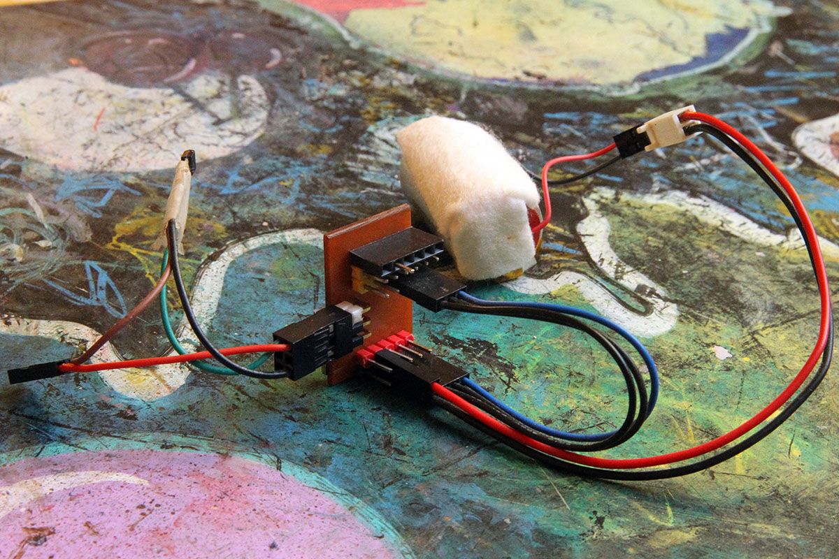

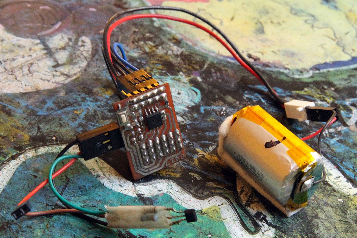

    😊 Taking inspiration from it I made my version from a universal board (my DIY) with attiny13 , a traistor on a spider and a star with diodes 🛠️
    Close-up of DIY circuit with wires and ATtiny13 board
    DIY board with ATTiny13 microcontroller and Li-Po battery on a work surface

Which ATtiny13 pins do I connect for switches and LED output?
Use PB1 (OC0B) for the LED or LED driver. Map switches to PB0 (S1), PB2/SCK (S2), PB3 (S3), and PB4 (S4). VCC, GND, and RESET wire per the ATtiny13 standard. The code defines these bits and enables pull‑ups for the inputs. [Elektroda, ACeK, post #21772947]
How do I change brightness and speed during runtime?
S1 halves LED current by halving the PWM duty. S2 accelerates the effect timing by 16×. S3 and S4 select the effect program.

What PWM frequency and timing does it use?
Timer0 runs Fast PWM with TOP=15 and prescaler 256, yielding about 293 Hz PWM. The upper nibble sets cycle counts, producing steps from roughly 0.055 to 0.88 seconds per segment. This avoids flicker while keeping soft transitions. [Elektroda, ACeK, post #21772947]

What hardware did the builder use in this thread?
A DIY universal board with an ATtiny13, a discrete transistor on flying leads (“spider”), and a star‑shaped LED assembly. The post includes photos, a HEX file block, and a video link showing the effect. [Elektroda, ACeK, post #21772947]
What fuse/clock assumptions does the code make?
It assumes default fuses: internal RC oscillator divided by 8, giving about 1.2 MHz CPU clock. Timer0 and the ISR are configured for those defaults, so set fuses accordingly if flashing a blank chip. [Elektroda, ACeK, post #21772947]
How does the interrupt routine drive the LED effect?
The Timer0 overflow ISR decrements a cycle counter, then fetches the next table byte via Z from flash. It packs duty (low nibble) to OCR0B and timing (high nibble) to set cycle length, with zero as a table terminator to switch sequences. [Elektroda, ACeK, post #21772947]
