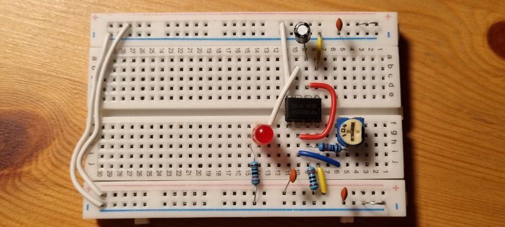

    Breadboard with NE555-based flashing LED circuit in astable mode
    To create a circuit that generates a flashing LED, we will use the NE555 chip in astable mode. Here is the list of components needed to build the circuit:
    Components:
    - NE555 integrated circuit - the main component of the circuit that will generate the pulses
    - resistors (R1, R2) - resistors that, together with the capacitor, determine the frequency of the generated pulses
    - capacitor (C1) - capacitor that works with the resistors to set the pulse duration
    - LED (D1) - a diode that will flash in response to the generated pulses
    - potentiometer (P1) - adjusts the frequency of the LED flashes
    - power source (e.g. 9V battery) - provides power to the circuit. (I used the power supply I presented in the previous article)
    How does the circuit work?
    The NE555 chip in astable mode acts as a continuous pulse generator. This works as follows:
    Capacitor charging - The capacitor (C1) charges through the resistor (R1) until it reaches a voltage of about 2/3 of the supply. At this point, the output (pin 3) of the circuit is in a high state and the LED lights up.
    Capacitor discharge - when the voltage reaches 2/3 of the supply, the NE555 circuit starts to discharge the capacitor through resistor (R2). When the capacitor discharges to a voltage of 1/3 of the supply, the circuit output switches to a low state and the LED goes off.
    Repeat cycle - the process of charging and discharging the capacitor repeats, resulting in the generation of rectangular pulses. The LED flashes in response to these pulses.

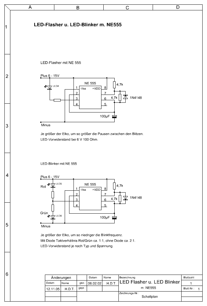

    Here I add a diagram from another article, but the construction is similar for each circuit.
    Schematic of two LED blinking circuits using the NE555 timer IC

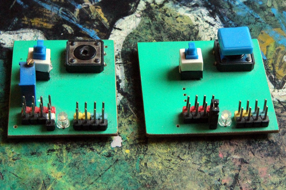

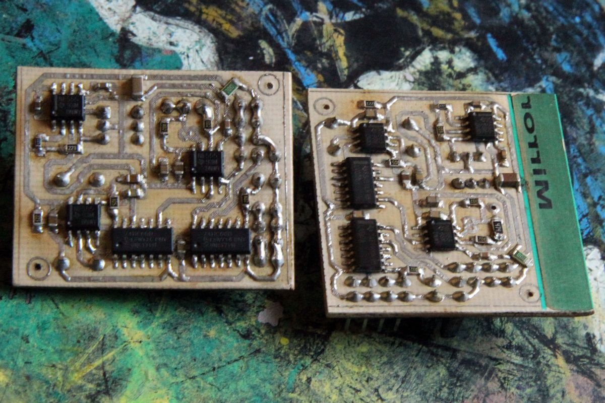

    :smile: Ben Eater has developed a type of clock for electronic circuits :idea: in the lead role 555 in three different working arrangements 🛠️ exact description is on YT in four parts 🎥
    😇 Based on his layout I made my version 😛
    Two green electronic modules with buttons, pin headers and LEDs
    Two PCBs with integrated circuits and visible soldered traces.
