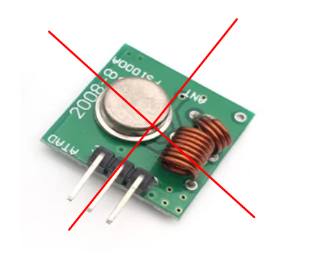

    It worked well, but the main problem there is that the remote has 5 channels and can control 5 blinds but @DeDaMrAz has 6 in the apartment. So we have to find something else that would work on all 6. Initial search showed some RF boards like FS1000 or CC1101 that can let us skip the remote altogether. First FS1000x boards were considered:
    FS1000A RF module crossed out with a red X, indicating it was rejected
    but we figured quickly it was not going to be feasible, mostly because of a lack of control in the transmission and overall instability and inability in HW for ASK/OOK modulation.

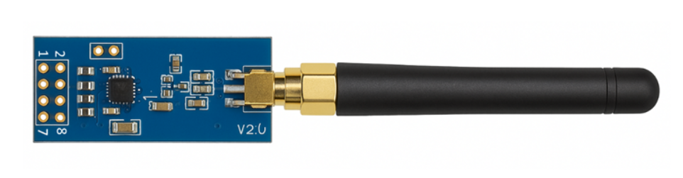

    From there we decided to move on with the CC1101 chip which is a 315-915MHz transceiver. Data sheet can be found here - https://www.ti.com/lit/ds/symlink/cc1101.pdf
    The same chip is a basis of Flipper Zero, so certainly it can handle many protocols while it does not require a very powerful MCU to run. ESP can drive it fine.
    CC1101 RF module with black antenna and blue PCB
    CC1101 modules arrived and we hooked everything up and after installing Tasmota and configuring all, it worked well from the first go! Results were verified it with Flipper Zero – everything is sent correctly. But the problem was it was not meant for the protocol Dooya blinds are made for, it was meant for Somfy based motors and control not Dooya that target blinds are based on. But the overall idea and implementation was flawless!

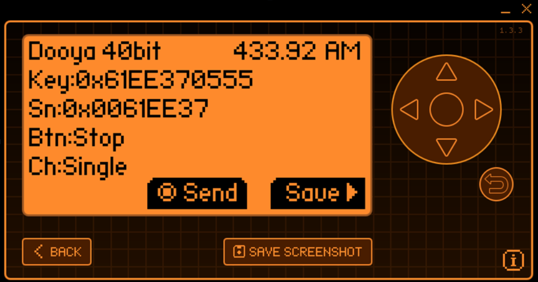

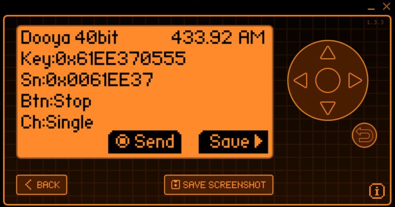

    That's why we decided to create our own yaml from scratch. The basics were figured out from all the repos and issues how to configure the module and create yaml file, etc. Furthermore, Dooya protocol is well known and some information can be seen here:
    https://github.com/omerl13/raspberrypi-rf-dooya-controller
    It uses 433.92MHz frequency, employing a proprietary system often requiring specific ID codes and payload structures, uses ASK/OOK modulation for data transmission, headers, and checksums. As Flipper Zero is able to capture the signal here is the original remote STOP button capture from flipper.
    Flipper Zero screen showing captured Dooya signal at 433.92 MHz (Stop, single channel)
    In general, decoded signal looks like this:
       KEY:0x61EE37 05 55 - > STOP:  id=0x0061EE37, ch=5, btn=5, check=5

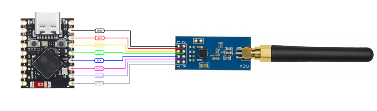

    After initial success, we've decided to choose the smallest ESP32 modules at hand - ESP32-S3 Super Mini were available, and we wired everything up like so:
    Wiring diagram of ESP32-S3 Super Mini connected to CC1101 RF module with antenna

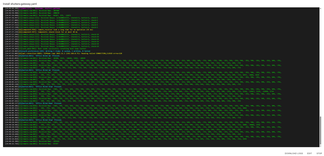

    This gave some initial success, it can actually read and decode signals from the remote, both in raw form and decoded as per Dooya protocol :
    ESPHome console showing green log of Dooya RF signal decode and transmit
    First success. We can read codes without Flipper and integrate them into our “final” ESP build. Now to enable transmission on CC1101 and ESPHome there are some tricks but also, we had to move from that PR#6300 that we used initially to Radiolib:

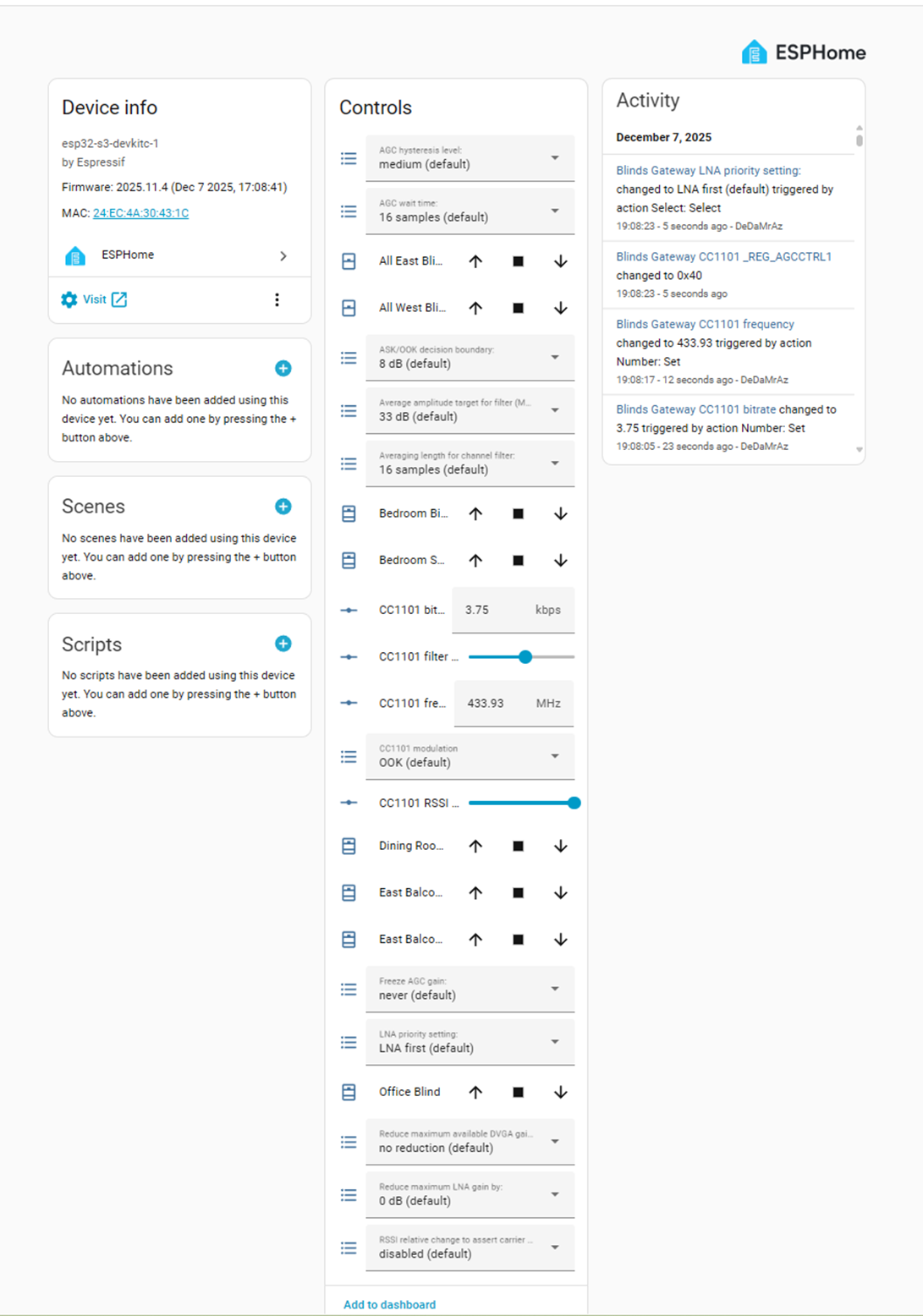

    ESPHome dashboard with blind gateway and CC1101 module settings
    There is now a possibility to control various aspects of CC1101, tweak and polish timings and intervals but it works and we’ll continue improving it.

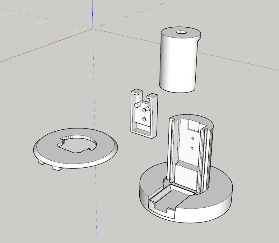

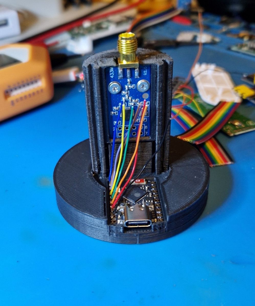

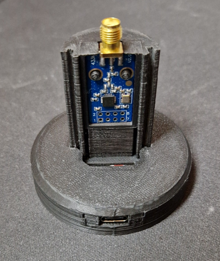

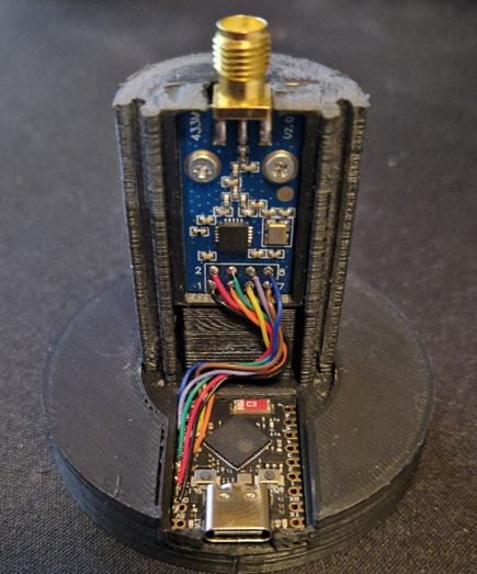

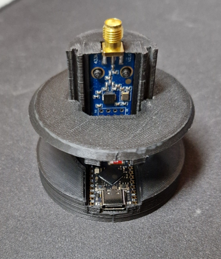

    3D-printed enclosure
    Once everything is done, small enclosure was also designed for it as a 3D model and printed. It took several attempts due to various 3D-printing tolerances. Sketchup file attached - ESP32-S3 and CC1101 enclosure V6.skp.
    3D visualization of disassembled enclosure for ESP32-S3 and CC1101 controller
    And this is the current final result, not ideal or pretty but it works:

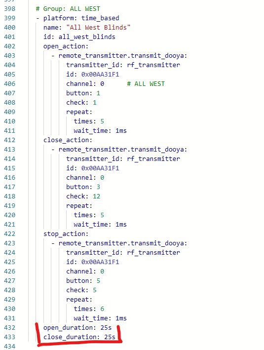

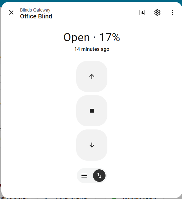

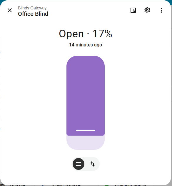

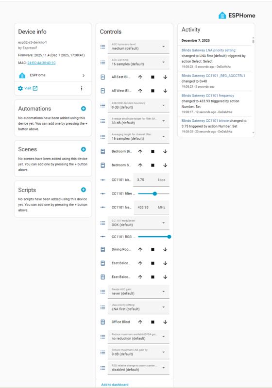

    So, it's important to mention that such shutters have to calibrated - the opening/closing time depends on shutter length, gears and the motor.
    ESPHome config snippet with blind open and close duration set to 25s
    Once configured and calibrated, they can be opened and closed and moved to any fraction in Home Assistant:
    Home Assistant control panel for office blind; currently 17% open
    Office Blind control panel in Home Assistant, blind open at 17%

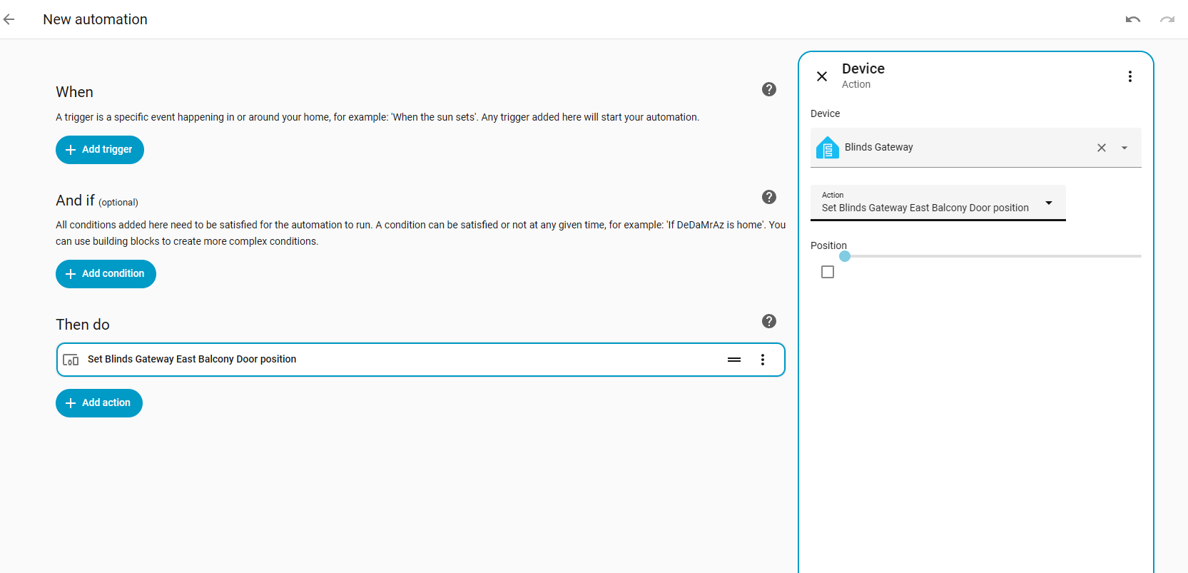

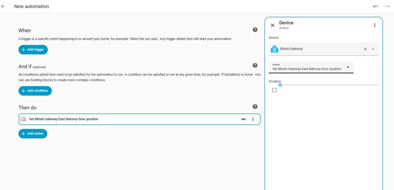

    They can also be used in Home Assistant automations, so you can, for example, open them in the morning automatically.
    Creating new automation to set Blinds Gateway East Balcony Door position

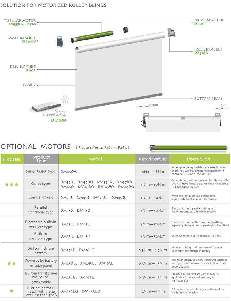

    Reworking the RF remote from the roller shutter so that it works with WiFi and Home Assistant
    We didn't dismantle the Dooya roller shutters themselves so basically we don't even know exactly where the antenna is there, we just made a new "remote control" for them.

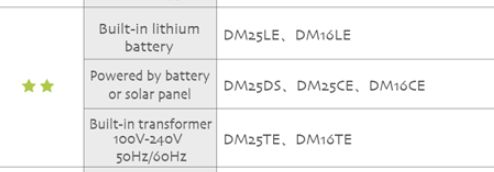

    How long does a charged battery last? What is the power consumption in standby mode? Have you considered Zigbee communication ?
  • #5 21782122
    Posts: 14762
    Rate: 12892
    There are different types of these blinds, but here are the ones presented that are powered normally from the mains. Only the RF remote control has a battery, it lasts for more than a good year, but it depends how much you use it.
    Table showing three power types for blinds and corresponding DM models
    However, our "gateway" on the ESP32 is powered by USB, so it too is permanently connected.

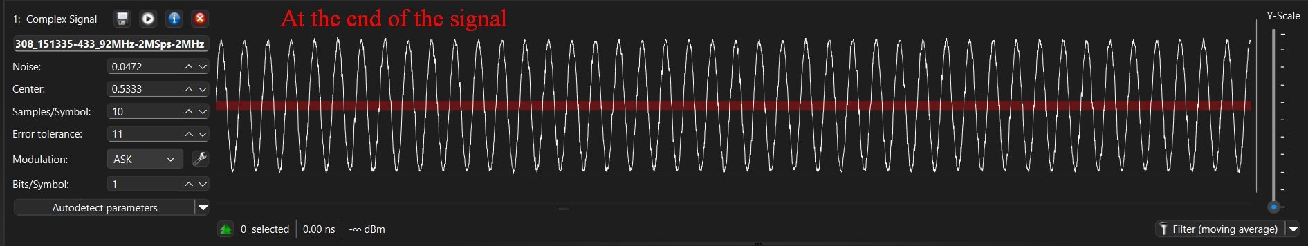

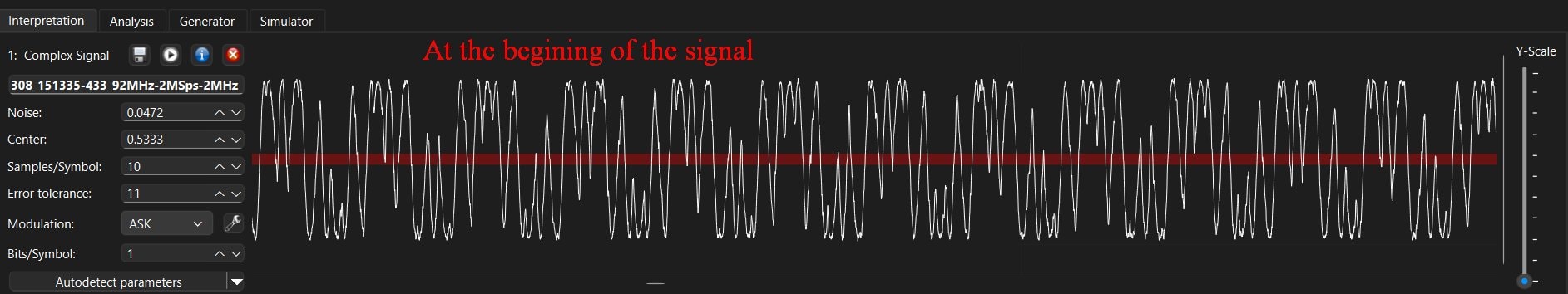

    So I ended up my work with my BIDI Dooya remote (DD1805H).

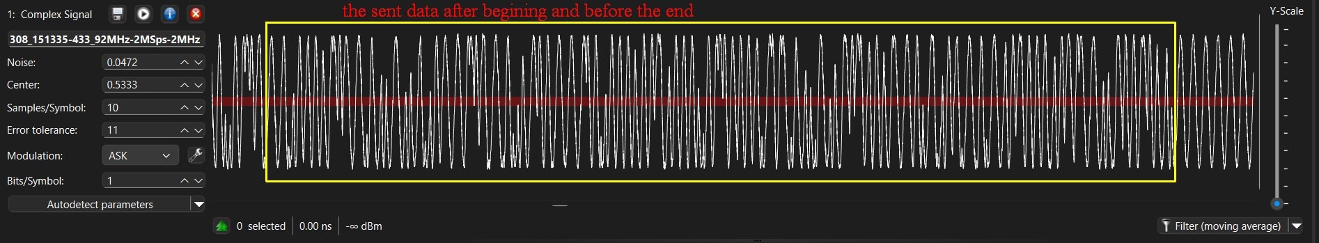

    I could not decode the recorded signal (RTL-SDR).
    Maybe in case anyone has any ideas... I attached the Universal Radio Hacker recorded signal.

    derrew222
    I have run blinds_gateway in kosnola it reads one remote control button as 3 lines of code, the question is how to convert this from raw to code that I can put in the final yaml file ?
    Console log screenshot showing three “remote.raw” lines with Raw values -446, -2686, and 1910.
  • #17 21860845
    DeDaMrAz
    Posts: 620
    Help: 34
    Rate: 130
    Do you know what type of remote you have? What type of protocol does it use?

How do I wire CC1101 to an ESP32‑S3 Super Mini?
Connect CS to GPIO12, SCK to GPIO11, MOSI to GPIO10, MISO to GPIO9. Tie GDO0 to GPIO13 and share it for RX/TX (half‑duplex). This single GDO0 line is key. [Elektroda, p.kaczmarek2, post #21780237]
