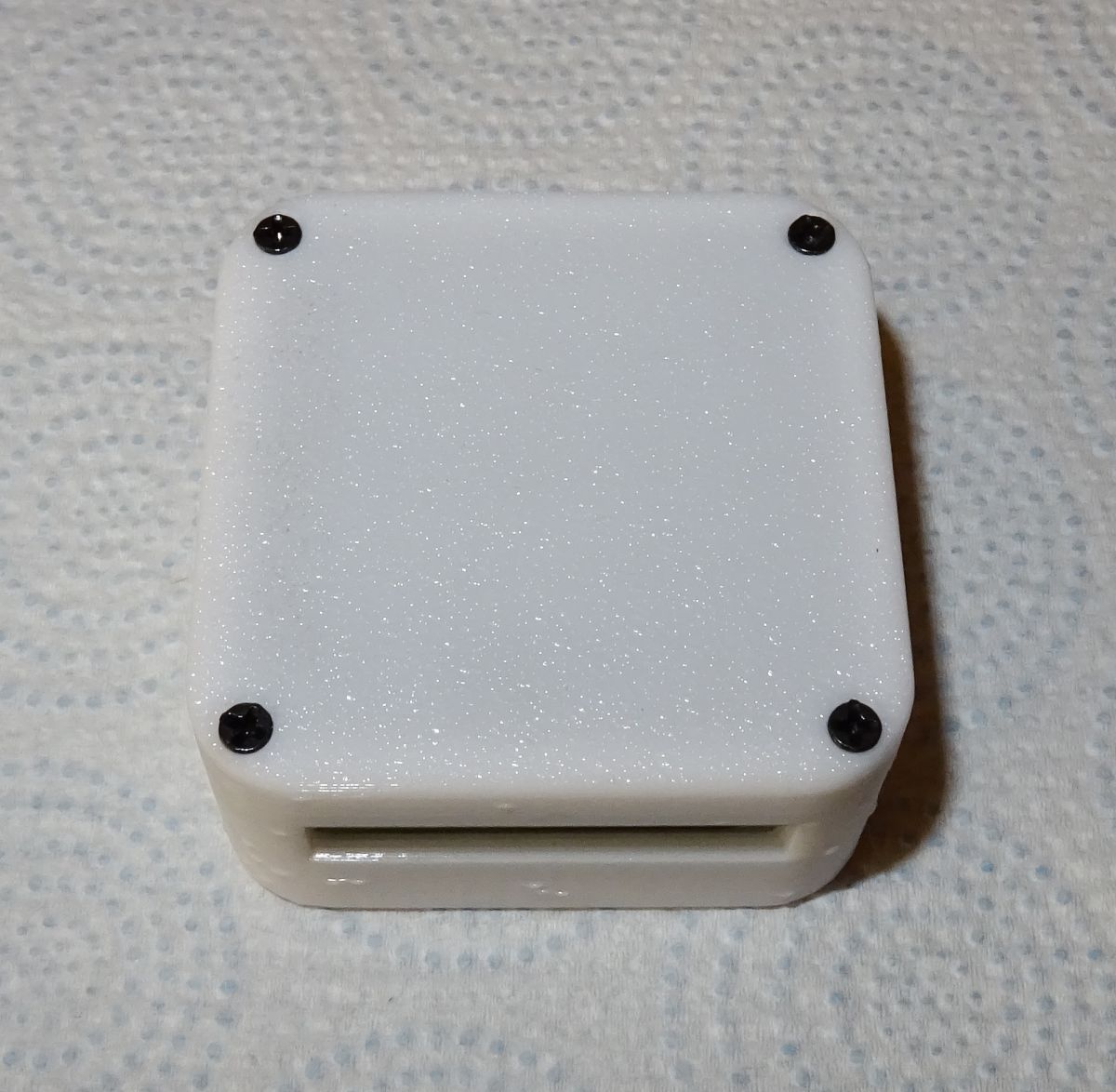

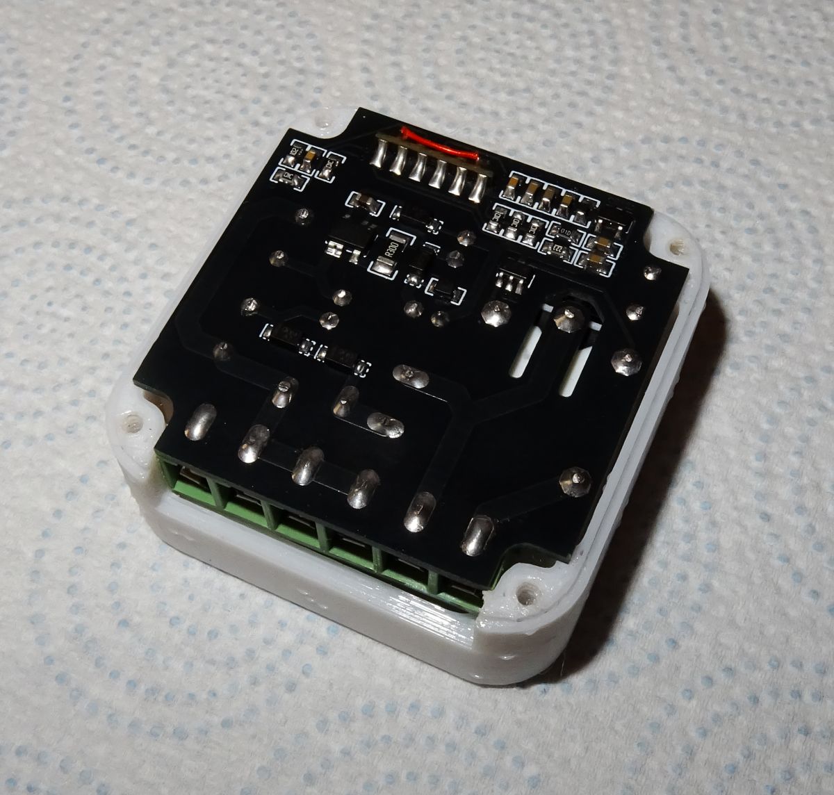

  • Built a Wi‑Fi-controlled cooker switch using an ESPC2-02 module, BP2525D 230 V→5 V inverter, M3406 5 V→3.3 V inverter, and GM8023B bistable relay.
  • The firmware runs on ESP-IDF 5.5 with no bytes, apps, or clouds, and provides browser-based on/off control, simple configuration, and FW updates.
  • Power consumption dropped from 0.3 W–1 W for off-the-shelf solutions to around 30 mW after software changes and a slight power-supply modification.
  • The finished unit measures 44x44x22 mm, but web development consumed about 90% of the programming time and a reset bug initially caused random crashes.
  • White electronics enclosure with schematic symbol and screw terminal connector

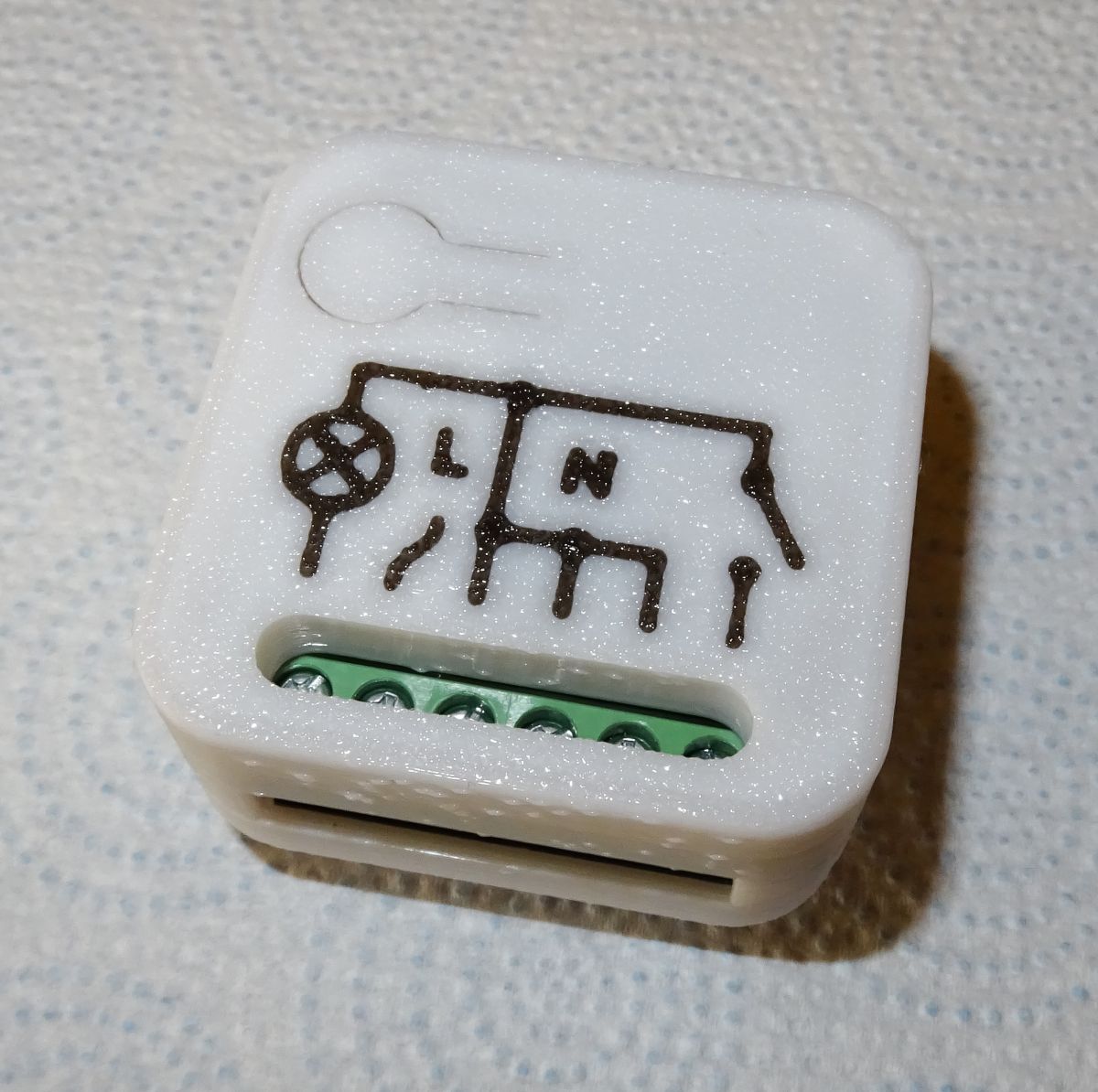

    Recently, when building a controller for my cooker, I decided to experiment with something simpler. Admittedly, I'm not keen on Wi-Fi control, but I was curious to see how low the current consumption could currently be. In the off-the-shelf solutions I tested, the consumption ranged from 0.3 W to 1 W. So I bought some Zigbee modules, a couple of Wi-Fi modules, a couple of different transformerless inverter ICs and bistable relays. A bit of coding and. A pleasant surprise. 0.1 W in the first tests, and after a couple of changes in the software + enabling power saving less than 0.05 W.... With WiFi... Eeeeee? It didn't stop there. By modifying the power supply slightly, I managed to get down to around 30 mW. I even assembled my own meter to confirm the results. I was expecting something in the region of 0.1 W. I decided not to use the Zigbee version.
    I wrote the softwares using ESP-IDF 5.5, without any bytes, apps or clouds. Control from a browser on/off + simple configuration. There is also the possibility of updating the FW.
    To make things less rosy, the whole thing took a while. I am completely unfamiliar with web development, some 90% of my programming time was taken up with it.
    There was also a bug that was causing all sorts of things to happen, I got stuck until I found it. Reset! Apparently the capacitor + resistor in the module wasn't enough and ESP was able to crash at odd times. I connected a reset to the GPIO and set it to high after startup, helped.

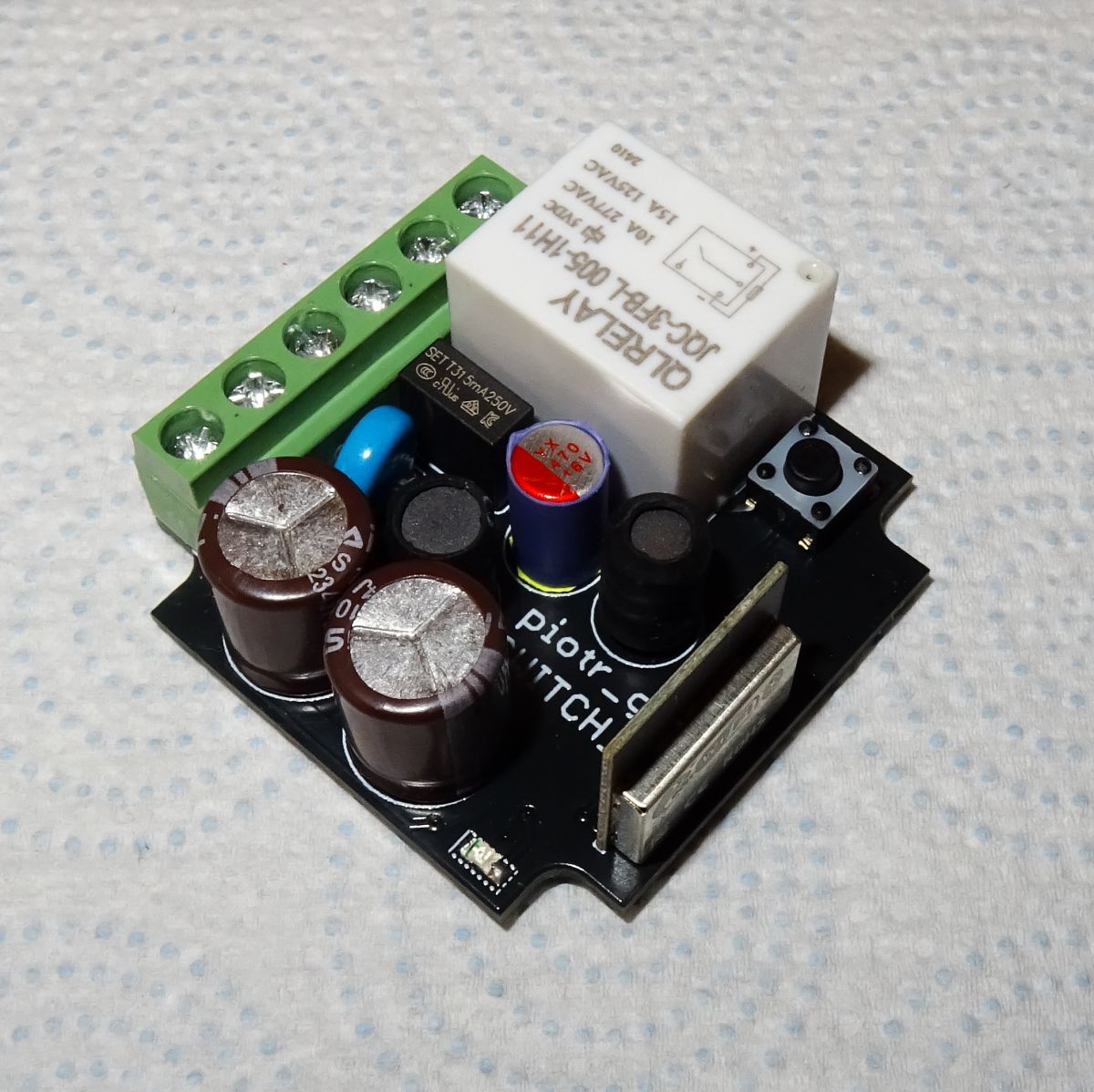

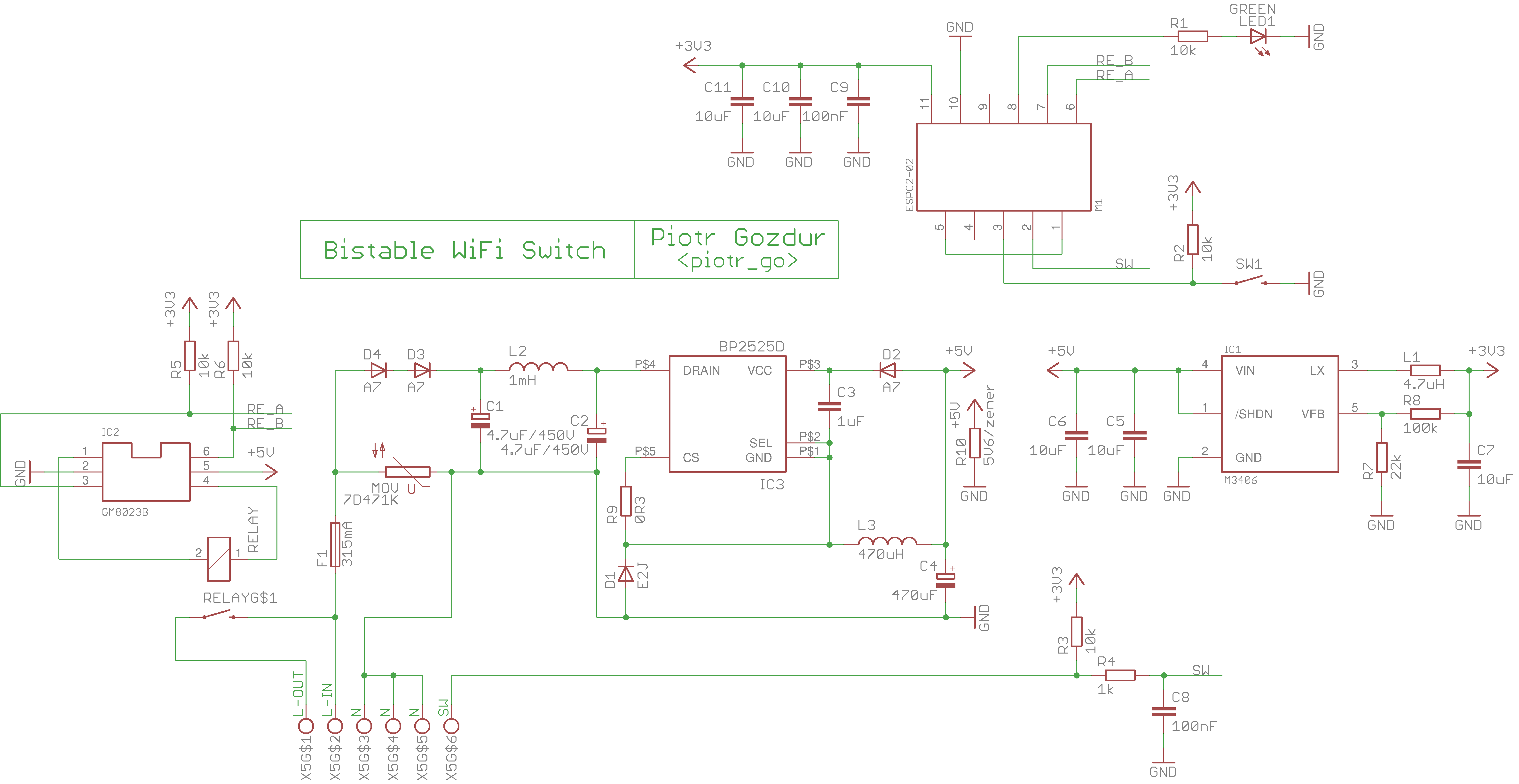

    Used Wi-Fi module ESPC2-02 from DOIT, 230 V-->5 V inverter BP2525D, 5 V-->3.3 V inverter M3406, bistable relay control GM8023B.
    Schedule:
    Schematic of a bistable WiFi switch using ESPC2-02 and GM8023B relay
    Building: Building:

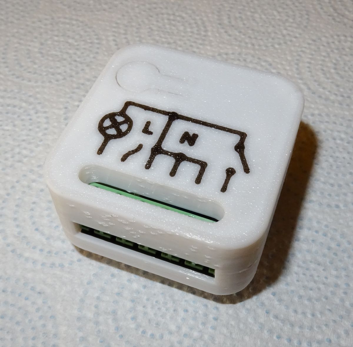

    White electronics enclosure with L and N markings and relay circuit symbol
    White plastic device enclosure with four corner screws
    Dimensions: 44x44x22 mm

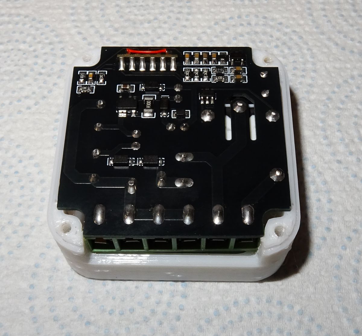

    Close-up of the bottom side of a PCB with soldered components and screw terminals
    Bottom view of a PCB in a white plastic enclosure with mounted SMD components

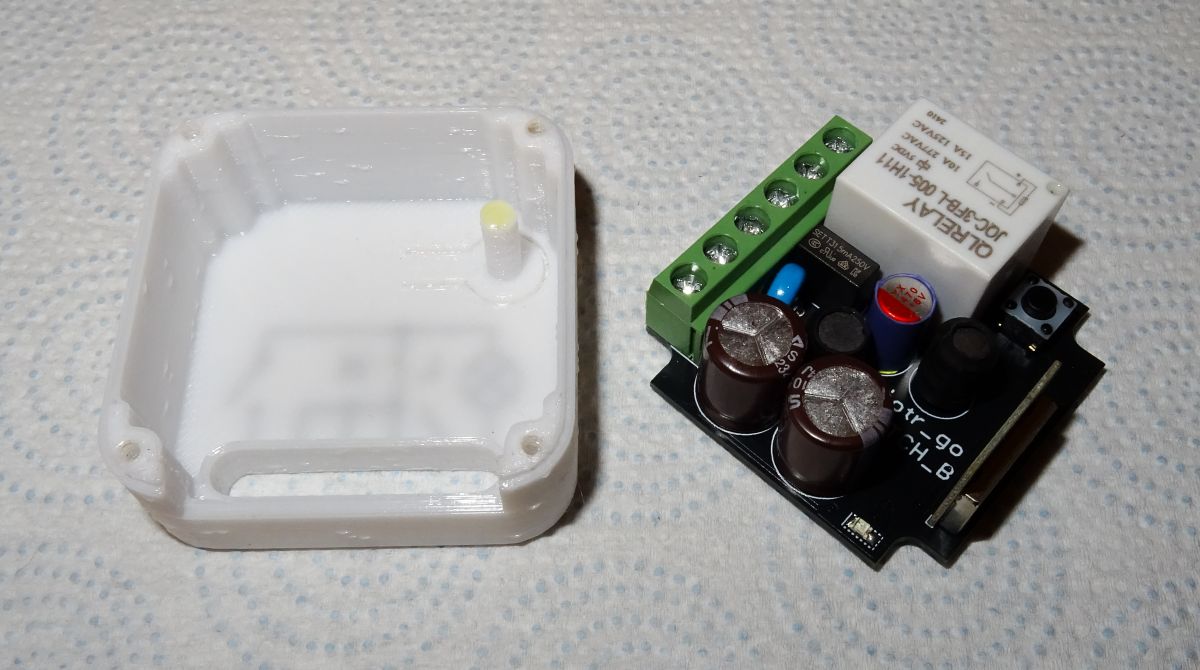

    Electronic module with bistable relay, screw terminals, and ESPC2-02 chip
    Electronic module with relay next to a white 3D-printed plastic enclosure

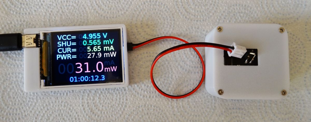

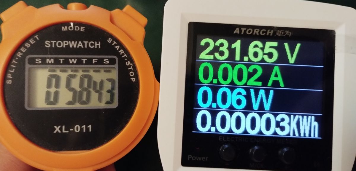

    Current consumption:
    XL-011 stopwatch and ATORCH meter showing 0.06W power usage at 231.65V
    Power consumption meter with LCD screen showing 27.9 mW and a case connected by a wire.
    Measured with a plug-in meter and an average hourly measurement when powered from 5 V.
    Consumption measured with the control side running.

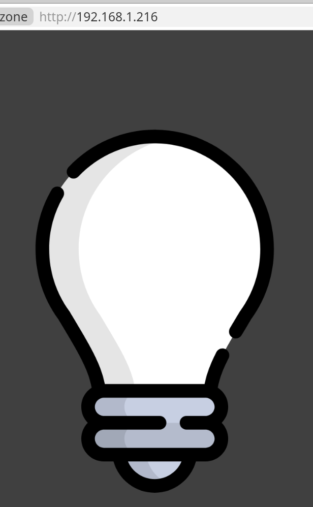

    Control: Control:
    Light bulb icon on dark background in browser interface at 192.168.1.216

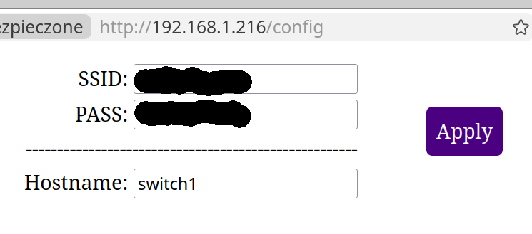

    WiFi Configuration:
    WiFi setup screen for ESP module with SSID, password, and hostname fields

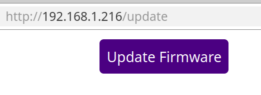

    Updating FW:
    “Update Firmware” button on page at IP address 192.168.1.216/update
    You can either press and select the file, or drag the file onto the button.

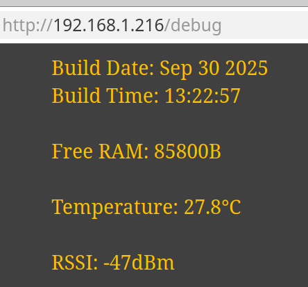

    Info:
    Debug interface screenshot of ESP via browser with IP address and system stats
    Various helpful information.

    Nice one. ;) The case is PLA and the black jumper is a pen?

    Jawi_P wrote:
    Body is of PLA
    PETG, higher softening temperature. Although the chip is unlikely to heat up.
    ??? aaaa WZorek, printed in black (on grey film) PETG on the first layer.

    piotr_go wrote:
    Modifying the power supply a little, I was able to get down to around 30 mW.
    Could you write a bit more - how did you manage this? 30 mW is usually what the ESP alone draws and without a radio, and you have a radio (quite responsive) and an inverter.

    >>21778398
    Inaccurate meter. :)

    krzbor wrote:
    Could you write something more - how did you get it to work? 30mW is usually what the ESP alone draws and without a radio, and you have a radio (quite responsive) and an inverter.
    I initially tested on an ESP32-C3 (I was making a cooker controller on it so it was handy), C2 performed slightly better (can't remember the exact numbers).
    R10 I changed to a zener. The original manufacturer of the BP2525D recommended a 1.5k...2k resistor (the voltage at the output increases at low load).
    I also tested several 5 V--->3.3 V inverters, the M3406 performed best at low load.
    Upload the binary to the ESP32-C2 if you have one and test.
    chemik_16 wrote:
    inaccurate meter
    While the measurement on the 230 V side may be inaccurate (too little current), it should be OK at 5 V.
    I checked with several USB meters, it came out similar.

    Shouldn't diode D2 in the diagram be the other way around ?
  • #15 21790543
    maurycy123
    Conditionally unlocked
    Posts: 3108
    Help: 225
    Rate: 735
    manski wrote:
    Shouldn't diode D2 on the schematic be the other way around ?
    No. Look up the datasheet BP2525D for yourself.

    Hmmm, and why did you make the relay control so complicated?
  • #17 21790920
    piotr_go
    DIY electronics designer
    Posts: 2905
    Help: 94
    Rate: 3337
    Bistable relay. It is energised only during a state change (for 0.01...0.1s).
