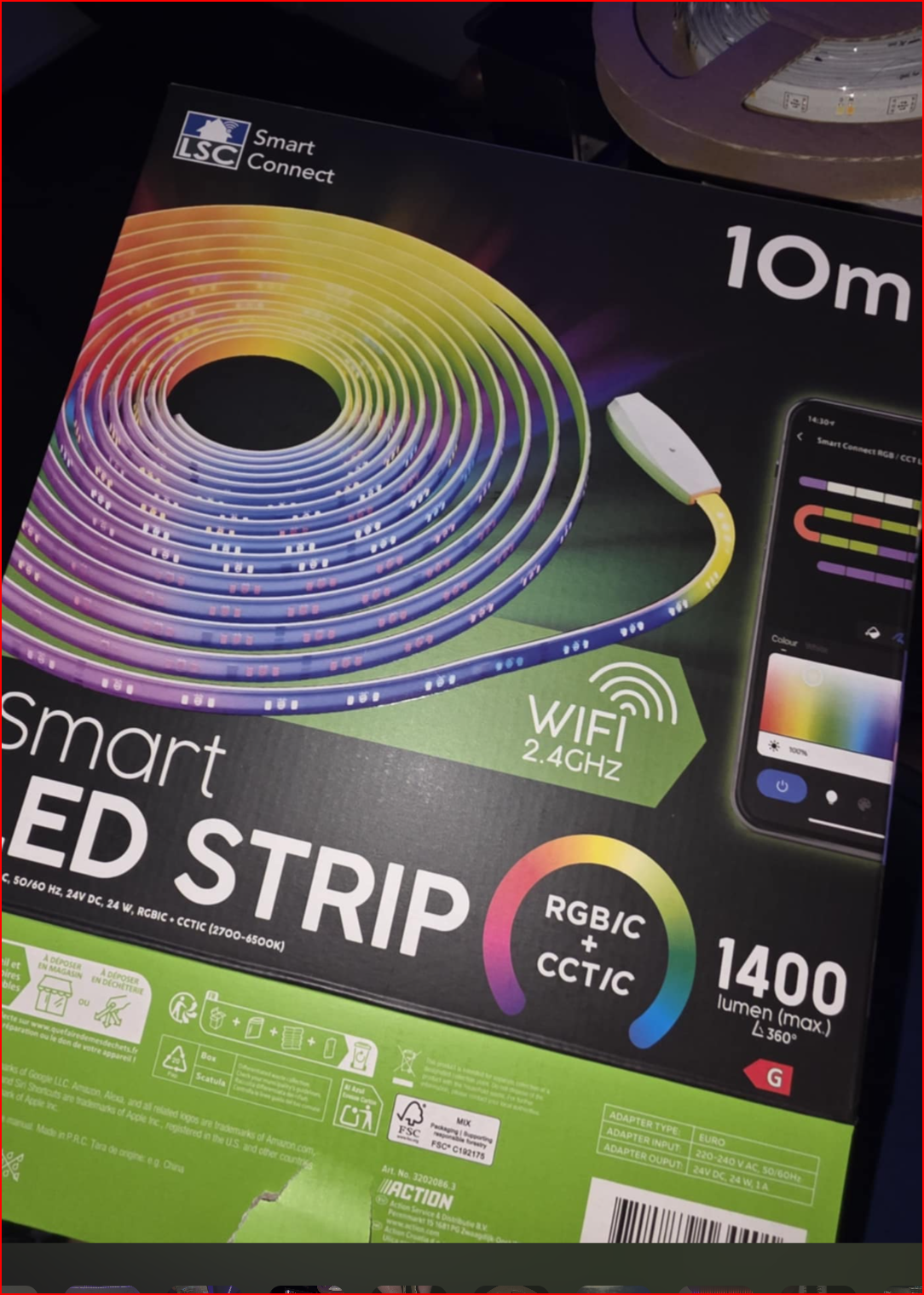

    Hi everyone! I recently bought an LSC Smart Connect RGB/CCT LED strip (10 m, 24 V DC, WiFi 2.4 GHz, 1400 lm max) and I need some guidance.

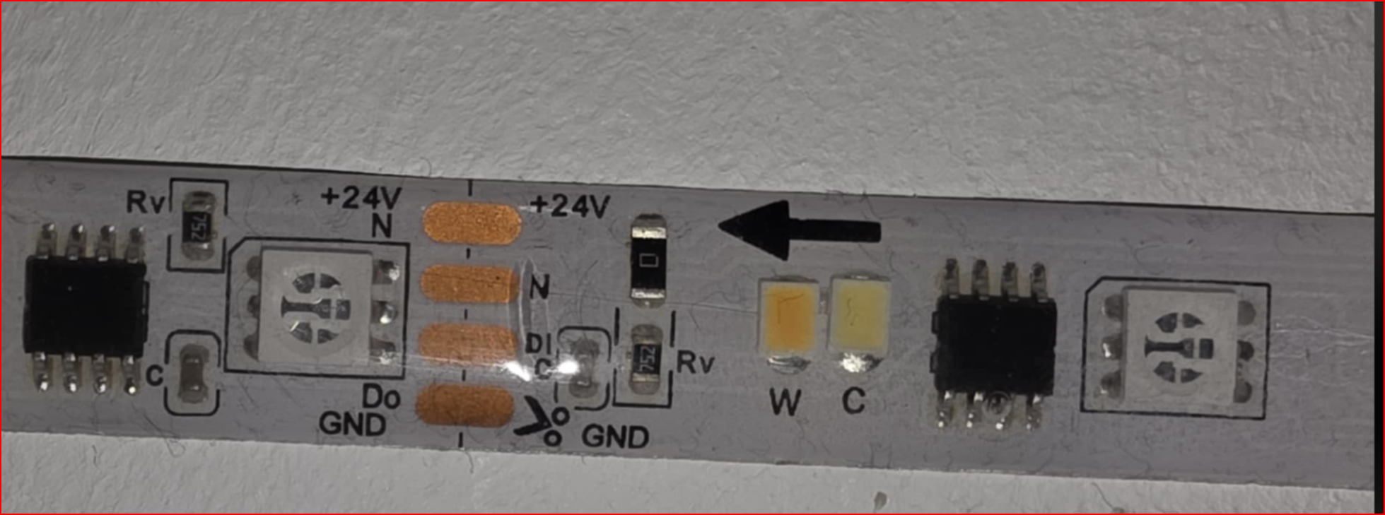

    I can see the copper pads in the second photo with markings like 24 V, N, DI, GND, etc. I just want to be 100% sure I'm doing this correctly before I make any cuts.

    Smart LED Strip 10m packaging with RGB/C and WiFi control visible @ElektrodaBot @ElektrodaBot

    AI: How many copper pads (pins) are there at the cutting point—could you confirm the exact number and the labels (e.g., 24 V, N, DI, GND, etc.)?
    Thanks for asking! Looking closely at the cutting points on my LED strip, I can see there are 5 copper pads with the following labels:
    24 V (positive power)
    N
    DI (data in)
    GND (ground)
    Rv (appears on the side)
    There's also markings for:
    Do (data out)
    C
    W (white)
    C (cool/cold white, I think)
    The arrow on the strip points in the direction of data flow.
    Since this is a smart RGB/CCT WiFi strip with both color and tunable white temperature control, it seems more complex than a basic RGB strip.
    My questions now are:
    Do I need a special 5-pin connector for this type of strip?
    Will a regular LED strip connector work, or do I need one specifically for smart/addressable RGB CCT strips?
    Can you recommend a specific connector type or product that would work reliably with these 5 pads?
    I really appreciate your patience in helping me understand this!

    Initial assessment of available information
    - Your LSC Smart Connect 10 m “XXL” strip (24 V, Wi‑Fi) is the Action/LSC model that the vendor states can change color per 25 cm segment. That points to a digital, segment‑addressable architecture rather than a classic analog RGB/RGBCCT bus. (action.com)
    - Community teardowns of recent LSC RGBIC+CCT strips (e.g., 3203632.x) show one single data line (DI/DO) daisy‑chaining small driver ICs (SM16703/GZX16703) per segment; the “CW/WW” pads often exist on the controller PCB but are not used to the strip. In other words: power (+24 V, GND) plus one data line drive the strip. (community.home-assistant.io)
    - 24 V “RGBIC”/SM16703‑class strips are normally 3‑wire systems (V+, DATA, GND) and commonly use 3‑pin strip connectors or JST‑SM 3‑pin pigtails. (suntechlite.com)
    Taken together, your pads labeled +24V, DI, GND are the functional ones. The extra pads you see (N, Rv; sometimes C/W/Do markings nearby) are typically unused test/reserved or the mirrored label for the opposite side of the cut (DO vs DI). This matches what we see on LSC digital strips.

    1) Why not 5‑ or 6‑pin “RGBW/RGBCCT” clip connectors?
    - Those are made for analog strips where each color/white channel has its own power trace. Your LSC strip uses a serial data line (DI/DO) and on‑board drivers. A 5‑pin analog connector will not line up logically with the data pad and can create unreliable or wrong connections. The vendor info (25 cm segment color control) and community teardowns confirm the addressable design. (action.com)
    2) What are the pads I actually need to bridge?
    - On the “upstream” side (toward the controller) you’ll typically see DO at the cut; on the “downstream” side you’ll see DI. The bridge must connect:
    - +24V to +24V
    - GND to GND
    - DO (upstream) to DI (downstream)
    - Extra pads such as N/Rv are usually not used by the strip electronics. If in doubt, confirm with a multimeter that they don’t continue along the strip tracks.

    - The XXL strip is specified as 24 W total on the vendor page, so currents are modest (~1 A at 24 V). Even so, poor clip contacts on the data pad can cause flicker or “stuck” segments. Soldered joints or good‑quality 3‑pin clips minimize that risk. (action.com)

    - LSC sells multiple variants. While all evidence for the XXL 10 m points to a 3‑wire digital chain, please verify your board width and check with a multimeter that only +24 V, DI/DO, and GND continue past the cut. This avoids buying the wrong connector. (action.com)

    - Measure the PCB width of your strip at the cut point: 10 mm or 12 mm?
    - Are you joining two pieces in a straight line, making a corner, or adding a detachable plug?
    - Can you post a close‑up of the pads on both sides of the cut line so I can confirm the pad order (+24V / DI/DO / GND) and advise an exact connector SKU?
