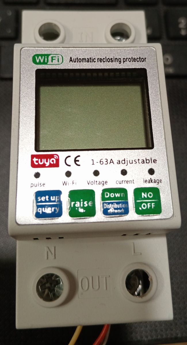

    Hello. Could you please provide some information regarding my question?
    I have an Automatic Reclosing Protector.
    Spoiler:
    It works, but I'd like to get what I want.
    1. Electricity meter: The SmartLife app's display of consumption history and current is very inconvenient — it's not suitable for analyzing consumption. Furthermore, updates are very infrequent. There's also no way to reset the current meter readings: to calculate the monthly value, I have to remember the readings at the beginning and end of the period myself.
    2. Internet addiction: I have my own MQTT at home, with my own personal space and women. I'd like to control the meter's on/off switch. I configure the triggering settings using buttons, and that's sufficient.

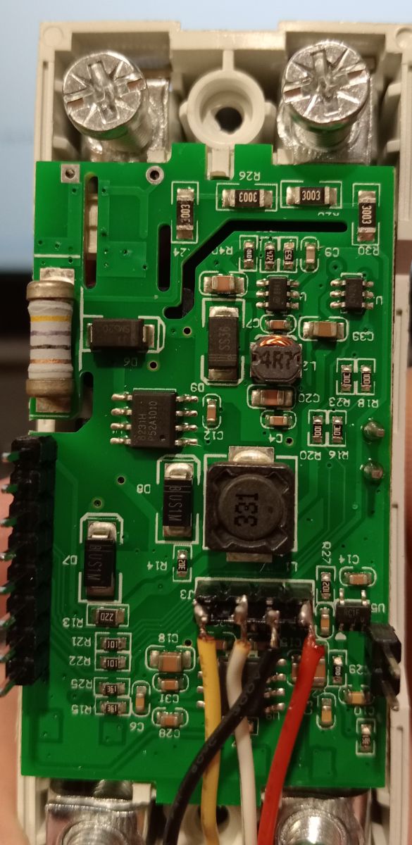

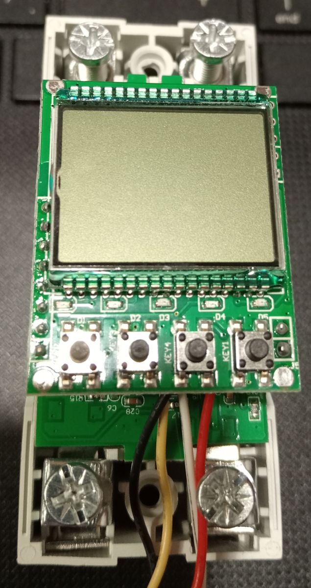

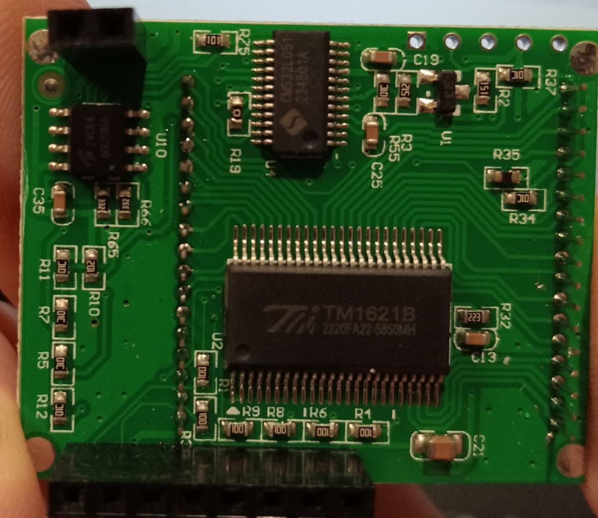

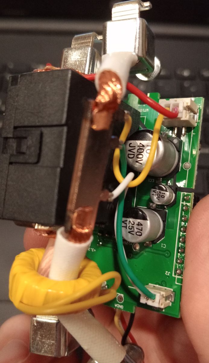

    Disassembled the device and found the following components:
    TM1621B - screen controller
    CMS32L051 - microcontroller that controls everything
    24C64 - EEPROM
    CB3S - (not pictured) - I assume it's a UART bridge between the CMS32L051 and the Wifi/TUYA server. CB3S connected to mainboard only /-/rx/tx
    My question is: can someone explain how the communication between the CB3S and the CMS works? I tried all the port speeds, but didn't see any meaningful information. I only see zeros, but the number of zeros can vary depending on load manipulation and button presses.
    Sincerely, xopek.

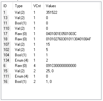

    In the analysis log, I haven't seen anything about voltage, current, or status yet, but I think after switching to the OBK, it will become a little clearer and more convenient.
    A data table with columns ID, Type, VCnt, and Values containing varied entries
  • Compound raw-byte VCP format likely carries voltage, current, and power
    #4 21742261
    Posts: 14764
    Rate: 12897
    There is no separate dpID for current/voltage/etc. They are using compound format, raw bytes array, usually VCP, 2 bytes per voltage, scaled by 10, so precision to single decimal point.
    Search for: DP_TYPE_RAW_TAC2121C_VCP
    https://www.elektroda.com/rtvforum/find.php?q=DP_TYPE_RAW_TAC2121C_VCP

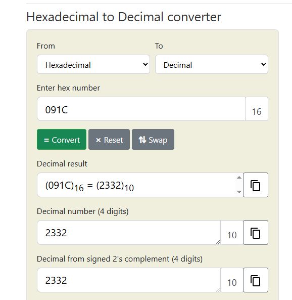

    On your capture, dpID 6 looks interesting. The first bytes are 091C, which can be decoded into 2332 decimal:
    Hexadecimal to decimal converter showing result 091C 2332
    The following is most likely your voltage value. Next bytes are 0, so I'd guess that they are current and power, just like in DP_TYPE_RAW_TAC2121C_VCP.
    Code: C / C++
    This format is known and works in OBK well. That being said, if you have some format that is not yet in OBK, then it's also not a problem - we're here to help, we can add a support for a new format for you.

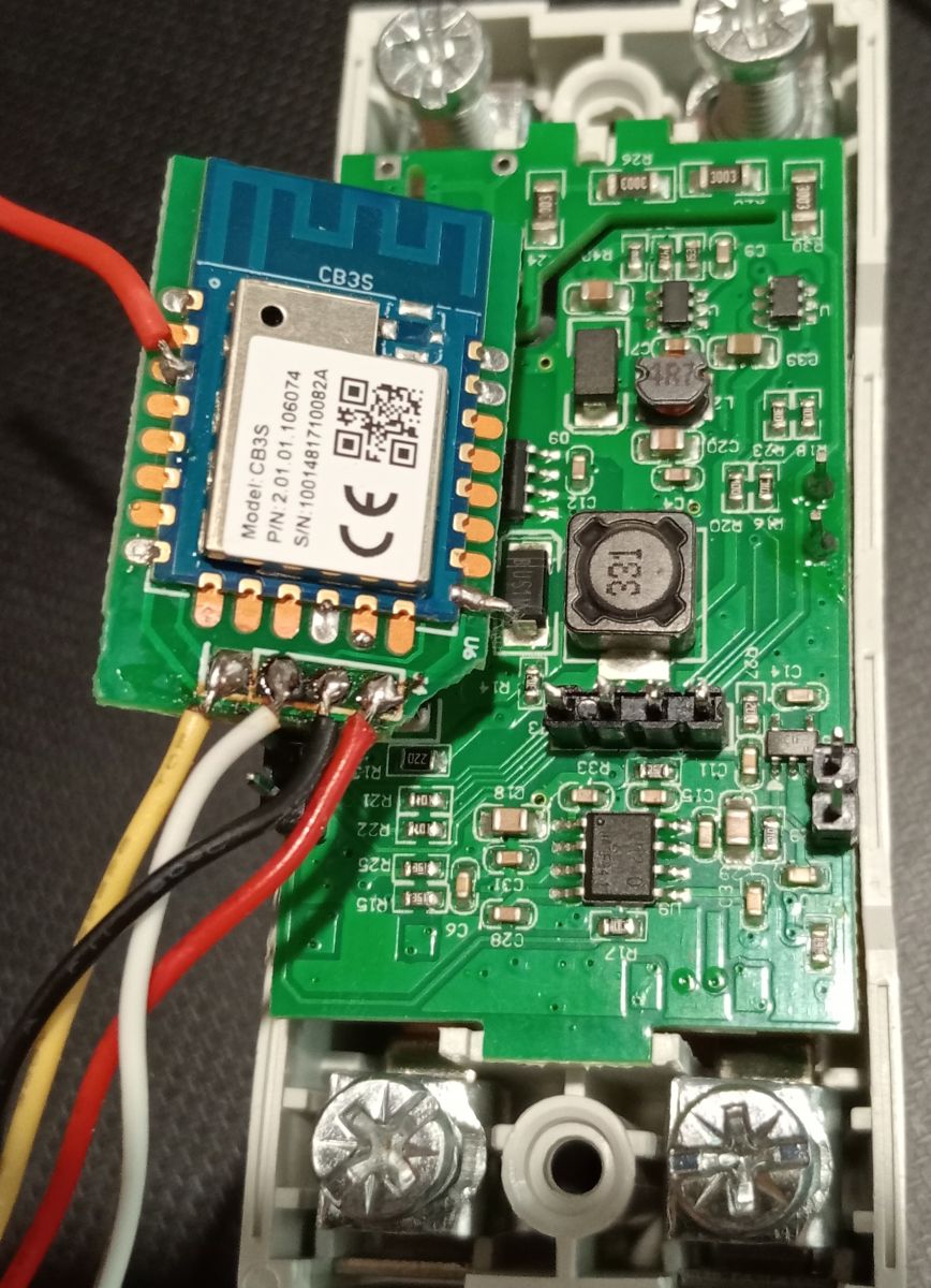

    How do you connect CB3S to the UART converter? Posting a photo often can lead to quicker diagnosis and help.
    Well, maybe we can try to send dpID set to 0 from OBK and see if it's reset.
  • #9 21745189
    xopkep
    Posts: 20
    There are four pins between the mainboard and the CB3S: RX, TX, GND, VCC.
    I tried a different UART adapter (the first was a CH340, the second was a CP2102), but it still won't flash or read. I'll try using a programmer again; maybe it will work.
    CB3S module connected with wires to a PCB with electronic components
  • #10 21745200
    Posts: 14764
    Rate: 12897
    How do you power it, how long are the wires?
  • #11 21745246
    xopkep
    Posts: 20
    The wires are no longer than 15 cm. I've tried powering the board from a UART adapter and an external 3 V power supply. I've encountered similar firmware issues before, and changing the UART adapter solved the problem.
  • #12 21750208
    xopkep
    Posts: 20
    I'm out of ideas. I've already tried other adapters (CH340, CP2102, FTDI, and some other CHxxx). I've tried different power supply options. I can't connect to the module. However, the module works perfectly in the original device. All the adapters are working, and the power supply is fine. All that's left is to find a PC running WinXP, but the software for flash won't work there :(

    Yes, I direct-soldered to the RX/TX pins on the module. There's nothing on the back of the PCB, no mask, no traces.
  • CH340G works only below 56,000 baud
    #16 21757586
    xopkep
    Posts: 20
    Wonderful! All my problems with this and the previous firmware were either Windows and driver-related! The port wouldn't work at speeds above 56,000! This is the first time I've seen this. I tried dozens of drivers and got the CH340G working, but the CP2102 still doesn't work.
