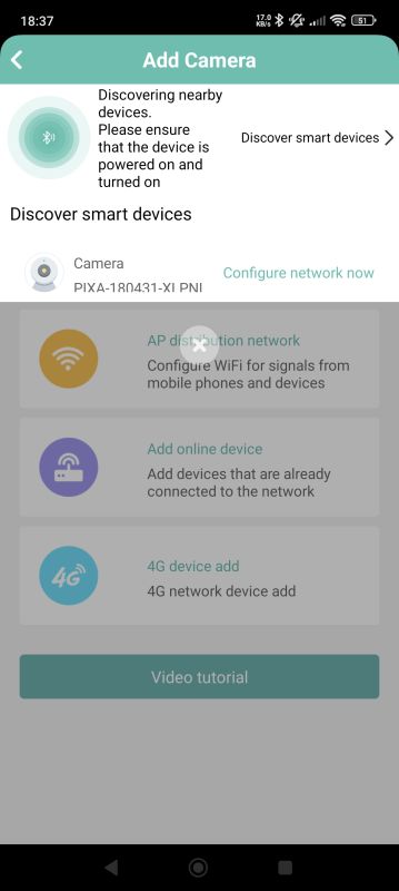

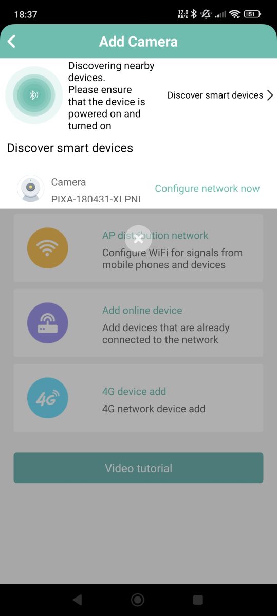

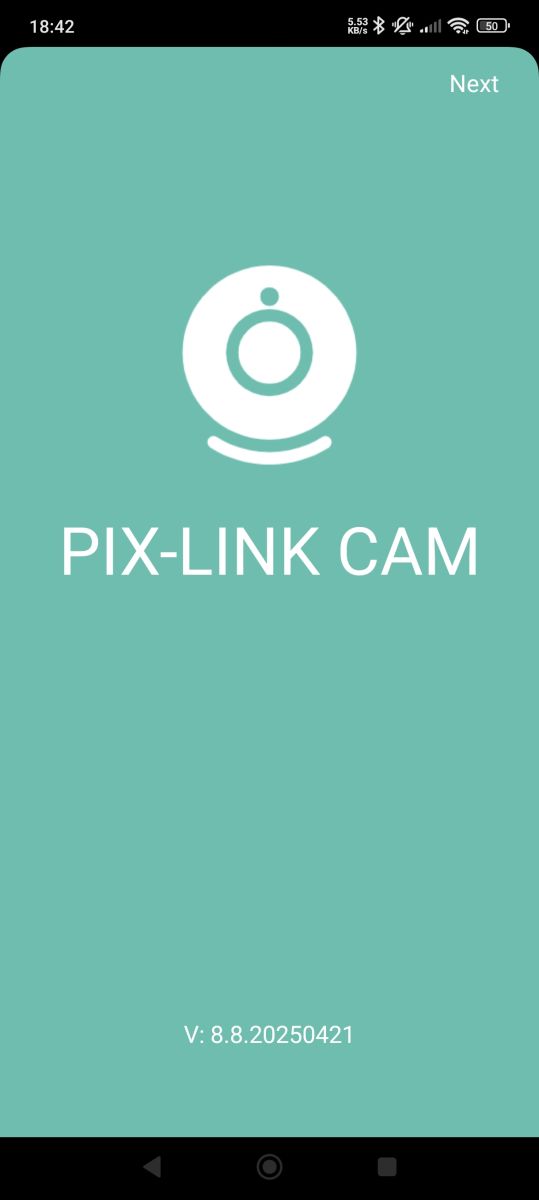

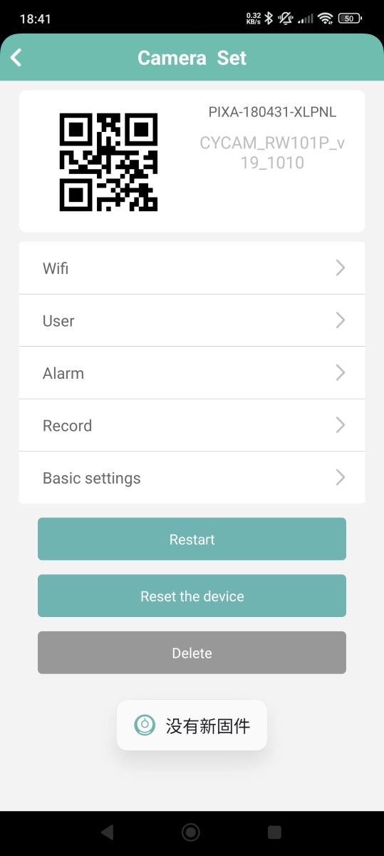

    Found a BK7252U firmware dump on Discord to be paired with an app I've not seen before.
    No information about the device it came from apart from "its an A9 cam uses the pix-link app".
    It boots on an encryption key free BK7252U.
    Boot log from P0
    Then silent on both UARTs.
    AP broadcast
    Screenshot showing Wi-Fi network name PIXA-180431-XLPNL on dark background

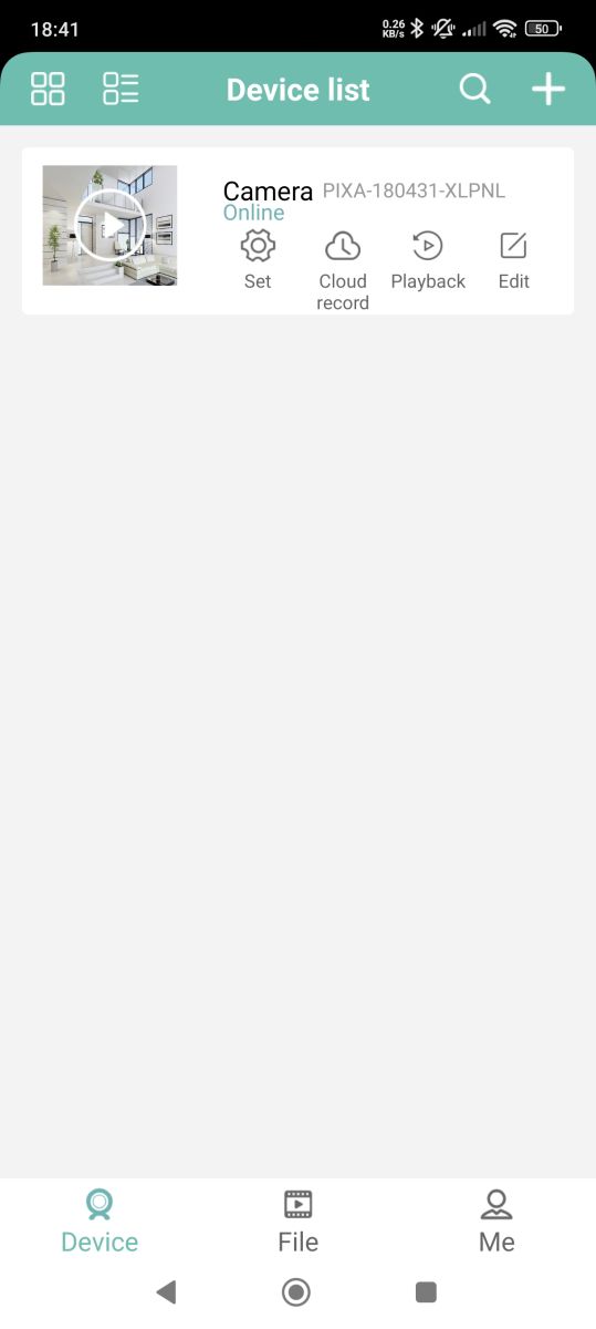

    Pairs with the Pix-Link Cam app
    Pix-Link Cam app splash screen with camera icon and version 8.8.20250421 Camera setup screen in Pix-Link app, detected device named PIXA-180431-XI PNI Device list screen showing one online network camera in a mobile app Camera settings screen with QR code and options for Wi-Fi, alarm, and user configuration.
    Strings of interest in the dump
    It’s using a PPCS-style (Peer-to-Peer Connection Service) P2P cloud stack
    There are loads of strings like:
    ΡΙΧΑ-180431-XLPNL
    The apparent product name and version CYCAM_RW101P_v 19_1010 seen in the app might link it to the RW101P Snowman https://www.pix-link.com/rw101p-snowman
    White security camera with labeled parts: microphone, lens, speaker, power port, Micro SD card slot
    but that doesn't quite tally with it being described as an "A9".

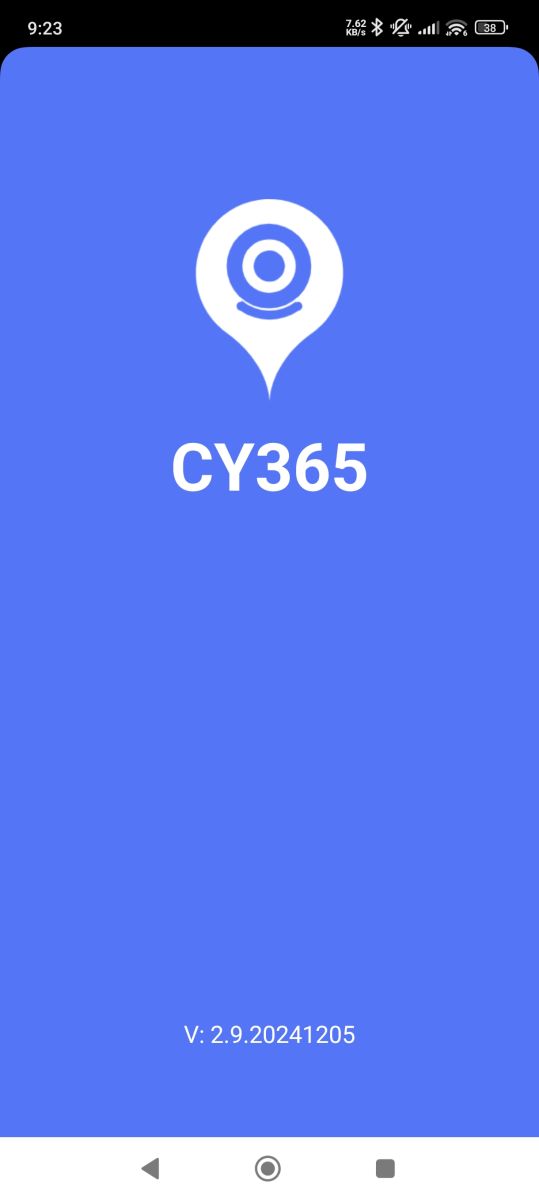

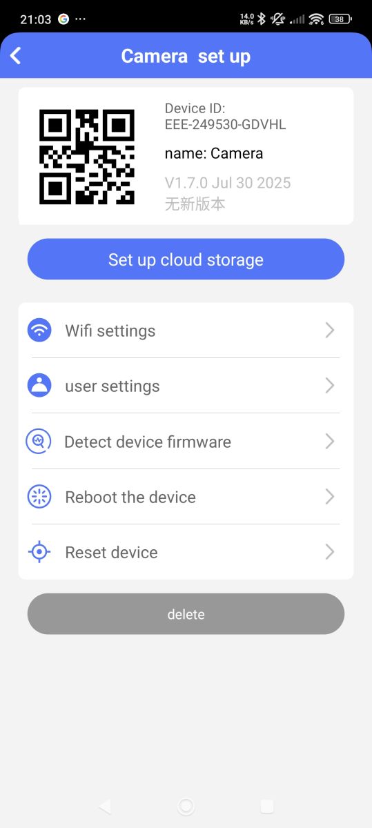

    Well, immediately after playing with the BK7252U dump I opened a tiny BK7252N device that uses the CY365 app. So PIX-LINK could be re-skin of that, it's all the same inside.
    CY365 app splash screen with a camera logo and version numberCamera setup screen with QR code and options for Wi-Fi, user, and device settings
