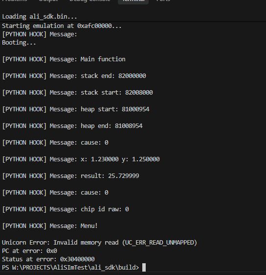

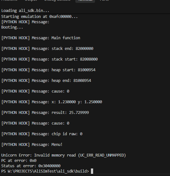

    For my part I am putting together an emulator for Ali, my Hello World bin is already displaying text:
    Terminal console with emulator logs and memory read error
    First via the printf hook and then normally already - reading from the register to send via the UART.

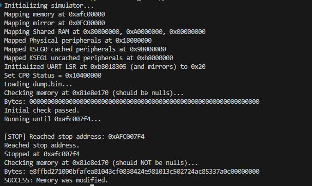

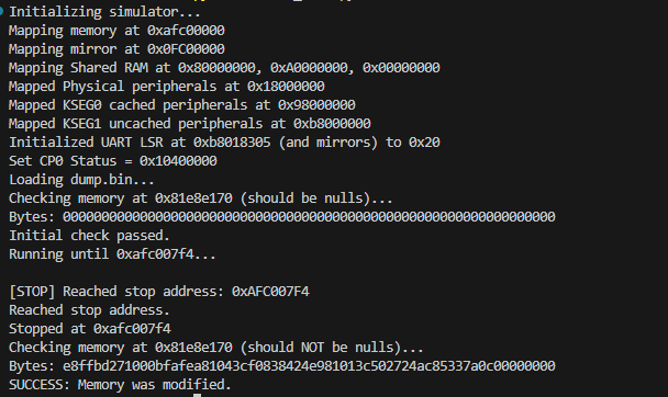

    I also managed to pass the first bootloader, the C pseudocode:
    Code: C / C++
    It copies the data to RAM at address 81e8e170 and then performs functions there:
    MIPS emulator console showing successful RAM memory modification

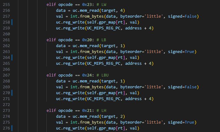

    I supposedly use the off-the-shelf CPU engine but it has a lot messed up and I have to manually handle the instructions:
    Python code fragment emulating MIPS load instructions in an emulator
    I don't know how functional this will be, time will tell.

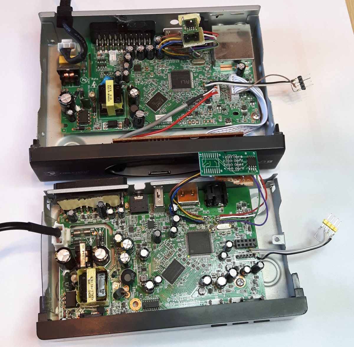

  • External flash socketed for faster firmware tests

    I’ve desoldered the memory chip; I’ve fitted a socket and mounted the memory on a separate board so that I can program it externally quickly and easily. I’ve got a few ideas about what to check and I’ll let you know how it goes.
    (I also have a decoder with an MSD7818 processor and plan to check whether Globo will boot from that decoder.)

    I can switch programmes because I have memory modules in the sockets; I just insert a different one into the decoder and, after a reset, it will boot from a different one. (I swap the memory whilst the set-top box is running. Perhaps I’ll make two memory modules on a single board and just change the control lines, but for now there are separate memory modules on separate boards. I’ve attached a photo. Nothing spectacular – the socket is soldered into the set-top box using wires, but it works.)
    How to compile and run custom firmware for ALI M3801 and other chips from tuners?
    The original boot loader and this test one are both assigned to the same address, AFC00000. I’m unable to move it.
    During testing, I only changed the combinations of characters %d, %s, %x, and %, a, b, f, to see what works and what doesn’t.
    Entering %s works, and I also managed to display something binary (4F0101), but I entered a few new commands at that point and I’m not sure whether that was a read from addresses B8xxxxxx or something random.
    Apart from adding a few display commands, I didn’t change anything else.
