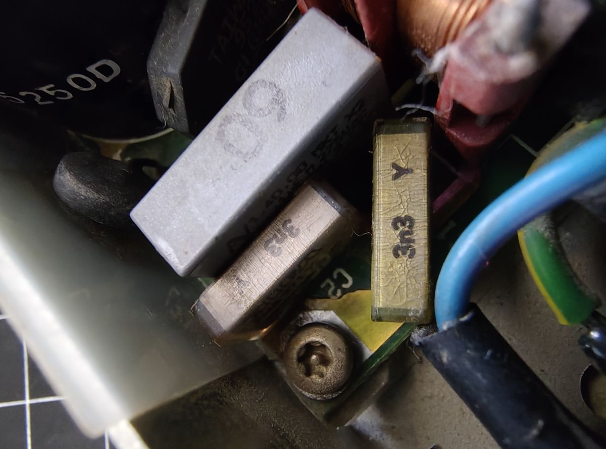

  • Polish measurement equipment often uses Silesia mains filters and notorious RIFA paper capacitors that fail after decades.
  • The filter topology uses an input choke for common-mode noise, two Y capacitors to earth, and an X capacitor across L and N for differential noise.
  • In HP digital oscilloscopes from the 1990s, these capacitors were built into filters integrated into the socket and switch.
  • Cracked resin lets moisture in, the capacitors leak, and the filter can explode, swell, or spray tar inside the unit.
  • Repairs usually mean replacing them with film or polypropylene capacitors such as WIMA or Wurth Electronics, or removing the filter entirely.

    I've just hit a cracked Rify, this time it's Y-grade switched between L and N and PE. It's a good thing the article came up because I probably wouldn't have noticed it straight away, they will be replaced with ceramic.

Paper-dielectric X and Y capacitors absorb moisture after the resin case cracks. Leakage rises, leading to smoke, bangs, or tar ejection. The common‑mode choke usually survives. The EEVBlog rule of thumb quoted is “replace if found, always!” because these parts age poorly. [Elektroda, filipcichowskidev, post #21775596]

Isolate mains, discharge capacitors, and inspect X/Y caps for cracks or discoloration. Replace degraded paper capacitors with modern polypropylene film parts, then retest insulation/leakage. A real case showed 10 mA L–PE; replacing cracked RIFAs with Würth restored compliance the same day. [Elektroda, filipcichowskidev, post #21775678]
