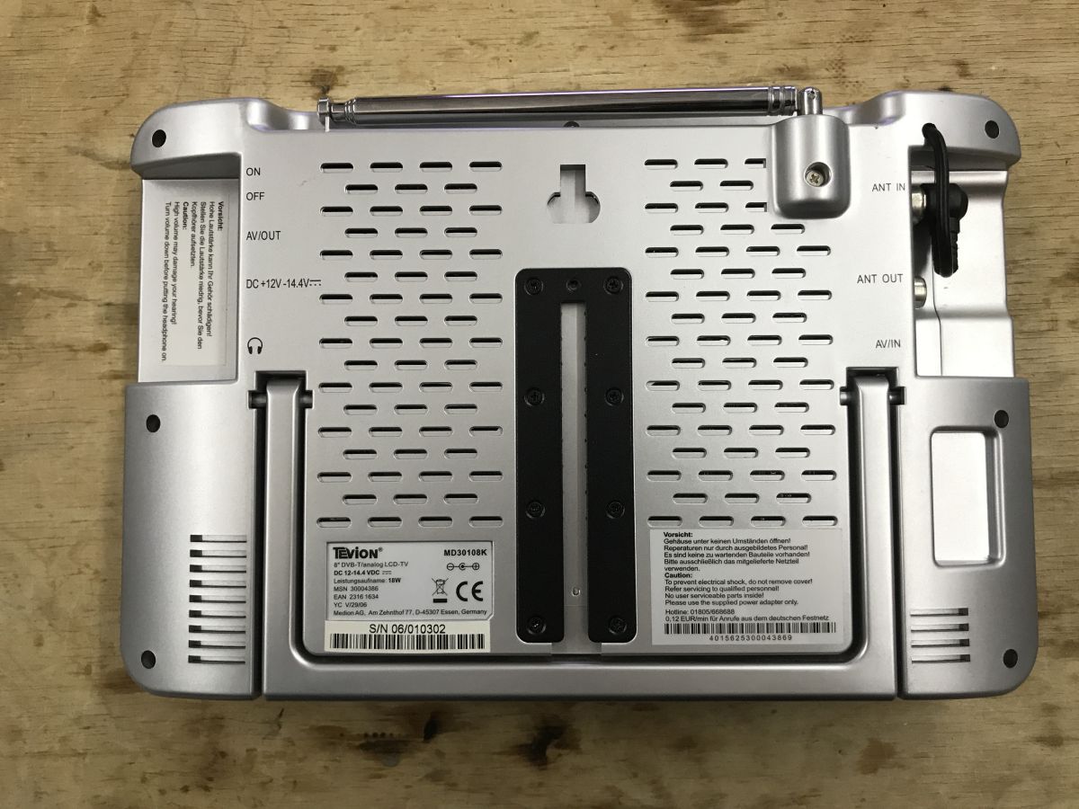

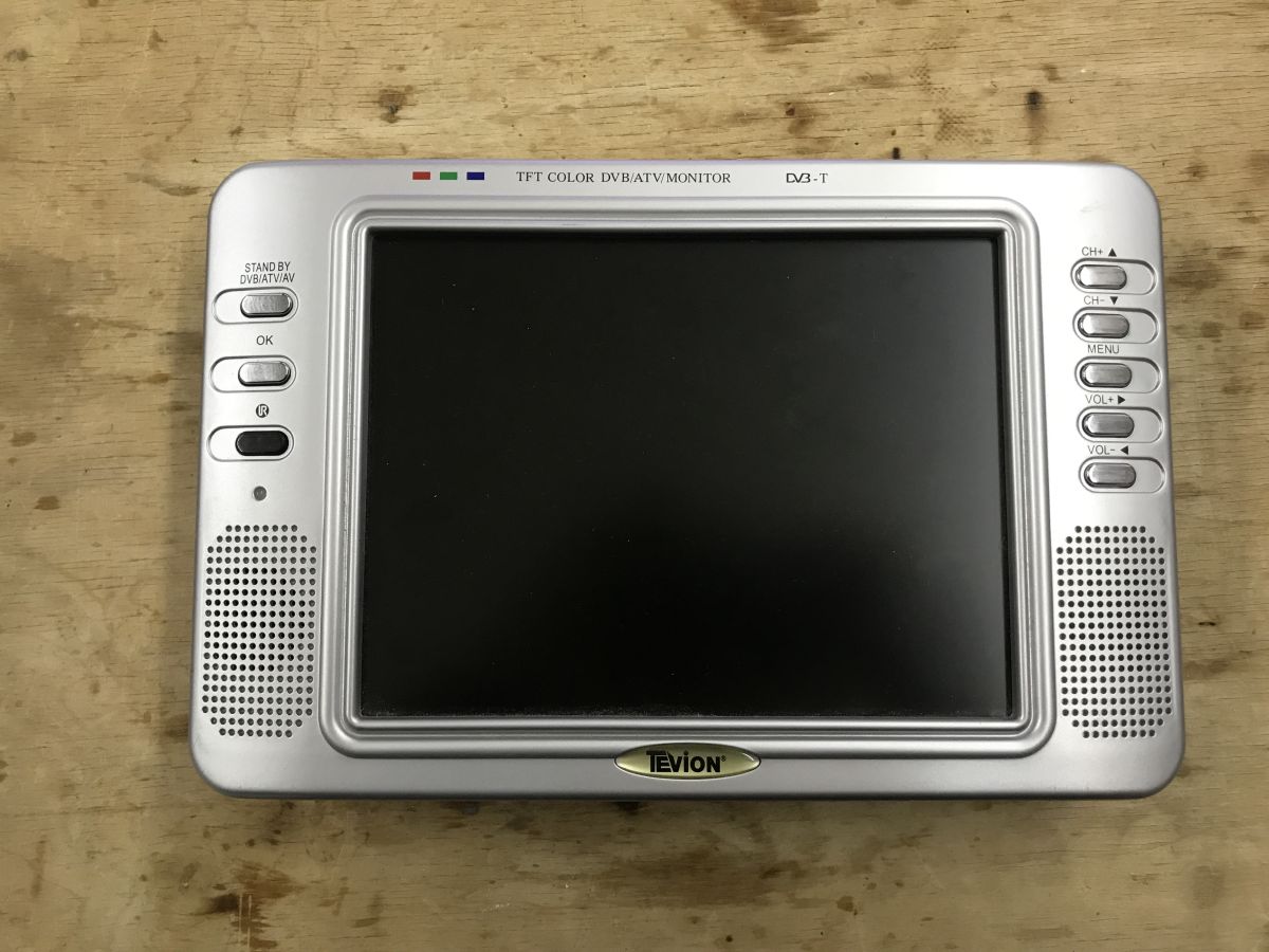

    Here is a comparison, current measurements and a presentation of the interiors of the two displays - the first is the older LCD 8" TV Tevision MD30108K offering antenna and AV input, and the second is the slightly newer EM713/SX-LCD-7CAL 7" 1024x600 IPS/PLS, already compatible with VGA, HDMI and powered by USB. I will check both units with, among other things, an analogue surveillance camera. I will also consider the second unit for use with a Raspberry Pi or other microcomputer.
    Let's start with the older hardware. It already supports DVB-T/MPEG2 and runs on 12 volts:
    Comparison of small displays 7" 8" for monitoring and more, measurements Comparison of small displays 7" 8" for monitoring and more, measurements Comparison of small displays 7" 8" for monitoring and more, measurements
    In addition to the remote control, the kit comes with a lighter socket cable that allows you to run the whole thing in your car. The equipment itself is quite handy for its time and has a foot on the back which can also be used as a handle.
    These were not yet the days when manufacturers tried to reduce the number of buttons on the case to a minimum, so controlling the whole thing is quite intuitive:

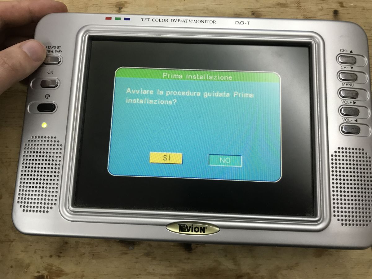

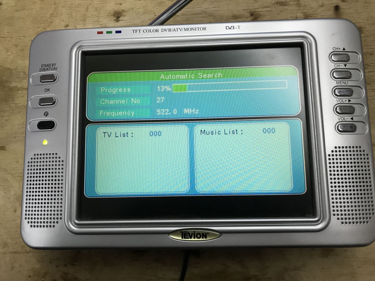

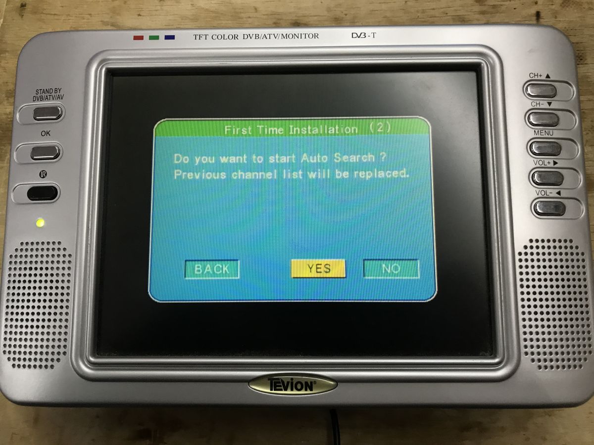

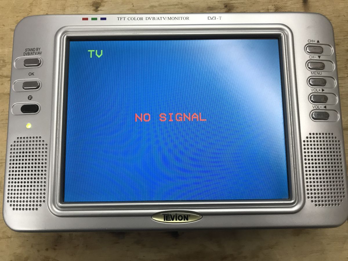

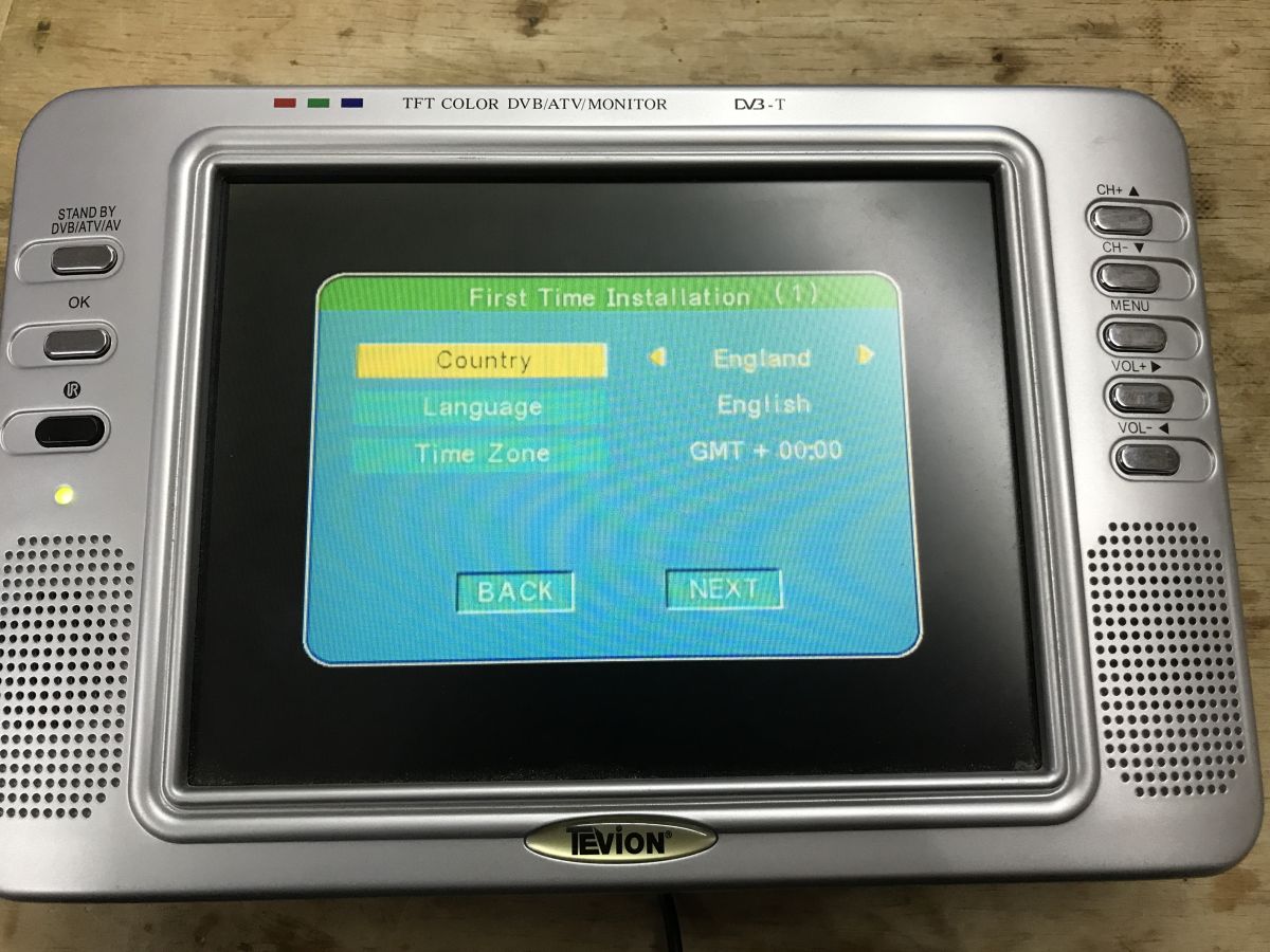

    The unit searches for channels - with poor results, DVB-T2/HEVC would be needed these days:

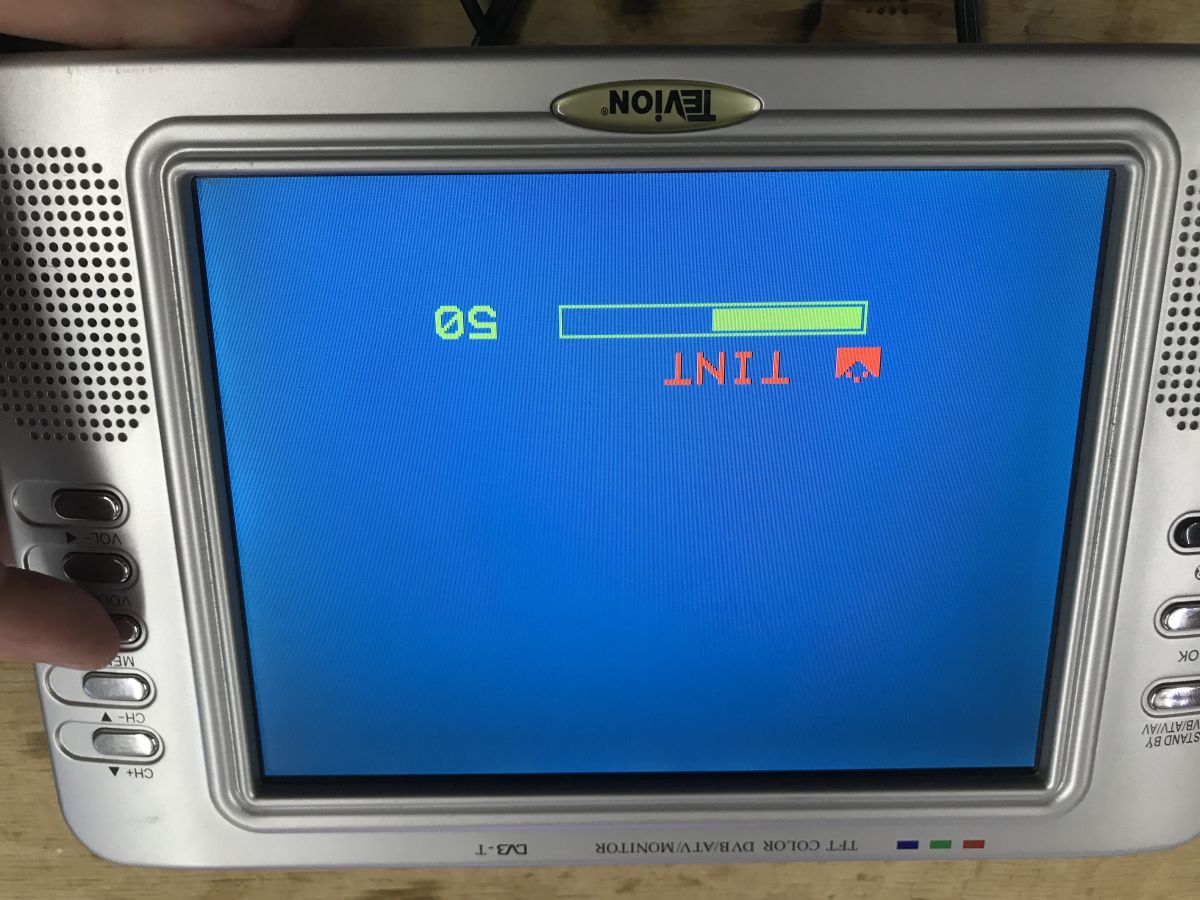

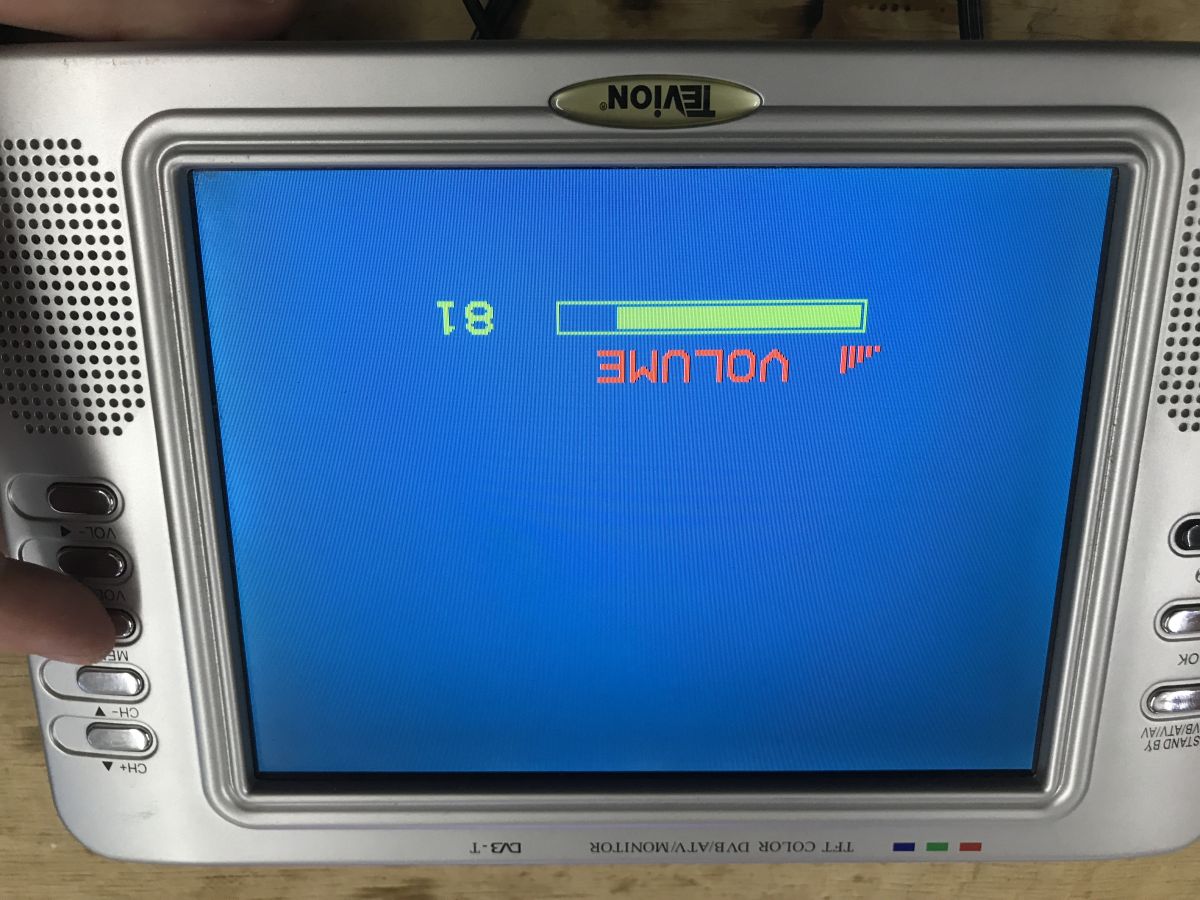

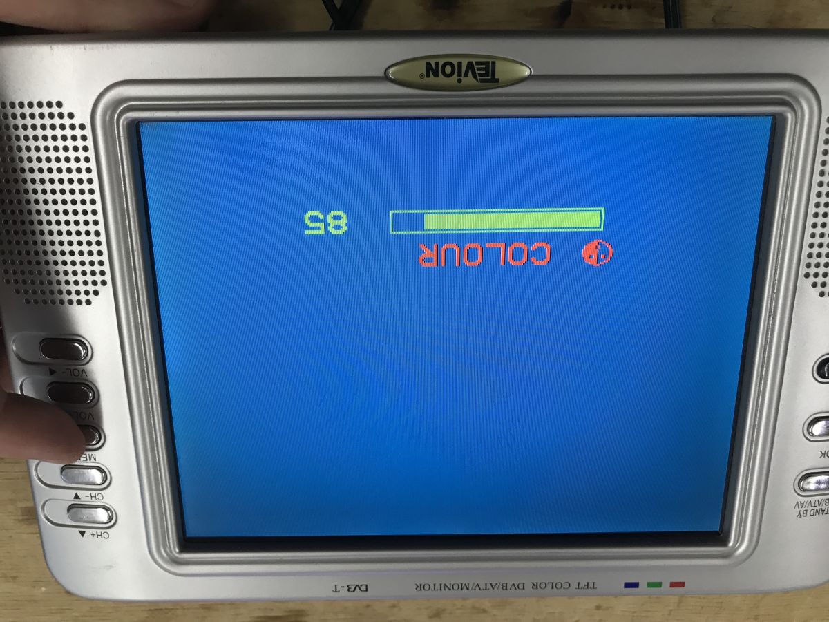

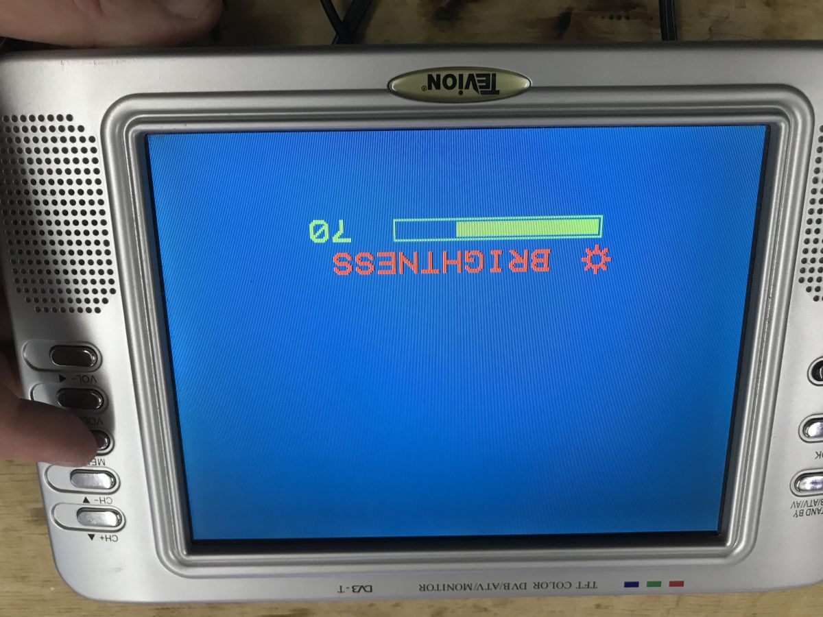

    You can only play with the menu, which in my opinion still holds that older CRT TV vibe. That colour scheme and font.
    Comparison of small displays 7" 8" for monitoring and more, measurements Comparison of small displays 7" 8" for monitoring and more, measurements Comparison of small displays 7" 8" for monitoring and more, measurements Comparison of small displays 7" 8" for monitoring and more, measurements Comparison of small displays 7" 8" for monitoring and more, measurements

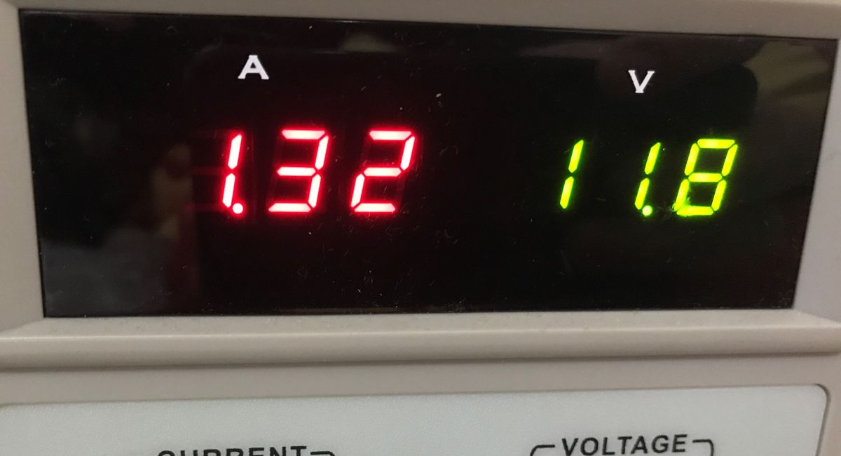

    I also measured the current at 12 volts:
    11.8 V * 1.32 A gives approximately 13.5 W.

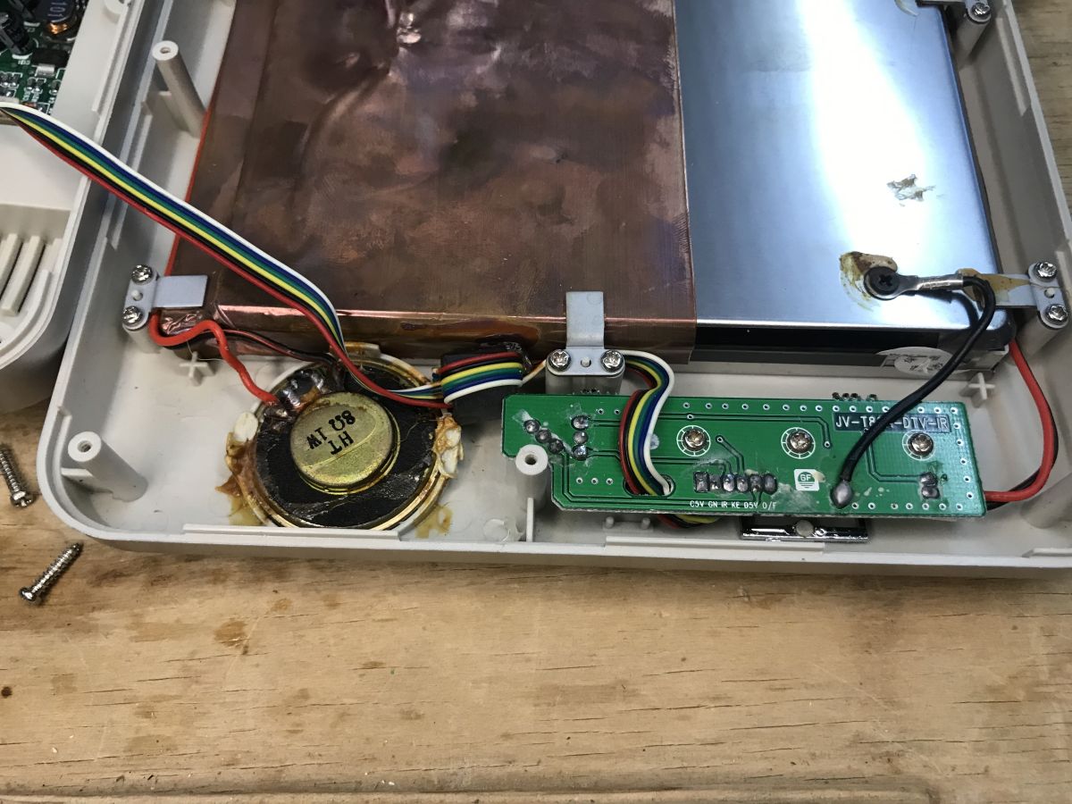

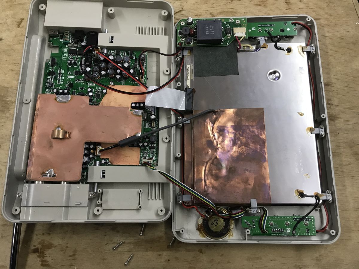

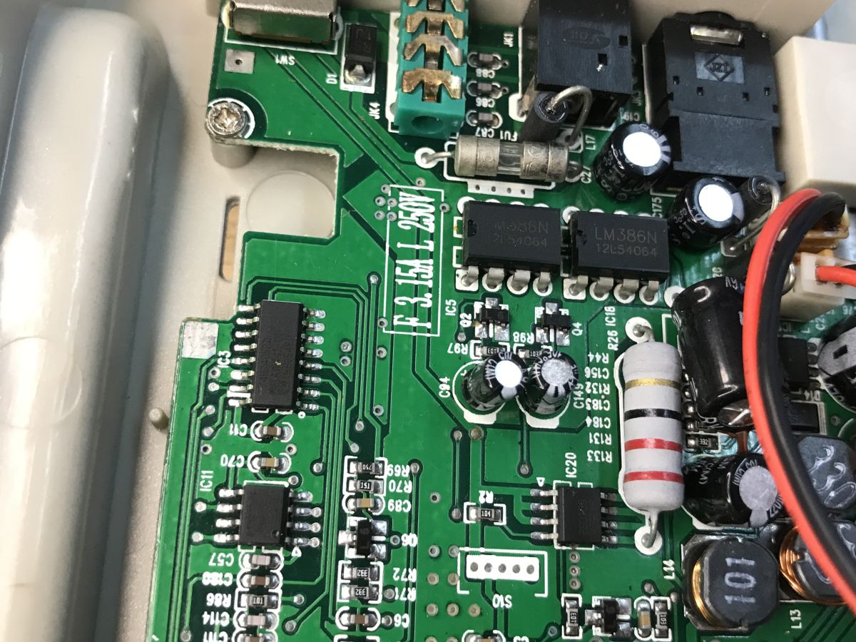

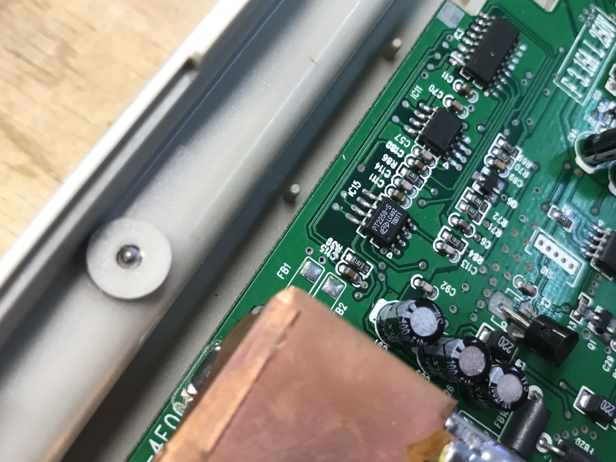

    It remained to look inside. The copper shielding hides quite a lot from us, but at least by the pulse transformer board and the characteristic connector we can judge that the backlighting here is still fluorescent. The whole circuit is not yet as integrated as in newer monitors.
    Of the separate circuits inside, the LN386N amplifiers and the PT2259 driver are conspicuous, the rest I have not analysed.

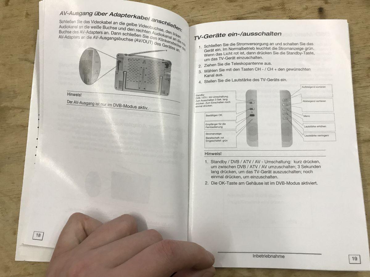

    Finally, the instructions:

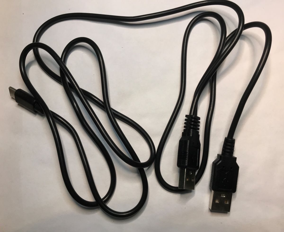

    We start with the contents of the kit, as the box was unlabelled. This is also where we get the wires to start.

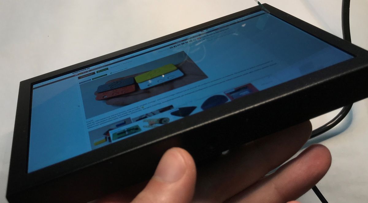

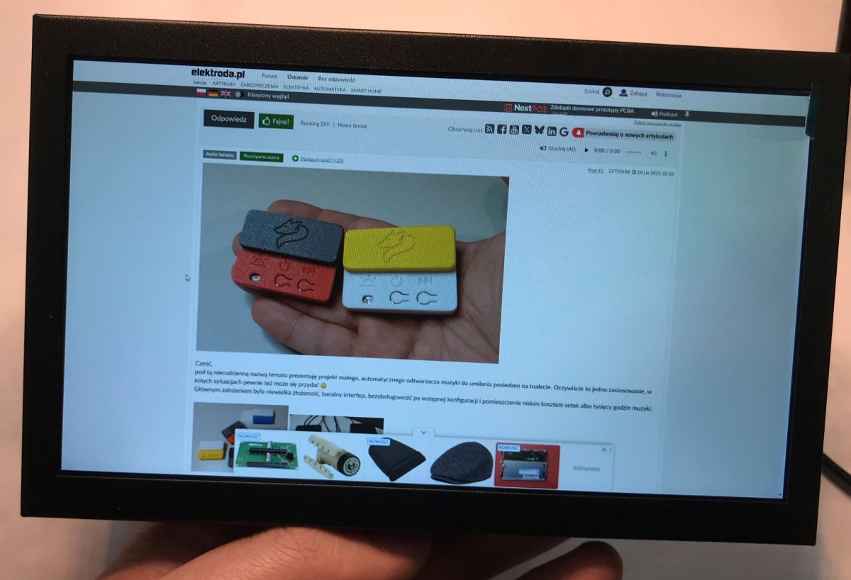

    Image is quite legible, no problem looking at an angle:
    Comparison of small displays 7" 8" for monitoring and more, measurements EM713 monitor displays elektroda.pl webpage with image of 3 small electronic devices 7 LCD EM713 monitor displaying a website at an angled side view

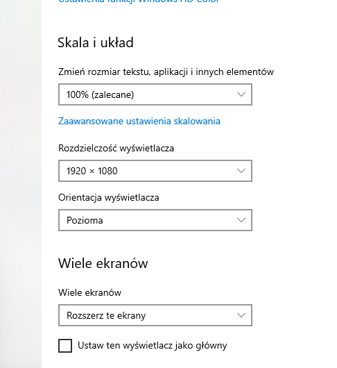

    The monitor accepts a 1920x1080 signal which then goes to a 1024x600 matrix:
    Windows display settings with 1920×1080 resolution and 100% scaling selected

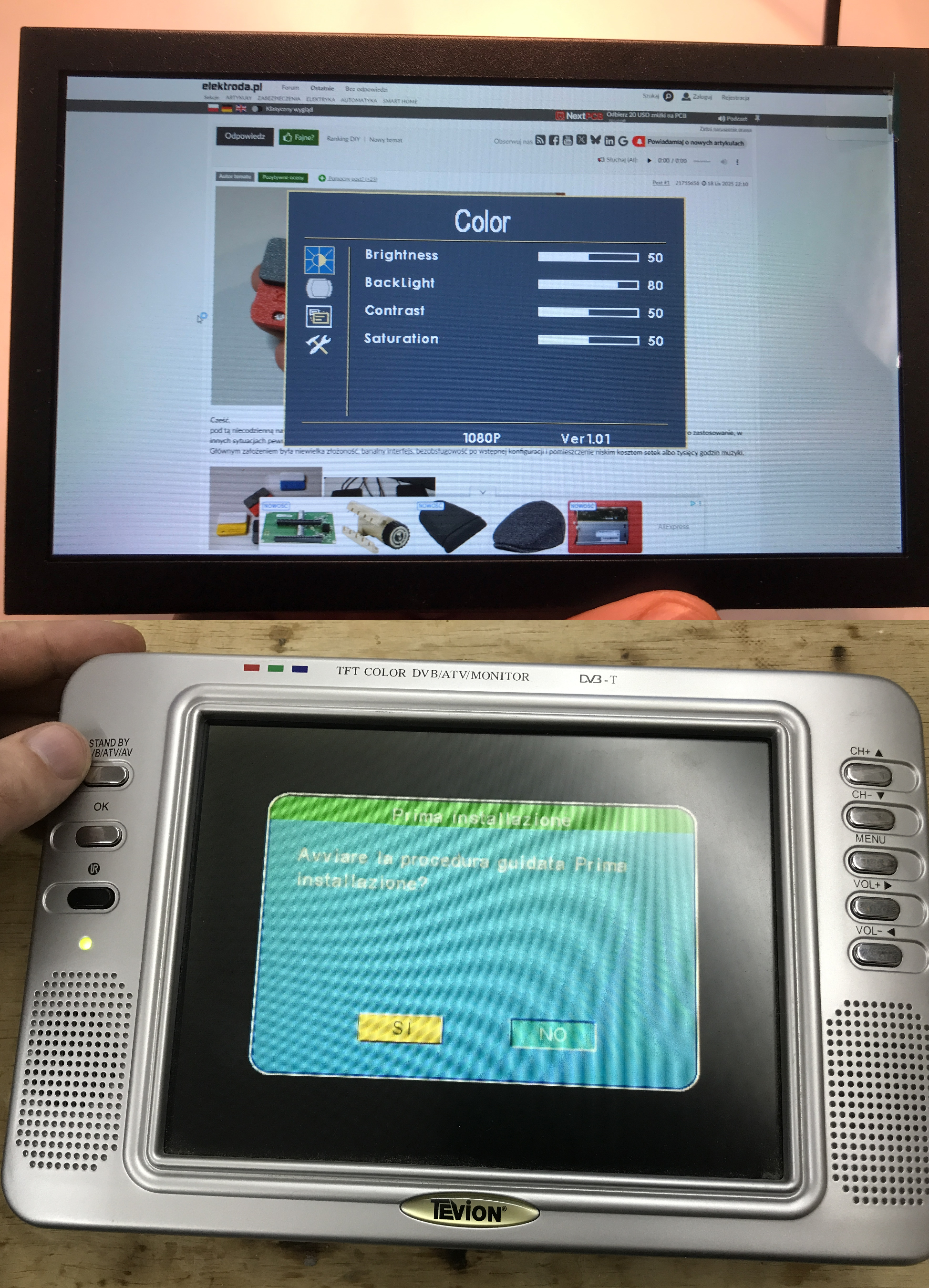

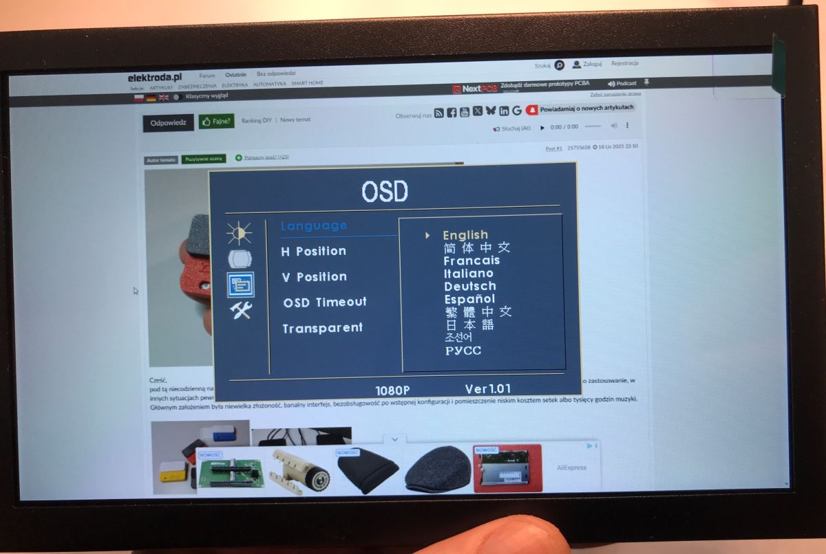

    The menu is already reminiscent of the style of newer designs, we have here the basic picture settings, but the Polish language is not to be found anyway:
    OSD menu on EM713 7 monitor showing language list and image position settings LCD screen showing image settings menu, held by hand in front of a website LCD EM713 display settings menu with image ratio and sharpness options visible On-screen menu of EM713 display shown upside-down On-screen menu of EM713 display shown upside-down

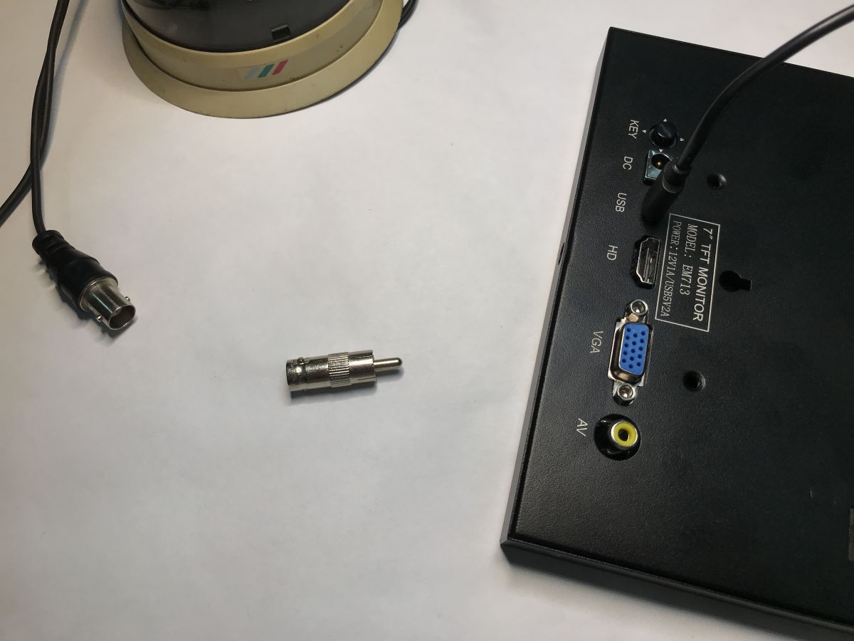

    We received an RCA to BNC adapter in the kit, so there is no problem connecting the camera:
    Close-up of BNC, RCA adapter and HDMI, VGA, AV ports on EM713 monitor LCD screen showing camera feed, held in left hand, dome camera visible in background

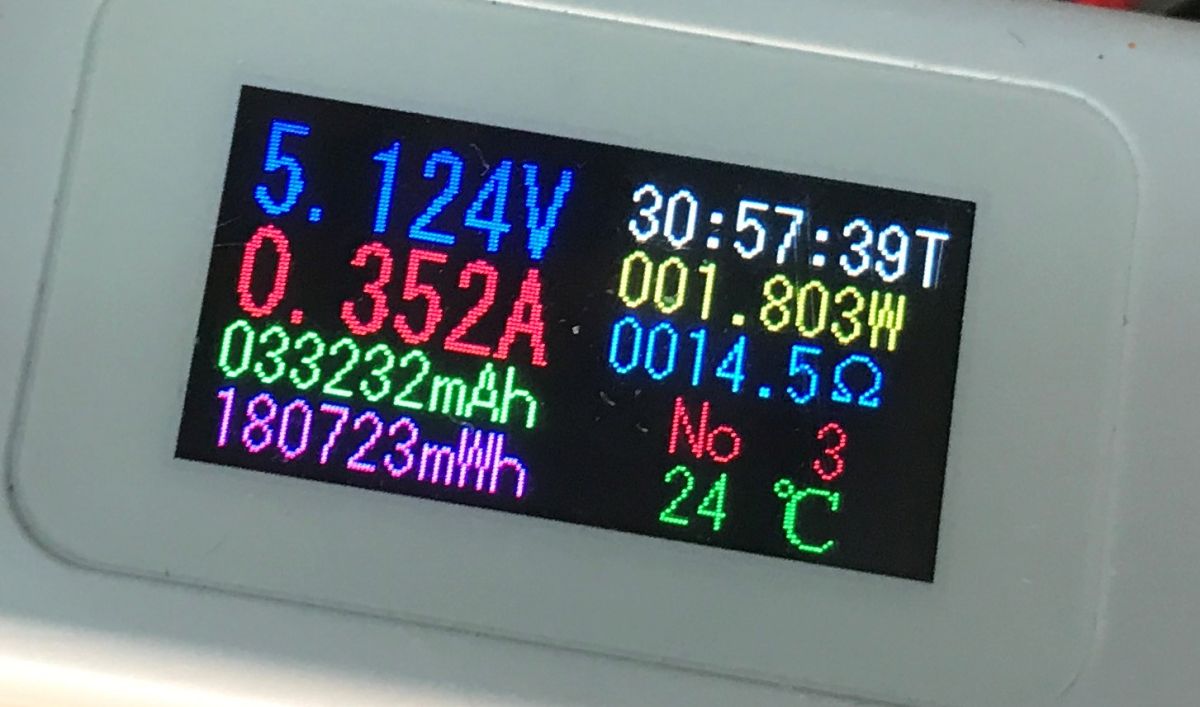

    Now the current measurements. The backlight setting changes the current a lot, brightness not at all. First backlight 10% (you can go down to 0%, but that's pointless - you can't see anything then and there might be a problem with the backlight):
    USB meter screen shows 5.124 V voltage and 0.352 A current draw
    5.1 V * 0.35 A = 1.8 W

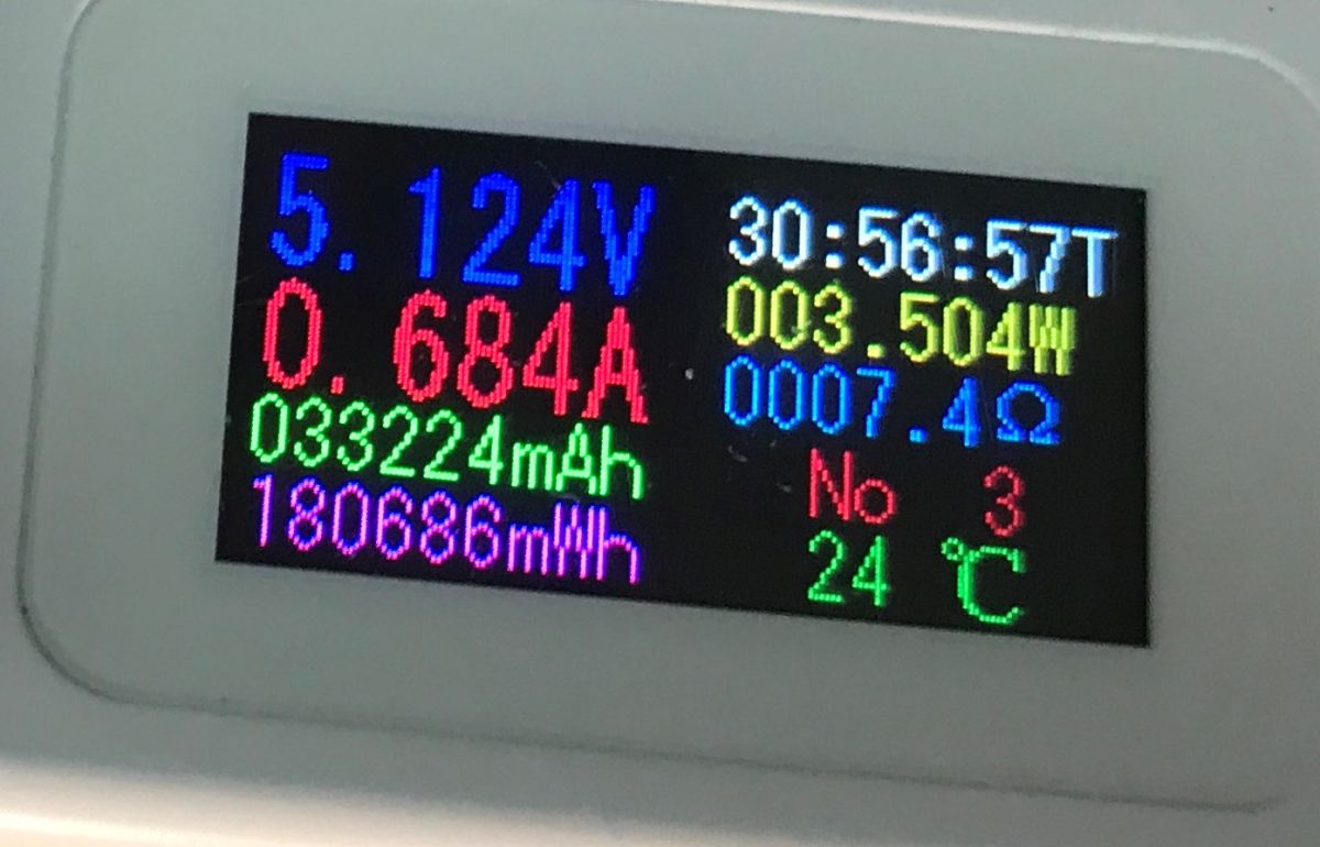

    80%:
    Meter display showing 5.124 V voltage and 0.684 A current from a USB power meter
    5.1 V * 0.68 A = 3.5 W

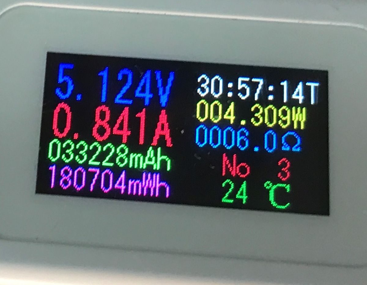

    Meter display showing 5.124 V, 0.841 A current, and 4.309 W power usage
    5.12 V * 0.84 A = 4.3 W
    In summary, such a monitor costs us between 1.8 W (with a lower backlight it is unlikely to be usable) and 4.5 W.

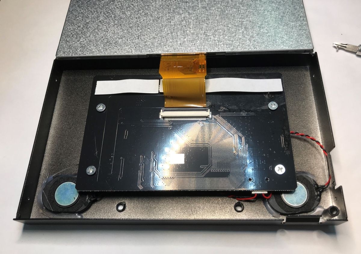

    It remains to look inside:

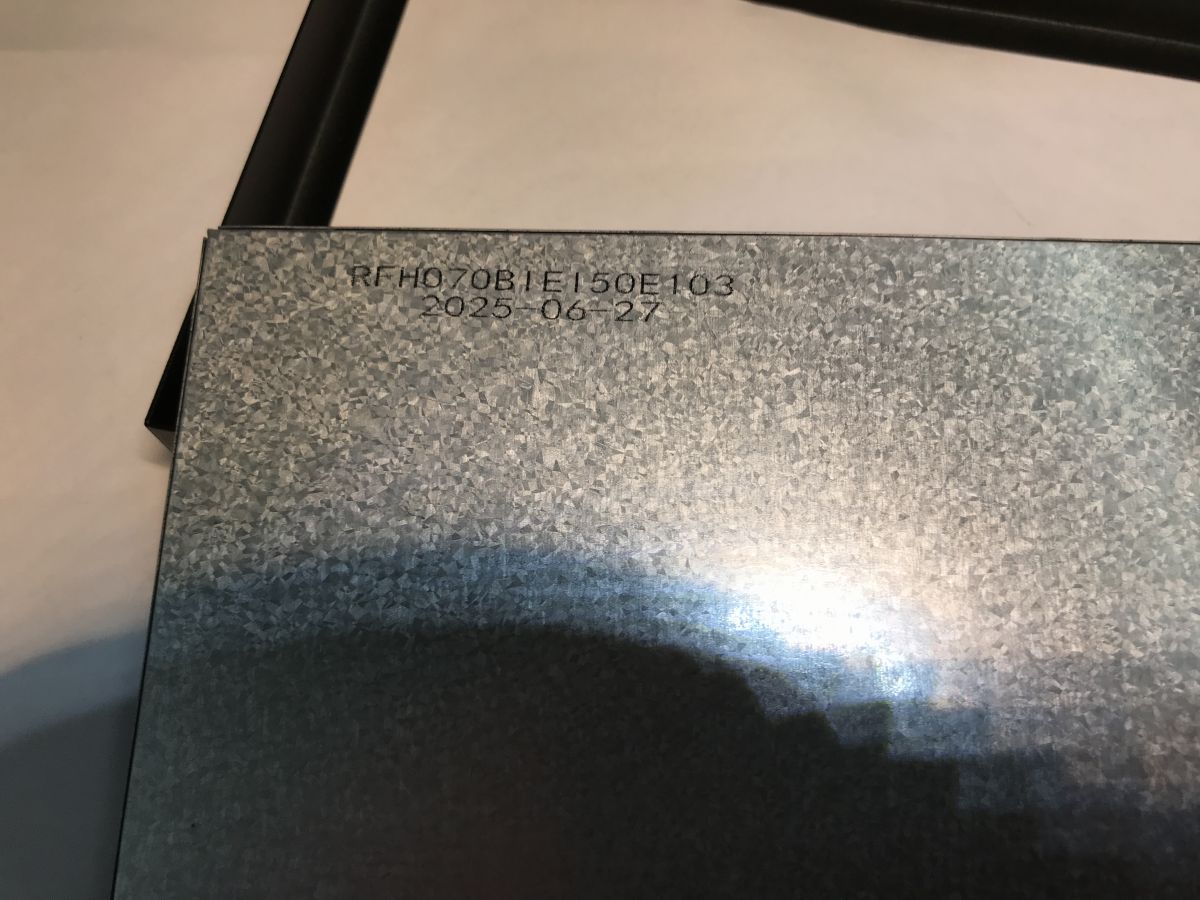

    Close-up of a metal panel with 2025-06-27 date and code RFH070B1E150E103 printed Inside of LCD monitor case showing main PCB and connected ribbon cable
    Date on the matrix - 2025-06-27, fresh.

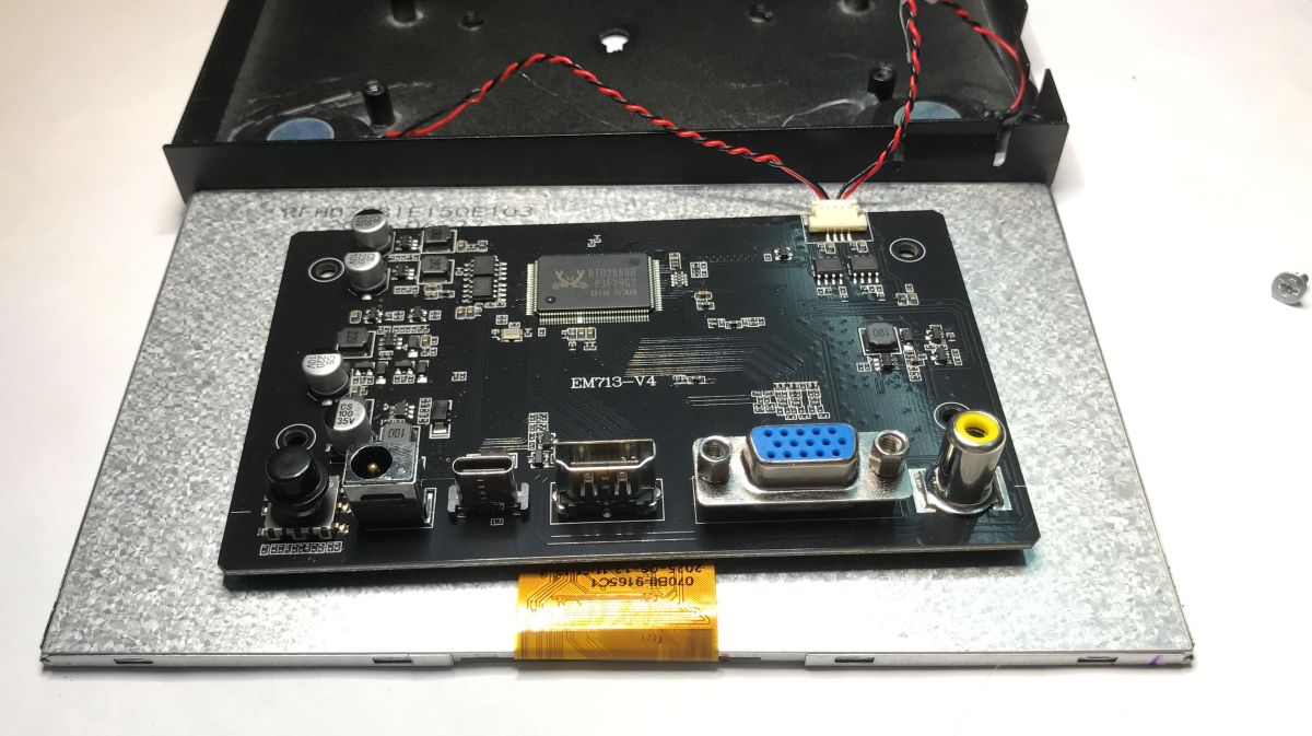

    EM713 LCD monitor mainboard with visible VGA, HDMI, and USB ports

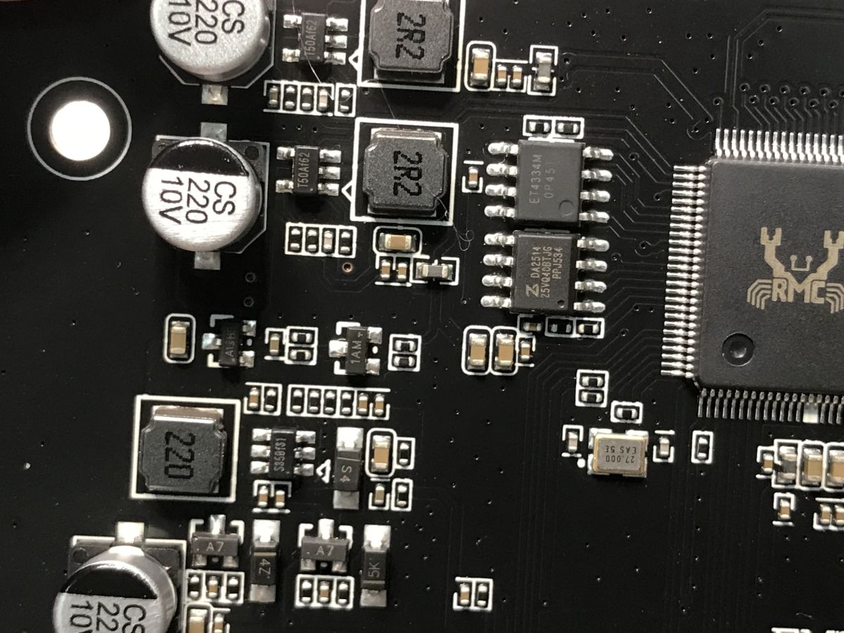

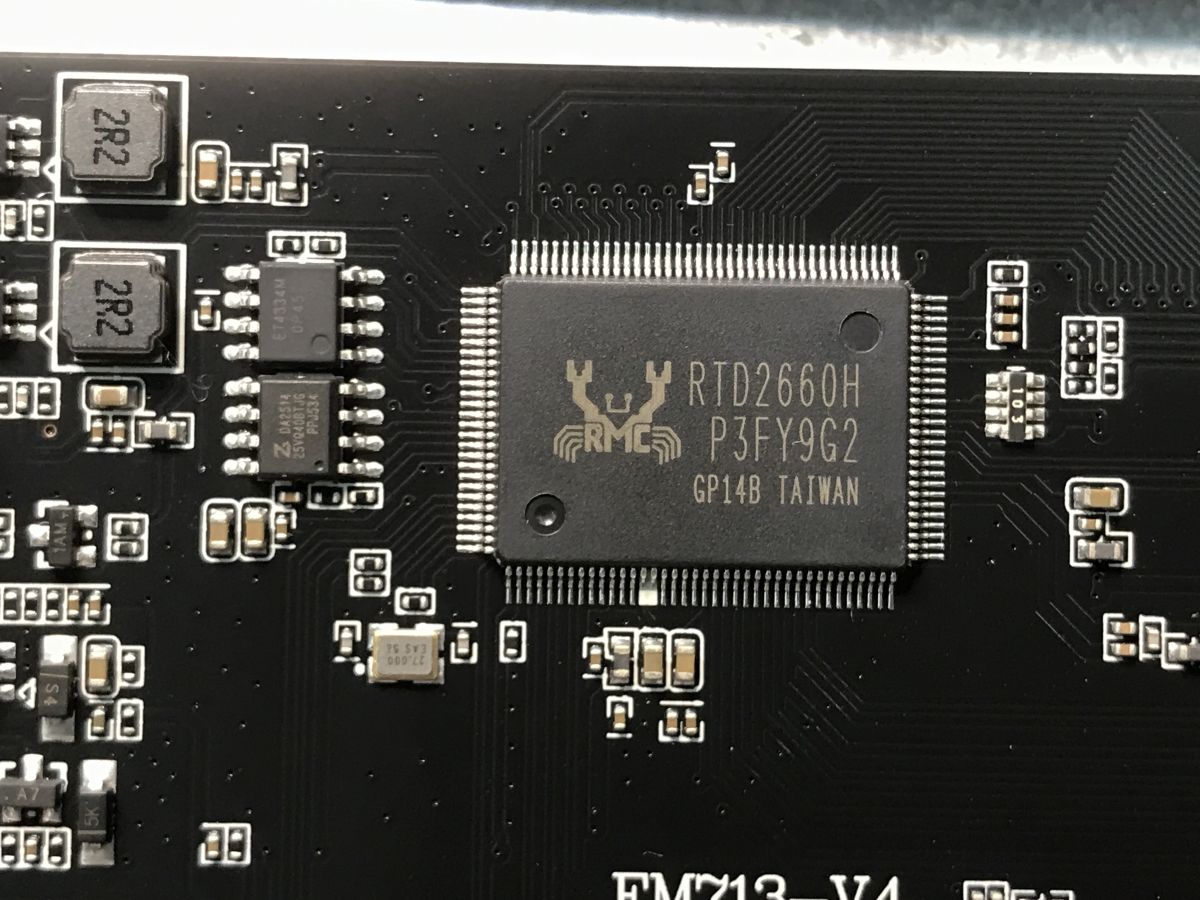

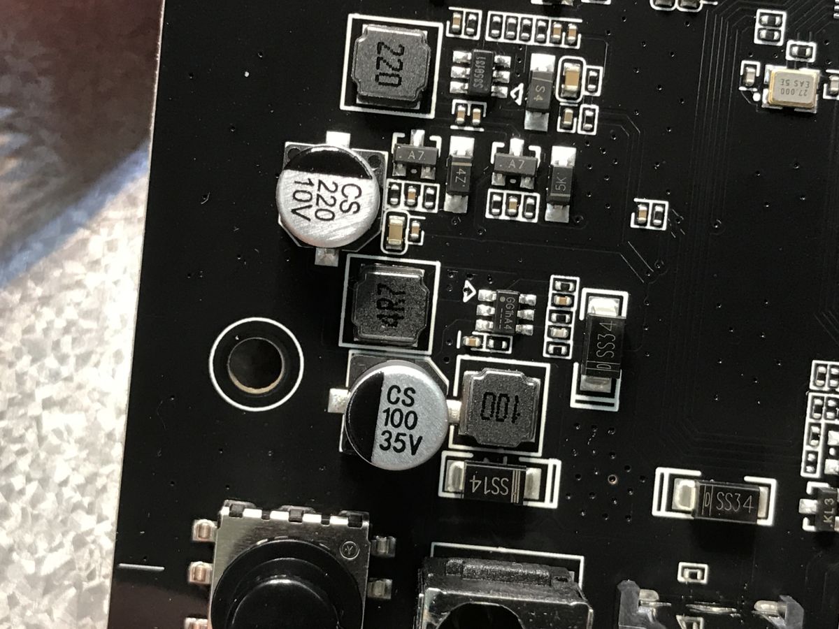

    Everything is on a single PCB. The heart of the chip is RTD2660H , a well-known chip, also found in universal LVDS controllers.
    Close-up of RTD2660H chip on black PCB inside EM713 monitor Close-up of PCB showing ET4334M DAC, 25VQ40BT Flash, RTD2660H chip, and 220µF 10V capacitors Close-up of electronic components on a black PCB with CS-labeled capacitors.
    Right next to it we see the 25VQ40BT, a Flash memory, and the ET4334M, a 24-bit DAC converter. This appears to be for audio. There are even smaller chips - two T50Af62s, anyone decipher? It seems to me that these could be separate right and left channel audio paths.

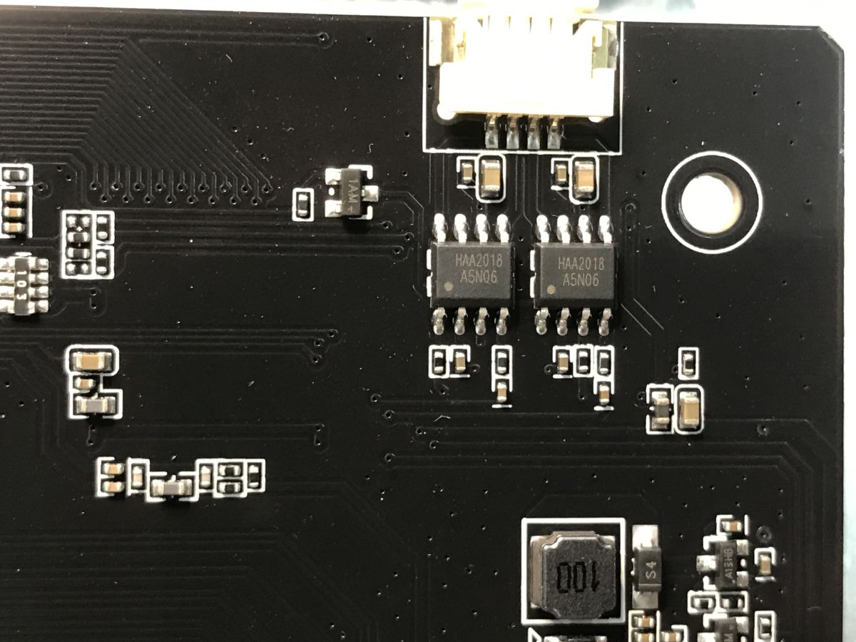

    Close-up of two HAA2018 A5N06 chips on a black PCB with nearby components
    The two HAA2018s at the connector from the speakers need no explanation - they are audio amplifiers.
