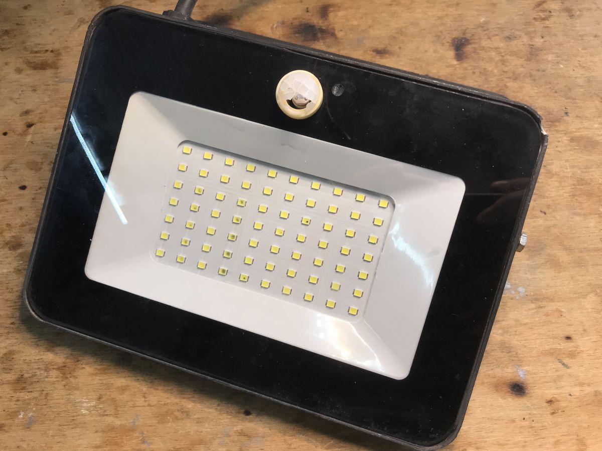

    I would like to invite you to a destructive demonstration of a powerful outdoor LED lamp with a PIR motion sensor. The equipment came to me completely inoperable, so I decided to check its construction for teaching purposes. I was mainly puzzled by what was broken, and how the LED control and the motion sensor were implemented.
    I don't know the model of this lamp, so the whole thing will be based on guesswork.

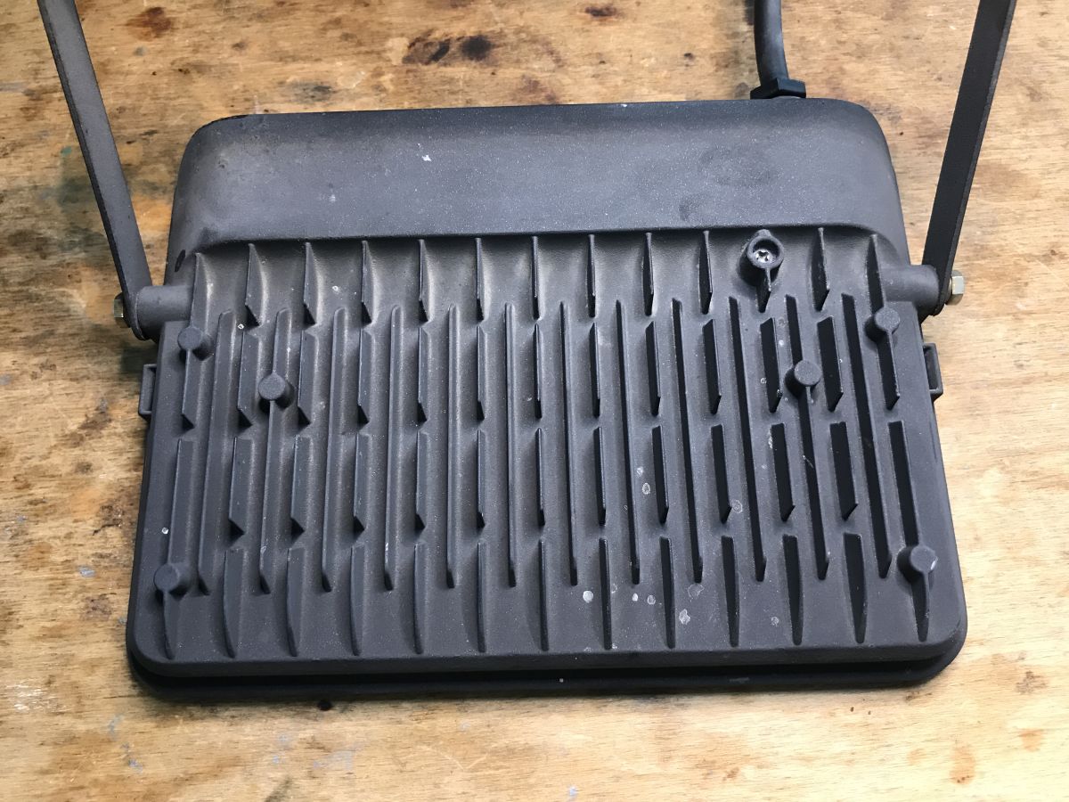

    The housing is metal and solid, and you can also see that it has 'fins' on the back for heat dissipation. 50 W in LEDs is a lot of power though, and after all, not all of it turns into light. I wonder what efficiency the LEDs are in there.

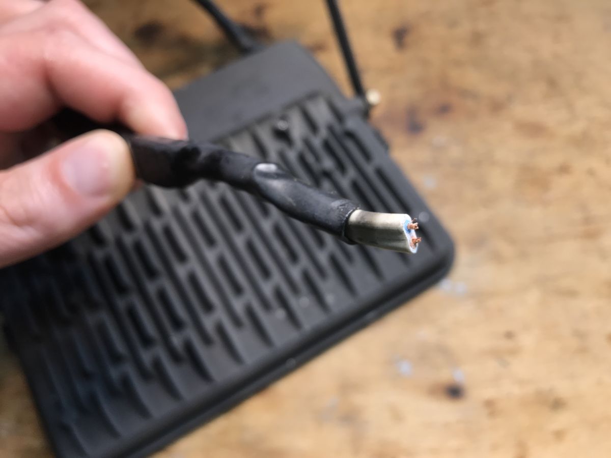

    I guess the previous owner decided that earthing was unnecessary and wired the whole thing with a two-wire wire.

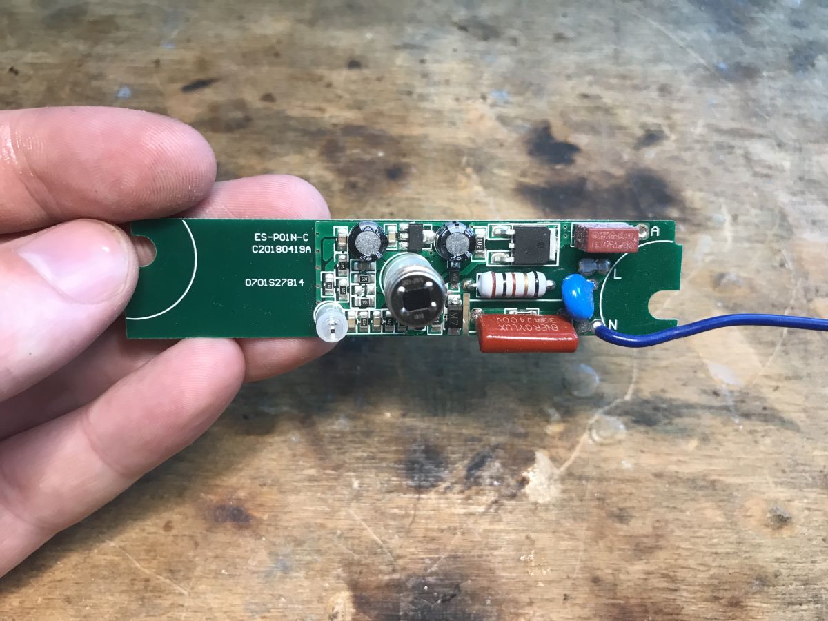

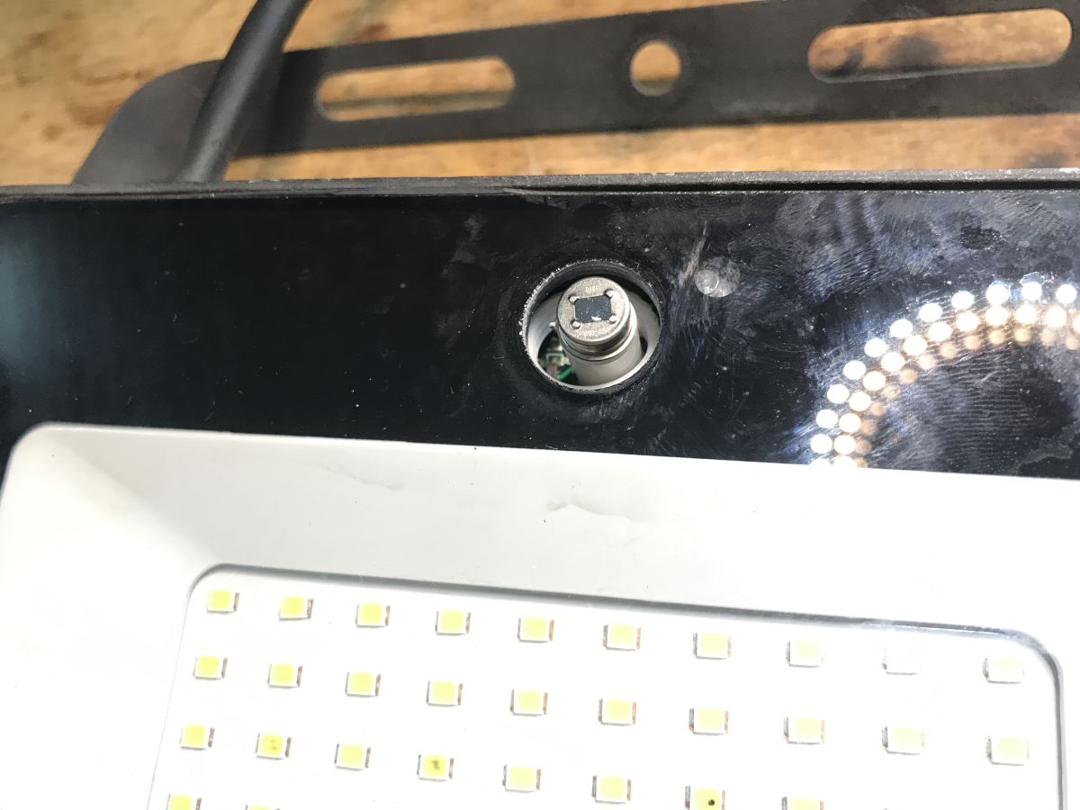

    Here you can see a PIR sensor, I associate such from various other hardware, there are also such ready-made modules for Arduino. You can also see the LEDs punctured, this is probably how this hardware ended its life.

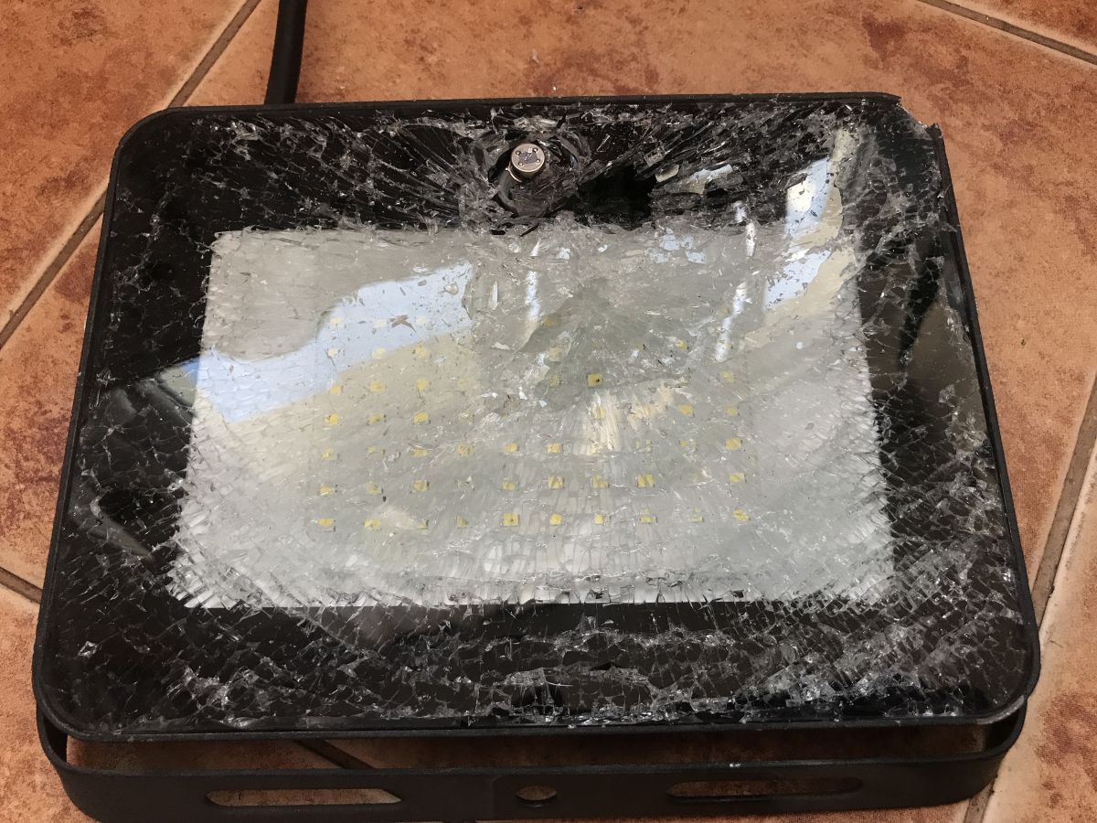

    Unfortunately I have not found a way to get inside in a non-destructive way .
    Interior, failure rate and construction of a 50W outdoor LED floodlight with motion sensor

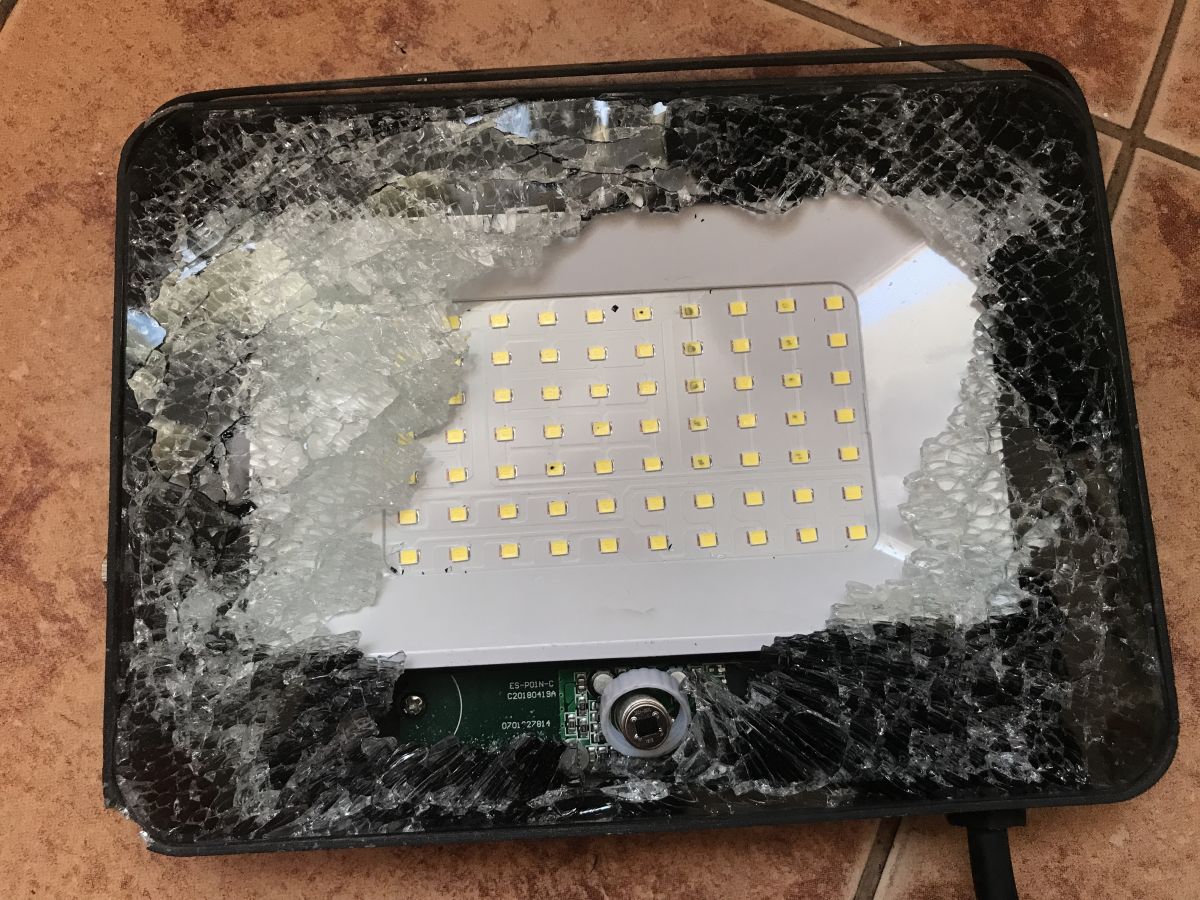

    Hammer and drive. Good thing the whole thing is made of special glass that doesn't shoot shards left and right.

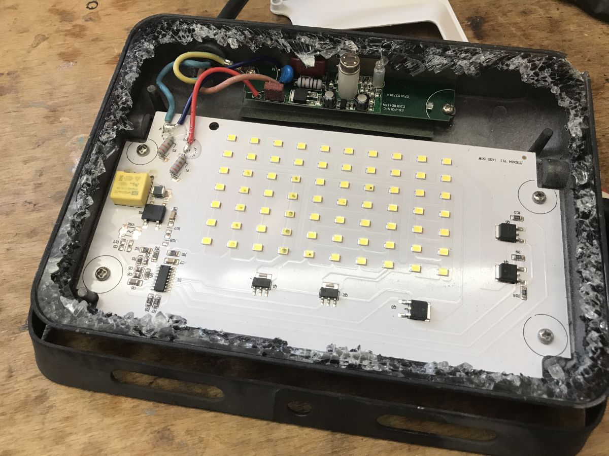

    This way we almost have the interior. You can see that there are two separate modules inside. Probably copies without the PIR sensor are also produced. This module with PIR probably works.

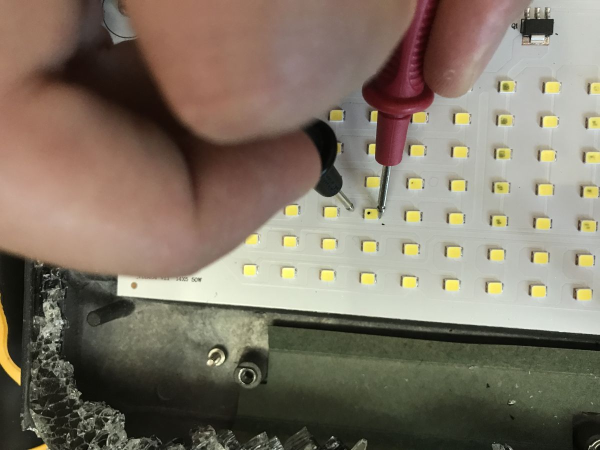

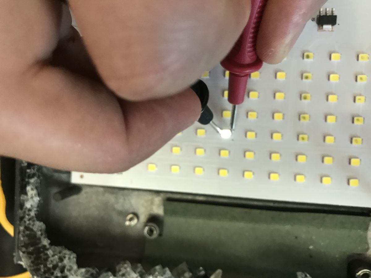

    Out of curiosity I tested the LEDs - some are faulty and a break in the circuit. Interestingly, some with black dots still work:

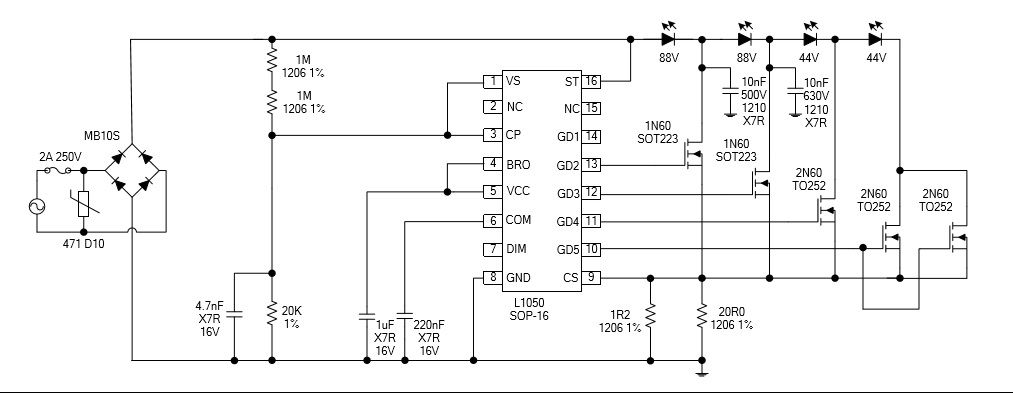

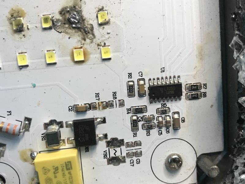

    However, let's start at the beginning. There is a phase wire and a neutral wire to the board, with the phase wire connected through the motion sensor. Then we have two fuses, an anti-interference capacitor and a rectifier bridge. Circuit U1 (L1050) appears to be a constant-current LED controller and is powered directly from the mains.

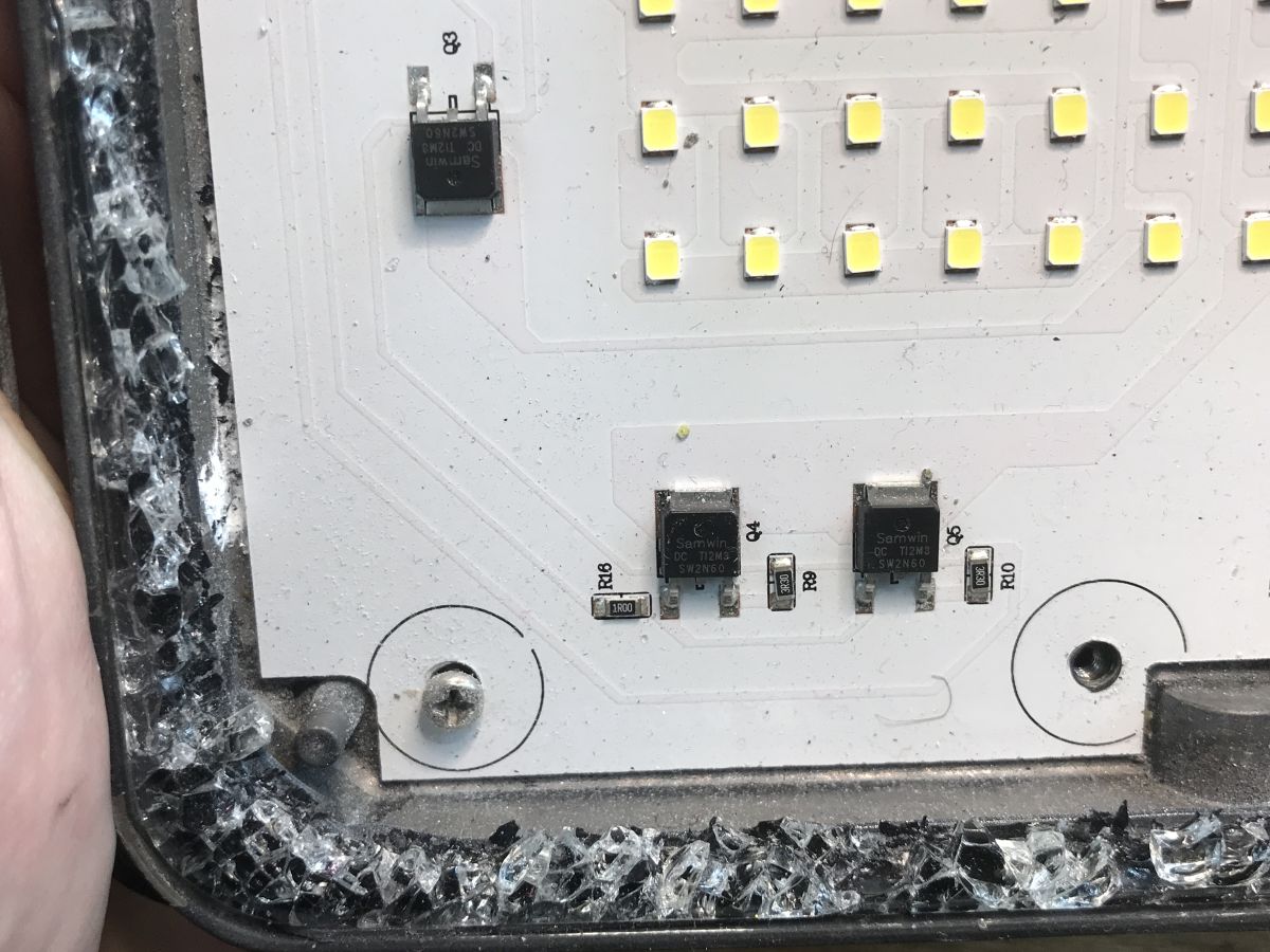

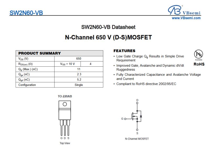

    Next we have the transistors, primarily I see the SW2N60 there:
    These are MOSFETs with an N-type channel for high voltage, I was surprised by their resistance in the open state:
    I managed to find a whole schematic showing a similar circuit:

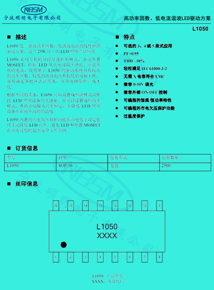

    I was quite surprised by the way the LEDs are connected, anyone know what purpose this is used for? The rest is pretty clear, the CS pin is used to measure current (via the voltage drop across the shunt resistor), the 1MΩ resistors to power the controller circuit.
    Specification of L1050 LED driver IC showing features and pin diagram in Chinese.

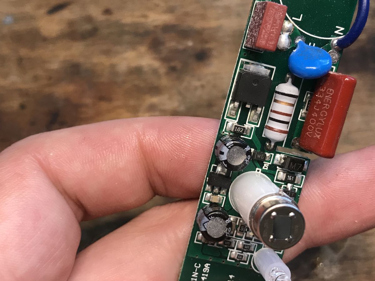

    What's left is the PIR module. A cool little gadget. There's even a fuse and a varistor.
    Electronic PIR motion sensor board held in a hand Electronic module with PIR sensor held in hand, visible capacitors and resistors Bottom side of a PCB with visible traces and solder points, held above a wood surface
    The lamp is potentially repairable but it is now without glass and in addition soldering in new LEDs is difficult, the whole thing effectively dissipates heat. A heater would be useful.

    I don't know if they are all glued with the same black glue, but I've dealt with some that, when the metal part was heated at the contact with the glass, the glue mass became flexible. I lifted the glass without any problem. Strangely enough, I noticed that this glue is resistant to acetone and alcohol. So chemical dissolving does nothing.

    I was quite surprised by the way the LEDs are connected, anyone know what purpose this is used for? The rest is pretty clear, the CS pin is used to measure current (via voltage drop across the shunt resistor), the 1 MΩ resistors to power the controller circuit.
    The LEDs are supplied with full, rectified, pulsating mains voltage. To minimise flicker, when the voltage is lower than the conduction voltage, a piece of the section is cut off. Will work well with a large number of LEDs in series (230 V supply).
    I would try to cut the glass with dental floss.

    I have repaired several similar headlights for myself that were written off, except that they do not have a motion sensor. You can get the glass out in its entirety with a bit of self-denial using GSM device service tools (thin undermining/separating plates, molybdenum wire, chemical action or heating). Disassembly looks similar to peeling off the display in a tablet, except that the glue in the lamps holds more firmly (there is much more of it). In my case, the most effective solution was a tin with the B&R logo engraved on it, which can be found under the phrase "phone opener". If you don't care about aesthetics then it's a good idea to make a "notch" in one of the corners as a starting place for further action between the glass and the body.
  • Drill out glass and measure LED branch voltages
    #7 21801479
    sampler
    Posts: 441
    Help: 22
    Rate: 80
    I have repaired quite a few such lamps. Usually the cause is low quality diodes, so the repair is also for a while.
    Firstly, the method of opening. There is a simple method. Drill a small hole fi 2-3 mm at the back in the housing in the corner of the glass and screw in a metal screw. The screw will push the glass out beautifully. These glues are mostly chemically cured so heating and undermining is a waste of time.
    As the author noted there is also the problem of soldering out the old diodes. The board is glued to the case and dissipates heat well. I cut out the old diodes with pliers and solder in the new ones. The most important thing is to measure the voltage on the diode branches. There are different voltages on the diodes. From 3 volts to 18 volts.
