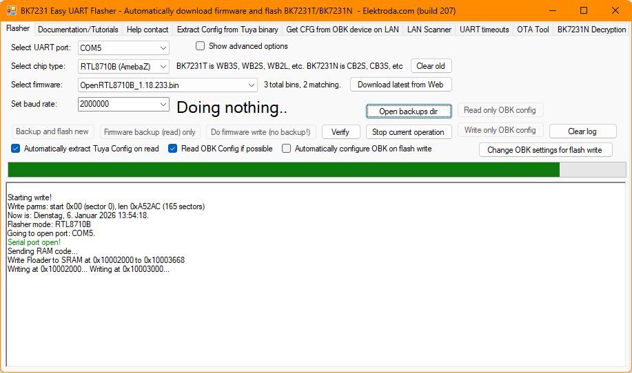

    Hello, I am trying to flash an RTL8710BX with OBK using BK7231GUIFlashTool.
    But when writing the FLOADER, it hangs (always here:)
    BK7231 Easy UART Flasher interface with firmware writing process active
    I have tried several baud rates - always the same.
    What can I do?

    On my first time, flasher crashed.
    But, since i didn't reconnect RTL8710BX board and floader was already uploaded everything else worked fine.
    On the second try there were no problems.
    Baud rate - 1500000.
    On my third try it hanged, but restarting flasher without reconnecting the device helped.

    Thanks, good tip. It worked now on the 2nd try.
    I also used another Silicon Labs CP210x USB to UART Bridge.
