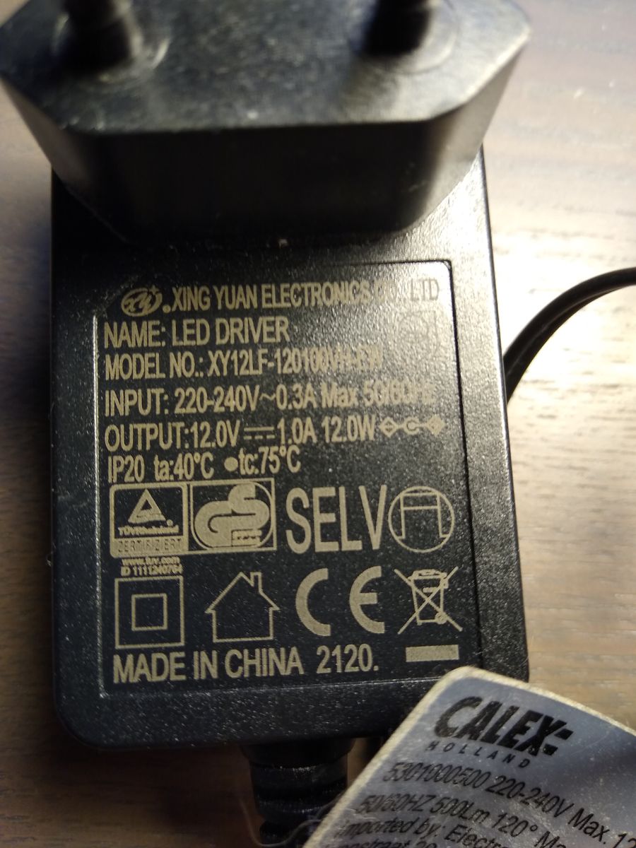

    AI: Can you share details about the power supply you're using for the lamp (voltage, type, and whether it's stable or has any delay/soft start features)?
    Default socket power supply (12V, 1A) part of the lamp.

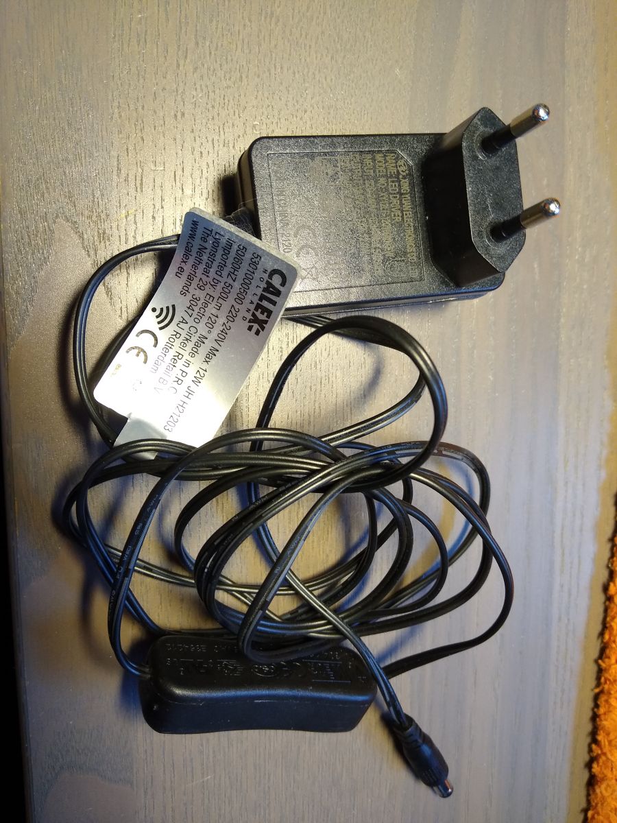

    Currently, it sounds like a power supply problem.

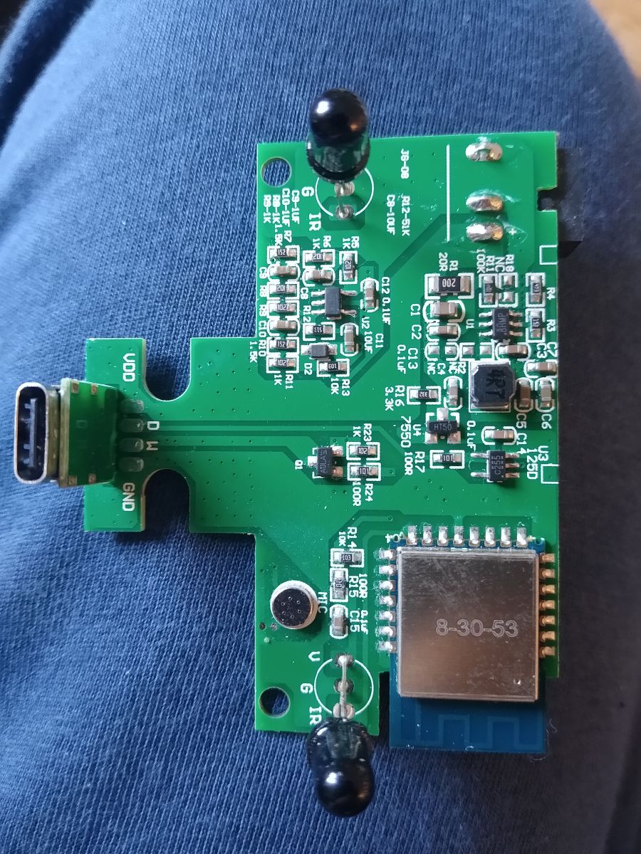

    Can you show some photos of the lamp, just for generic information? Is it easy to access the PCB?

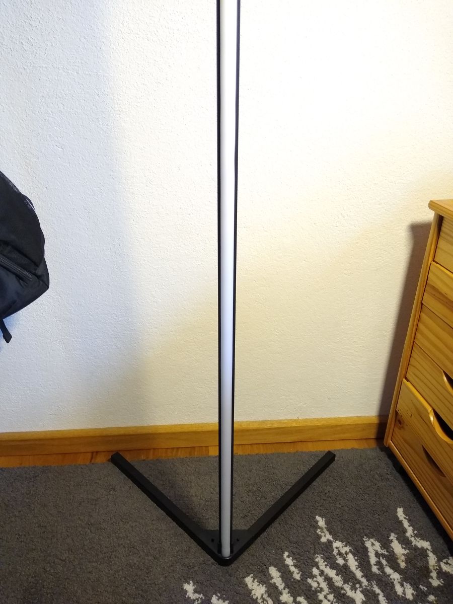

    Here we go:
    Close-up of green PCB with USB-C port and electronic components AC adapter with European plug and CALEx label attached to the cable LED driver from Xing Yuan Electronics with technical specs and certification marks Modern vertical LED floor lamp on carpet next to wooden drawer unit
