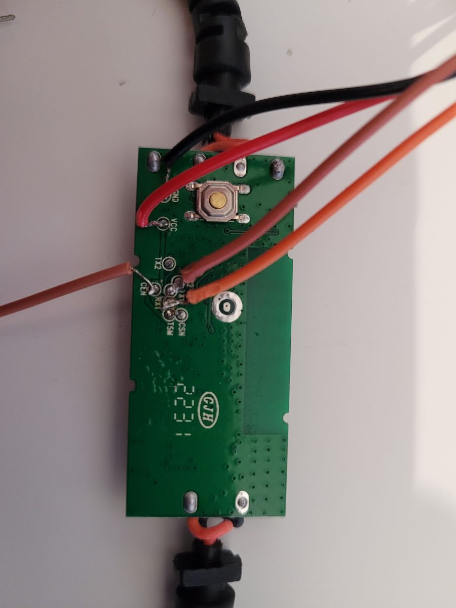

  • The Anko Sunset Lamp (I004055) RGB LED lamp controller uses a BK7231N and runs from USB-powered 5V.
  • Most pins are exposed and labelled on the underside, with P20 for the button and P6/P7/P8 for RGB PWM outputs.
  • Flashing used LTChipTool over TX1 and RX1, with CEN tied to GND when starting.
  • Reading the chip and uploading the binary eventually worked, though LTChipTool sometimes froze at 0% or low progress.

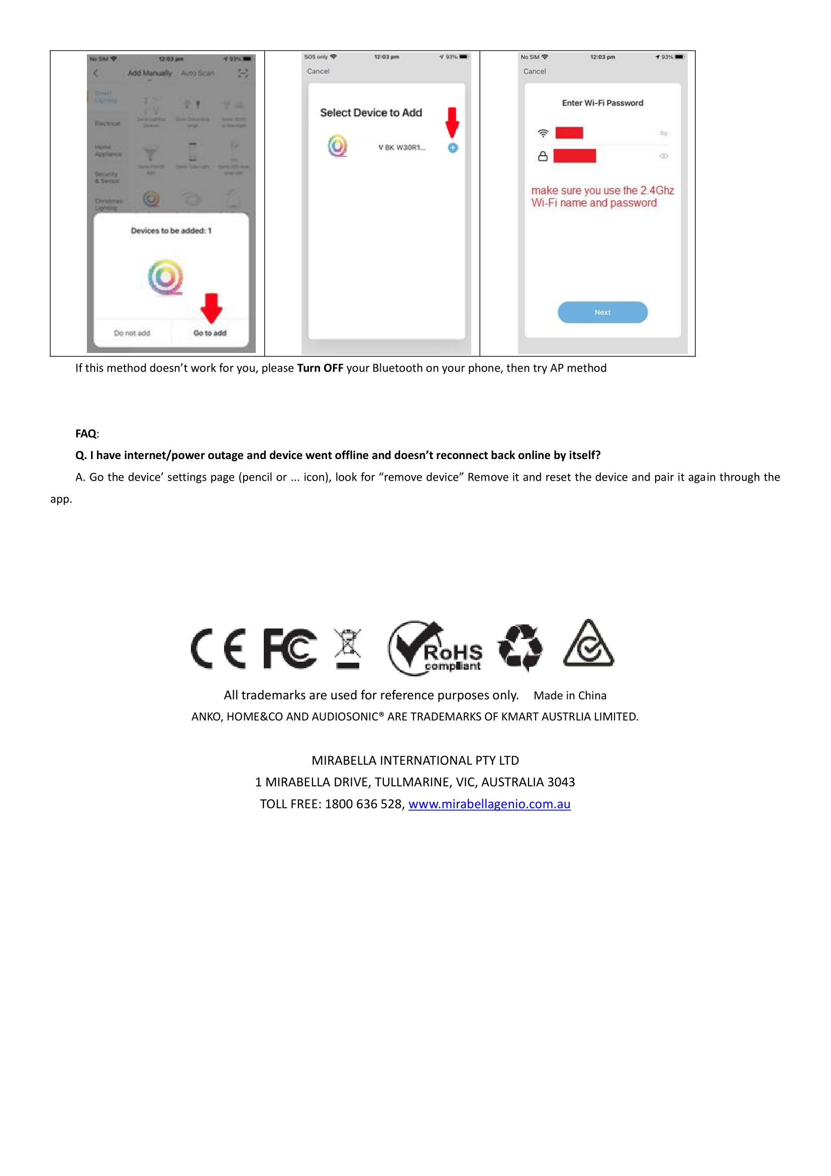

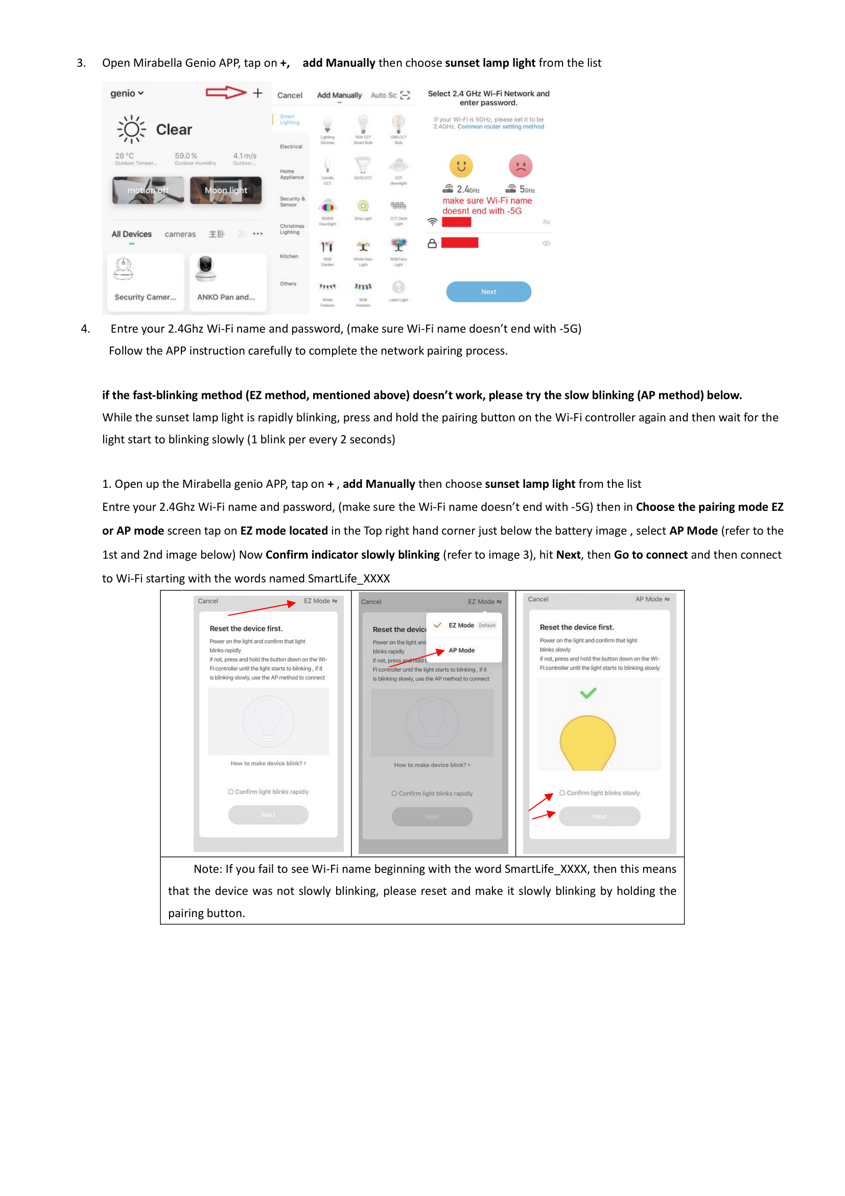

    User manual:
    User manual for the ANKO Smart Wi-Fi Sunset Lamp. Mirabella Genio app setup screen for pairing Sunset Lamp with Wi-Fi network. Screenshots of the pairing process for the Kmart Anko lamp with the Mirabella Genio app. Wi-Fi RGB lamp connection instruction.

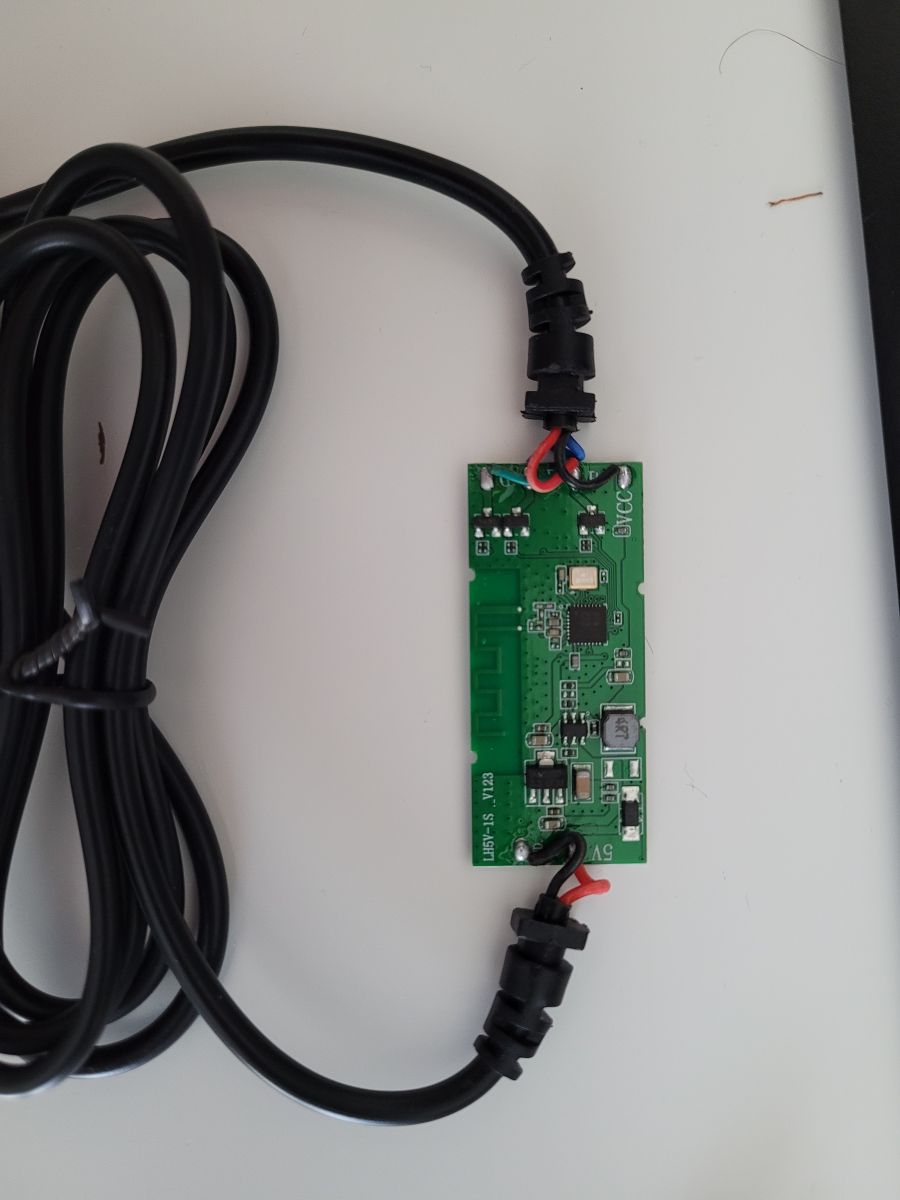

    Good news is (1) it's a 5v device (powered by USB) and (2) it's running a BK7231N inside. Doesn't seem to be a SoC/ESP type chip, just the BK7231N directly on a circuit board. Even more good news is that most of the pins are exposed and labelled on the underside of the board.
    Photos:
    View of an RGB LED lamp circuit board with attached wires. Printed circuit board with wires and electronics on a white background. Electronic circuit board with visible connections and a button.
    Pin roles:
    - P20 - button
    - P6 - PWM (red)
    - P7 - PWM (green)
    - P8 - PWM (blue)
    I was able to flash using LTChipTool (remembering to connect CEN to GND when it starts) using TX1 and RX1. Was a bit hit and miss, sometimes it would freeze at 0 or low %, but I eventually read the data from the chip and uploaded binary.
    The LED bulbs are all exposed as a single RGB PWM output from the controller (R=6 G=7 B=8). The button on the controller is pin 20, inverted, with pullup active.

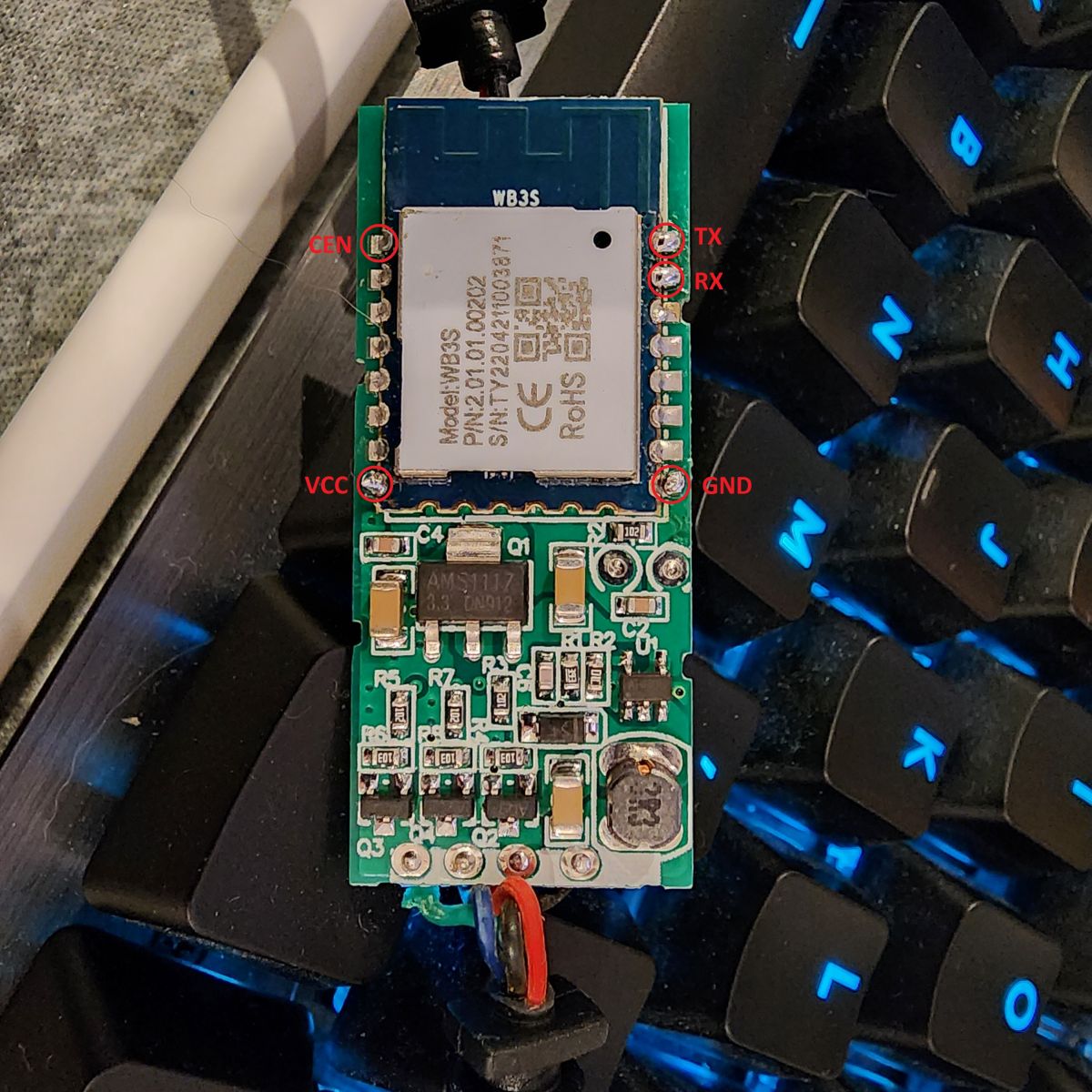

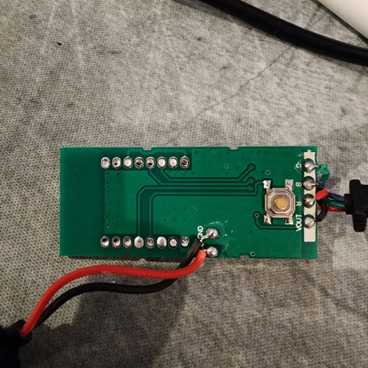

  • WB3S variant pin mapping and flashing notes
    #2 21162167
    sillychip
    Thanks for posting this! I've got two separate Anko sunset lights flashed now and they're working perfectly!
    Out of the two I flashed, one was an older revision with a WB3S inside (BK7231T) instead of the bare BK7231N. The pinout and pin mapping is different so below are some details to help anyone with this variant.
    Front of Board (pins marked):
    Image of a board with a WB3S module with marked pins CEN, TX, RX, VCC, and GND.
    Back of Board:
    Back of a circuit board with wires soldered to labeled pins.
    Solder wires to TX, RX, VCC (set to 3.3V), and GND as normal and connect the chip to the flasher.
    When flashing, ground the CEN pin to reset the module. If this results in the flasher disconnecting and the COM port disappearing from the list, plug the USB power for the module in and try again. Pulling CEN low was causing issues without external power for me.
    Mapping the pins was fortunately easy as the traces for the switch and the RGB LED are the only things under the board, and the vias at the wire end line up with the silkscreen RGB labels. Through this, I've determined the following pin roles and numbers:
    P1 - Button (1)
    P9 - PWM (1) - Red
    P24 - PWM (2) - Green
    P26 - PWM (3) - Blue
    Hopefully this helps someone out, let me know if there's something I missed and I'll update this post!

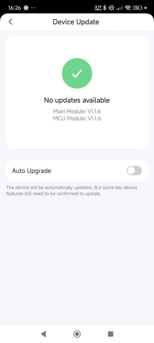

    #7 21162844
    Posts: 5188
    Help: 445
    Rate: 912

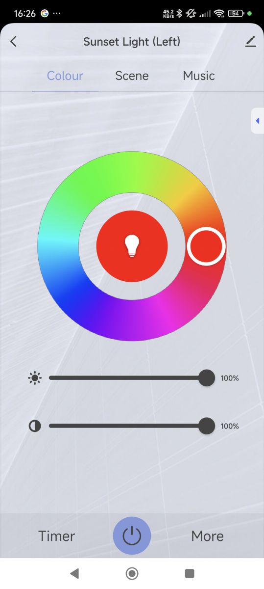

    flashed fine for me to a WB3S.

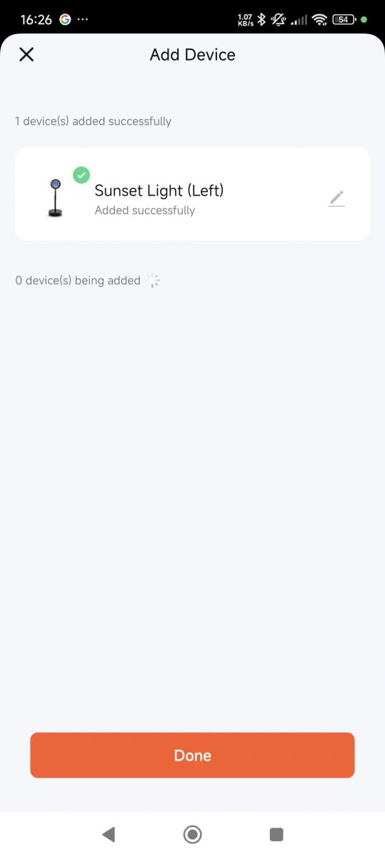

    Device update screen showing no updates available, main module and MCU version: V1.1.6. App interface for light control with color wheel App screen showing successfully added device named Sunset Light (Left).
    cloudcuttable
