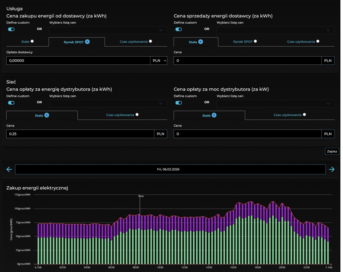

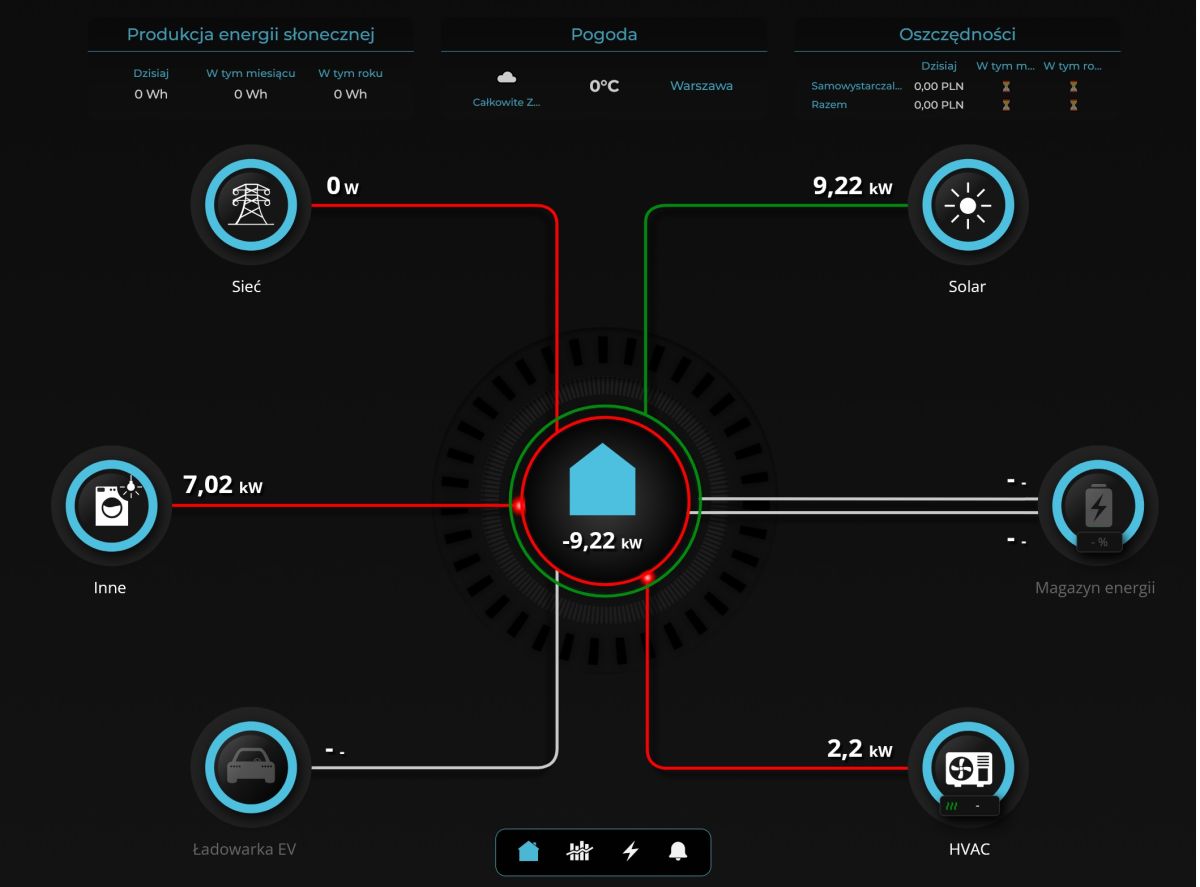

  • Considering an external EMS device like MICOMA
    #5 21830481
    karol140140
    Level 4  
    All in all, I came to similar conclusions.
    Hence the idea of an external device.
    I happened to come across MICOMA, but if you have experience with other EMS and can recommend something, I'd love to hear advice/insights.
    I have screen shots of their app with some random data, but it looks promising:
    App screenshot showing energy flow diagram: Solar 9.22 kW, Other 7.02 kW, HVAC 2.2 kW
    App screenshot with energy price input forms and a daily electricity purchase bar chart
