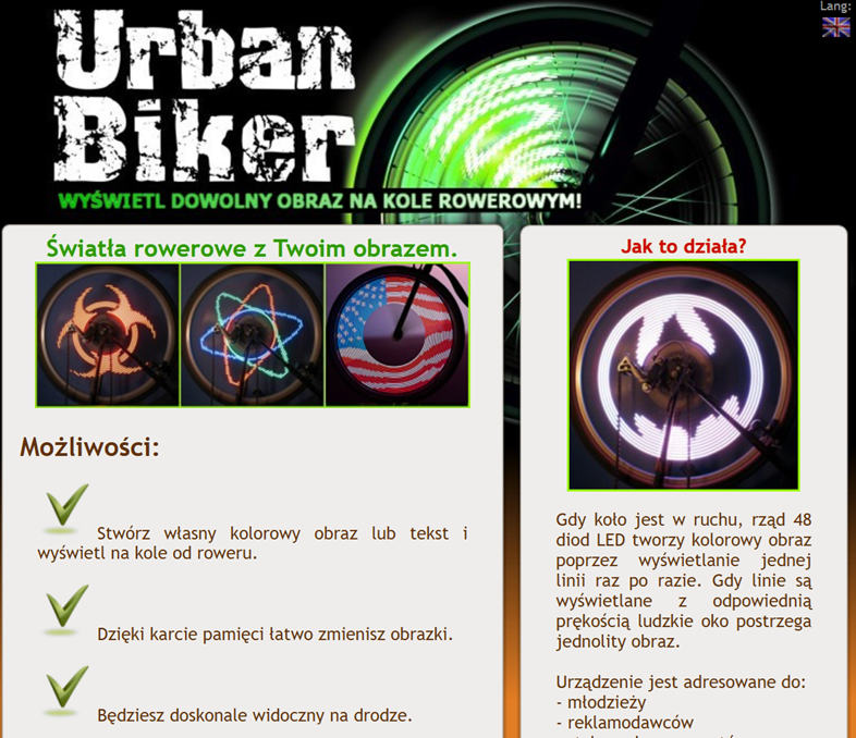

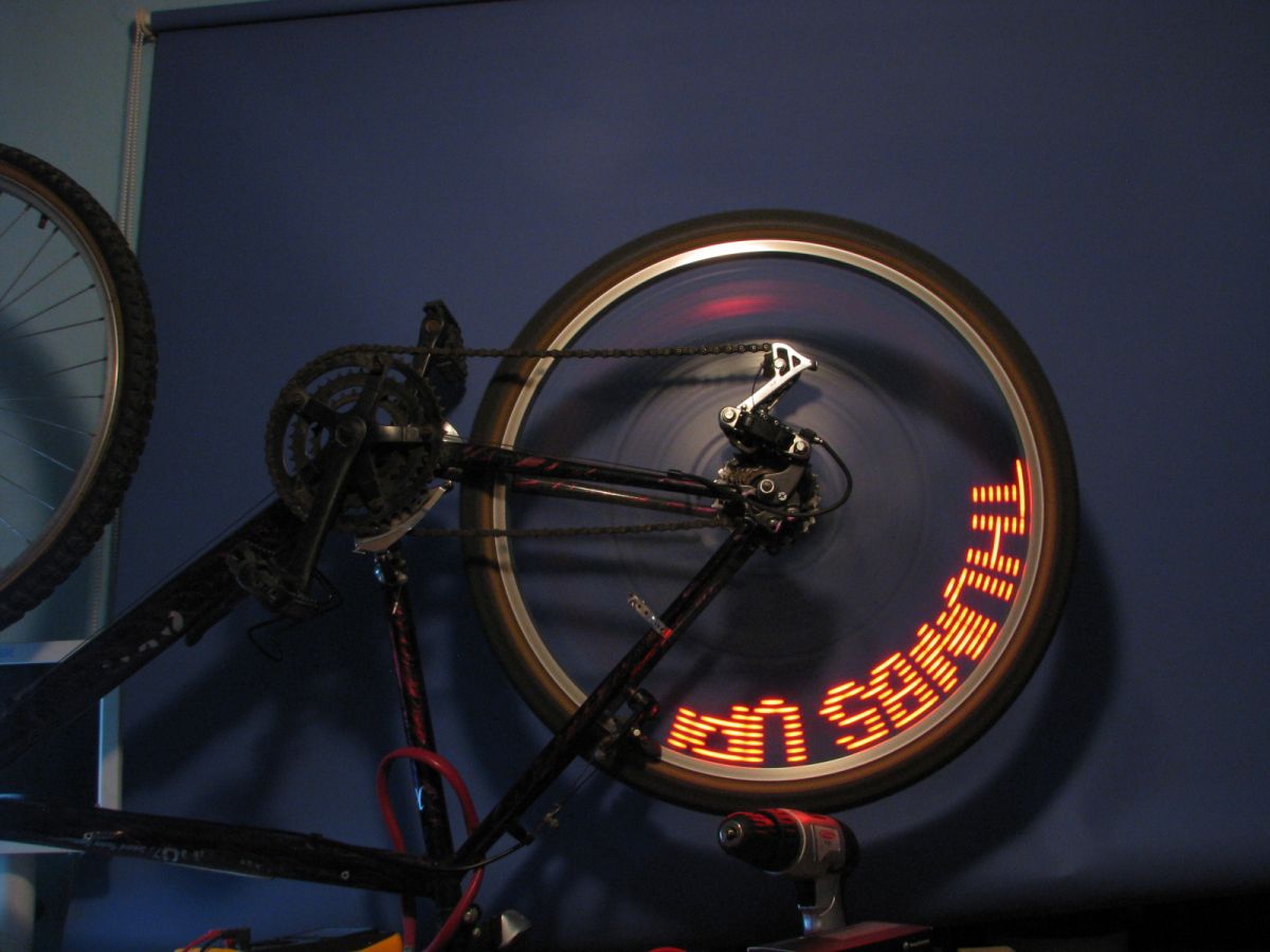

  • Hello Colleagues,
    I wanted to share an old project that I once made and was even commercially available for a while. The project is more than 15 years old so I am happy to share the materials. Maybe it will inspire someone or they will want to make such a device themselves. The code is 100% working and everything needed is in the zip.
    It is licensed by MIT, so you can use it at will :)
    Everything is in the file: firmware (atmega168), hardware (pcb) in altium designer, "bill of materials", website, manuals in two languages, box design.
    There are two versions of the device standard and compact. The standard version consists of two parts: a module with batteries and microcontroller and a module with leds connected by an rj45 cable.
    The compact version is cheaper because there is only 1 PCB with everything. It is a much slicker, improved version 2.
    If you decide to make one, I suggest the compact version.
    If anyone would need such specific RGB leds as in the project, sd card slots or buttons, I still have something in stock - please write on priv, I will give for what grace and shipping costs :)
    Good luck.

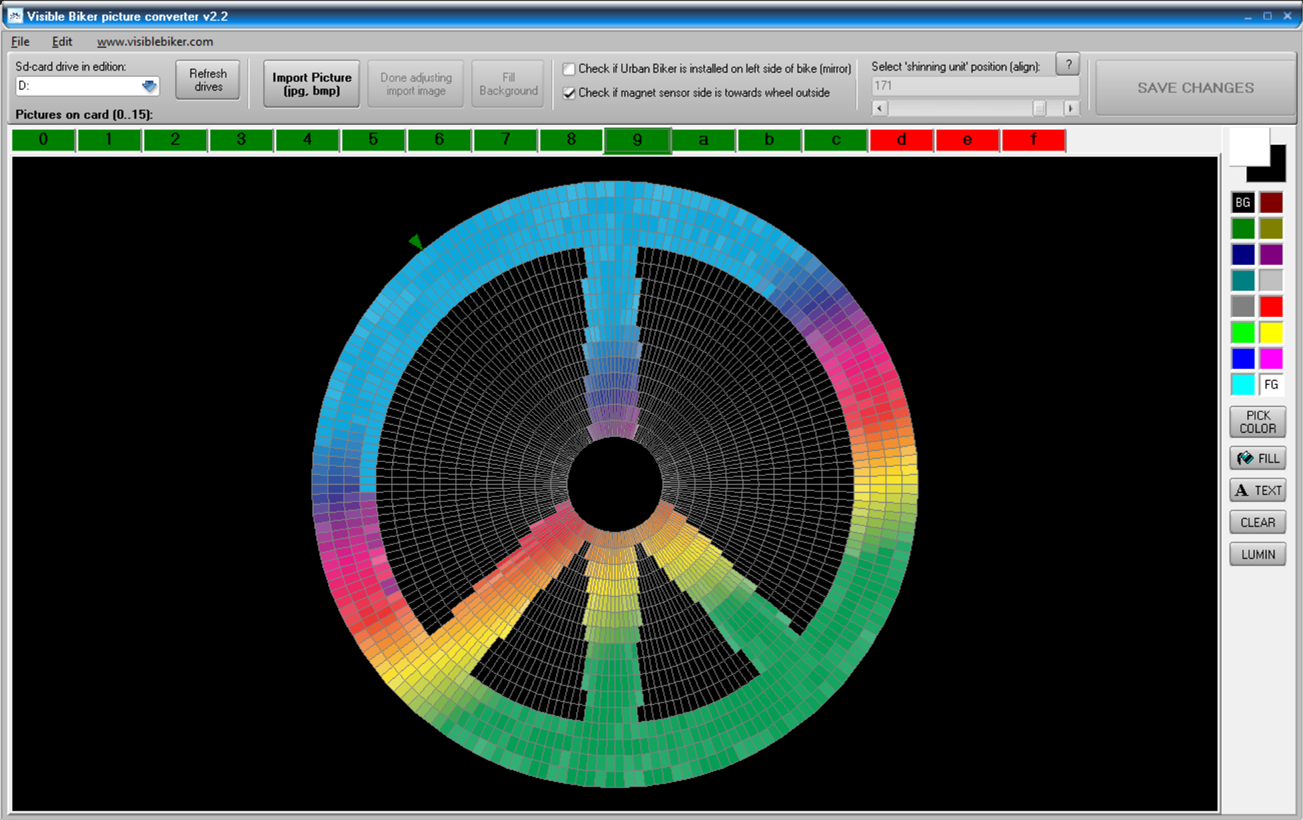

    I should also add that the package also includes a programme for importing images as graphics suitable for display on the device, which means that you can upload and create your own images. The source code is also included. To run this program, there must be a file named "urbanbiker" on some disk in the root directory - the program is designed so that the user has to insert a micro sd card into the computer and then the program detects it and automatically edits it. The micro sd card is detected just as I described above.
    The final version of the PCB is UBC_pcbv2-final.PcbDoc
    The file panelv2.PcbDoc- is the version to order 10 pcb's per panel.
