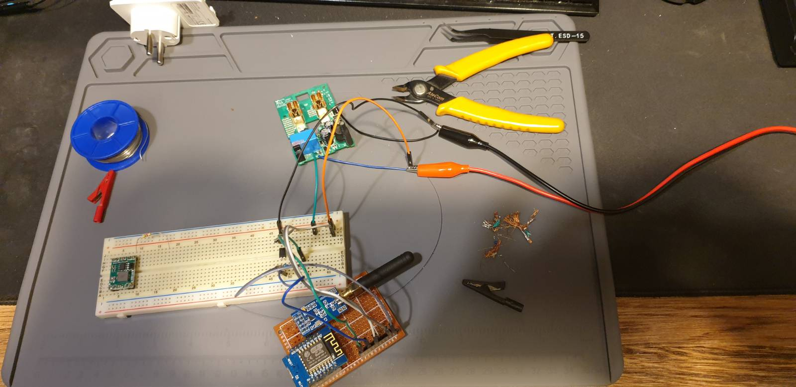

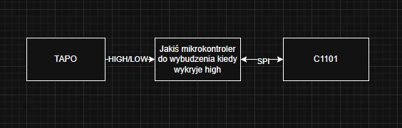

    I am carrying out a project to detect the relay status of a Tapo P100 and send information via an ESP8266 (Wemos D1 mini) with a CC1101 module.
    Connection description
    TAPO side:
    - 5 V - wires: orange / blue / red from the power supply
    - GND - three black wires (including power supply) 2 Cathode
    - Green - relay control signal (0-5 V)
    - The 0-5 V signal is applied to the optoisolator PC817 <-> 470 Ω <-> 1 Anode
    ESP8266 side (Wemos D1 mini - CC1101):
    - GND - common ground with power supply and common ground with PC817 (Grey 1, Grey 2) 2 Cathode / 3 Emitter
    - 3.3 V - pull-up for PC817 output (Green) <-> 10 kΩ <-> 4 Collector
    - 5 V - power supply for Wemos D1 mini (White)
    - PC817 output connected to GPIO of ESP8266 (Blue) 4 Collector <-> GPIO
    - CC1101 connected via SPI
    Problem
    If all the grounds are connected and I switch on the 5 V power supply:
    - ESP8266 does not respond to the signal,
    - the LED on the Wemos is clearly dimmed,
    - the circuit gives the impression of a short circuit or overload.
    On the other hand, if I disconnect the GND wire between the ESP8266 and the PC817 (Emitter 3) before turning on the power, then turn on the power and only then reconnect the ground to Emitter 3, the circuit works fine.
    What could be causing this circuit effect?
    I can provide a detailed schematic with component values if required.

    I have poor eyesight and I'm rather visual so the schematic may be helpful if not here then on priv but try the option also of undoing the collector of the right side of PCB17 before switching on the device to determine if the same effect? Because if same then its not likely to be an optoisolator but a conductor?

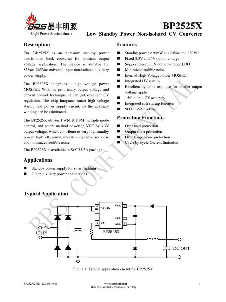

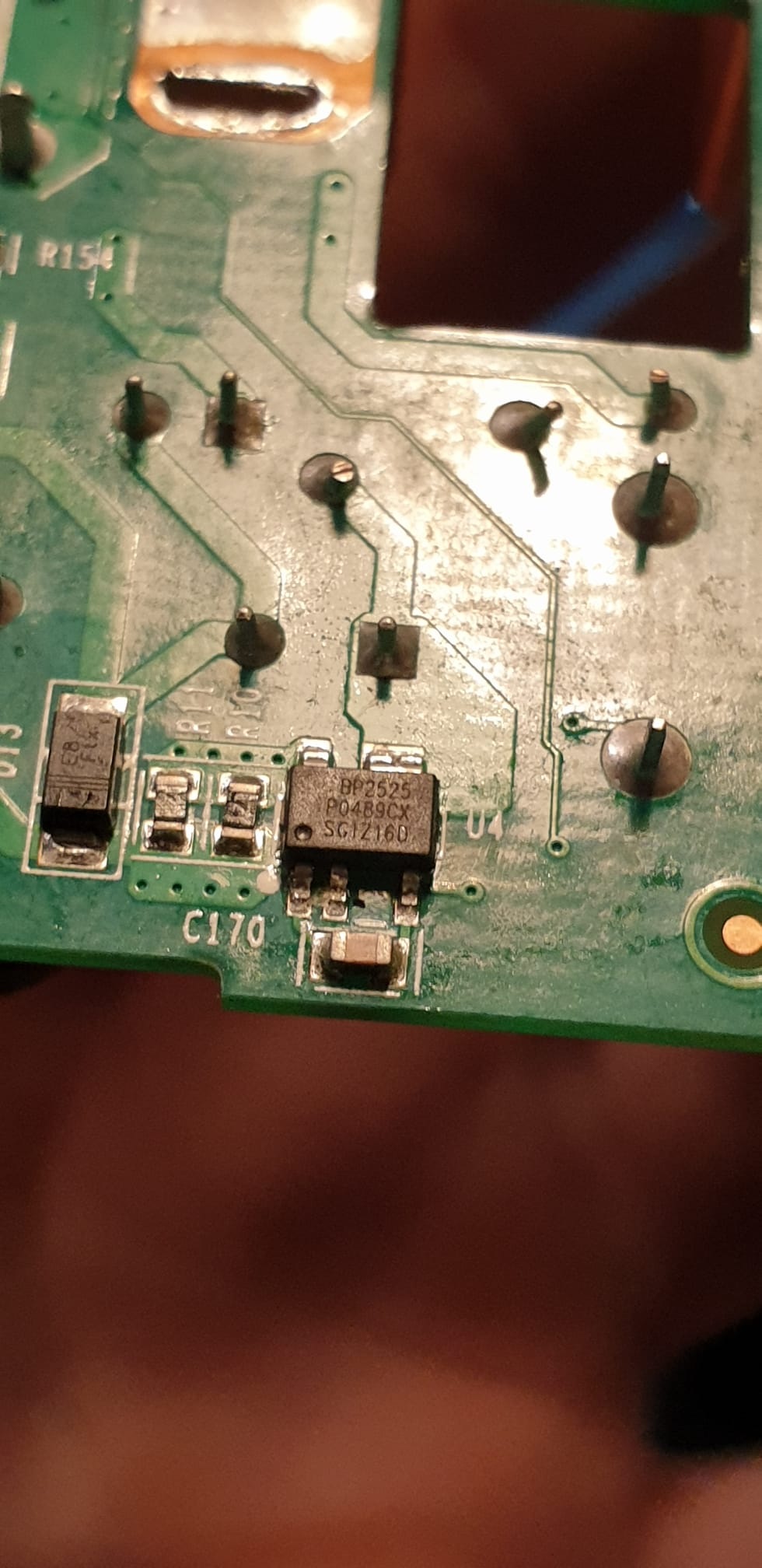

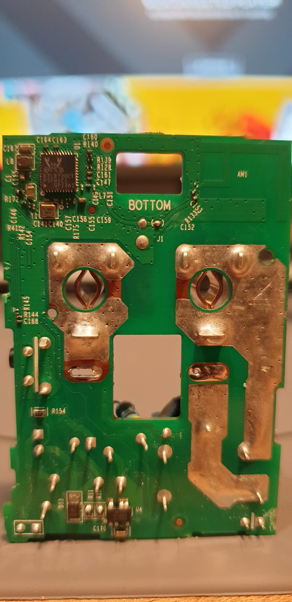

    I'm throwing in some photos that I think would be useful, maybe someone will need them one day.
    The Tapo P100 uses the RTL8720CF microcontroller, and is powered by the BP2525
    RELAY controlled by GPIO_8
    Bottom side of a green PCB labeled “BOTTOM,” with an IC and large soldered contact areas
    Close-up of a PCB showing a BP2525 IC, solder joints, and traces
    Datasheet page for BP2525X showing features, protection list, and a typical application circuit diagram
    In BP2525 SEL to ground, which sets 5 V to DC OUT
