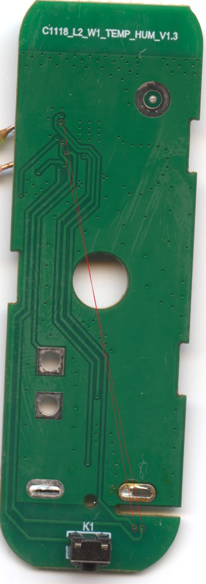

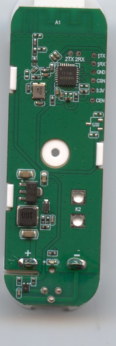

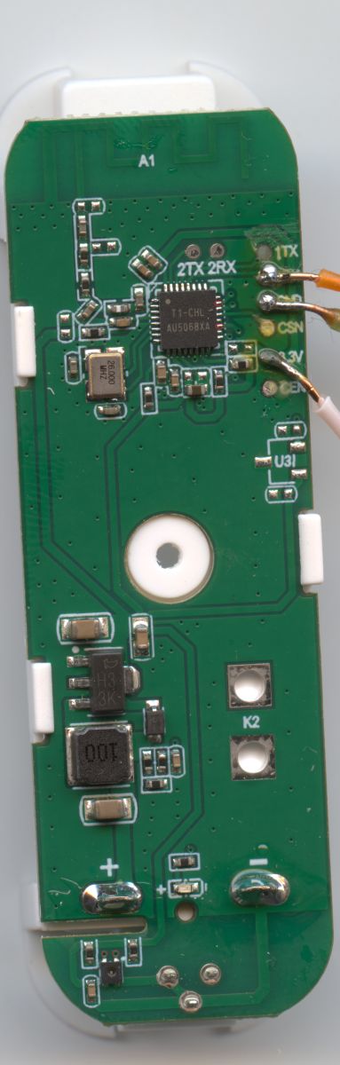

    Hello to all . First timer here . Got some Tuya/Smartlife Temp-Humidity sensors from Temu . Opened them and seem to be based on the BK7238 chip with the AU5068XA marking. Successfully backed original firmware that i attach , flashed OpenBK firmware (238T) , connected the device to the router and have access to the WebGUI . Can anyone guide me on how to troubleshoot the pins so that i can have the temp and humidity readings ?

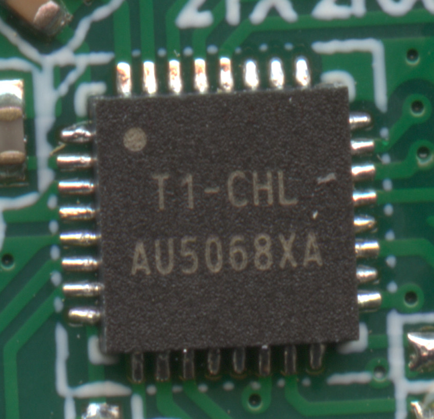

    Green PCB with AU5068XA chip and labeled pads 1TX, 1RX, GND, CSN, 3.3V, CENGreen PCB labeled “C1118_L2_W1_TEMP_HUM_V1.3” with K1 switch/button and mounting hole
    Macro photo of an IC on a PCB labeled “T1-CHL” and “AU5068XA”.Blurry close-up of a black SMD component with a central hole on a green PCB

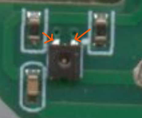

    Check pin continuity and trace unused pins
    #2 21835237
    Posts: 5217
    Help: 448
    Rate: 917
    do you have a multimeter to check continuity between two points?
    I'd perhaps suggest seeing where these two pins go
    Close-up of a green PCB section with a small black component and two orange arrows pointing at it.
    there's no mention of the pins in use in the boot log either

    >>21835237 Yes, of course I have a multimeter; will check and post tomorrow. I bought 4 of them that came in a single package, so I have spares to check with original firmware if needed.

  • Scanned PCB photos reveal AU5068XA pin traces
    #5 21835679
    leon22heart
    Posts: 72
    Rate: 7
    Added and back photo of the PCBs. The components and traces are so minuscule that are only shown by scanning the PCB on my scanner with 3200 dpi precision. It's difficult to use the multimeter to scan for traces without a microscope or at least a magnifying glass.
    I think I manually traced them in the photos I attach below. They seem to go straight to the pins of the AU5068XA chip.
    Green PCB with a central hole, traces, and the text “C1118_L2_W1_TEMP_HUM_V1.3”Green PCB with an IC and three wires soldered on the right side, shown in close-up
    and 2 better ones
    Temu Temp-Humidity Sensor (BK7238, AU5068XA) - Batch 25WSDJ01 /Model F-SL01WB PinoutTemu Temp-Humidity Sensor (BK7238, AU5068XA) - Batch 25WSDJ01 /Model F-SL01WB Pinout
    #6 21835877
    Posts: 14768
    Rate: 12909
    To which T1 pins?
    By the way, it seems the same PCB is used by the door sensors. U3 footprint looks like hall sensor.

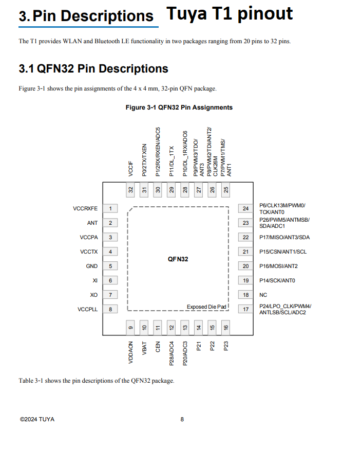

  • #7 21835888
    leon22heart
    Posts: 72
    Rate: 7
    >>21835877 As you say T1 pins, you mean physical ones like the ones in the BK7238 chip or something else? The physical ones are circled in red in the second batch of photos, which allowed me to upload the full picture in its resolution. The service that the forum recommends, unfortunately, downscales the image.
    #8 21835900
    Posts: 14768
    Rate: 12909
    Does this match your device?
    Documentation page “Tuya T1 pinout” showing a QFN32 pin assignment diagram
  • Need a guide to identify BK7238 sensor pins
    #9 21835932
    leon22heart
    Posts: 72
    Rate: 7
    >>21835900 Sorry, my friend, I don't know how to identify it. Is there a guide I can follow before answering back? The only things I identified are the button and WiFi LED through the OpenBK web app. I don't know how to proceed further. BTW, thanks for the help.
    PS1: If I understand the die schematic right and its position, then we should be talking about pins 23 and 19. But I don't know which sensor driver to use in order to get readings from those pins.
    PS2: Btw didn't overwrite bootloader on flash , just a note.
    Try sht3x driver on traced I2C pins

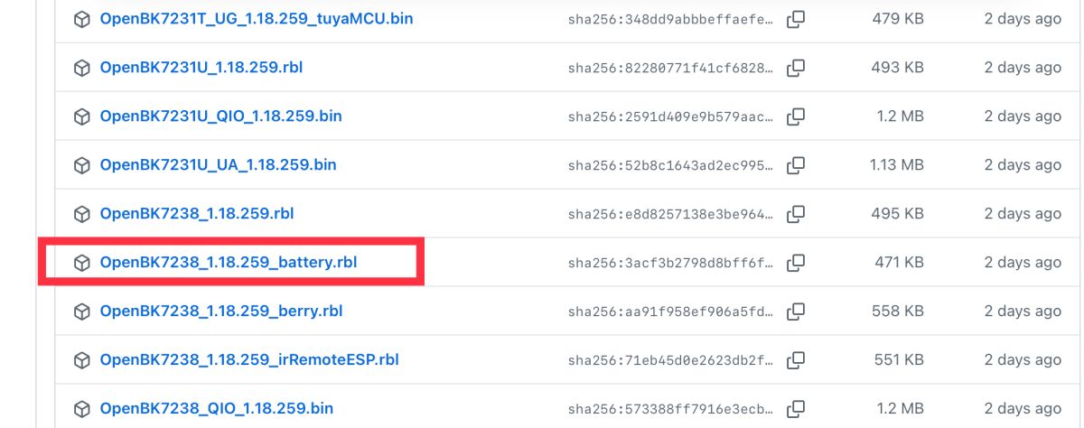

    #12 21836361
    max4elektroda
    Posts: 758
    Help: 49
    Rate: 189
    leon22heart wrote:
    Does anyone can compile a BK7238 OTA update with SHT3X enabled ? Reason being i banged the rx and tx traces on the pcb (extremely fragile) and now i have only OTA option . If not possible will open and mod another sensor for a full UART flash with the new firmware.
    No need for that. If you scroll down the page with the firmware images on github, under the table with the firmwares and their descriptions you'll find many links for even more firmware files.
    The "battery" one should include the driver, for OTA you need the .rbl file
    Screenshot of code with red boxes around “OBK_VARIANT…BATTERY” and “#define ENABLE_DRIVER_SHT3X”.
    Screenshot of a file list; a red box highlights “OpenBK7238_1.18.259_battery.rbl”.

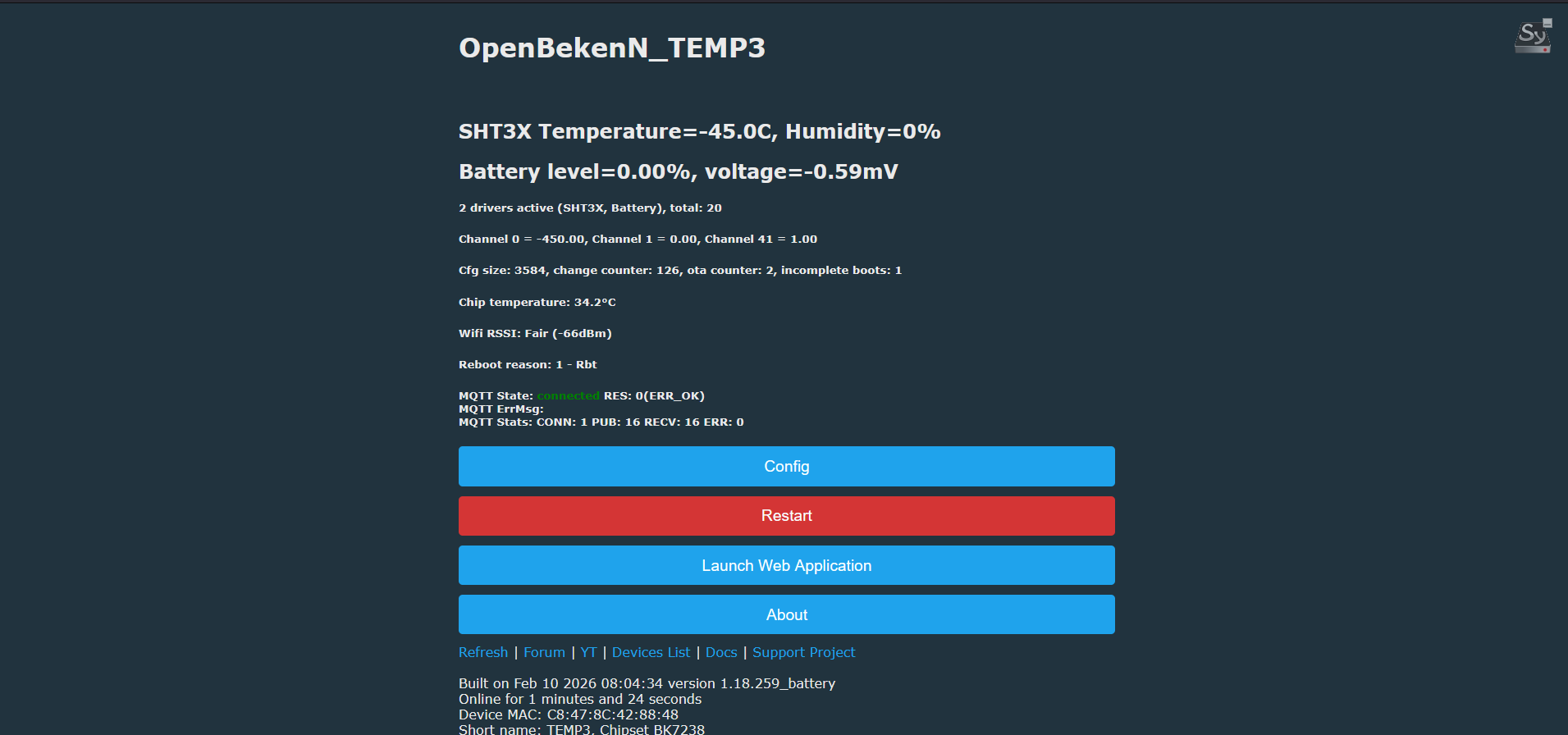

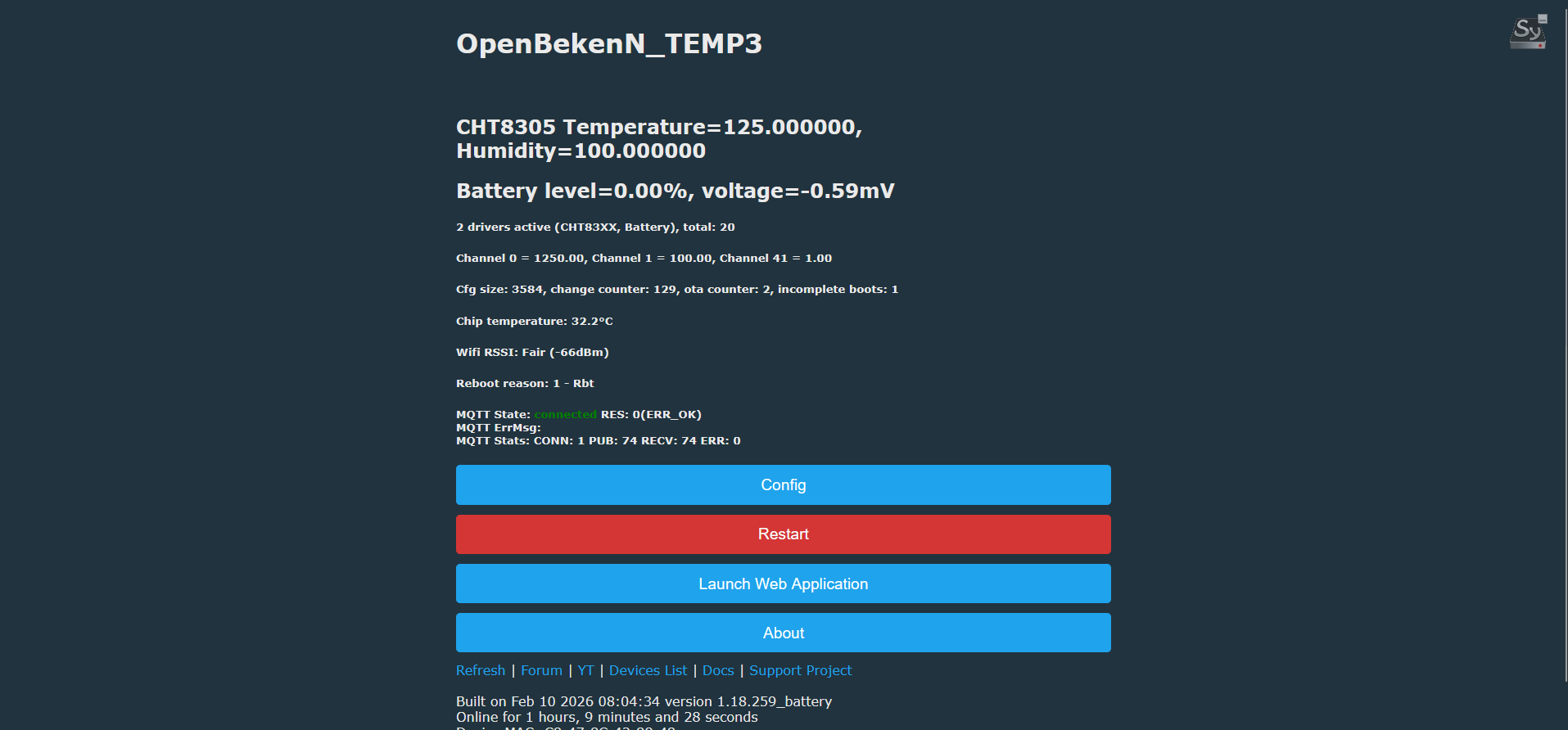

    >>21836361 Thank you for the suggestion . By flashing a battery firmware , the sensor is found but stuck at 0% humidity and -45C temperature . Any idea on how to troubleshoot it ? Also how should i go in order to find the BAT_ADC and BAT_Relay ? I assume that those also exist as in the generic BK7231 temp sensors .
    Also in the logs i got Info:SENSOR:DRV_CHT83XX_ReadEnv: Temperature:25.937500C Humidity:55.627441% but this doesn't show on the web interface. Same with battery Info:DRV:DRV_BATTERY : battery voltage : 3408.164062 and percentage 100.000000% . Powersave works off the bat .
    Also updated the template on the 1st post.
    Screenshot of OpenBekenN_TEMP3 showing SHT3X at −45.0°C and 0% humidity and battery level 0%
    and some logs
    That looks good, we simply used the wrong driver.
    So change the pins to CHT83XX_SDA and _SCK and use startdriver CHT83XX.
  • CHT83XX driver detects sensor as CHT8305
    #15 21836472
    leon22heart
    Posts: 72
    Rate: 7
    >>21836457 Ok. Changed the driver to CHT83XX as well as the pins, and now I have Info:SENSOR:DRV_CHT83XX_ReadEnv: Temperature:125.000000 °C Humidity:100.000000% in the logs and in the web interface. It recognizes it as CHT8305.
    Re-updated template at post 1.

    #16 21836619
    max4elektroda
    Posts: 758
    Help: 49
    Rate: 189
    That really looked better before ...
    Let's try to nail it down.
    SDA and SCK are the same for CHT83XX like the "working" assignment with softI2C and SHT3X?
    On the first test (with SHT3X) did you start the CHT83XX driver, before you got the entries like
    If you remove the CHT83XX_SDA and CHT83XX_SCK pin config (by selecting "empty" selection) and then stop and start the driver ("backlog stopdriver CHT83XX; startdriver CHT83XX").
    Do you get some "valid" readings with the default pins from the driver?
       g_softI2C.pin_clk = 9;
       g_softI2C.pin_data = 14;
       g_softI2C.pin_clk = PIN_FindPinIndexForRole(IOR_CHT83XX_CLK, g_softI2C.pin_clk);
       g_softI2C.pin_data = PIN_FindPinIndexForRole(IOR_CHT83XX_DAT, g_softI2C.pin_data);
    If not, next test would be: define pins as SHT3X_ again and restart driver. Any change?
    If not, what if you start SHT3X driver and after that restart CHT83XX driver?
    It's a bit poking around, I know.

    #19 21836877
    leon22heart
    Posts: 72
    Rate: 7
    Yes they are the same .
    I cant confirm this but i believe no . Its possible during a reboot to have changed the pins temporarily from SHT3X_ to CHT83XX_ and saved them . I have yet to replicate the scenario where i got the right readings with a wrong driver.
    Working on the other scenarios .
    If i clear the pins to default , stop and restart yhe driver i have
    Info:SENSOR:DRV_CHT83XX_ReadEnv: Temperature:125.000000C Humidity:100.000000%
    Info:MAIN:Time 628, idle 166246/s, free 119344, MQTT 1(1), bWifi 1, secondsWithNoPing 555, socks 2/24 POWERSAVE
    Info:MAIN:Drv CHT83XX stopped.
    Info:CMD:[WebApp Cmd 'backlog stopDriver CHT83XX' Result] OK
    Info:MAIN:Time 629, idle 155006/s, free 119344, MQTT 1(1), bWifi 1, secondsWithNoPing 556, socks 2/24 POWERSAVE
    Info:MAIN:Time 630, idle 165967/s, free 119344, MQTT 1(1), bWifi 1, secondsWithNoPing 557, socks 2/24 POWERSAVE

    Info:MAIN:Time 641, idle 162091/s, free 119344, MQTT 1(1), bWifi 1, secondsWithNoPing 568, socks 2/24 POWERSAVE
    Info:SENSOR:DRV_CHT83XX_Init: ID: FF FF FFFF
    Info:MAIN:Started CHT83XX.
    Info:CMD:[WebApp Cmd ' startDriver CHT83XX' Result] OK
    Info:GEN:No change in channel 0 (still set to 1250) - ignoring
    Info:GEN:CHANNEL_Set channel 0 has changed to 100 (flags 0)
    if i set the pins back to SHT3X and then load - unload -load the SHT3X driver i have the
    if i set the pins back to SHT3X and then load - unload -load the SHT3X driver , then load - unload -load the CHT83XX driver i have the
    Info:MQTT:Channel has changed! Publishing 100 to channel 0
    Info:MQTT:MQTT client in mqtt_incoming_publish_cb topic TEMP3/0/get
    Info:MQTT:Publishing val 100 to TEMP3/0/get retain=0
    Info:MAIN:Time 350, idle 182847/s, free 117320, MQTT 1(1), bWifi 1, secondsWithNoPing 283, socks 2/24 POWERSAVE
    Info:GEN:dhcp=0 ip=192.168.1.66 gate=192.168.1.1 mask=255.255.255.0 mac=c8:47:8c:42:88:48
    Info:GEN:sta:rssi=-66,ssid=LOLIDAS24TP_IOT,bssid=9c:05:d6:ba:e3:ee,channel=11,cipher_type:CCMP
    Info:GEN:CHANNEL_Set channel 0 has changed to 1250 (flags 0)
    Info:MQTT:Channel has changed! Publishing 1250 to channel 0
    Info:MQTT:Publishing val 1250 to TEMP3/0/get retain=0
    Info:MAIN:Time 351, idle 143518/s, free 117424, MQTT 1(1), bWifi 1, secondsWithNoPing 284, socks 2/24 POWERSAVE
    Added after 6 [hours] 14 [minutes]:
    I cant seem to replicate the correct readings under the wrong driver. Was it a fluke or the order affected something ? Is it possible to extract more data from tuya IOT about the chip and its behavior ? From my second , third or fourth device .

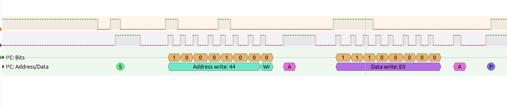

    It might be even simpler some issue with BK7238 and SHT3x:
    I flashed your dump to my BK7238 and attached a logic analyzer to the SDA SCL pins.
    It searched for address 0x44 and 0x22, later sending "0xE0" to 0x44 (see below):
    Logic analyzer screenshot: I2C write to address 0x44 with data 0xE0, including ACKs and STOP.
    So I would assume, SHT3x is correct, but I didn't get the complete communication (even when attaching a SHT31 sensor).
    Next I tried to run my SHT31 with OpenBK7238 and didn't succeed.
    Maybe my SHT is broken?!? AHT2X works.
    If you start (as in the beginning) SHT3x driver, will you get a reasonable status or only FF ?
    If we don't succeed, I can only think of capturing the communication on I2C with the sensor on an unmodified device.
    But this would mean you'd need e.g. a logic analyzer to do so..

    So a quick recap: identified the sensor traces by inspecting the PCB scans (traces too small for multimeter). According to the QNF32 schematics the pins are the P17 and P24. By setting softSDA the P14 and softSCK the P24 I find a sensor with ID 0x44. This is usually CHT80XXX based. If I input the image of the sensor to Gemini I get
    Gemini said
    Based on the visual markings in your image, the sensor is an SHT3x series (likely an SHT30 or SHT31) digital temperature and humidity sensor.
    The marking "5507" on the left side of the chip is a production or batch code, while the "GV4" marking is the characteristic identification for the SHT3x line.
    So by either using the SHT3 driver with the appropriate pins or the CHT80XXX driver with the right pins I get either Temperature: 125.000000°C Humidity: 100.000000% or Info:SENSOR:SHT3X_Measure: Temperature: -45.0°C Humidity: 0%.
    I don't get it.
