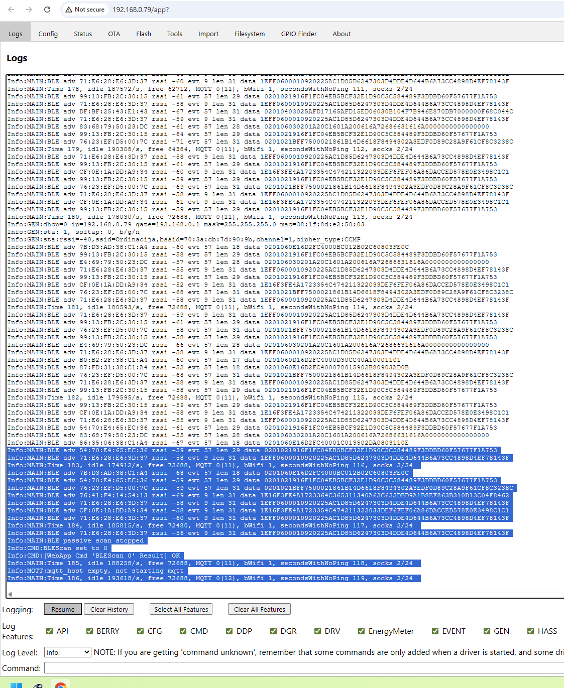

    >>21850071 This looks really promising, but I am not sure what I am looking at. Am I right to assume that I can build this from the https://github.com/NonPIayerCharacter/OpenBK7231T_App fork? Do I need to specify BK7231N_ALT target? For some reason, none of us here can get the build system to work (I guess it is heavily Windows-biased, which none of us has access to here), so we have to remove most of the scripts first to get to the Makefile, which is why I am asking. Also, any chance this would work on the BK7231T version, since this is what we have for the students to play with? Anyway, thanks, looks great!

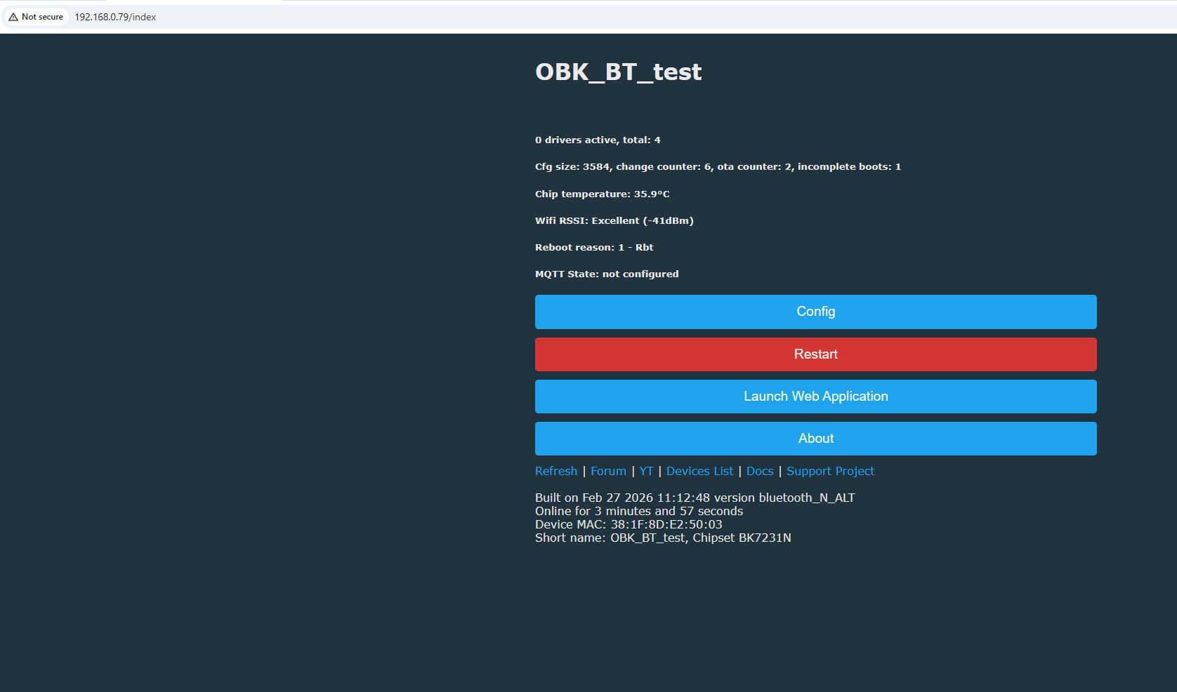

    follow that thread I mentioned before, I got a local build system via docker ready that needs to be tested on Linux so you can build it quickly. BT is coexisting and some heavy development and testing is on the way but for now the initial goal is achieved - BT is running on N ( and I think T as well + other platforms as that is the goal of this project ) it works, coexists and with more improvements to follow. Feel free to give feedback and ask questions as this is a huge milestone for our project but we may use it is a different way than you intended it so feel free to engage and we will get it done.

    What exactly is the problem with building?
    It's Linux only, the only things that are needed to build ALT are make and gcc (best is system arm-none-eabi gcc from ubuntu 22.04 (10.3))
    cd to cloned app repo and just type "make OpenBK7231N_ALT VARIANT=btproxy"
    Only scan is implemented, no active connections.
    Caught advertisements are then passed to Home Assistant via ESPHome API.
    Extended advertisements are not supported, as is LE Coded.
    BK7231T is not supported (it doesn't support ble 5.x library), only N and 7238. At least for now.

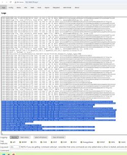

    >>21853774 Thanks for the tip, we will try this. We were using the shell commands from the root of the repo and they do not seem to work well (I guess bash vs zsh vs sh syntax comes into play), so every time we build we just strip the rest and leave the SDK and the main Makefile and build it this way. I am not sure why such a straightforward project has such a convoluted build system (on the other hand I appreciate the difficulty of supporting a dozen different platforms). Just a clarification: by the app repo, do you mean the platforms/OpenBK7231N directory? There are so many Makefiles floating around between the root and that, I am not sure where the target is. I can always grep for it, I guess...
    On the Bluetooth side, we do have the BLE running on T (actually, on N as well but I have not posted it yet), a sample project was posted in this forum. Primitive as it is, it does support advertisements as well as encrypted connections (all you need for the latter is to activate the SM); what we were lacking was the coexistence with WiFi. I am still not sure from looking at your code how it was done. There must be several parameters set up for it to work smoothly (like the delay for the radio reset). Is it all taken care of by the SDK? There is an rf_coex_.. struct somewhere, but all it does is set the policies, no relax times or anything. It must somehow interact with the scan window/interval settings (CEVA manuals for their stack mention some formulas), but where is it done?
    Also, you managed to set up active scanning as well. Did you check that it actually sends out scan requests and gets stuff back? There must be a callback that does this upon receiving the advertisement. Is it also done by the SDK code? I did not find it in your code, but I might have missed something. We always wrote the callback by hand (this is all active scanning is, really, just asking when you feel like it :)). We do have a bunch of eager students to write code though... :) Someone currently is working on the HID (over GATT for now) profile, I will tell her you got the coex working, see if she can make a 'wifi keyboard' this way.
    Great work!

    No, i meant main app directory (OpenBK7231T_App)
    N and T default SDK are from Tuya, and use their makefile. I have problems with it as well on WSL1.
    OpenBK723xx_ALT builds fine, but like i said requires specific gcc.
    Callback is registered via ble_set_notice_cb
    Active scanning works fine, i get BTHome sensor name if it's enabled. Don't know if LE Coded works, it's disabled in SDK and i don't have any device that uses it. Also don't know if extended advertising works.
    Coex is achieved via window/interval settings, but it can miss some advertisements that way.
    RTL8720C/RTL8720D don't miss advs, they can work when scan window=interval
    Pls be aware that i almost know nothing about bluetooth. This is the first time i've done anything with it.

    >>21855295
    Yes, hal_bt_proxy_bk7231.c is the correct file.
    hal_bt_gap_callback only processes advertisements, scan must be launched manually with BTStartScan command in OBK, which calls HAL_BTProxy_StartScan. Then scan will just continue until stopped.
    I don't think it's in my favor when i want to do more than just receive advertisements.
    I tried to implement active connections on RTL8720D, but it's a callback hell there. I barely understand what most functions there do.
    To enable scan on LE Coded channels, GAPM_SCAN_PROP_PHY_CODED_BIT must be added here:
    https://github.com/NonPIayerCharacter/beken_f...er/ble/ble_5_1/ble_pub/app/src/app_ble.c#L696
    And GAPM_SCAN_PROP_ACTIVE_CODED_BIT for active scan.
    T doesn't support coded because it doesn't support 5.0.
  • Manual BTStartScan needed for OpenBK BLE scanning
