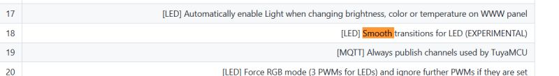

    I am trying to configure smooth dimming / fading effects on my OpenBeken-flashed LED controller, but I cannot get any transition behavior to work.
    Device information:
    Chipset: BK7231N
    Firmware: Built on Feb 13 2026 – Version 1.18.261
    LED driver: SM2135 (confirmed active in web UI)
    5-channel RGBCW controller
    The device is correctly detected and running in Light mode.
    The web UI shows:
    Brightness slider
    RGB color control
    Temperature slider
    “1 drivers active (SM2135) total 32"
    So the light driver itself appears to be working correctly.
    What I am trying to achieve
    would like behavior similar to Tasmota, where I can enable smooth fading directly in the firmware:
    Fade 1
    Speed 50
    This causes the device to interpolate brightness changes internally (device-side), independent of Home Assistant.
    Tasmota-Docs: Fade
    What I tested:
    led_lerpSpeed 85
    I cannot find any documented commands like:
    fade
    transition
    smooth or
    setChannelTransitionTime
    OpenBK7231T_App-Docs
    I am looking for:
    Device-side brightness interpolation
    Device-side color interpolation
    Smooth transitions directly in the driver
    Essentially the equivalent of Tasmota’s Fade Speed, but for OpenBeken.
    Is smooth dimming / fading currently supported for:
    BK7231N
    SM2135 driver
    Firmware 1.18.261
    If yes:
    What is the correct command?
    Is additional configuration required?
    Is led_lerpSpeed supposed to handle this?
    If not:
    Is this feature planned?
    thank you very much!
