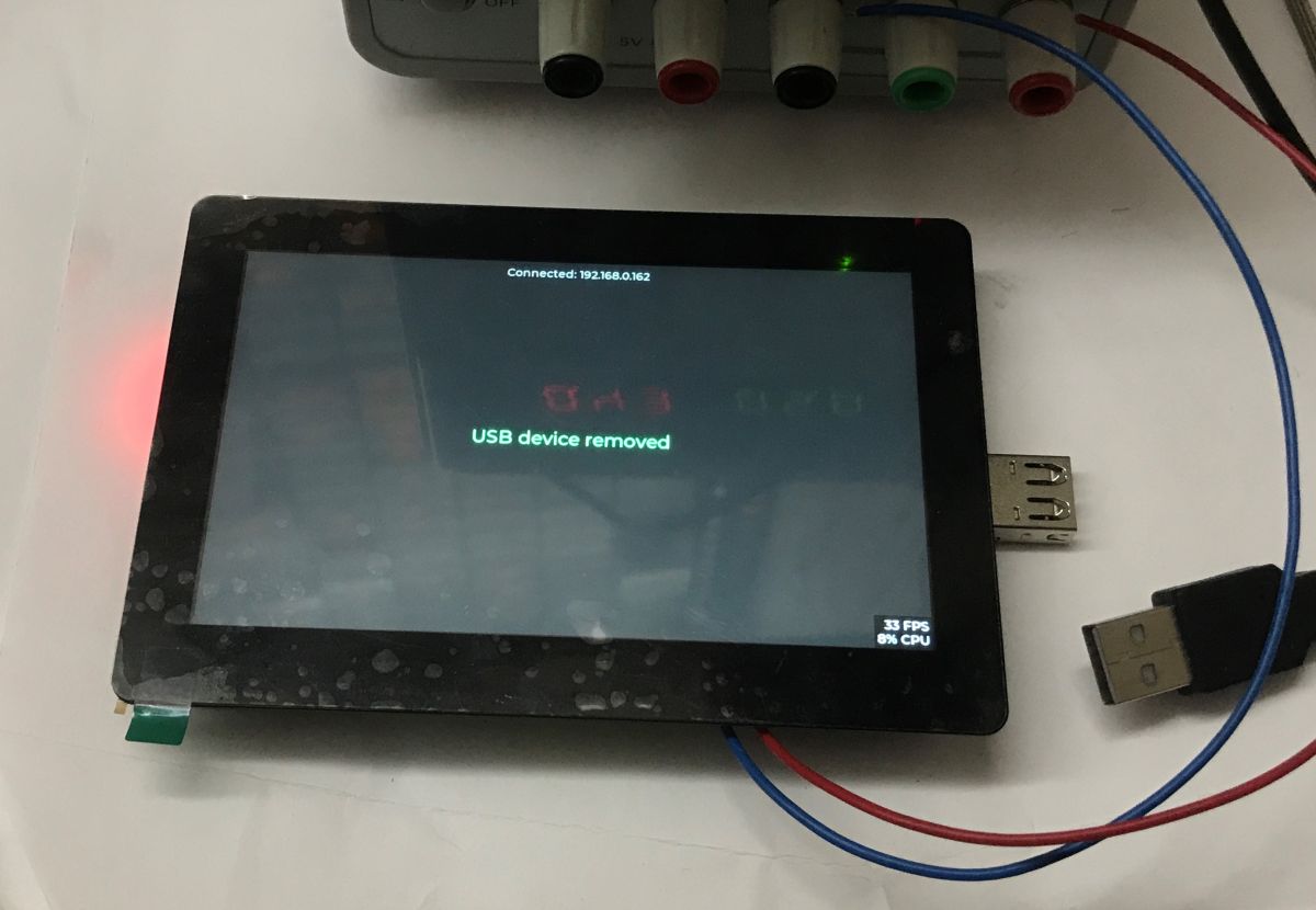

    Step 3: Detect USB device
    We now start USB Host mode on the ESP32-S3 and check that any device has actually been connected to the USB port. This is an absolute must - before we can start thinking about HID keyboards, reports and key mapping to LVGL, we need to be sure that:
    - the USB Host stack is working correctly
    - the device passes enumeration
    - we can read its descriptors

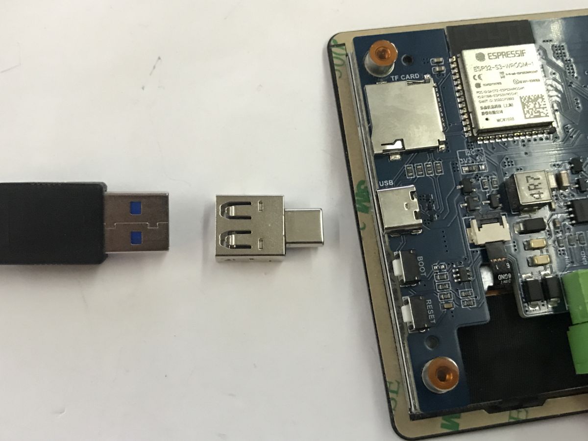

    Our board already has a USB connector, but here's a note - don't confuse this with boards where a USB to UART converter is brought out on the USB. Here we care about hardware USB, no CH340 will go here.
    Additionally, as the board has a female USB C connector, a male USB C to USB A female adapter is useful:
    ESP32-S3 board with USB-C port next to a USB-A to USB-C adapter and a USB-A plug
    The ESP32-S3 has a hardware USB OTG controller, so we don't need any external chips - we just need to correctly configure the USB Host library from ESP-IDF, which is also available in the Arduino environment.
    Code: C / C++
    We add the header and then:
    - start the USB Host library (usb_host_install())
    - register the USB client (usb_host_client_register())
    -set callback usb_host_client_event_cb, which will inform us when the client device is connected and lost

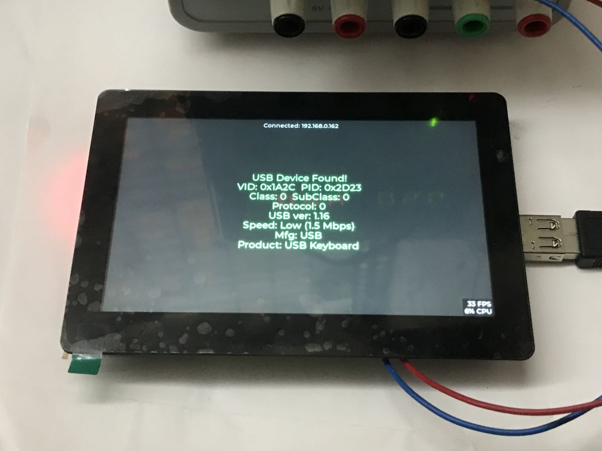

    With the usb_read_device_info function we create a description of the device shown on the screen.
    Code: C / C++
    In addition we call everything in init:
    Code: C / C++
    and we process the USB events in the main loop (usb_host_poll):
    Code: C / C++
    Touchscreen showing “USB Device Found!” and “Product: USB Keyboard,” with a USB-A plug connected on the right
    Touchscreen board displays “USB device removed” and an IP address; a USB plug lies beside it

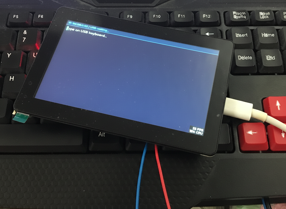

    Step 4: Basic keyboard events
    Two additional mechanisms are now required:
    - key capture from a USB keyboard
    - lVGL text field support
    As it happens, LVGL has a ready-made text field mechanism along with full-fledged editing. Even the cursor works there. All you need to do is register the driver via the lv_indev_drv_t structure and set it to type LV_INDEV_TYPE_KEYPAD. In addition, we set a function that will read the key events from the circular buffer, here kb_indev_read_cb.
    Code: C / C++
    Well, yes, but we don't have any queue - you will have to implement one yourself. Below for now is a callback that uses my kb_ring_pop function and my circular buffer (condition kb_ring_head != kb_ring_tail) to read the keys.
    Code: C / C++
    Here is a proper implementation of the circular buffer - events are inserted after the 'head' of the buffer, and its 'tail' points to the last unprocessed event. The buffer has a finite size, if it overflows it does not add more events.
    Code: C / C++

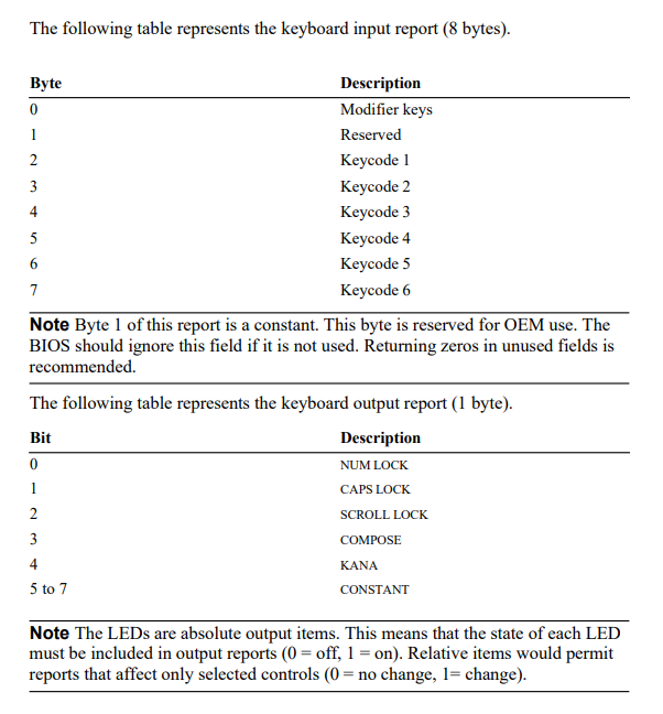

    What's left is to receive events from the keyboard. Just how do we know how to parse HID packets? This can be read in the documentation:
    https://usb.org/sites/default/files/hid1_11.pdf
    HID documentation table showing keyboard input report (8 bytes) and LED output report (1 byte)
    The keyboard reports the set of keys pressed at a given time. We can then independently determine the state of which keys have changed, i.e. which have been released and which have been pressed.
    Code: C / C++

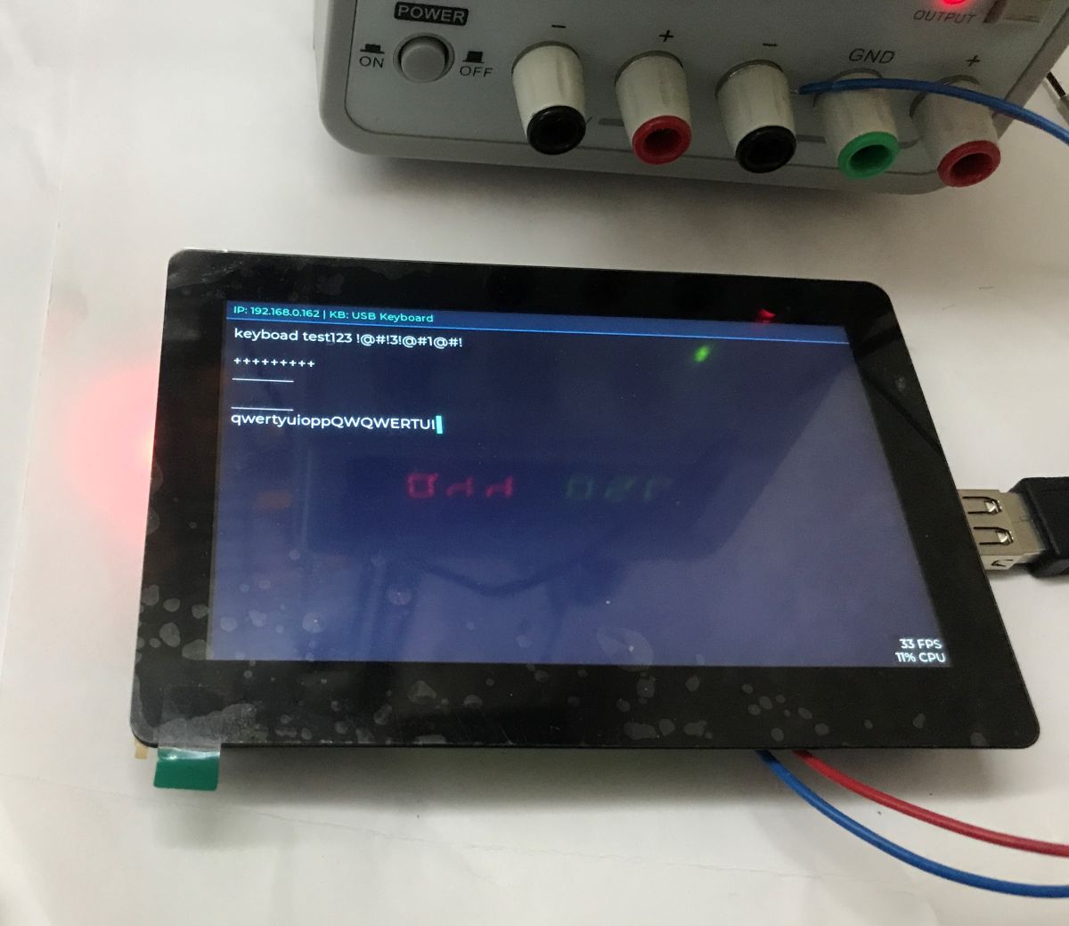

    Result:
    Touchscreen with black bezel shows typed text from a USB keyboard and IP 192.168.0.162.
    The keyboard is seen correctly. Letters, numbers and special characters work. You can make capital letters, although caps lock natively does not work. Arrows work, you can move the cursor, you can delete characters with the delete and backspace keys,

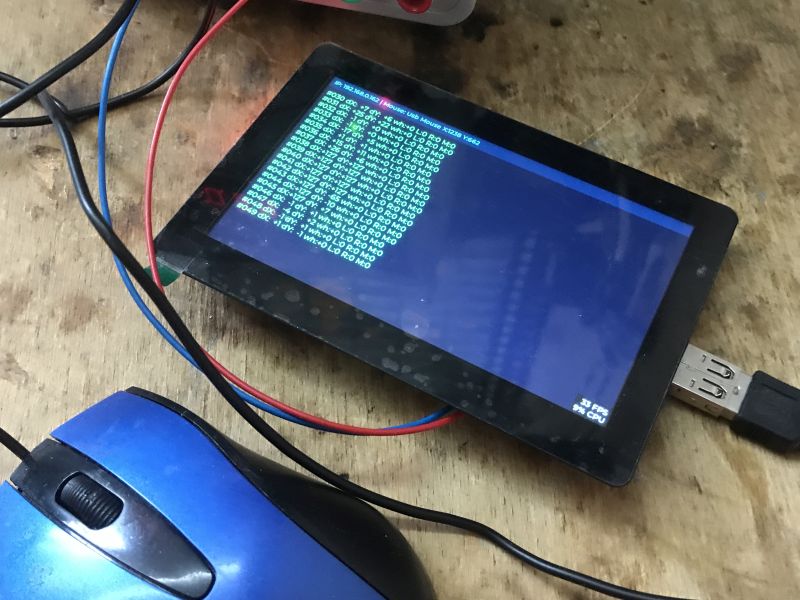

    Additional: mouse experiment
    Analogously, an HID-compatible mouse can be handled. Again, we need to refer to the HID documentation and add our own parsing of the package in hid_transfer_cb.
    https://learn.microsoft.com/en-us/windows-har...ers/hid/keyboard-and-mouse-hid-client-drivers
    D5 D0 0 2 X6 X2 X data byte Z5 Z0
    Byte D7 D6 D5 D4 D3 D3 D2 D1 D0 Comment
    1 0 0 Ysign Xsign 1 M R L X/Y signs and R/L/M buttons
    2 X7 X6 X5 X4 X4 X3 X2 X1 X0 X data byte
    3 3 Y7 Y6 Y5 Y4 Y3 Y2 Y1 Y1 Y0 Y data bytes
    4 Z7 Z6 Z5 Z4 Z3 Z3 Z2 Z1 Z0 Z/wheel data byte
    [/table:1cd0b14a05]
    The data used in this way can then be displayed on the screen, as an example I have added a display of the individual reports received. It is worth noting that we do not have information from the mouse about the "absolute" position of the cursor, we only have its offset.
    Code: C / C++
    The above code correctly decodes the reports from the mouse and reads from them the offset in the X, Y and Z (circle) axes. The state of the buttons (pressed or not) is also read.
