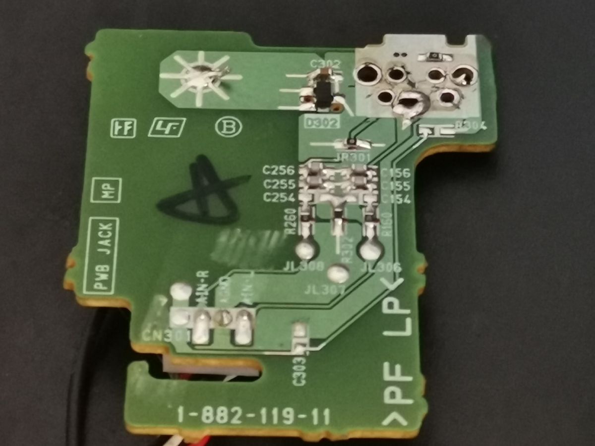

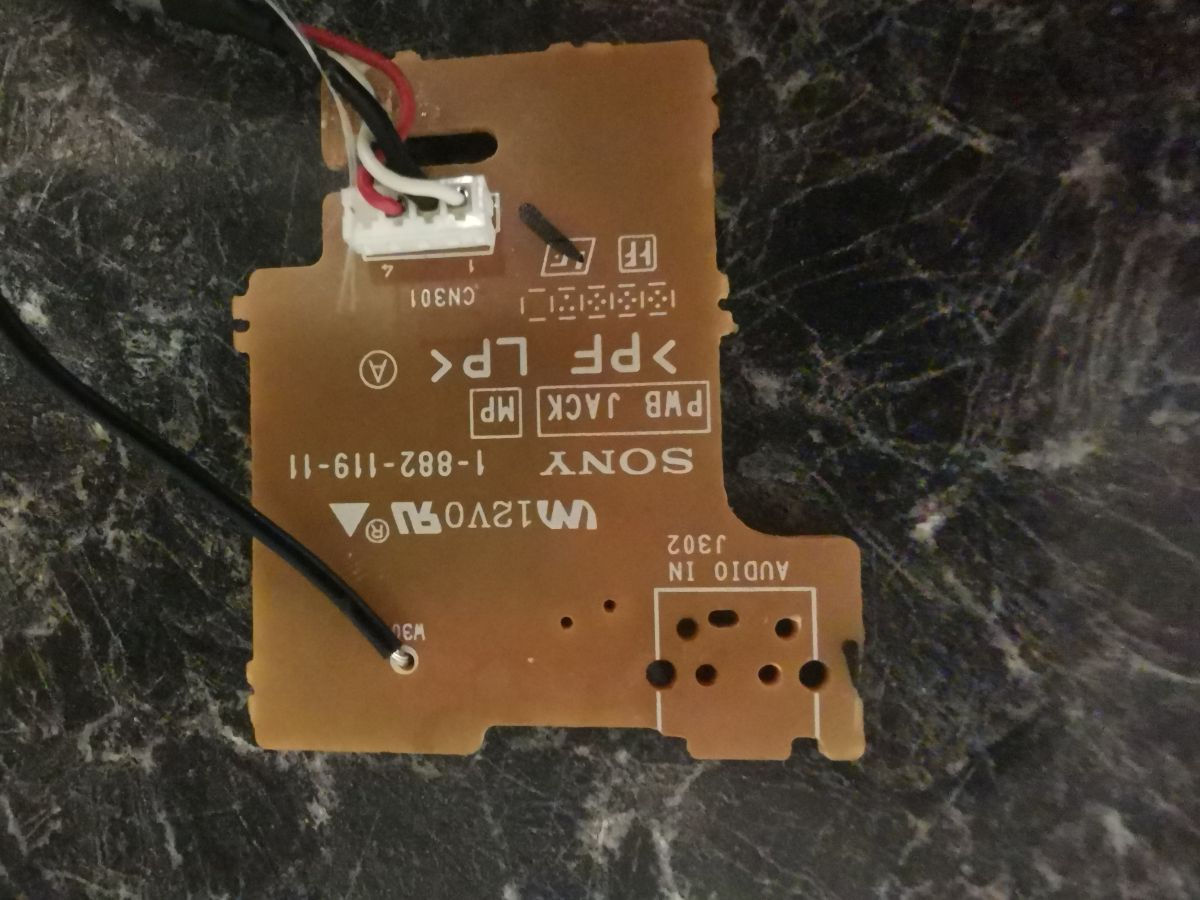

    Sony PCB with white CN301 connector and wires; mounting holes and printed labels are visible
    Green PCB labeled “PWB JACK” with jack socket solder pads and “PF LP” marking

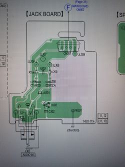

    “JACK BOARD” layout diagram showing PCB traces, connector CN301, and AUDIO IN jack J302

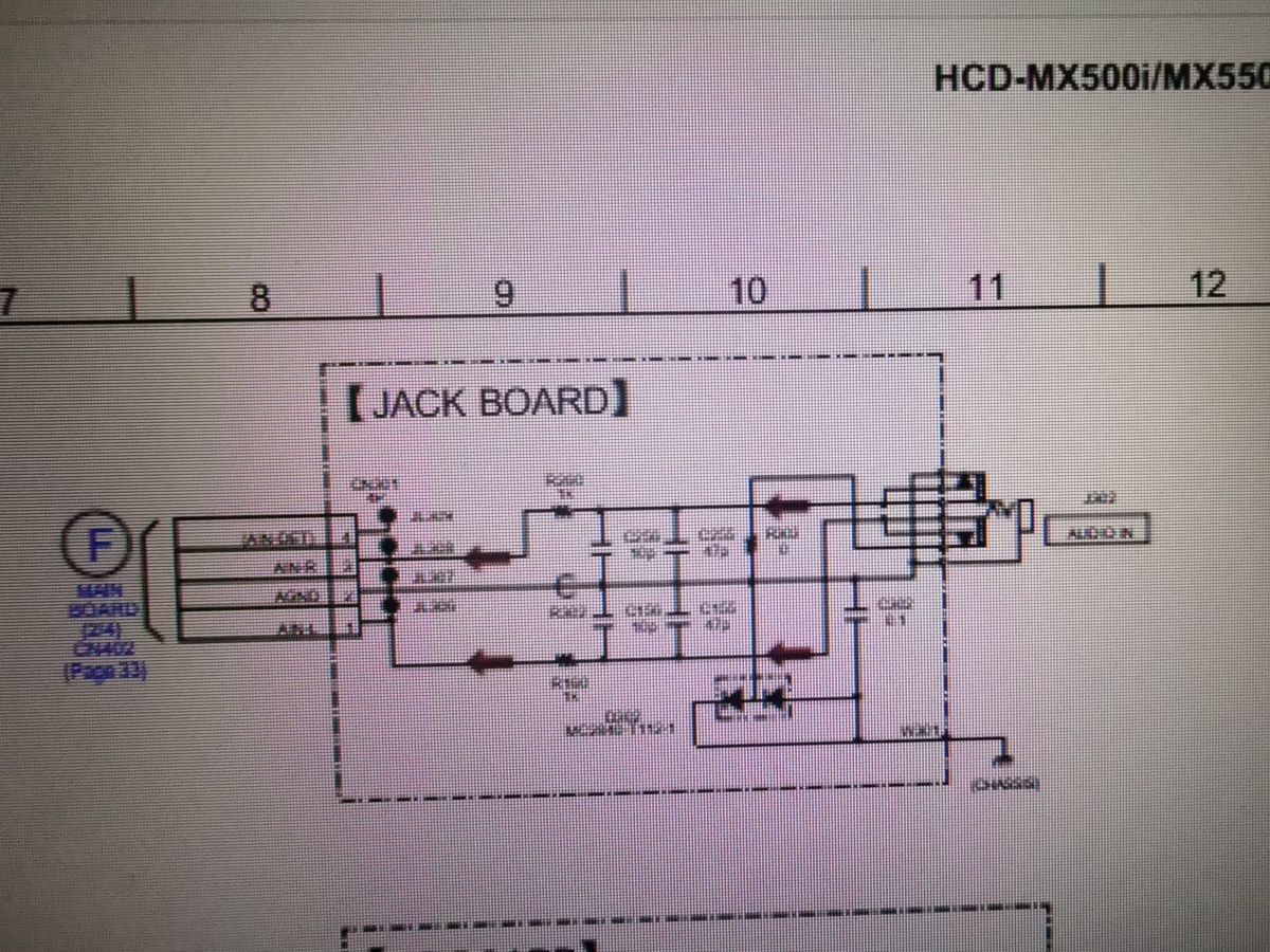

    “JACK BOARD” schematic with audio signal lines and a 7-pin connector symbol on the right
    AI: Can you share some context about the circuit board, such as what device it is from or any markings or labels that might help with identification?
    Looking for replacement socket jack in as it's broken and got 7 pins out PCB mounting (whatever I look at on the internet looks different) @ElektrodaBot

    krzysztofkawka66 wrote:
    Initial assessment of your photos and notes
    - Your board is clearly marked “SONY – PWB JACK – 1-882-119-11” and “AUDIO IN J302.” That matches the HCD‑MX500i/MX550i Hi‑Fi “JACK BOARD” used in the CMT‑MX500i micro system. The service manual shows the same board outline, the 4‑pin harness CN301, and labels AIN‑L, AGND, AIN‑R, and AIN‑DET leading from the audio jack to the main unit. (manualmachine.com)

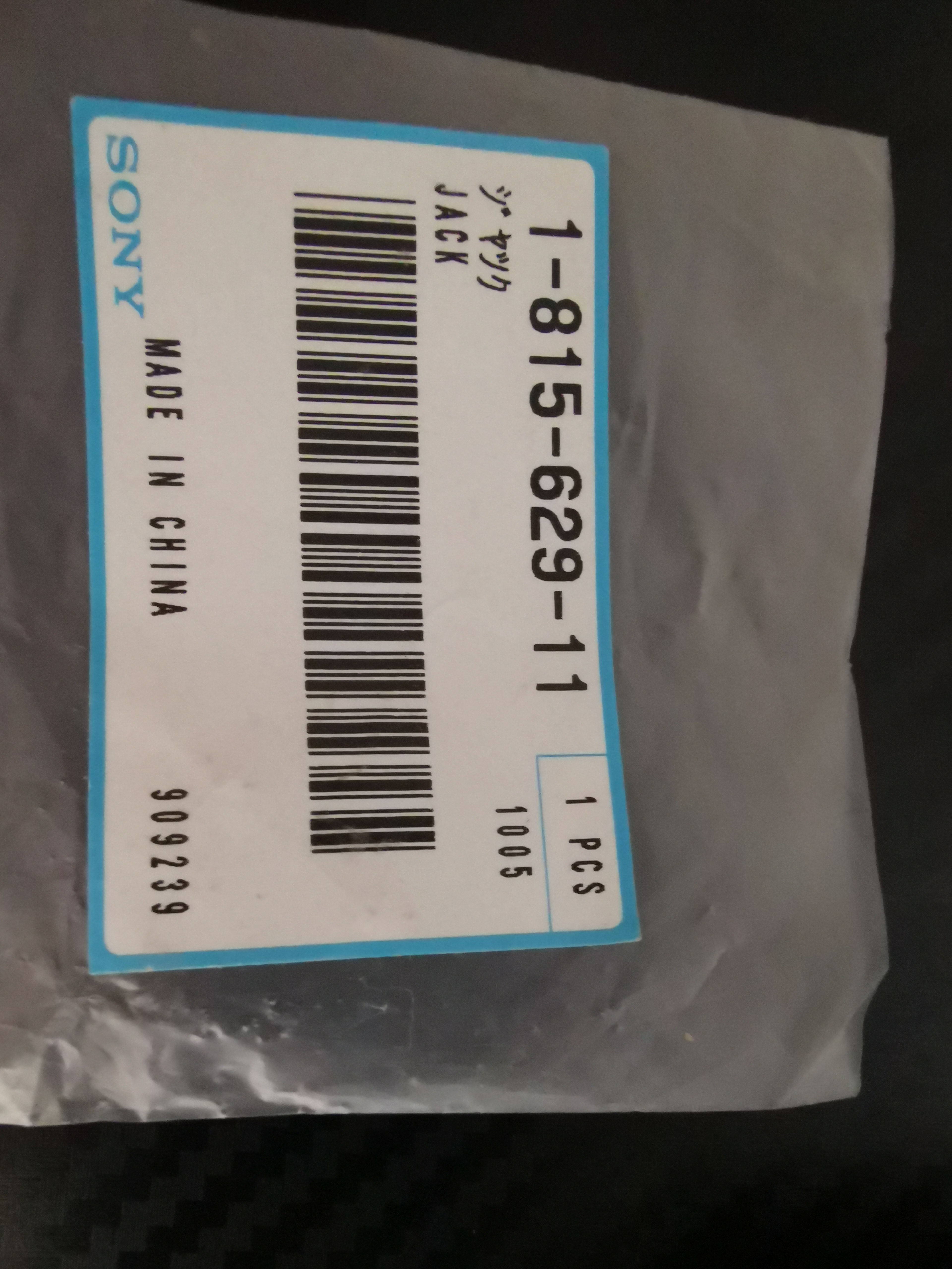

    - On that board, component J302 is specified in the parts list as “JACK (AUDIO IN) – 1‑815‑629‑21.” In other words: it is a 3.5 mm stereo “AUX” jack with an insert‑detect contact, not a USB connector. (manualmachine.com)
    - The product specification confirms the input is a “stereo mini jack (Audio In).” (manualmachine.com)
    Direct answer
    - Exact Sony spare part you’re after: 1‑815‑629‑21 (J302, AUDIO IN jack) for the JACK BOARD 1‑882‑119‑11. This exact jack is still listed by some parts vendors; for example, Sears PartsDirect shows stock under the same part number. (manualmachine.com)
    Detailed problem analysis
    What the 7 pins are doing on your footprint
    - Functionally you need 4 electrical functions brought out to CN301:
    - Tip = AIN‑L
    - Ring = AIN‑R
    - Sleeve = AGND
    - Insert detect = AIN‑DET
    - The remaining holes in that pad cluster are for the jack’s internal switch/contacts and/or extra grounds/mechanical lugs; your photos show two large anchor holes plus a 7‑hole contact cluster typical of “switched” 3.5 mm jacks used to provide a logic detect and maintain mechanical robustness. The service manual drawing shows CN301 labeled AIN‑L / AGND / AIN‑R / (AIN‑DET), and the “JACK BOARD” page shows the RC/ESD network around the jack (C155/C156/C255/C256, D302, etc.), exactly like in your board photo. (manualmachine.com)

    - The detect pad will toggle continuity to ground or to a pull network when a plug is inserted; you can see the AIN‑DET label at CN301 in the manual. (manualmachine.com)

    - 3.5 mm jacks vary widely in body shape and pin geometry even for identical functions. Sony often sources custom footprints. Matching by part number (1‑815‑629‑21) is therefore the most reliable route for a drop‑in repair. The service manual’s parts list explicitly names this jack for J302 on your board. (manualmachine.com)
    Current information and sourcing options
    - Primary: Order Sony 1‑815‑629‑21. Example current listing: Sears PartsDirect “JACK 1‑815‑629‑21” shows in‑stock pricing in the U.S. (availability may fluctuate). (searspartsdirect.com)

    - Fit a generic 3.5 mm, right‑angle, through‑hole, stereo jack with insert‑detect and similar center‑height, then wire the contacts to the original pads (Tip→AIN‑L, Ring→AIN‑R, Sleeve→AGND, Detect→AIN‑DET). This will work electrically, but the body may not align perfectly with the chassis aperture.
    Practical guidelines for replacement
    - Desoldering: Use flux, braid, and moderate heat; clear the two large anchor holes first. Avoid lifting pads near the ESD diode D302 and the small capacitors clustered beside the footprint. Inspect vias after removal. The exact component designators you see on your board (C155/C156/C255/C256, D302, CN301) match the service documents. (manualmachine.com)
    - Post‑install checks:
    - Continuity from jack Tip to CN301 AIN‑L and Ring to AIN‑R.
    - Sleeve to chassis/AGND.
    - Insert a plug and confirm AIN‑DET changes state at CN301 with a meter (the unit uses this to auto‑sense AUX). (manualmachine.com)
    - Functional test: With power on, measure ~0 V DC at AIN‑L/R (it’s AC‑coupled), then play audio into AUX and confirm both channels.

  • #3 21863612
    krzysztofkawka66
    Found part , all working ok .
