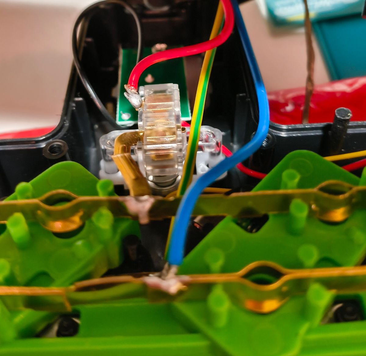

  • A SmartLED 8150 socket splitter from Smart/Tomic promises two 230 V sockets, three USB ports, and a lamp for PLN25.
  • Inside, the Schuko earth path is missing: continuity testing found no PE wiring, and the ground plate seems disconnected from the plug.
  • The USB supply uses a simple PSR flyback on a PL3378 IC with integrated switch, while the USB-C output stays at 5 V and 2.1 A.
  • The unit drew 2 A in testing, but the grounding is only for show, so it is judged a dangerous product.

  • Chinese splitter variant includes proper ground wiring
    #32 21859326
    karasinskibartosz
    >>21857878 I have a similar contraption (without USB), but bought directly from the Chinese. It looks almost identical. I read the entry and looked inside out of curiosity. To my surprise there is a ground! Everything as it should be. The thickness of the cables doesn't knock it down, of course, but it's still much better.
